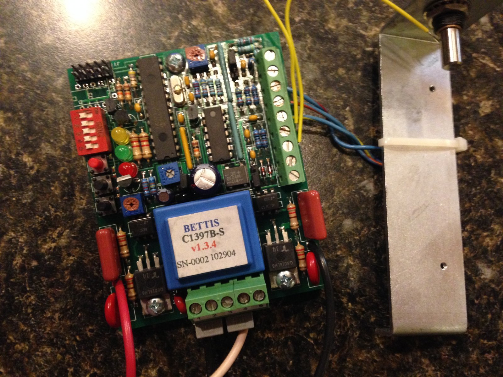

    Seat, I figured that would be the issue, and reversing a motor at full speed = higher than lock rotor amps. I was hoping someone would say, hell yes , done a bunch like that, works like a champ(wishfull thinking). Even though I do have access to a wide range of equipment, my time is at a premium right now. I've been testing the boards dave 001.JPG on the actuators with 4-20ma signal forward/reverse/stop, but the pot on the board is still the controlling factor for the motor, so even if I came up with a code for the arduino for 4-20ma output, it wouldn't vary the speed. To me it would be like a relay setup. I still would like to use the 115vac motors so I may have order a 1phase vfd, but that gets pricey, and that puts it on the wife's radar way too early in the project. Does any one know of a arduino code that will output 4-20ma/0-5v signal for our purposes? Which leads me to my next question. Does an arduino code have to be specifically written for simtools to receive commands or will it work with any serial purposed code. The reason I ask is I've seen some codes that I may want to try from the robot community. I know nothing about code, I would love to learn, but do not have the time or brain capacity.

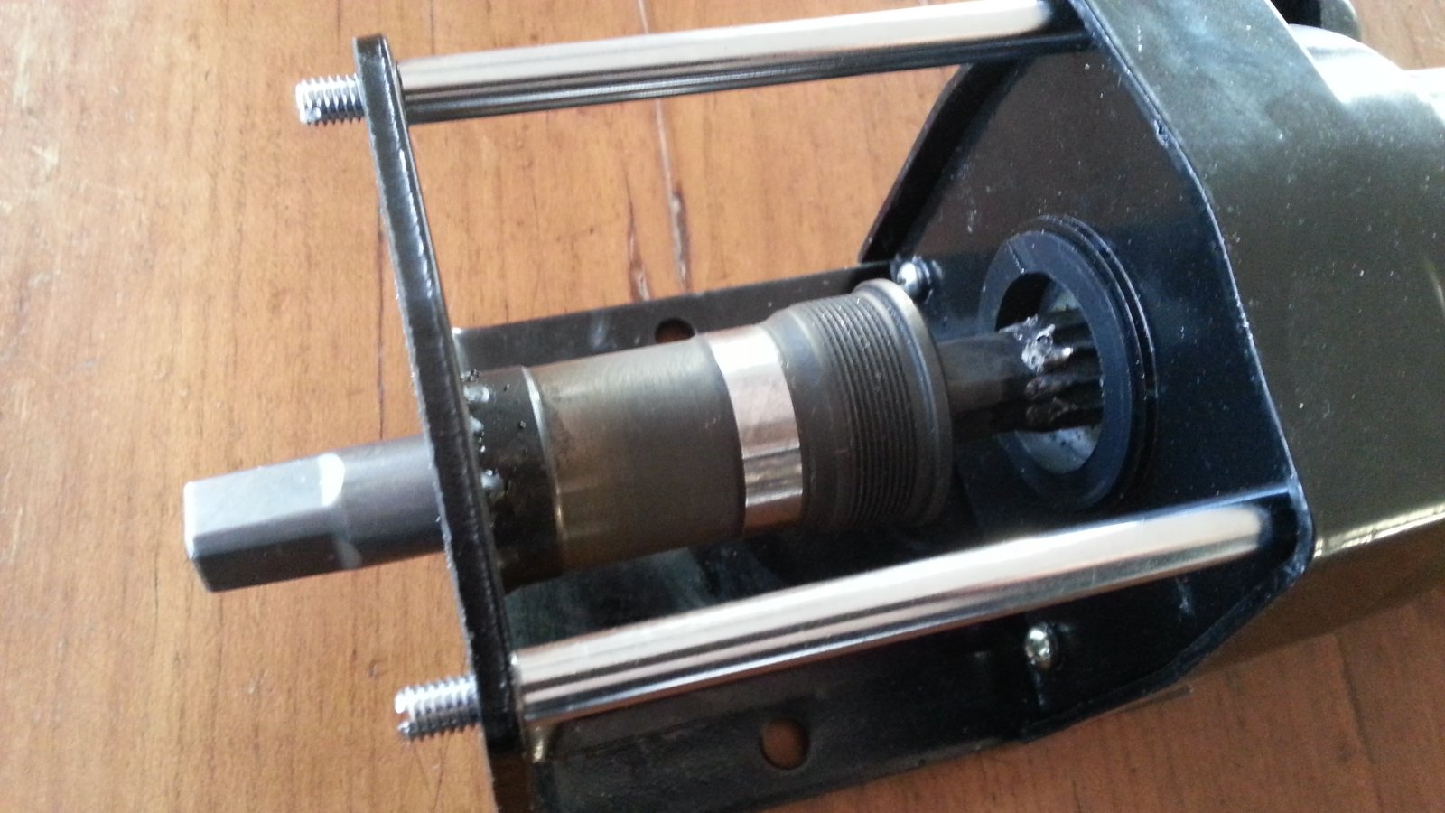

    If you need any inputs how to transform the wheel and axle of the winches into a lever (i used a shimano bottom bracket):

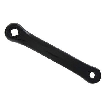

    @Pit nice work, I'm looking at a couple differant options. Are you using a hand crank from a manual winch for a lever? Tying to figure out what would have a square hole. @noorbeast thanks for the heads up, I thought a typical u-joint would be over kill but after reconsidering the possible weight, your right, better to be over than under.

    No it is a bike crank for children bikes, 15cm long:

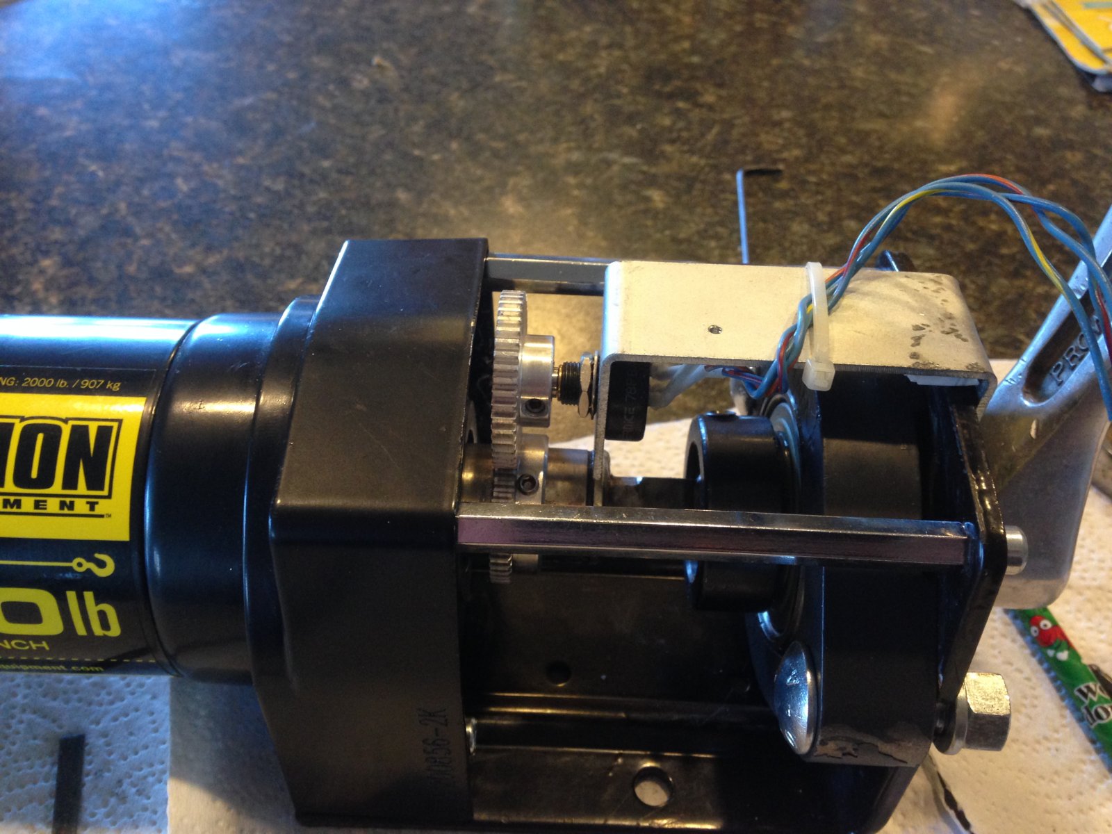

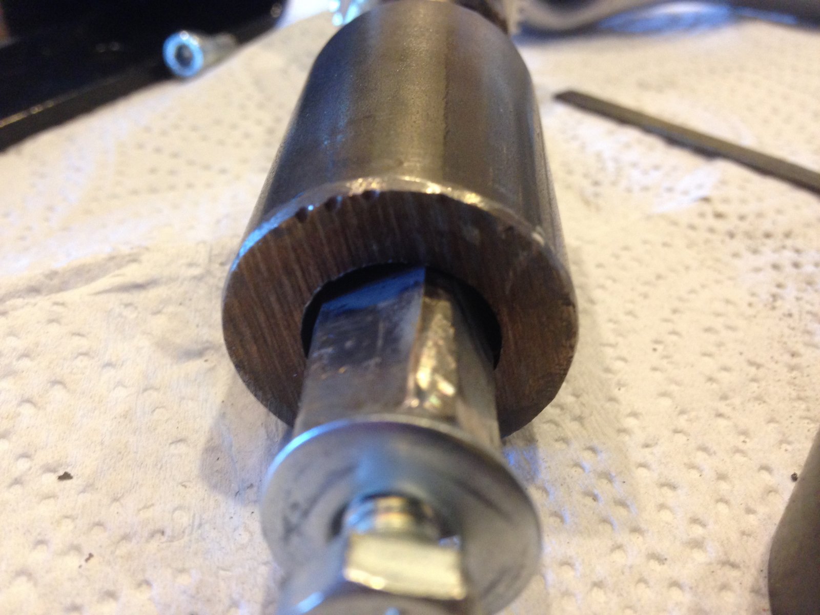

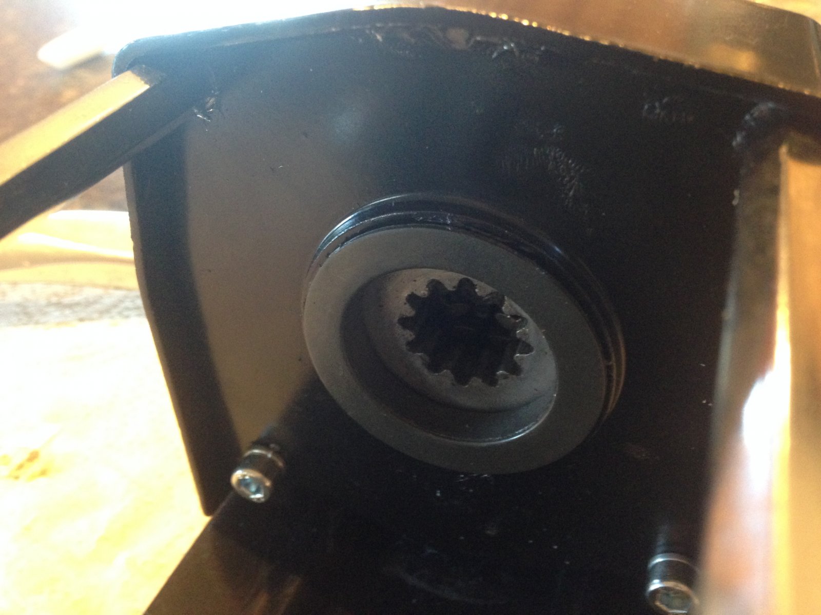

  20. dberg1
    dberg1 Member
    Jun 11, 2011
    37
    refrigeration pipefitter
    west of chicago,il
    150Coins
    +16 / 0 / -0
    :)[/QUOTE]

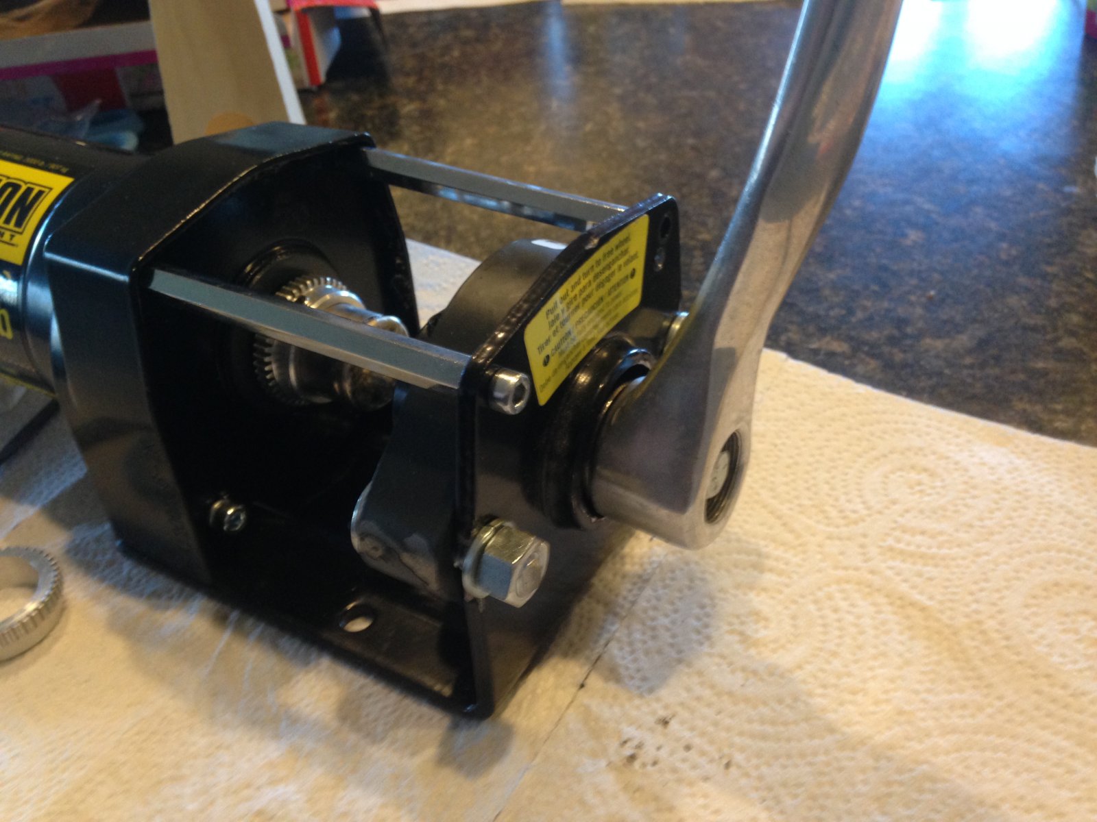

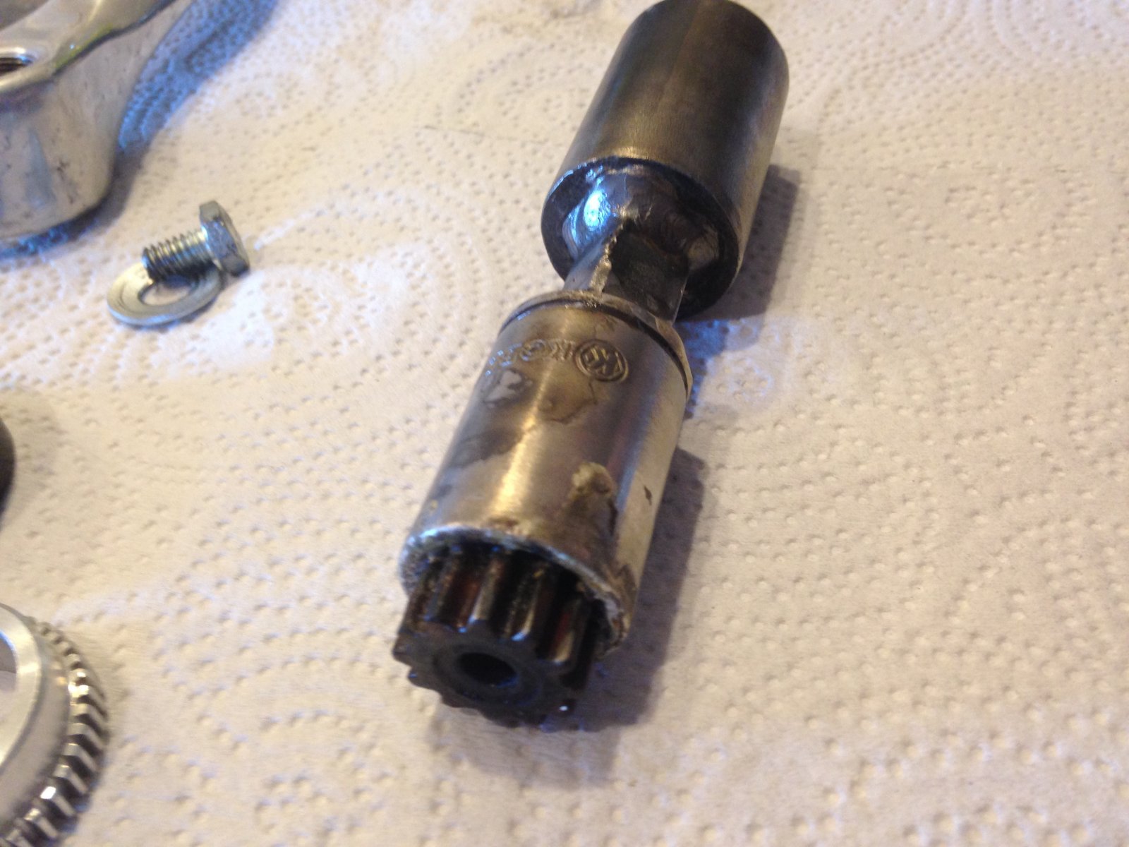

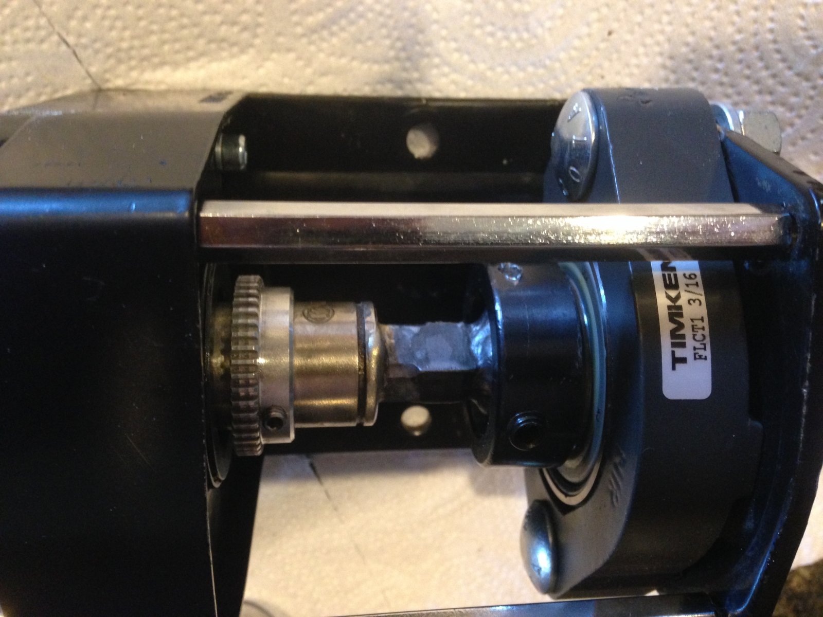

    Finally some progress. received the winches, and ordered 3 motor monsters(decided to roll the dice with cheap ones off ebay $11 each) so here is what I decided to do. Although I can weld I wanted to see if it could be done without welding. Hey, what do you tell someone with single digit IQ...nice weld! (just a little pipefitter joke). After disassembling the winch I realized the spur gear that connects to the spool was 18mm, so using an 18mm socket and a 1/2 inch(12mm) key stock shoved in the drive of the socket extended me out to the arm, and the 3 piece crank arm just happened to be the same size as the key stock(with corners ground on key stock). Now the bearing, I happened to have some 1 3/16 bearings and shaft, so I mounted the bearing, cut and drilled the shaft(using the 1 3/16 shaft as a bushing between key stock and bearing). every thing went together great. I did however decide to weld to key stock to the bearing on one end and 45% silver solder the 18mm socket to the gear and to the key stock to prevent any play when reversing direction(it had very little play before). If someone wanted to use a winch set but can't weld, or no access to equipment it is possible. daves 4-25-15 037.JPG daves 4-25-15 035.JPG daves 4-25-15 034.JPG daves 4-25-15 038.JPG daves 4-25-15 033.JPG daves 4-25-15 040.JPG
