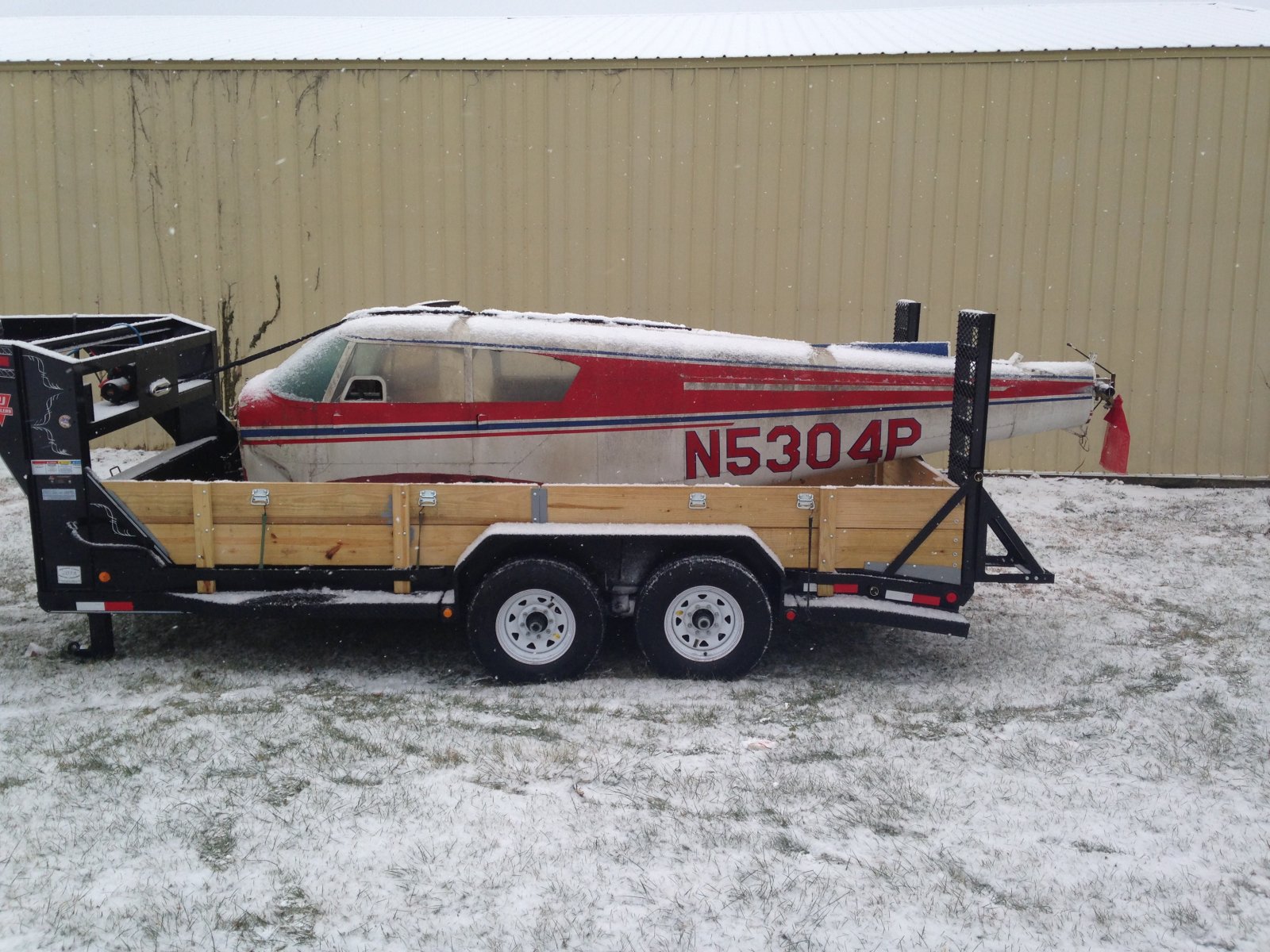

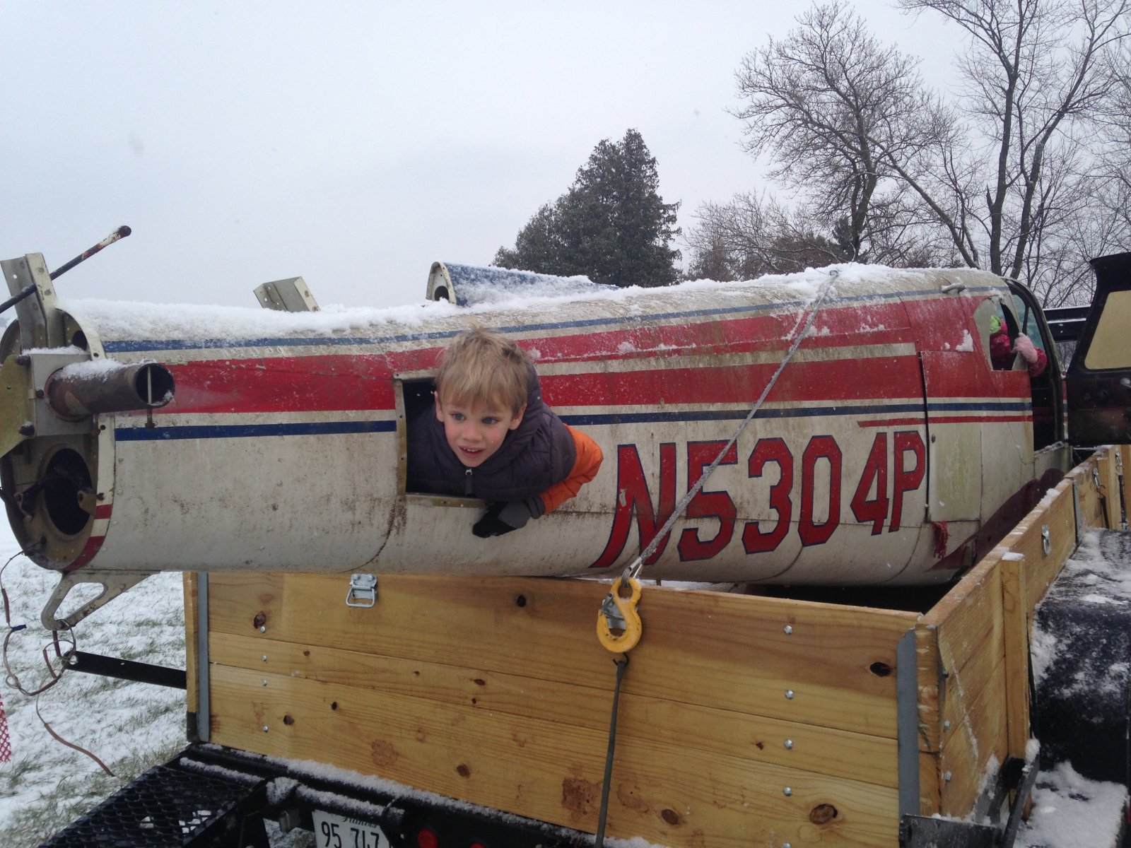

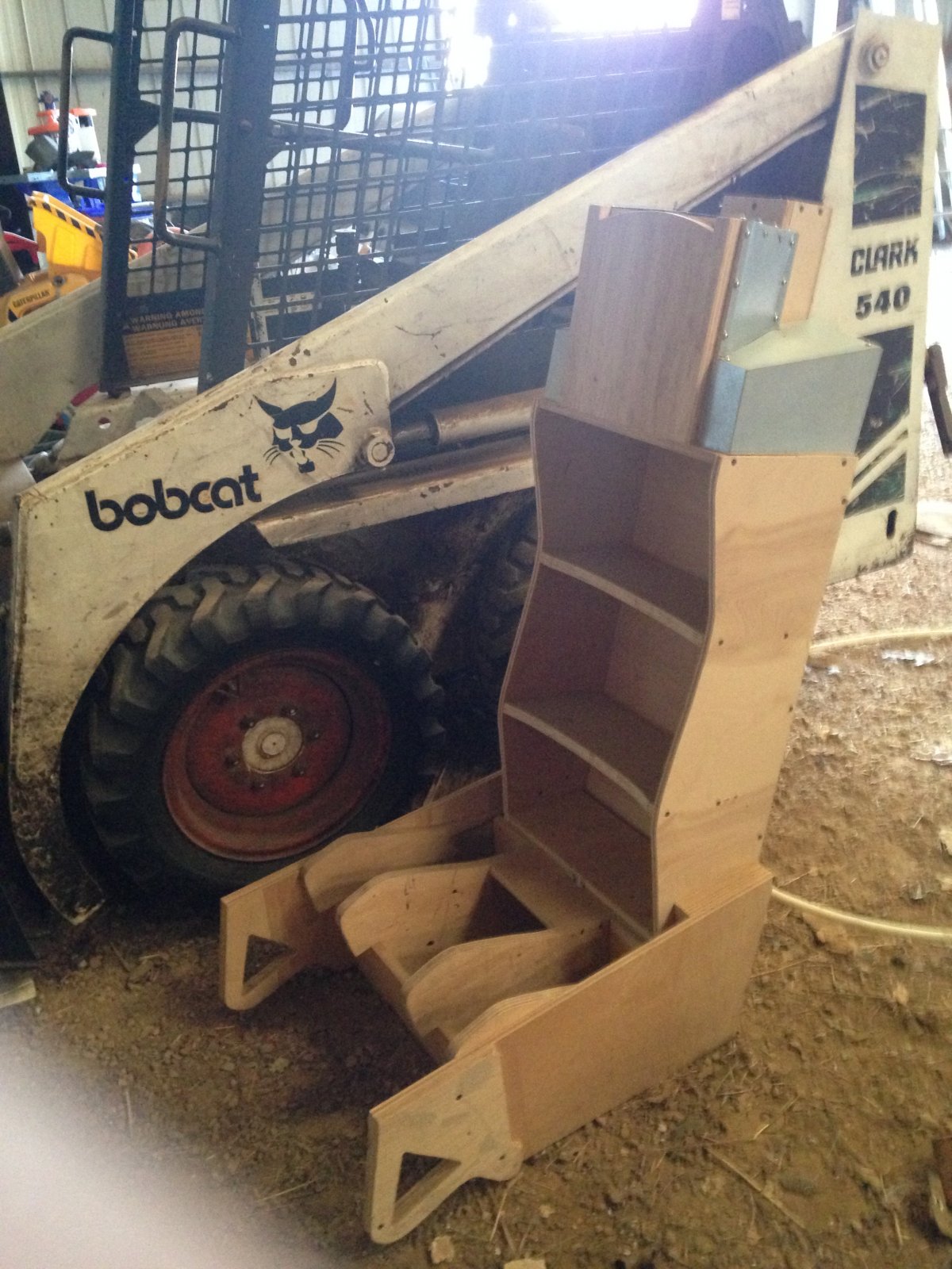

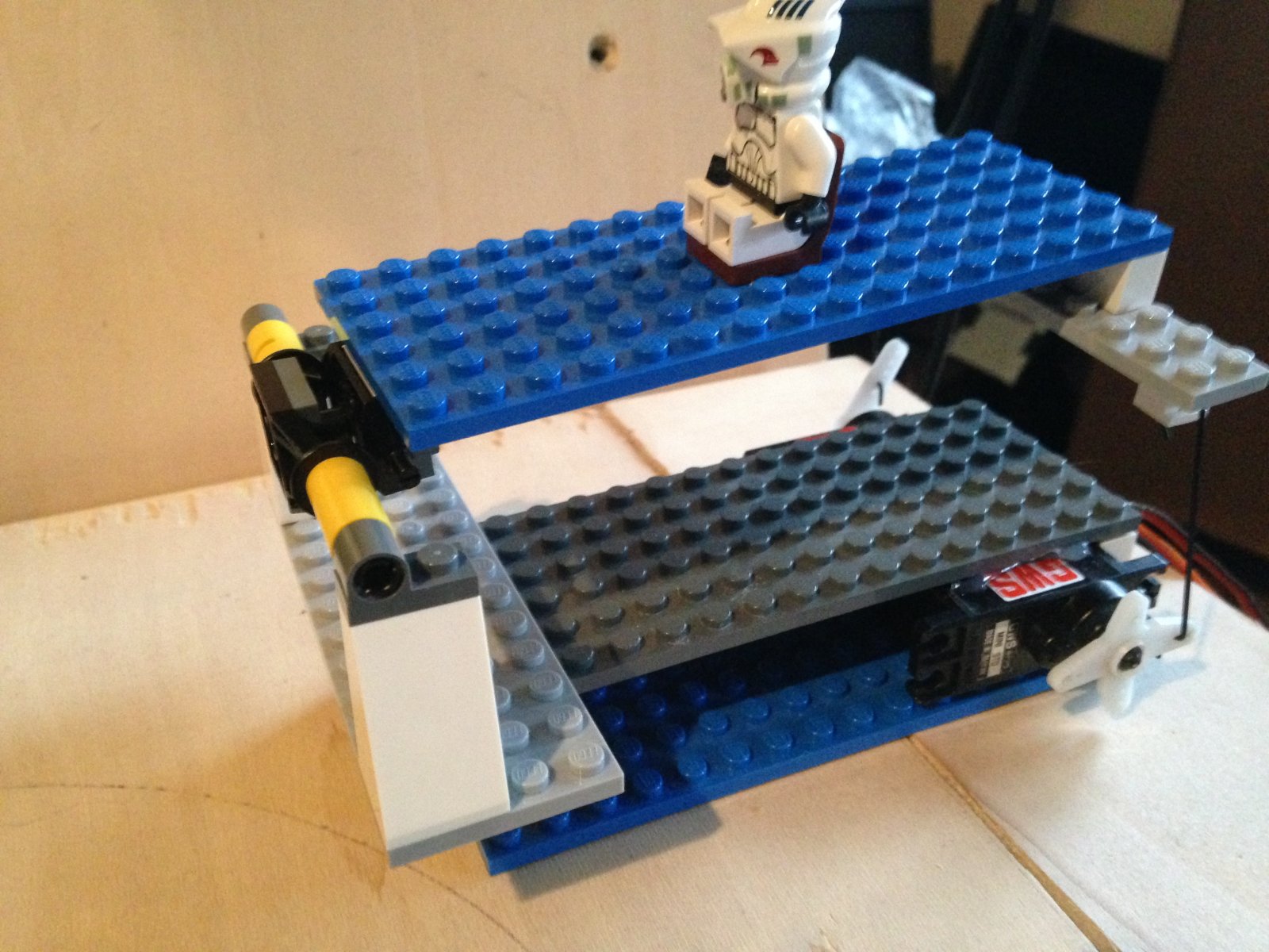

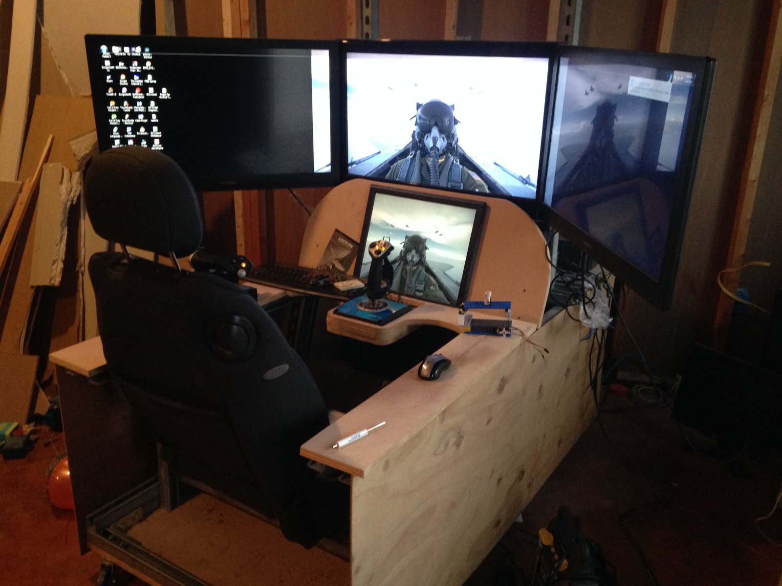

    Ok, so over the weakend I got my arduino and servos working, but haven't tuned yet. I stole some of my sons legos to make a mock-up, and played with it a little bit, but I am confident now I can make a go of it. Not sure what direction to take yet. Would eventualy like to take this. dave's phone 3-30-15 156.JPG and put it in this, dave's phone 3-30-15 001.JPG to make this. dave's phone 3-30-15 155.JPG I'm planning on starting smaller with a motion chair and working my way up. I have some 1/8hp reversible 115vac motors with drives that I would like to make linear actuators with, but the drives have pots to close the loop, so I need figure out how to give feedback to arduino instead of drives. The drives are highly configurable, so I'm sure I can. If I cant I will look into reversing relays with ard relay shield. got to go kids fighting in bathtub. more to come.

    noorbeast, thanks for reply and info. I know it would be a huge undertaking for the full cockpit, thats why I would start with a motion seat and hopefully someday go big. When I built the simpit a couple of years ago, I beefed it up with motion in mind, but I used a crane scale and it came in at 400lbs. I knew that killed any chance for a simple motion platform(which is why I gave up on the motion dream). I bought the fuselage in November with the idea to make a fiberglass mold of the front cockpit(not the whole thing)and make a tree fort out of the real fuselage. I don't have a set budget for the big project. Just a big dream, but being a refrigeration mechanic and a farmer, shit seams to come together. By the way I don't know much about the boards yet, but the actuator manufacture gave me the phone number to the people who build the boards for them. hopefully they can shed some light on things since I service about 30 of these units at $6000 a piece. the ones I acquired had bent shafts due to frozen water in the pipes:eek:(not my fault). If I cant get the boards to jive, what do you think about the relay idea?

    I would like to do the current flight sim, but like I said before I know weight is a problem. I am working on 115v actuators, which would make that possible. I have an aces2 replica daves 002.JPG that I built over the winter, and been waiting for it to get warm so I can fiberglass the back and pan. I think the ACES2 would make a good first, seat only, 2dof/wiper project. the real fuselage is a project for down the road to work on it with my son.

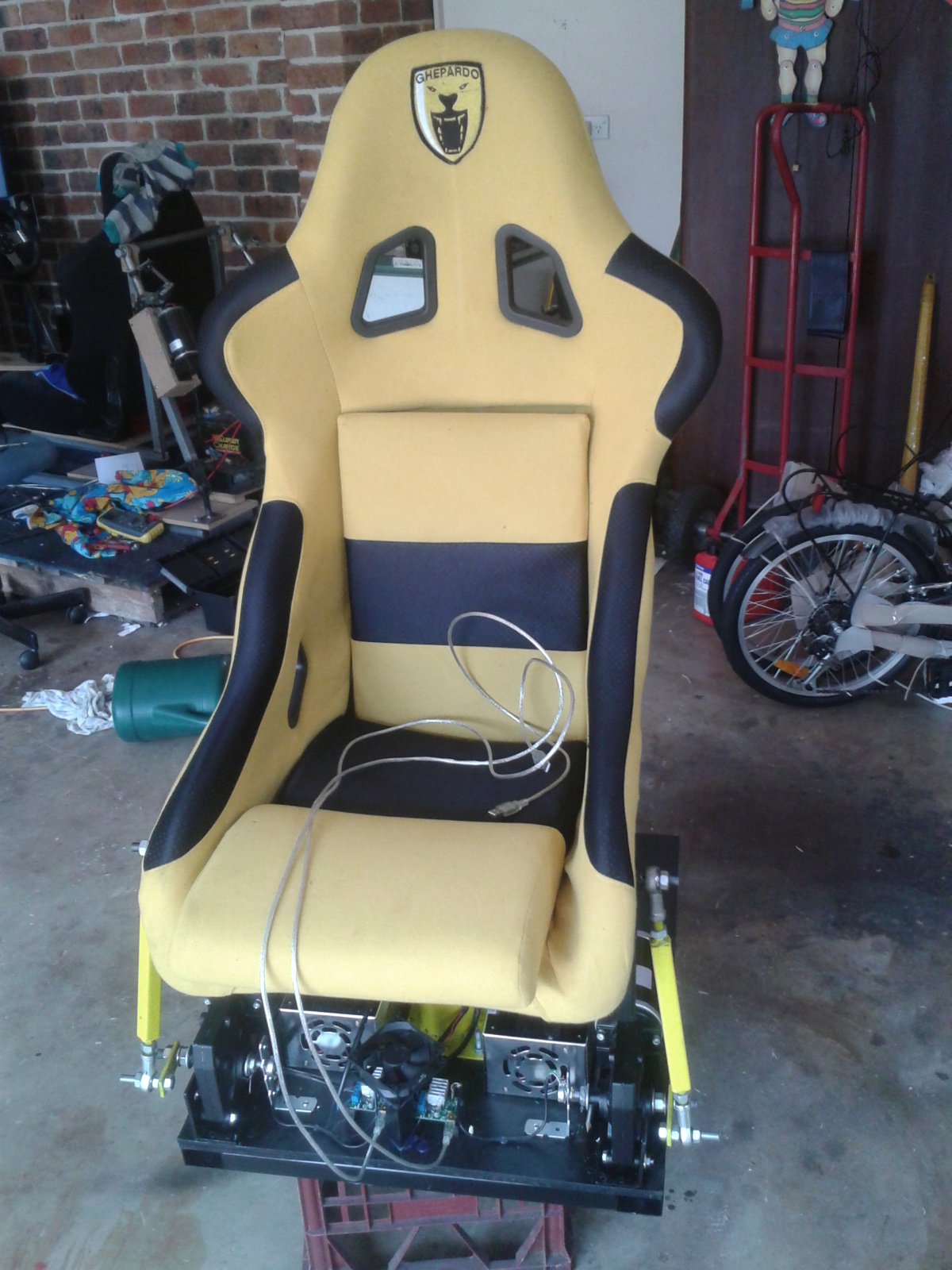

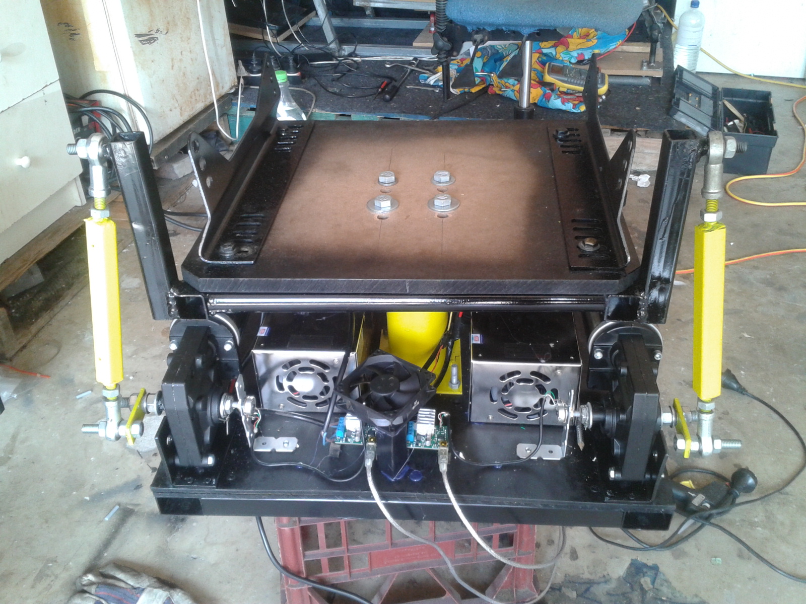

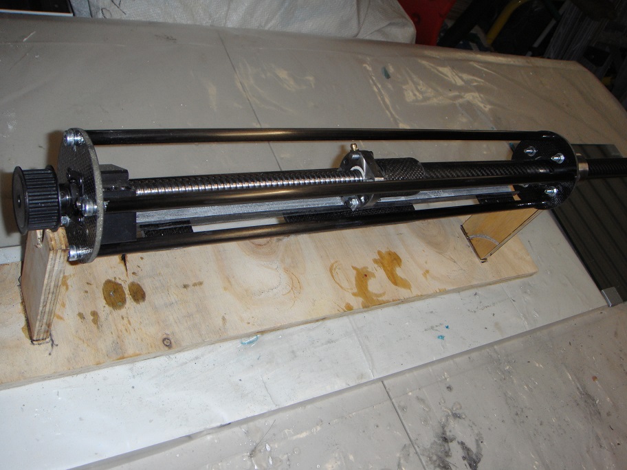

    You don't need a lathe to make ball screw actuators, (below picture of one I'm putting together now after load testing a prototype) although it would be handy for some parts - feedback couplings etc - although you can normally find something close. Unfortunately just using relays to control motors for a sim is not that practical, due to the motor control loop (PID) requirements. As such Variable Frequency Drives (VFD) are normally used to control AC motors (have a read - http://en.wikipedia.org/wiki/Variable-frequency_drive ). This all becomes quite expensive, so its success depends on your budget. Agree that it is better to start with a simple seatmover, learn what is practically required and move on from there. Also just something to think about - if your motor already has a pot connected to it and can move through 180 degrees and has the torque (gearbox already fitted?), then just attach a arm to it and use that to move the sim - actuator not required (KISS:)).

  17. bsft
    Roger that, if its just a seat, maybe stick it on a frame like this

    Hey Seat, thanks for the reply. Your ballscrew looks great. Im going to purchase my screws off ebay. Can't even compare making them to buying. Did a mill retro from leadscrew to ballscrew with ebay ones, and they worked great. The lathe just comes in handy for bushing and other parts like you said. The relays were a thought, with an arduino and a relay shield wouldn't that close the loop at the arduino and still utilize feedback from a pot. I work with vfds on a regular basis(just condemned one on a 150hp motor yesterday to the tune of $3800, cha-ching) I have access to all sizes of vfds, the problem is they are all 3 phase to 3 phase. The motors that I have now are assembled in 4000in/lb valve actuators, which is great but they take 30sec to move 90 degrees and that's too slow, unless you just smoked a lot of weed, then maybe it's too fast. So I'm looking into caniblizing the actuators for the motors and boards. I actually do have a pair of wipers motors to use for my first chair mover, I got them a couple of years ago and already fitted them with pots before I got discouraged with my arduino and shelved the project. I will keep you guys posted with what direction I take.

    Looks great! That's what I had in mind, for my first
