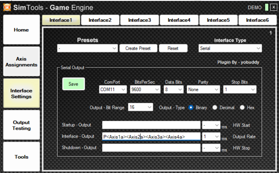

    Lebois code testing:
    Generally I have found it to be very stable and reliable. However, while testing in interface settings it seems slow to move to long adjustments. For example, if I place it on 100 and click the X to take it back to 0, it takes about 0.5-0.75 seconds. I've tried reducing the specified value in the code, past the recommend 6 to 3. Functionality is ok, but the speed remains the same and perhaps too slow. This is all at 51200 micro steps. Lowering the mocrosteps speeds up the motion and increases the range, but also comes with larger steps.
    However, in real world game testing (and for my purposes) the motors just about kept up with the output when viewed in virtual output.
    Tintin code testing:
    Using this code as supplied initially gave issues in interface setup testing. The motor randomly jumped around and was uncontrollable. I found that increasing the ms from 10 to 20 solved the issue. I then had the issue that the motors would randomly move during fast chamges. Changing the range to 1600 fixed this. This gives about half a rotation in each direction (360 degrees total). This is using 3200 microsteps and I found the motors are much quicker and responsive, hitting their targets faster (at the expense of larger steps). I tried other microsteps setting without success.

    I've done some more testing and the main issue Ive found with steppers is they are easily moveable if they are powered down. When powered back up the middle position is not always the same, so I would imagine an initial homing procedure would be required to center the axis, similar to what many 3d printers do with limit switches.
    The big question, is this possible to implement in either of the codes we're testing here? If not, I can't see how steppers are ever going to be a viable option

    Lebois' code is made for linear actuators, with 3200 micro steps. It doesn't correspond to your purposes... For me, this code works well but I have to reduce the speed either the motor drivers fail : something like a too high difference between motor position and input. I'll buy better quality stuff...
    With my code (original by aeorobbie), the motors are really faster and more responsive as you said. 5 ms is not enough, 10 or more is much better.
    Switches are highly recommended because when start up Simtools and output test, you'll notice that once it goes back to middle position, the position is not the same. This is due to the output format (0-255 in our case). The half of 255 is not 127 but 127,5. The problem is that the code "thinks" that the middle is 127,5 but Simtools sends 127 when you put it back to home position. With a small range, such as 1600, the difference can be clearly seen. This issue can be solved by either using a higher output format or using switches, like on a 3D printer. In both case, you have to modify the code. I'll try modifying the code for a higher input format, and then do some researches on how to wire and code for the switches. I will keep you updated.

    The problem here is there is no 127.5 for 8 bit output. ( as bit output is integer math)
    Please see the Appendix C: Bit Resolution Chart in the v3 manual for more info.
    I have not fully read the thread to see exactly what your doing, but buzz me if you need help, and I will see if I can help.

    Thank you very much for your reply. I'll check the manual... I said the problem was because of 127.5 because when I send 127 through the Serial Monitor or click on Output Test in Simtools, I can hear and see the motor moving of one or two steps, as if the middle / home position wasn't 127, but 127.5 for exemple. It was quite logical for me...
