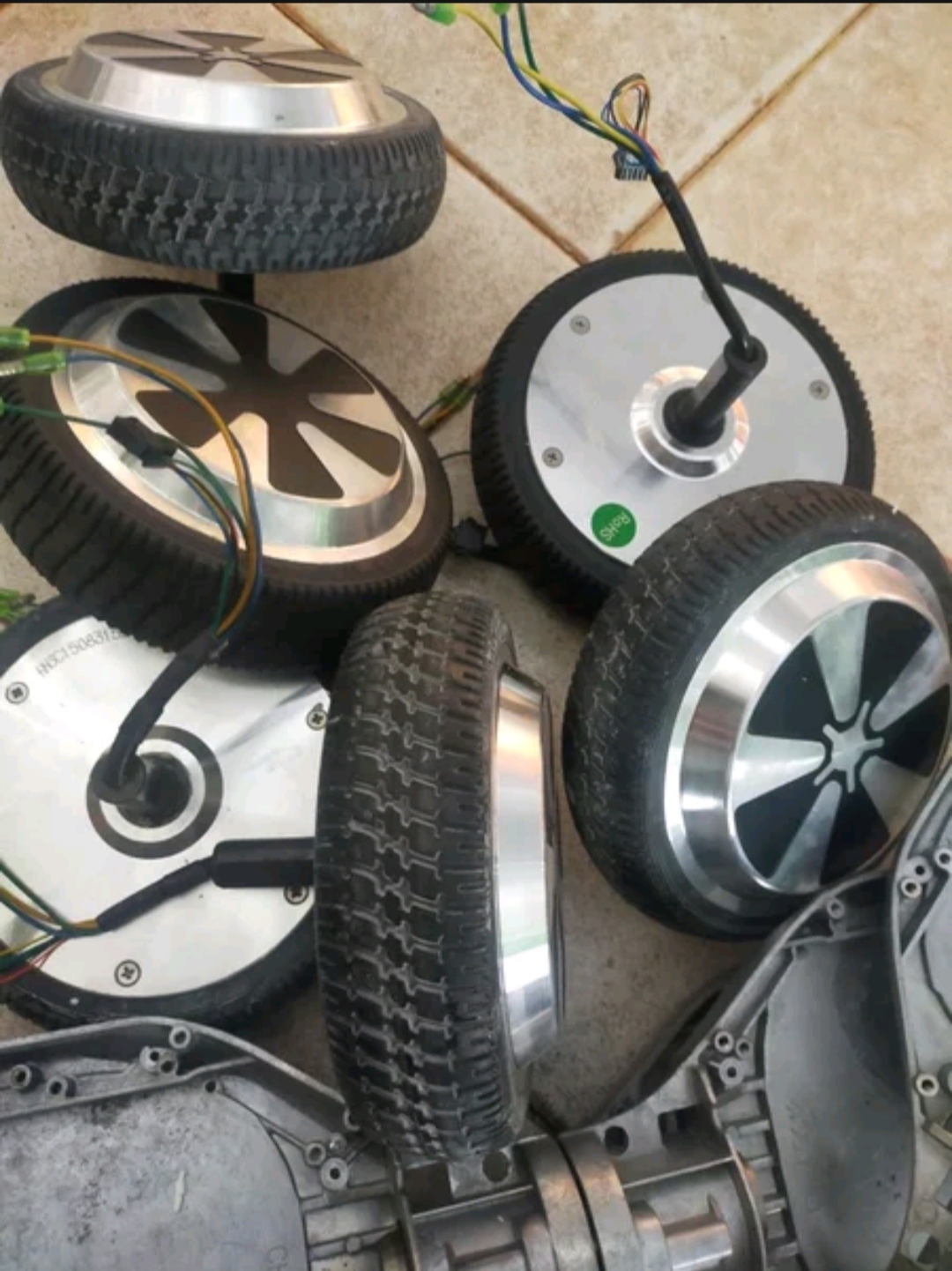

    hi all, before i buy this bldc motor i want to ask is it possible to use it for 2 dof or 4 dof?? with Vesc drivers?? because logically this hoaverboard bldc motor is able to support a load of 60-100kg. yes that's my crazy thought, but before I waste a lot of time and money on it I ask first. Or has anyone discussed this before?? direct me there. because at this time I feel less comfortable with the wiper motor, it is not strong enough to support the load. and I have read the post how to make a diy actuactor. this : https://www.xsimulator.net/community/threads/diy-linear-actuator-design.8221/
    and in my area it is still possible to get used ballscrews, as well as used dcmy1016 motors. which one is more recommended??

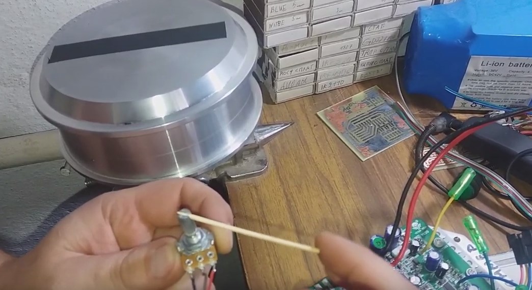

    I am also very interested in this!!! Here is an example of the operation of such a motor:

    yes - i think you could use one with a eccentric pin on the end and 2 lever arms
    could also be used for a ballscrew
    these motors have coils at a larger diameter than a normal motor and have good torque for thier weight
    i am surprised nobody else seems to have done it

    you will need a brushless motor driver and an encoder / potentiometer

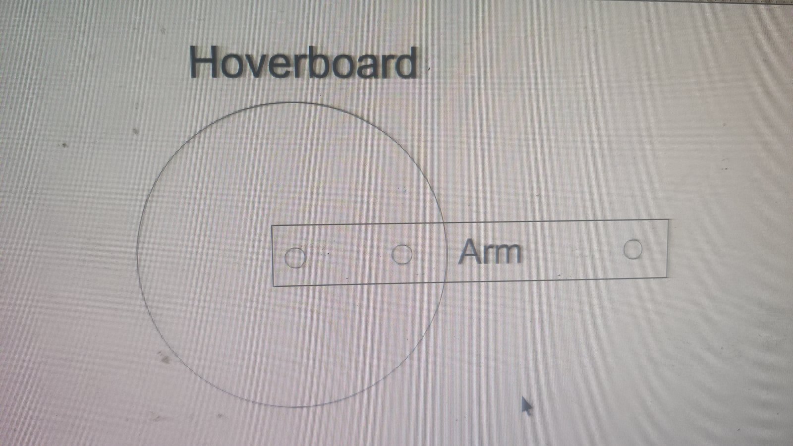

    How do you imagine the work of mechanics with wheels from hoverboard? Can you draw it schematically?

    Just like that sir, without gear reducer.
