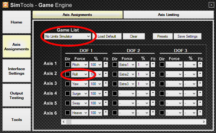

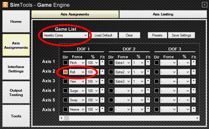

  16. value1
    Jan 9, 2011
    2,192
    Zug, Switzerland
    14,295Coins
    +3,363 / 13 / -1
    The beauty of SimTools is that you can set the axis assignments individually for each game.
    So when you feel, the roll axis should be converted in Game2 vs Game1 you just do this:

    yup, agree with that @value1

  19. shannonb1
    shannonb1 Well-Known Member
    Mar 12, 2008
    1,106
    Sales Intelligence
    Virginia
    8,909Coins
    +598 / 5 / -0
    It's not a question of polarity. Everything else works as expected but surge requires me too invert direction. If I reverse polarity then I would have to invert both axis on pitch. So your suggestion would just create another issue. Appreciate the thought though.
