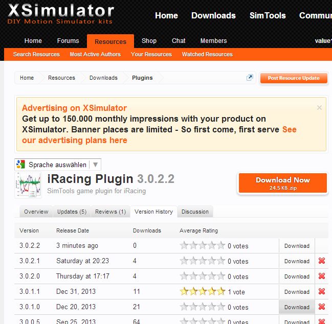

    You are right about that but the download file is called the same as the previus version.
    I know its a a little effort to change the file name but I forget to do that constantly so when I push the download button I overwrite the old file.

    Thank you @eaorobbie! Fixed now with 3.0.2.2
    @Rinus janssens: You can download any old version via the Version History:
