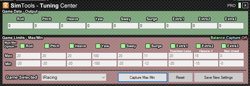

    Hi today i completed my sim and it works fine with the output testing so i seem to have all the settings right.
    I have updated the plugins for my controller and iracing and patched etc
    I also used the axis assignments of Vulbas settings as he has posted in the share your axis settings on here.
    But when i go to the iracing sim in game i get no feedback.. is there something i need to do after all the steps i have done above?
    Much appreciated for any info if someone could please help.. im not sure how to do a screen shot of my settings and yes i have saved the settings as i go.

    My settings in tuning center…..and works fine

    This may have been my problem.. i had never entered anything into the tuning centre because i did not know i had to . I merely just thought i needed to set the axis settings and the patch the plugin for each game.

    You just have to capture the plus and minus, and save settings.
    I changed the surge myself, because I wanted more action when braking and shifting, and not when going uphill.
    So you could make the led at surge blue and capture again (save settings) to see if this works better for you.

    I have motion i cant believe it .. its beeen a loong time coming
    If i make the values too high does it not respond at all? I tried changing alot of them from 20 to 100 or even 200 but did not get much result
    Do you mind sharing with me your Axis assignments ? like the percentages etc .. i have all mine set to 50% but on my Drives i only have my actuators able to extend 25%

    My motion sim has only 2 motors ..... you use 4 actuators, so I don't know if that's the same thing
    But here my settings Roll 40% - Pitch 8% - Heave 30% - Surge 80% - Sway 60%
    If this doesn't work for you, it's best to set each axis individually and test one by one in the game
