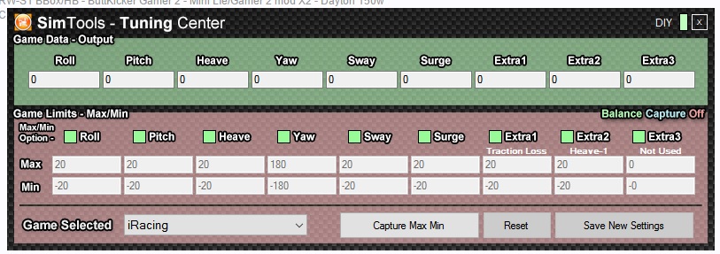

    I have the same problem, "Extra2 the value heave-1g". , When I set up extra2 to 1 or 150 nothing is changing

    Extra2 is an alternate for Heave - this is used for road bumps sensation.
    Pitch is needed for sensation of going up and down hills. Reduce the value in tuning center to have more effect in sim.
    Both work for me.
    Post screenshots of your iracing profile tuning center settings and axis assignments.

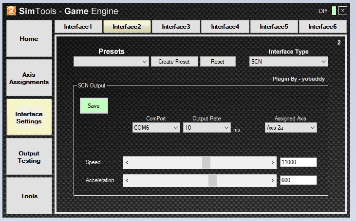

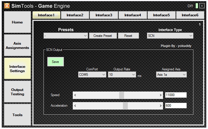

  6. gollum555
    gollum555 New Member Gold Contributor
    Feb 14, 2017
    - 140Coins

    That is not your Tuning center. Right click on Game Engine Icon in your Task bar. Those are the numbers Roofus is asking for...along with your Axis assignments as you've posted already.

    Roll pirch and surge are for testing how to setup it, let's say temporary solution,
    Below screen
  9. Nick Moxley
    17,056Coins
    +2,506 / 30 / -2
    Those appear to be default numbers in your tuning center. Running 1 force at a time and understanding what's what and how it works is Critical imo. Stick with Flat tracks for now, Leave the Banking/Roll/Sway issue for later. Learning the basics will go a lot further in the long run.

    Tuning center values bud. PS How can you have adjusted Dirt to work properly without touching the tuning center may i ask ?

    First of all, I'm moron , I have tried to adjust tuning center in Iracing but without results, now is working , now time for real adjustement all forces , thanks for tip.
    By the way, DIRT -> Prehaps I have played in tuning center in the past, and forgot about this
    Sorry for stupid questions , but finnaly Iracing working nice. ;-)
  13. Nick Moxley
    17,056Coins
    +2,506 / 30 / -2
    One force at a time, Realize One force by itself might feel "dull or not enough" Just bare with me, Get all the forces tuned to where you think they should be, Then Turn them ALL back on, and you'll be amazed. Trust me.
