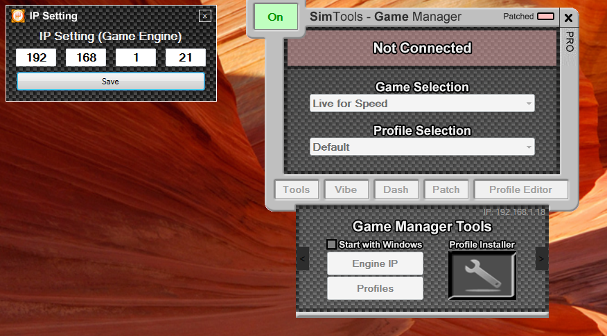

    Hi all i have buy simstool pro and game manager dont connet with my laptop.
    i test with a crosscable and test too with à right cable and a switch .
    I have a 2dof diy with arduino on 24v supply.
    Sorry for my poor english i am french
    Thanks for your help

    ok i make this after but i have test simstool v1.3 and i have no ip problem to communicate with my laptop so i think it's a software problem

    Actually it is a configuration difference between SimTools 1.3 and 2 that is likely the issue. The difference from SimTools 1.3 to SimTools 2.0 in setup is that instead of axis defined like this <Axis1> it is now like this <Axis1a> to designate grouping for a or b.

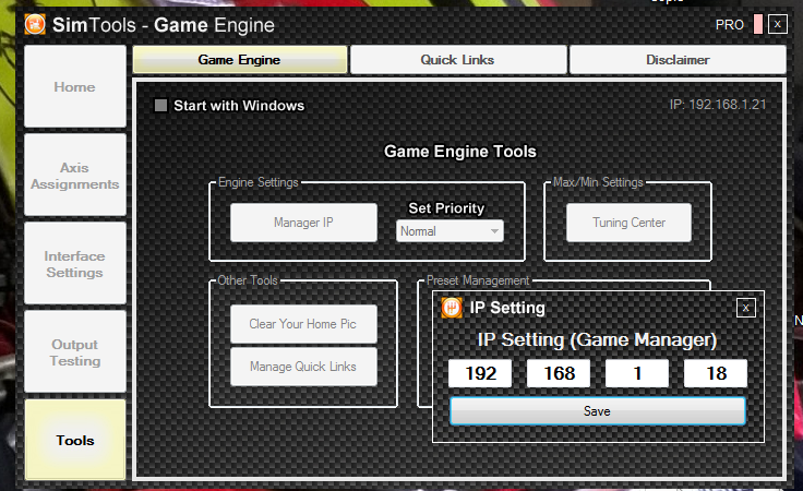

    this is the picture off my game computer and my laptop , the ip game manager and the ip game engine are good but i have not connected?
    the cable it's ok because i i test with simstool v1.3 i have connected with game manager
    i have check my firewall so i dont understand where is the problem
    i have activated my license on two pc
    if somebody have a solution to test
    thanks

    Check my earlier post about changing your Interface Settings for SimTools 2:

    Hi:) thanks for your help :thumbs i have see the configuration for group a, but now the commutication work and i dont understand why :think
    this afternoon i test and i hope to never have this problem
    BIG THANKS for your help hug:
