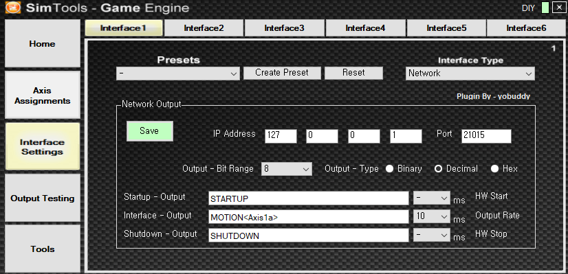

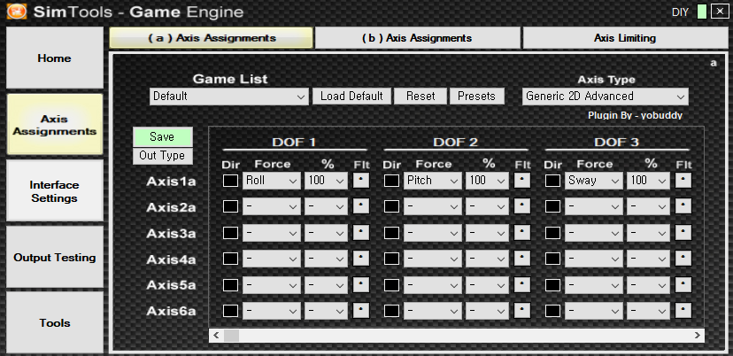

    Hi.
    I hope to receive motion data using UDP.
    However, no SimTools packets captured when I capture my network interface using Wireshark.
    What I missed?
    Thank you.

    What happens when you go to output testing?
    Maybe try output testing with the ( a ) Axis Output selected for Output Type.
    Let me know how it goes buddy!

    I already tried other ports. 21015, 5123, 3462, ...
    Should I check my antivirus software and firewall? (I don't understand...)

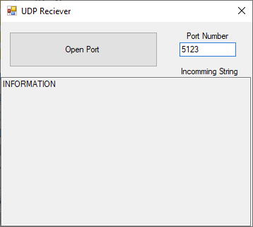

    I'm not to familiar with Wireshark.
    But I built a little UDP Receiver tool I use to check for data.
    Maybe give it a try.
    Take care,
