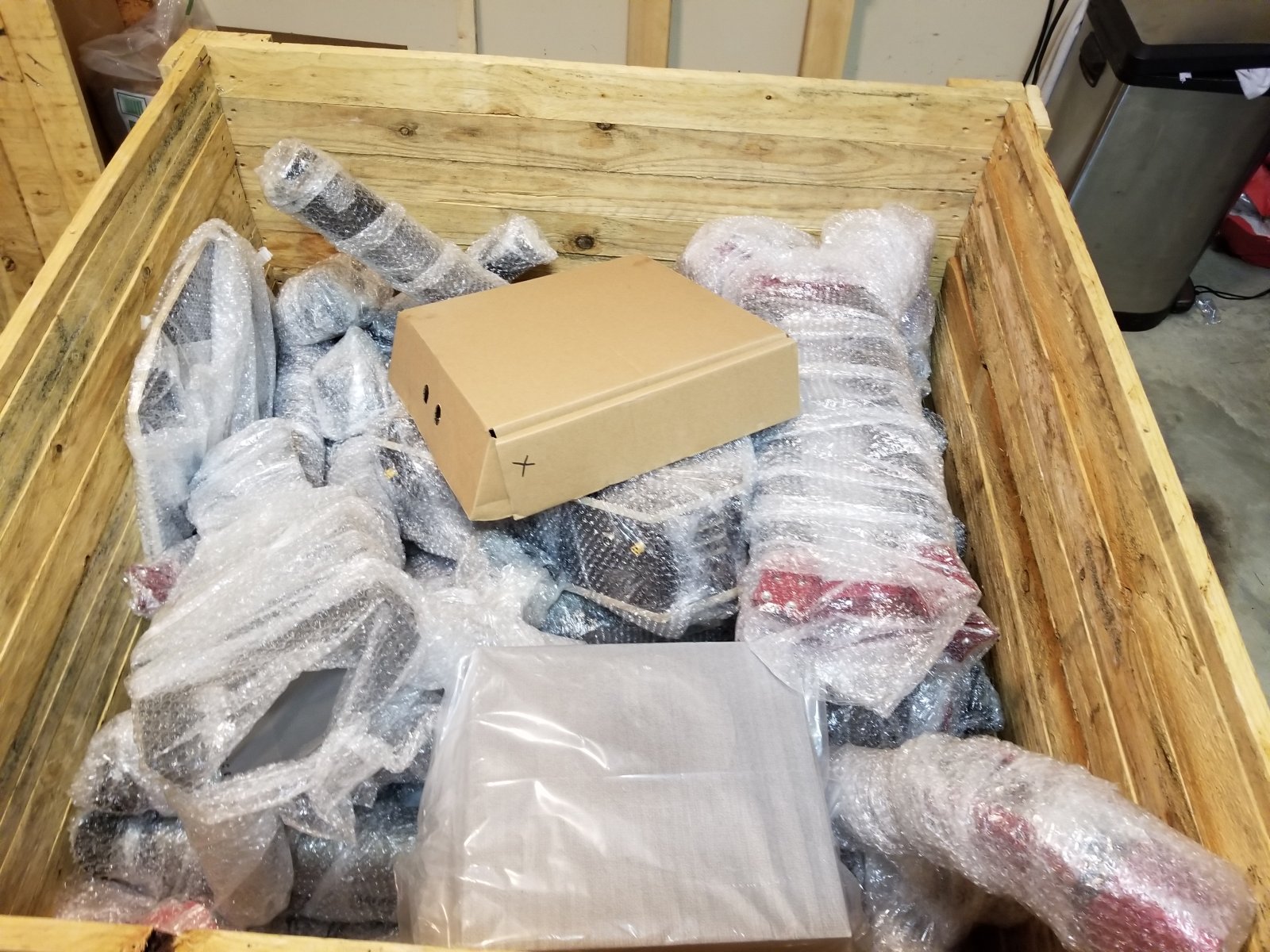

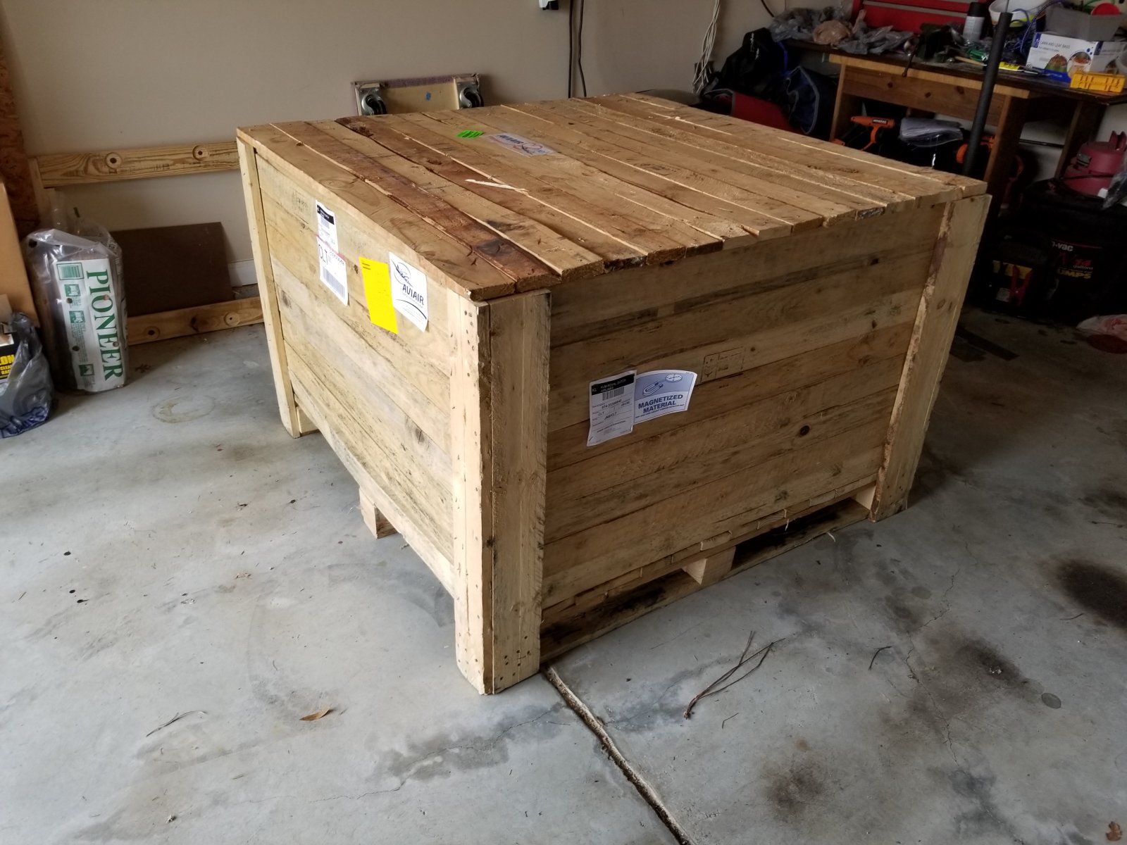

    Here is the crate. It was very sturdy and there was no damage externally on the crate. Not bad from coming 1/2 the world away. :)
    Thing looked well wrapped on the inside
    Here are the parts for the base assembly
    So my initial impressions are that this sim is a very solid construction. The finish and craftsmanship is excellent and actually much better that I expected. Finally this is a lot bigger that it looks in the pictures. This is no toy and would be right at home in an arcade or a racing shop.

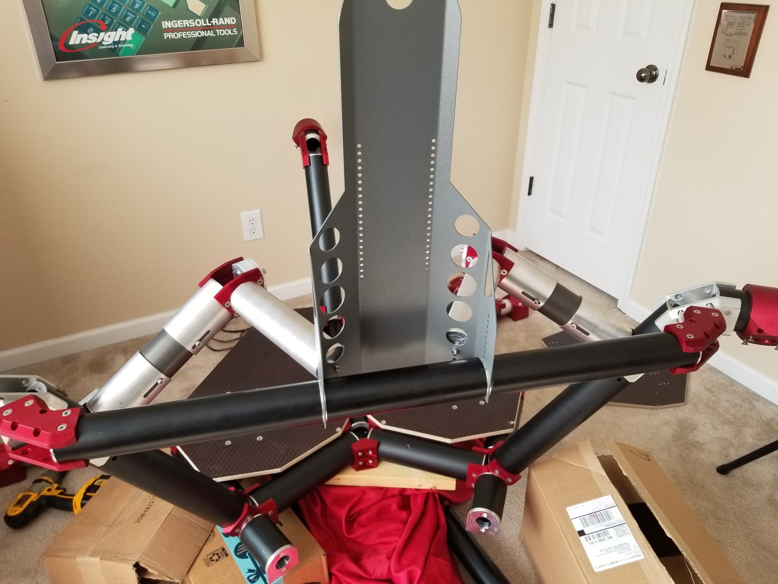

  6. Red_shift
    Red_shift Member Gold Contributor
    Sep 2, 2017
    55
    Charlotte
    361Coins
    +52 / 1 / -0

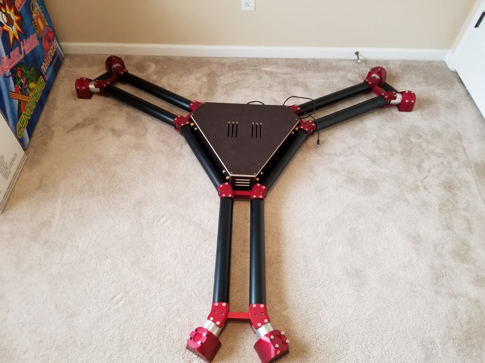

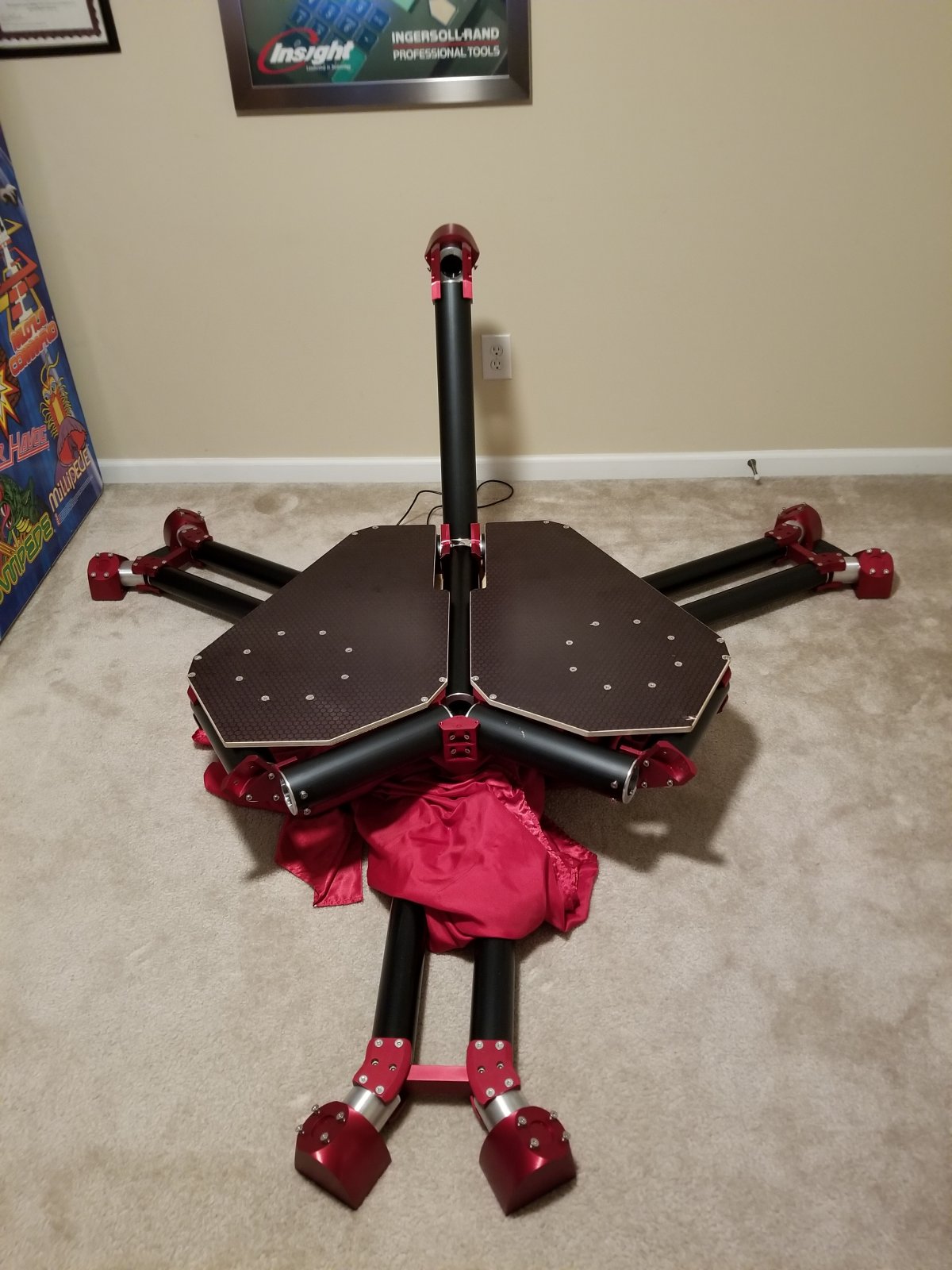

    Here is the base assembled
    Here is the platform on top of the base for screen assembly
    And here is where I am at right now with the base filly assembled with the screen bracket
    So far the build has progressed smoothly. The hardest part was the assembly of the black screen bar which has a middle center piece that screen mount attaches through. The next step is to attache the actuators. Stay tuned :)

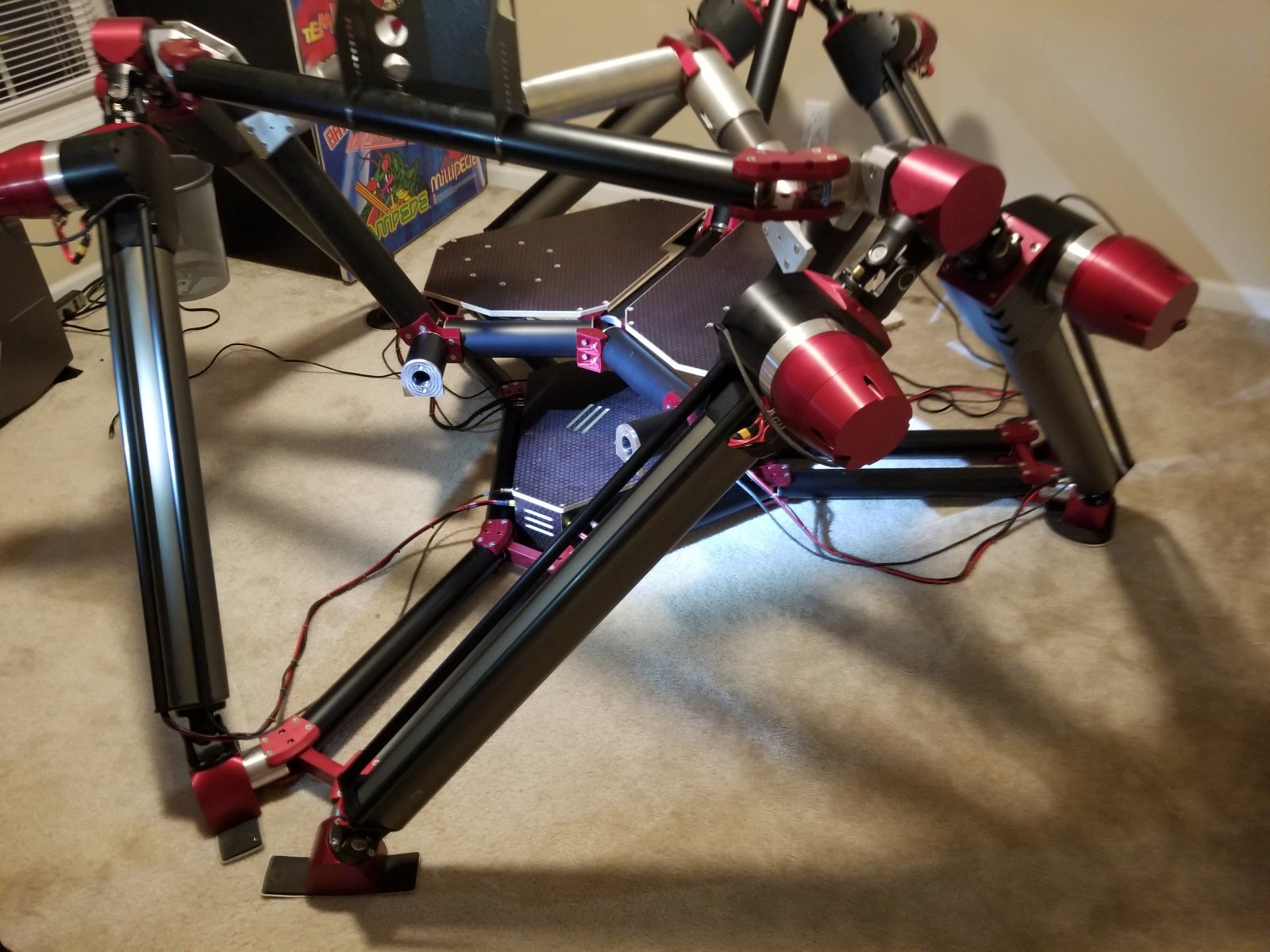

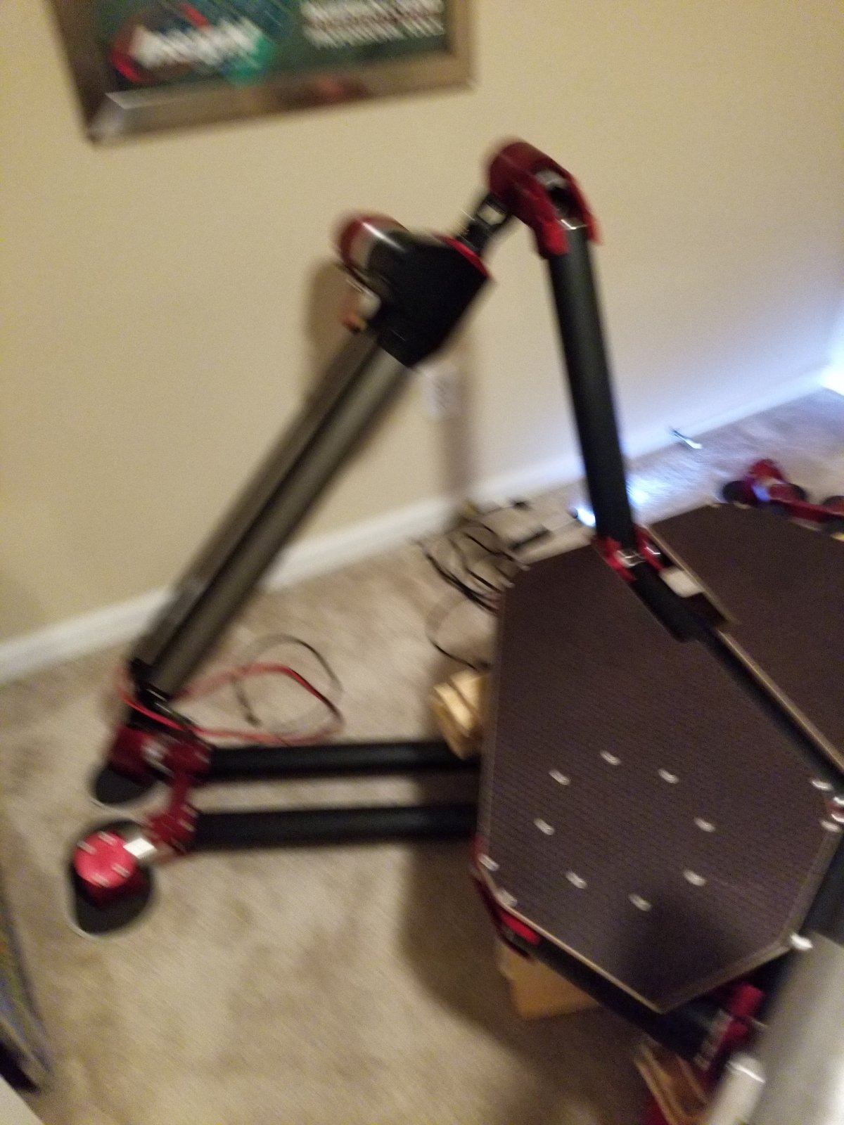

  9. Red_shift
    Sep 2, 2017
    55
    Charlotte
    361Coins
    +52 / 1 / -0

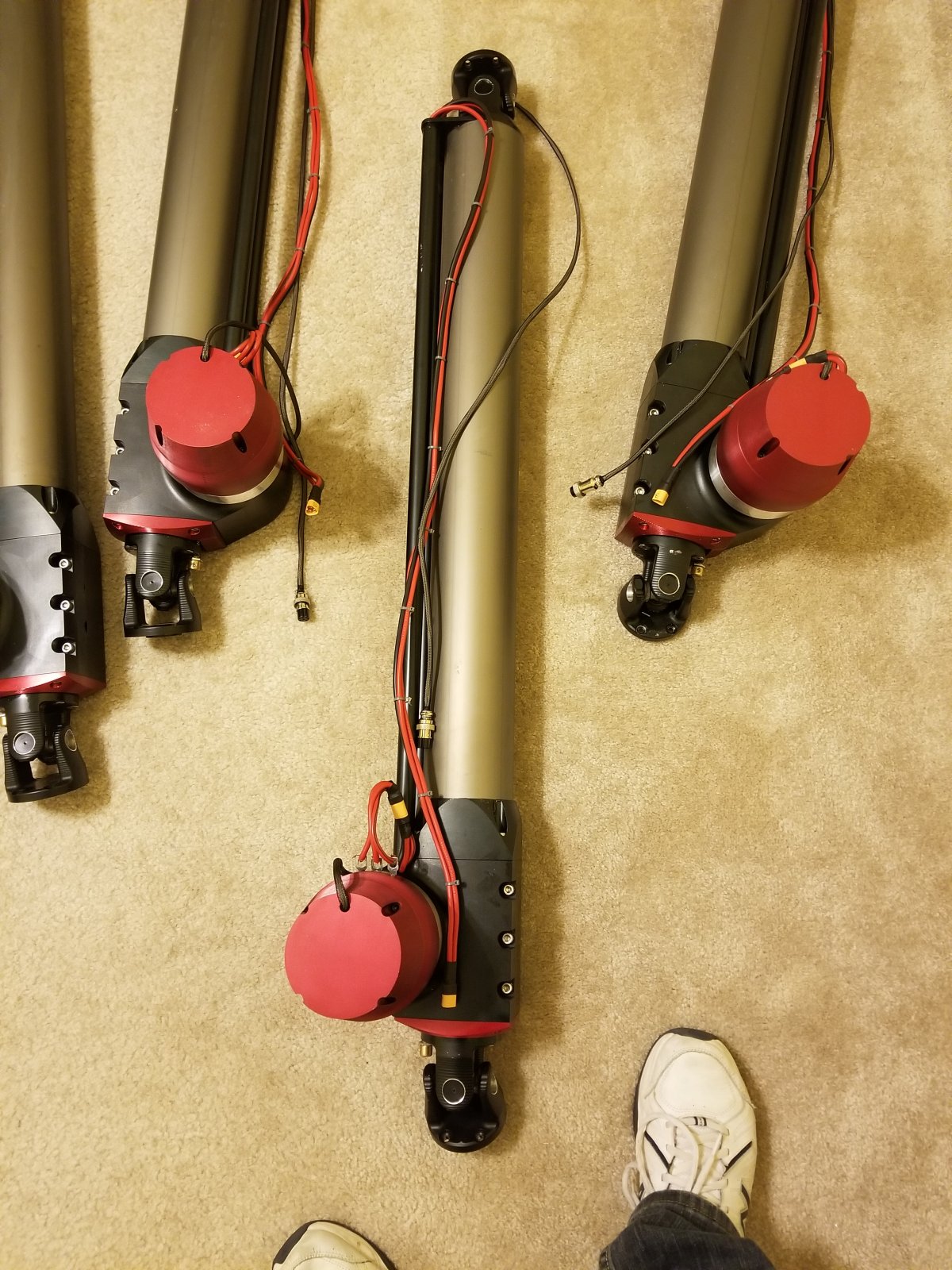

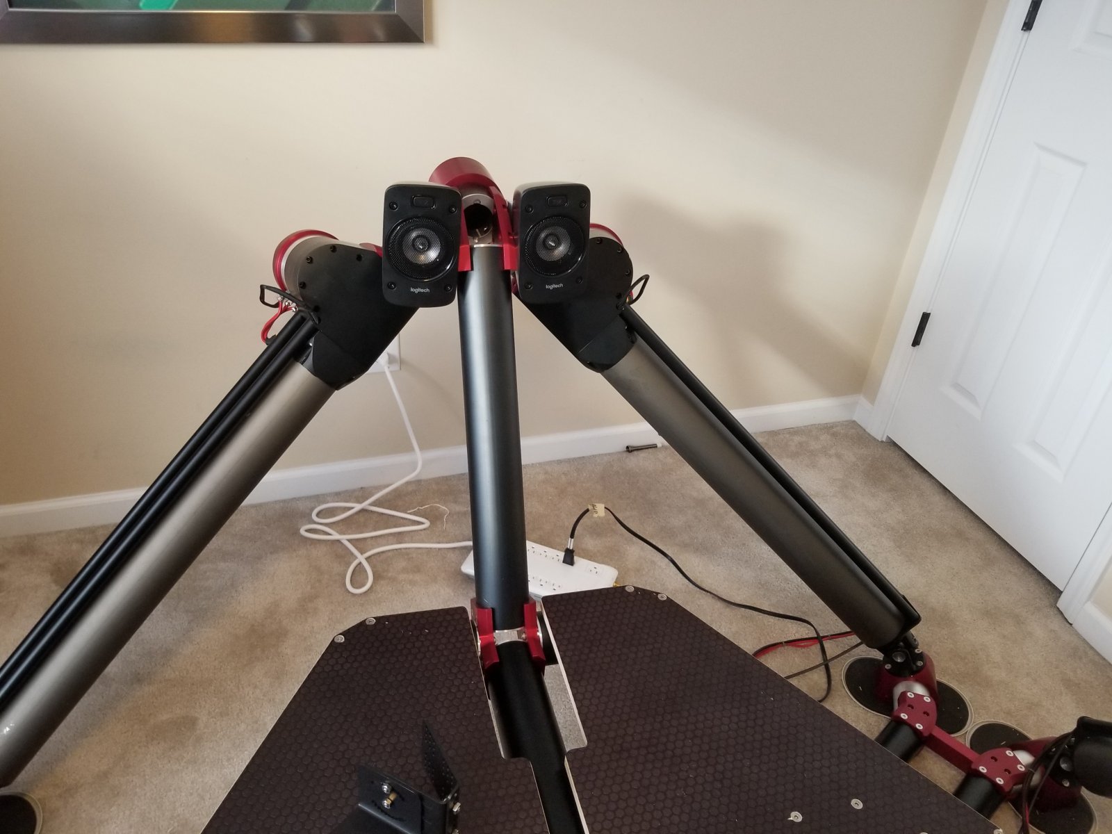

    So made some more progress. These are the actuators and they are massive, you can see my foot for scale. :grin
    Here is the first one on (sorry it a little blurry) . Figured out after this, that it is much easier to mount at the top first then lift up the platform and mount at the bottom. There is a recess in the U joint at the bottom so it will stay in place while you rotate and find the screw holes.
    Here is it with all the actuators connected. this is a two person job but one the first 3 are on, the last 3 are a lot easer. I would say it took about 2 hours to get them all connected
    At this point I started working with simtools. I was able to get the simulatior connected but unfortunately two of the actuators had encoder cables that got damaged during shipment. I was able to move all the other actuators manually through simtools. Jonathan has been very helpful though the setup process and is shipping me out new cables two fix the two not working.

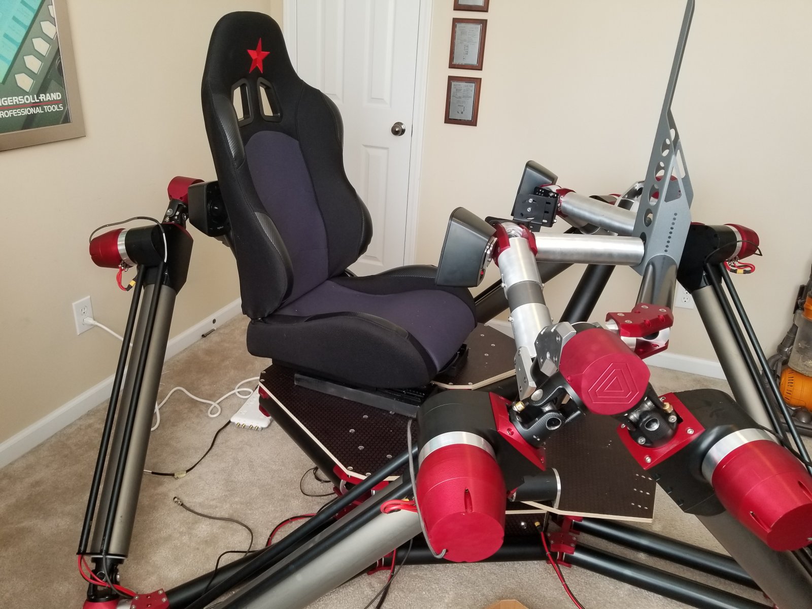

    I had a stationary Ubutto rig that I am reusing the seat from. I like it as it has an adjustable back and I think is more comfortable that a full racing seat. It has a forward/back slider so is adjustable for different length people. The movement on these actuators is insane, easily over 1/2 a meter.:thumbs
    I bought a low profile ceiling fan but I think fully extended I will only have about 2 inches clearance to the top of the screen. :grin.
    That's all for now, once I get the other two actuators moving I will post some video. In the meantime happy to answer any questions.

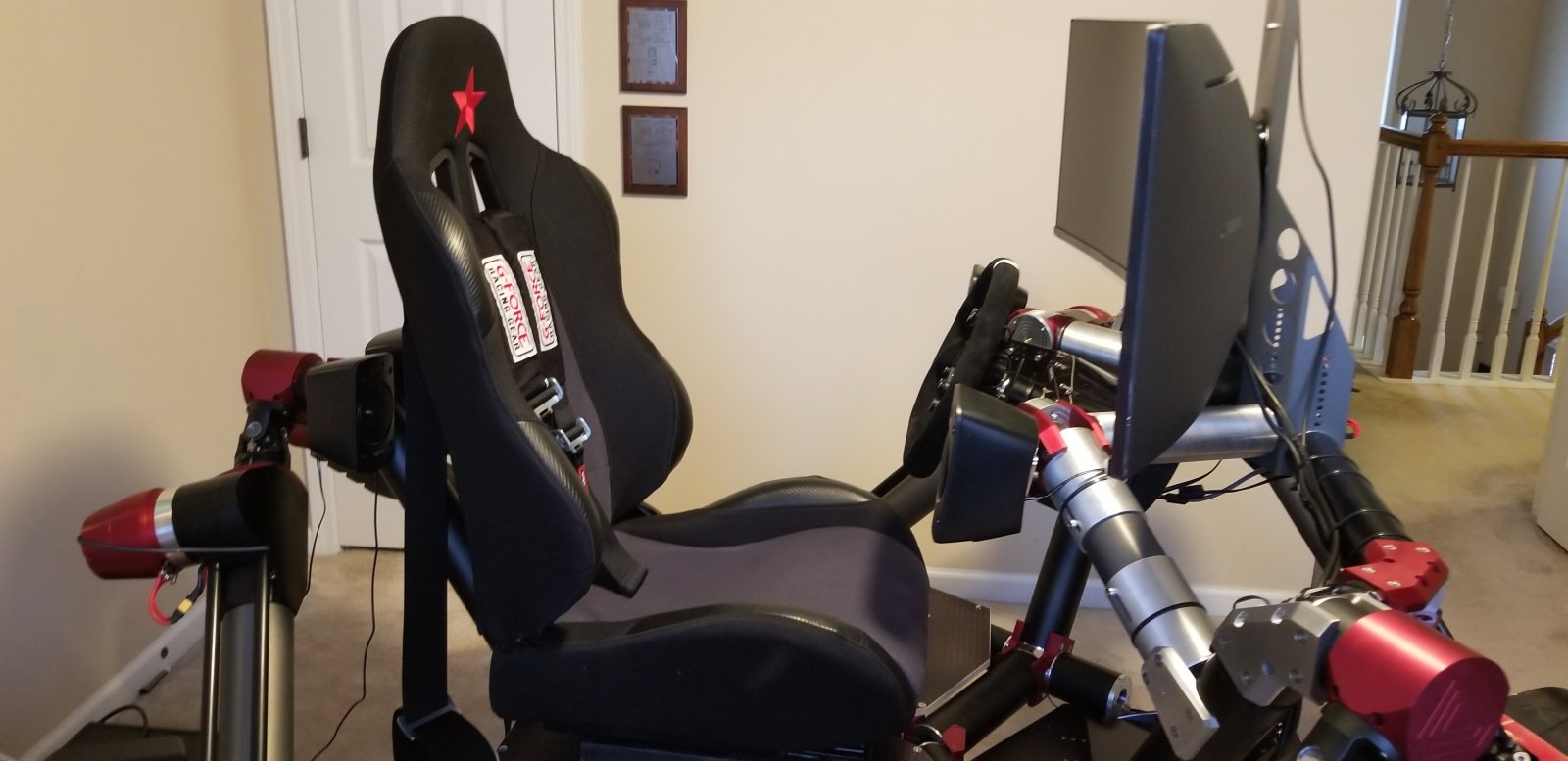

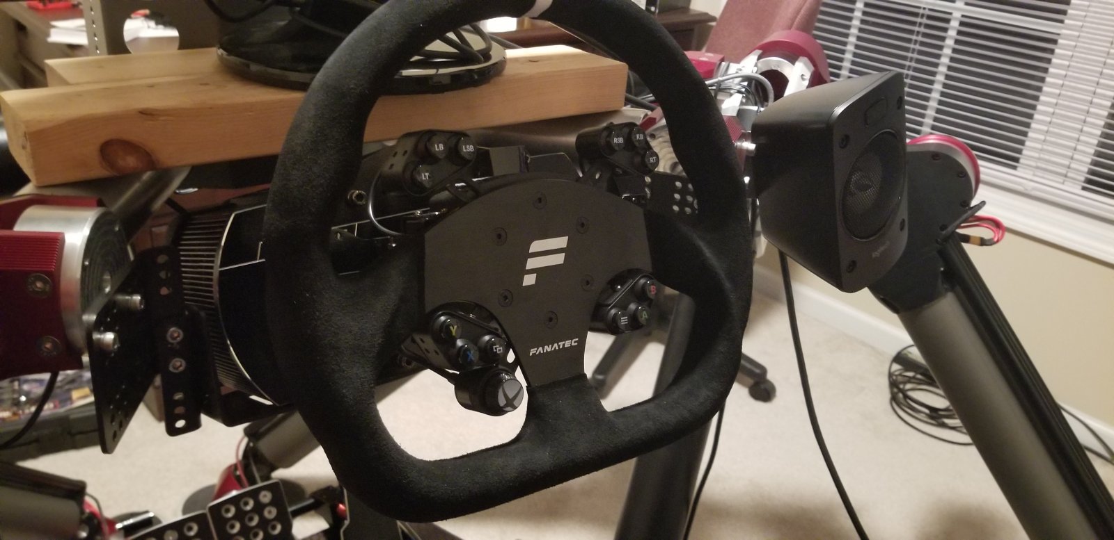

  17. Red_shift
    Sep 2, 2017
    55
    Charlotte
    361Coins
    +52 / 1 / -0

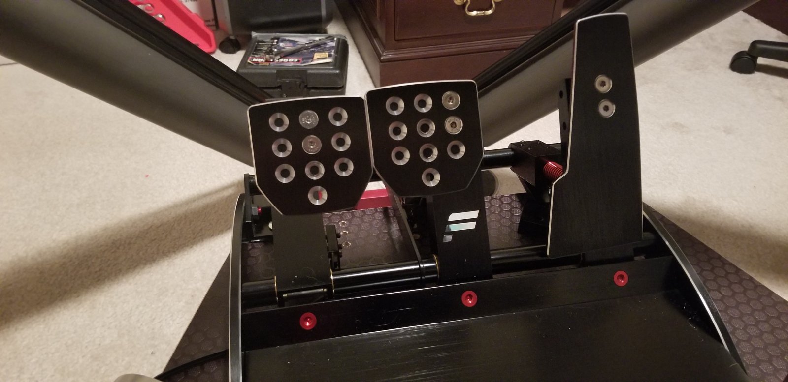

    So while I am waiting for the sensor cables I mounted the wheel and the Peddles. So please allow me to go off on a tangent and rant about Fanatec. So the cable they provided for the peddles was too short and I sent an email asking if they had a longer one available and this is there response in its entirety
    "thank you very much for your enquiry. Unfortunately we have not a 3m version available, sorry. I wish you fast laps and many victories."
    OK so I spend $400 on a set of peddles and that is the best you can do? No, Hey dude this is a standard strait RJ12 cable you can buy at Amazon for $5. nope, just a sorry can't help. These guys are incredible! Also the calibration instructions for the wheel are actually incorrect in the manual! In fact it so bad, that there is a you-tube video (not by Fanatec) that some guy made on out how to do it properly. Anyway back to the regular scheduled program :eek:
    The million dollar Fanatec peddles are not moveable for left foot brakers So I had to make some modification. I off set the peddle set a bit and then created an extension bar to lengthen the break peddle. Had to remove the clutch peddle for this (but who needs that). Anyway here is my creation and I'm back to my go-carting youth. :grin

  20. Red_shift
    Sep 2, 2017
    55
    Charlotte
    361Coins
    +52 / 1 / -0

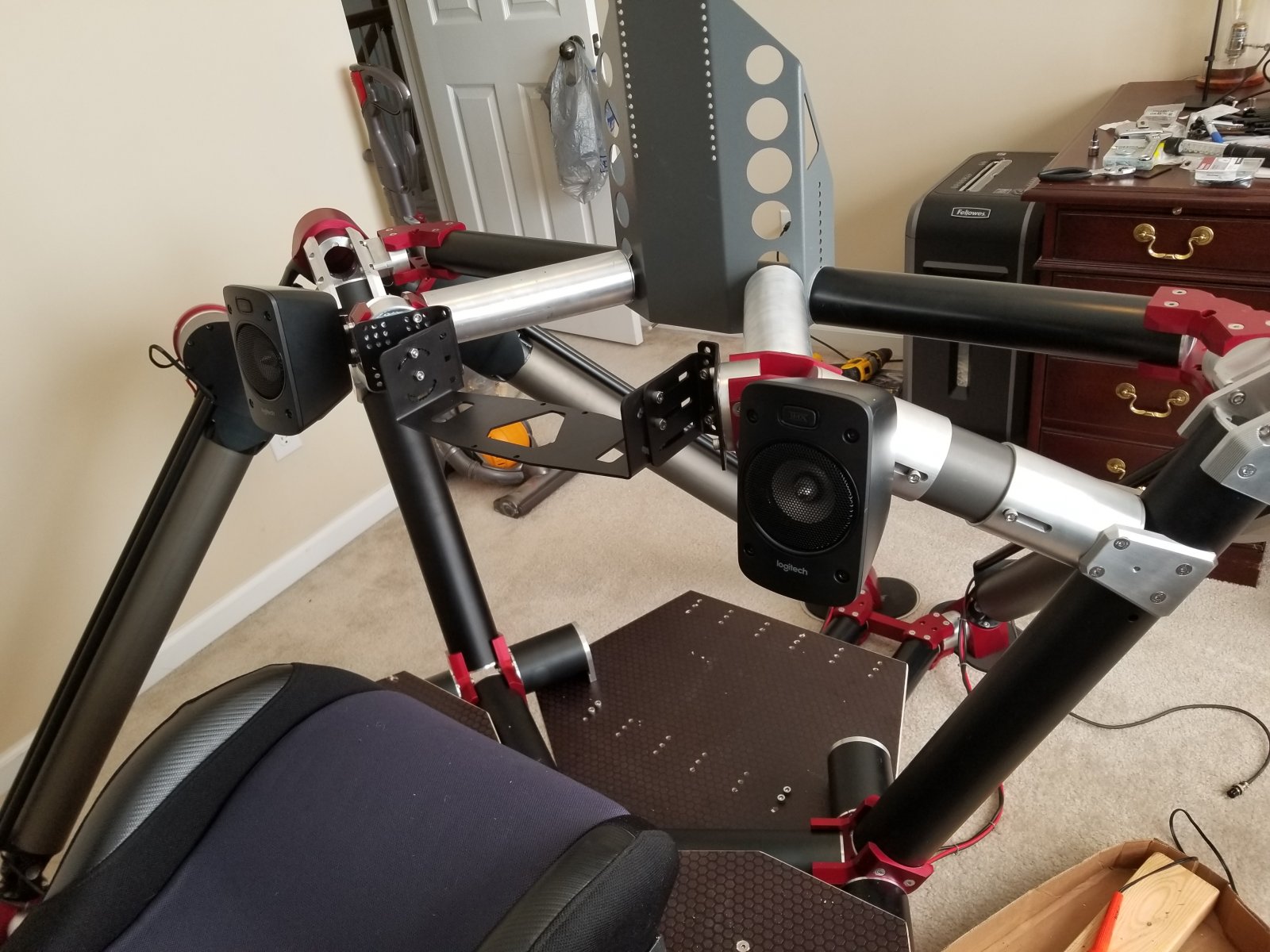

    Sorry its been a while. I have had some problems with actuators sticking due to rotation, so I am waiting for updated parts that will fix this issue. I am expecting them to arrive in the next couple of weeks and once I get everything retrofitted and working I will post some video. Even thought I have had a few teething issues, I have to say that the support has been very good. Below is a picture with the screen fitted.
