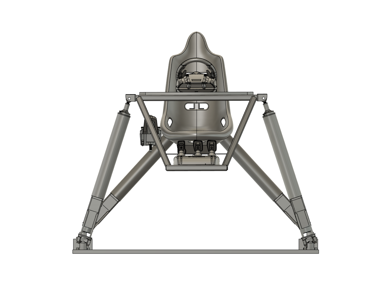

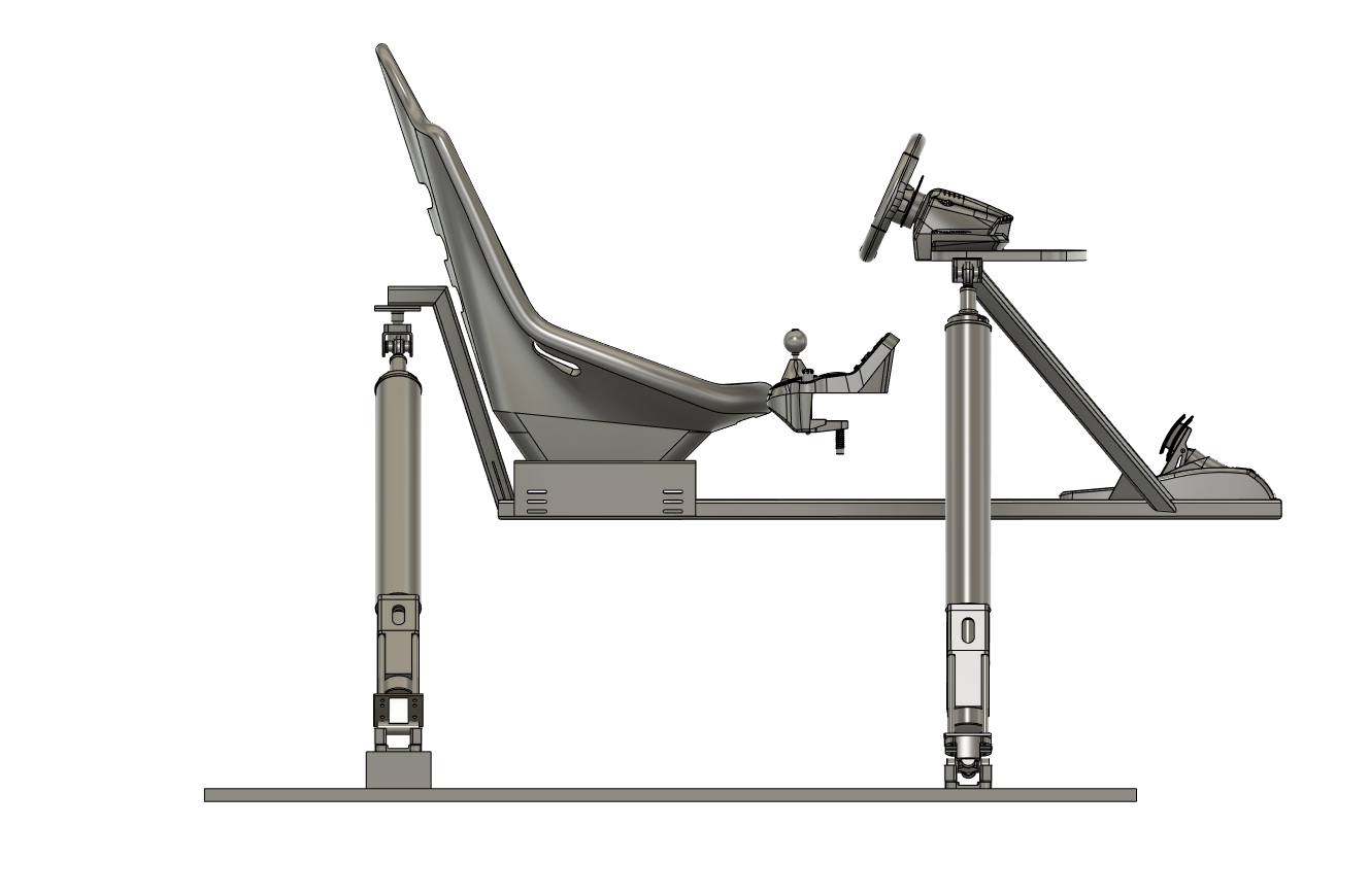

    4DOF
    These actuators are based off of designs for 6dof setups but I don't see why they cant be used for 4dof. My hope for the project is to be able to build a 0dof and add actuators and climb from 2dof to 4dof to 6dof as funds become available. It is a little tricky but playing with rig geometry will be key during each phase. I will have 3D models in the coming days to show what I mean.

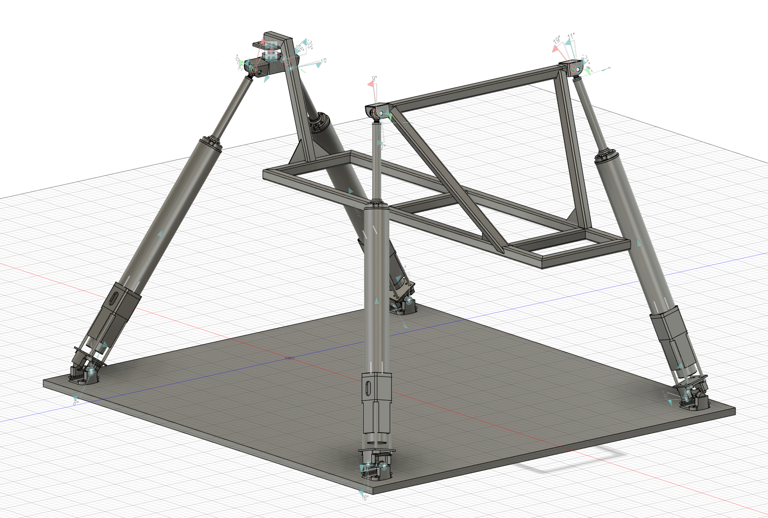

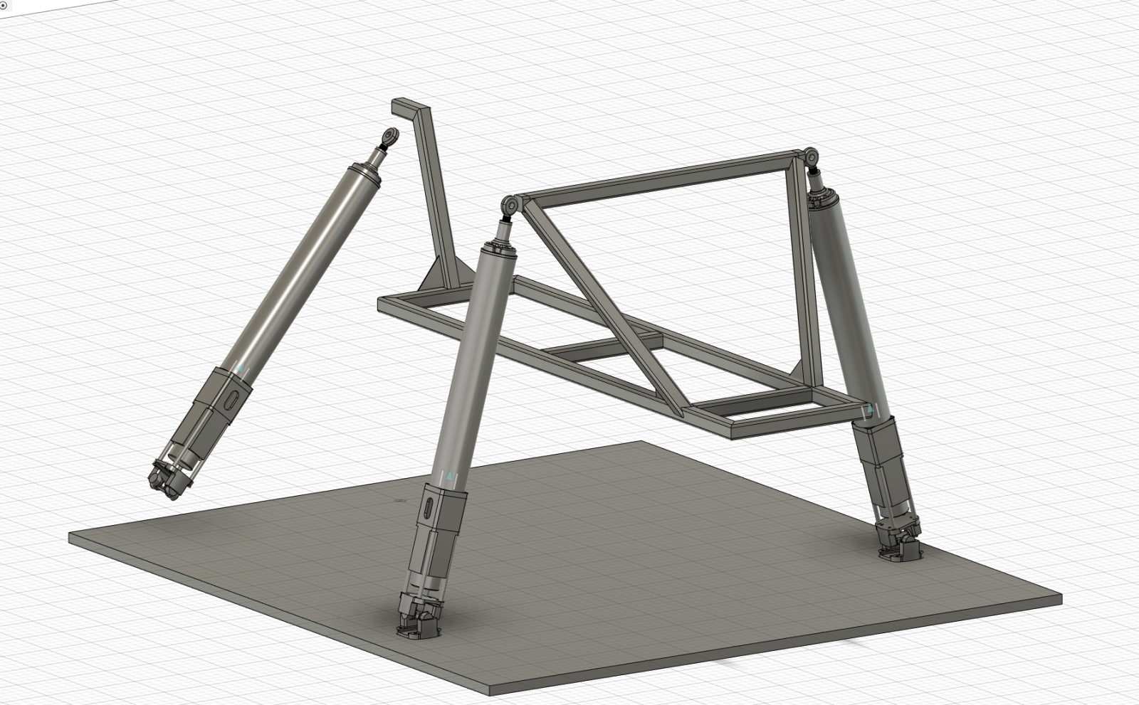

    I've been leaning how to make constraints and now I am finalizing the dimensions for the base and geometry for the actuators. Here is a progress pic of the frame

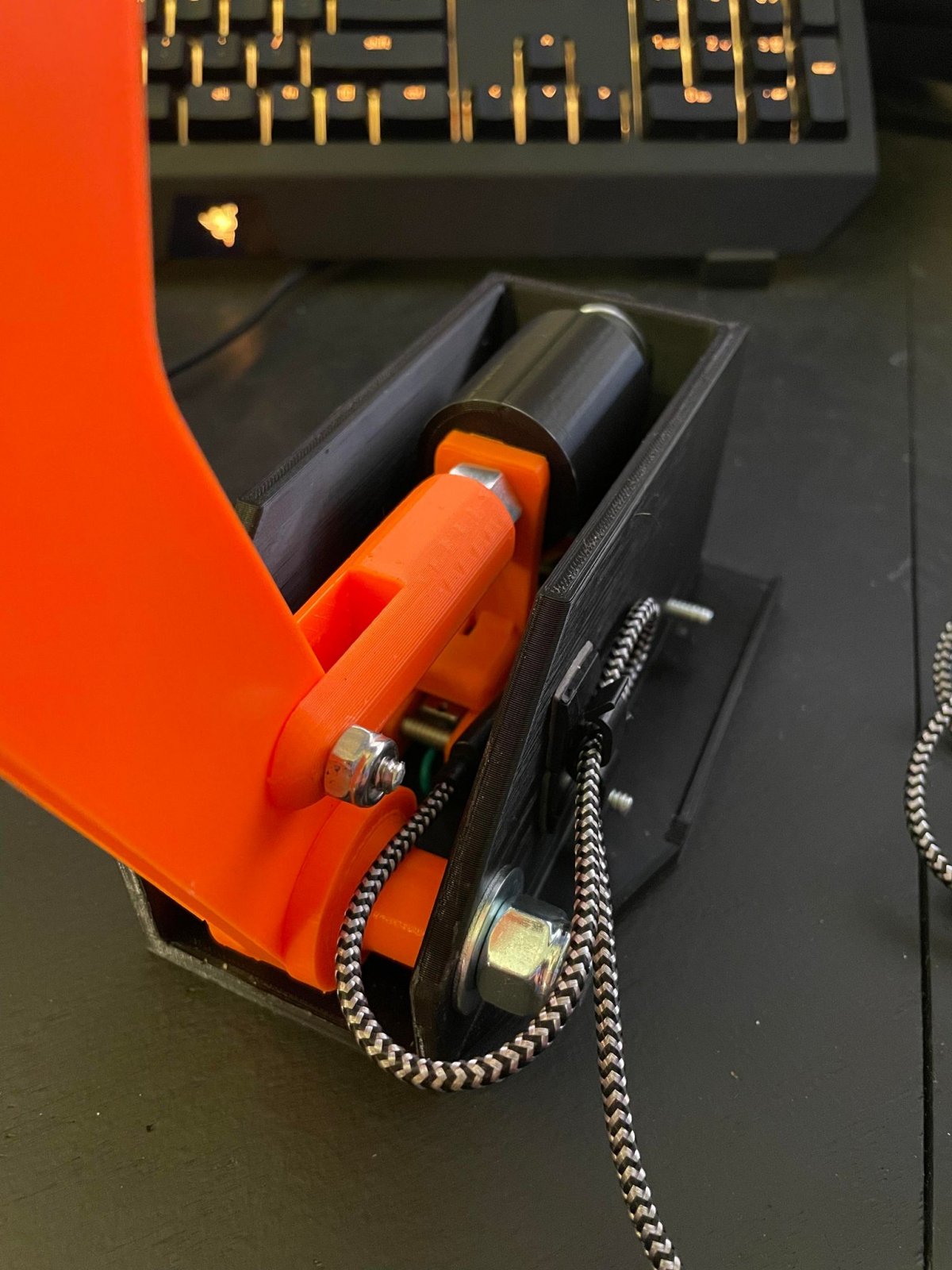

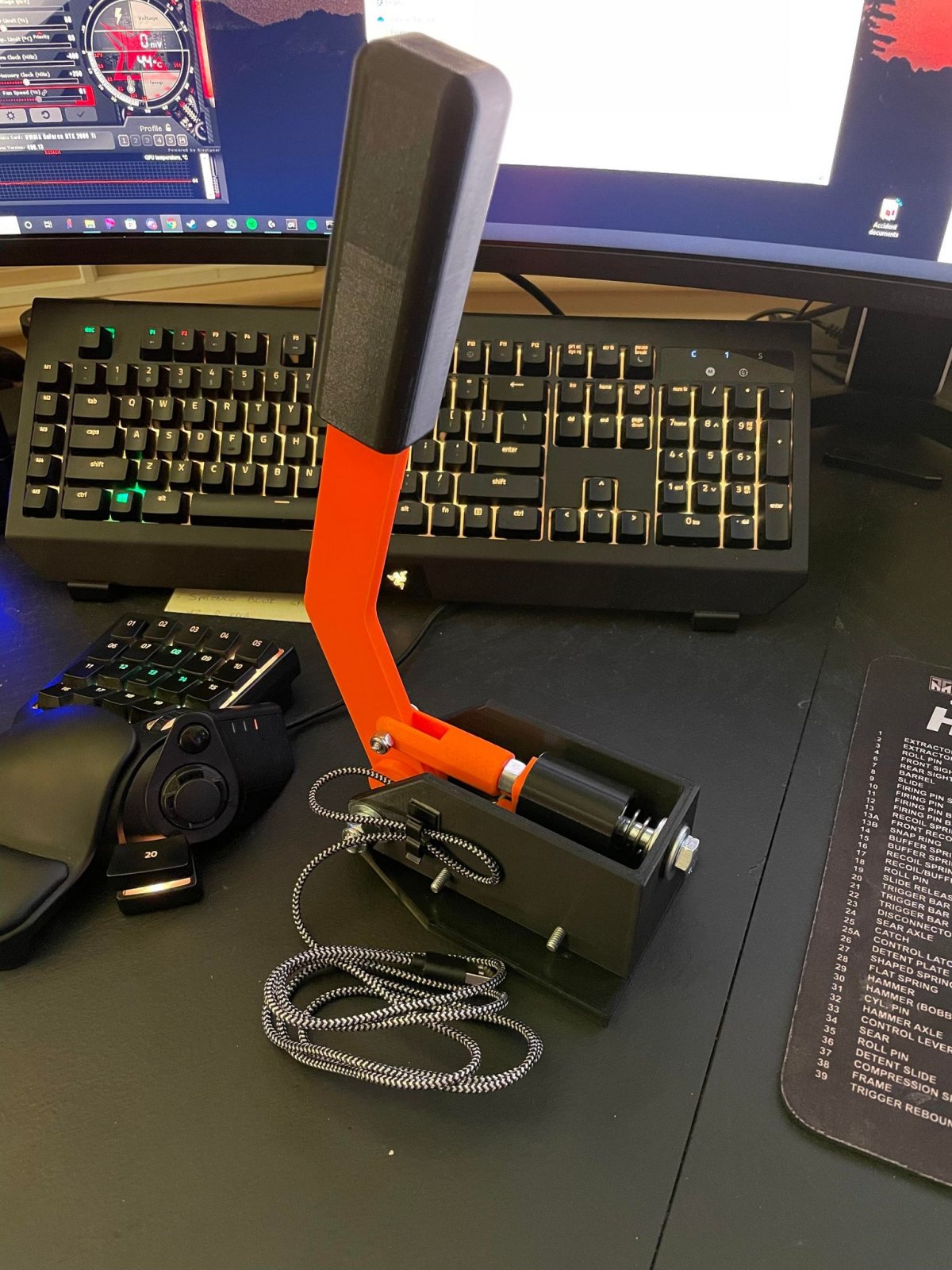

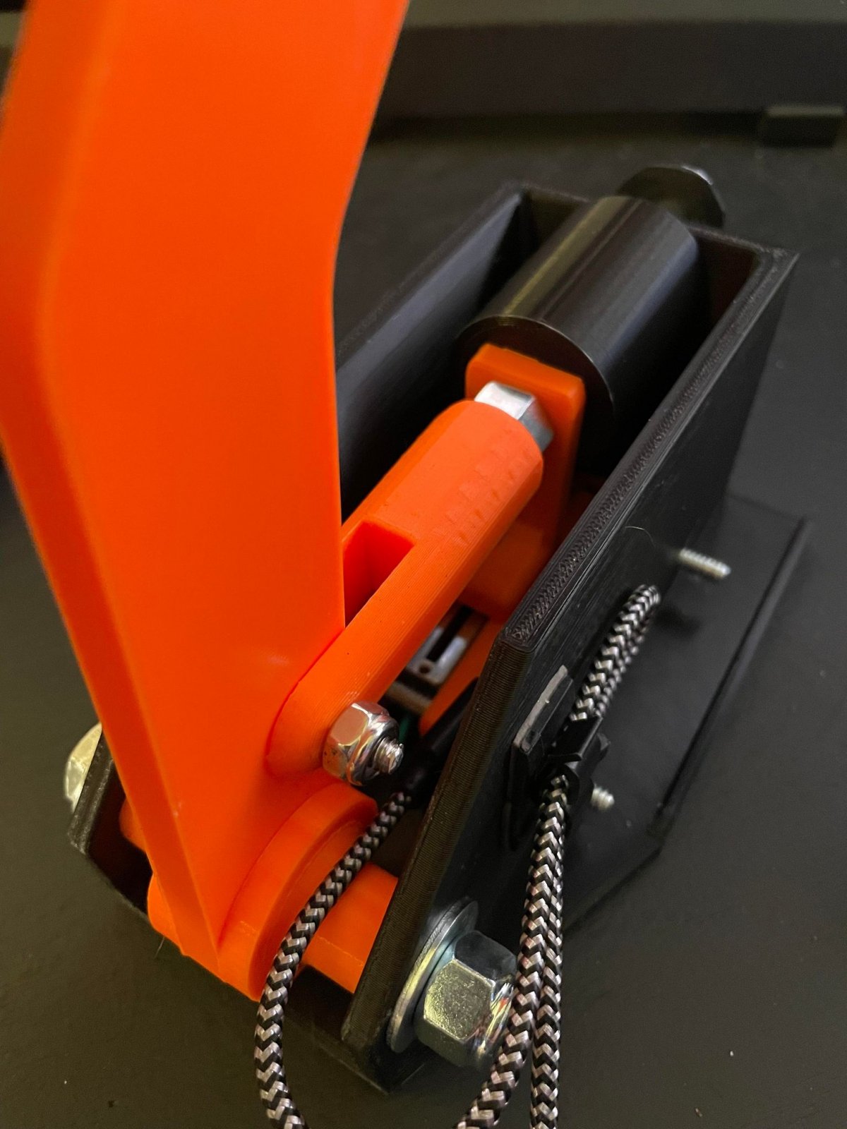

    Not much physical progress has been made, but I have been learning a lot and doing smaller projects. Work should be slowing down in the next two weeks. So I should be able to weld the frame, the base, and machine the remaining components that I need for my actuators.
    I did just complete a DIY hand break to install in the rig once its done haha.
    I will be sure to post some pictures and videos in the coming month as I get the rig assembled for the first time. Stay tuned!

    This is a very nice design. I'm looking forward to seeing it progress. If the rest of the build is the same quality as your handbrake, you're going to have a beautiful rig.
