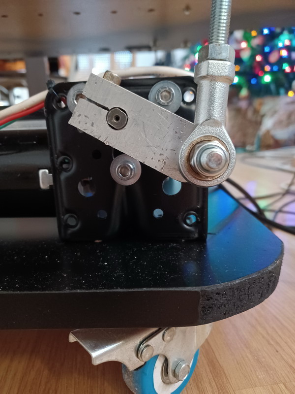

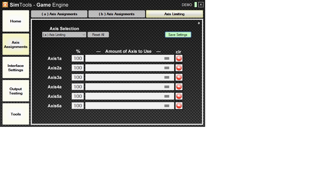

    Hi everyone, here's another question. How can I give the engine more stroke because going to the max I only have the displacement that can be seen in the picture
    even if the values in Simtools are max ...

    You can set the range in SMC3 with the Clip and Max Limits, but keep in mind over about 38-40 degrees up and down effective use of torque rapidly drops off:

    hi noordbeast thanks for the immediate reply, so the adjustment you do on SMC3 is managed on simtools ...?
    So I can only increase the leverage for more displacement.
    21,580
    151,094Coins
    +11,028 / 56 / -2
    SMC sets the available range, SimTools allocates that range between various axis.
    But as I said, keep in mind to not overload a motor, as it is diminishing returns when increasing the range of levers, which can end up putting necessary strain on a motor.

    what interval do you recommend to use

    If you want max range of motion, you can set "max limits" to 0 in SMC3 Utility tool and "clip input" to around 40. However, please change these settings gradually and watch out for binding.
    As noorbeast suggested, best to keep the angles between +/- 45 degree max.
