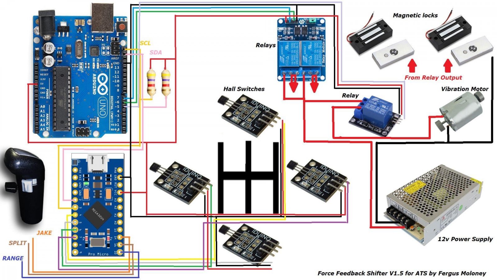

    Changed a few bits since I last posted so I’ve redrawn the schematic. I’m now using magnetic locks and contactless switches.

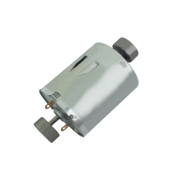

    I’m finding this shifter is working well apart from the vibration effects of gear grinding. The vibration motor I’m using is a bit anemic for the mass of the stick.
    I’m thinking either an actuator connected on a parallel pivoting axis to physically move the stick in my hand or switching to a transducer. Can anyone suggest a suitable transducer or motor/potentiometer/driver combo that might work? I have a few wiper motors but they are too bulky for this application.
  3. Gadget999
    1,988
    12,132Coins
    +492 / 11 / -0
    Try adding a larger out of balance weight to the end of the motor

    Sharing the Arduino code I've used for the Micro and Uno boards:
    The Micro (seen by windows as a game controller but also communicates with the Uno over i2c);

    The Uno board which interprets game data and data from the micro to control 3 relays and in turn power the electromagnets and vibration motor;
