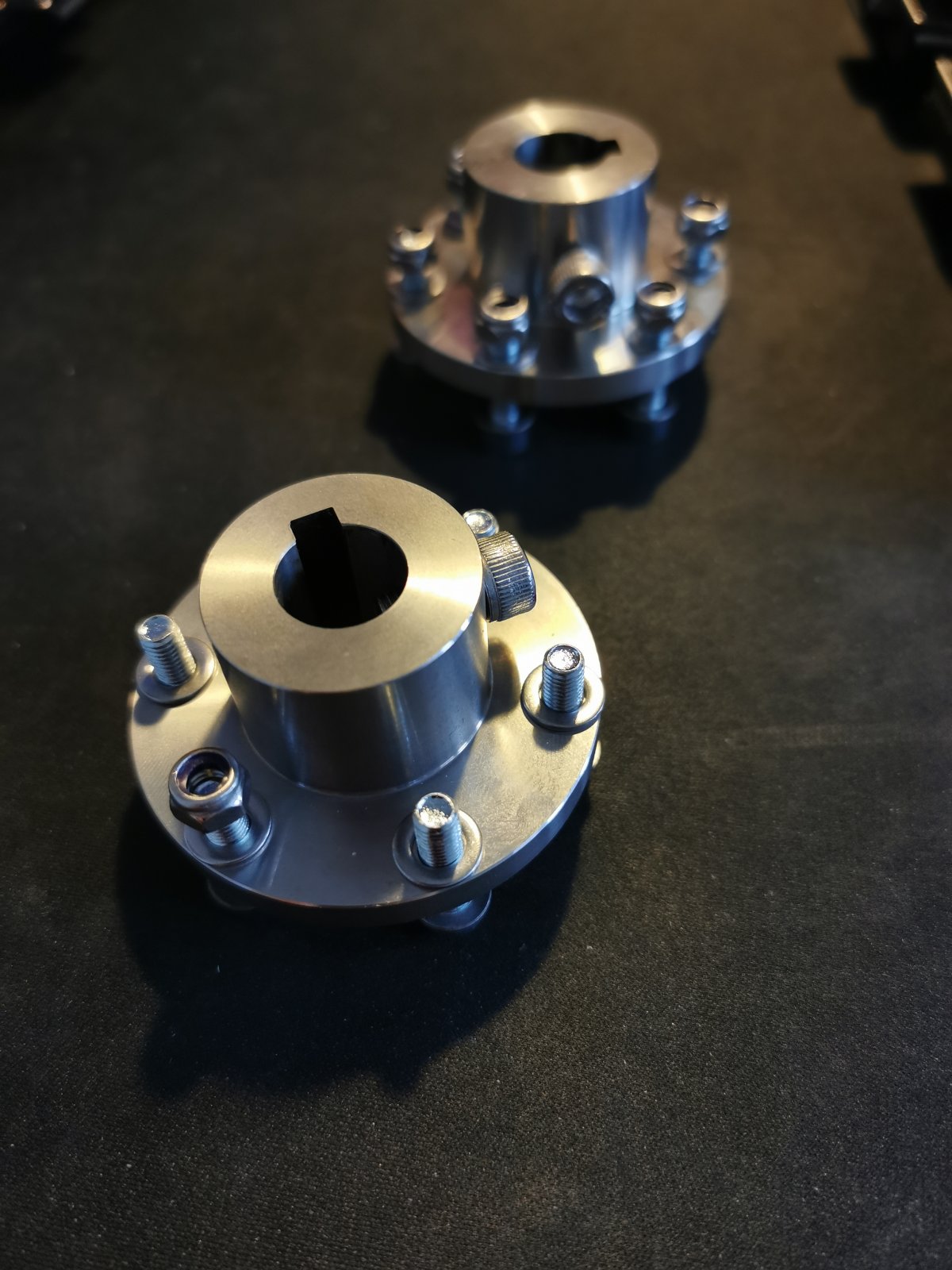

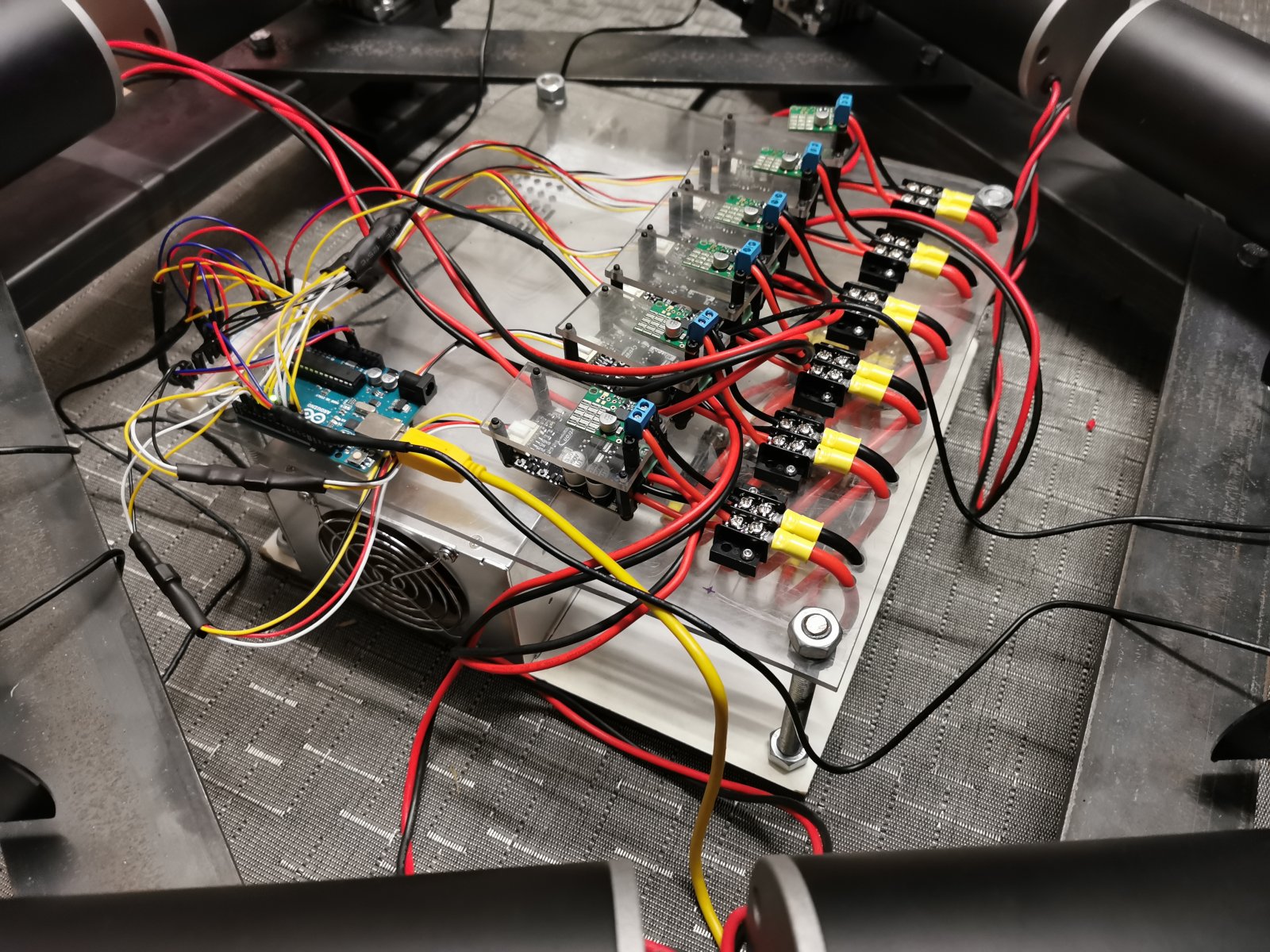

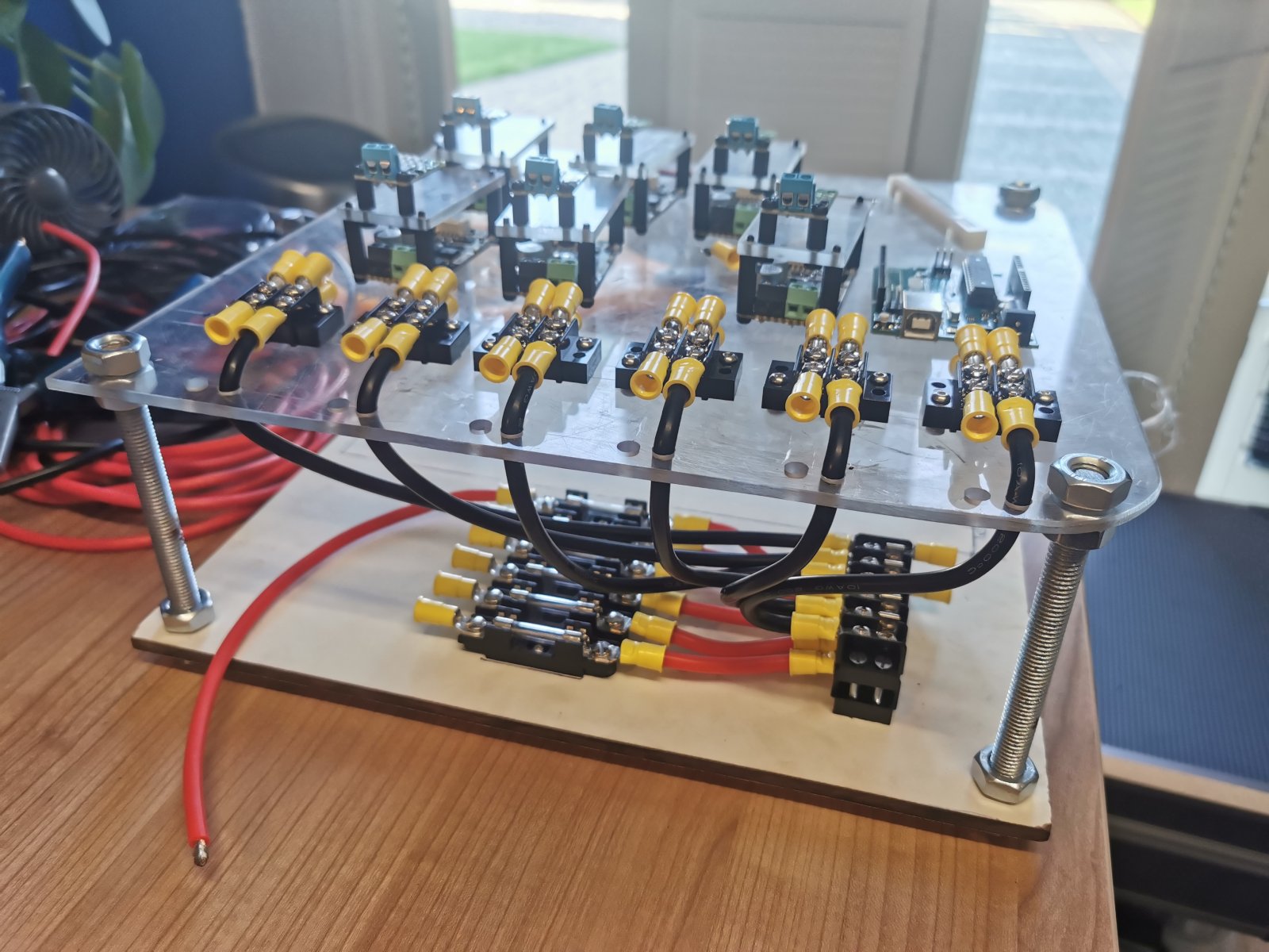

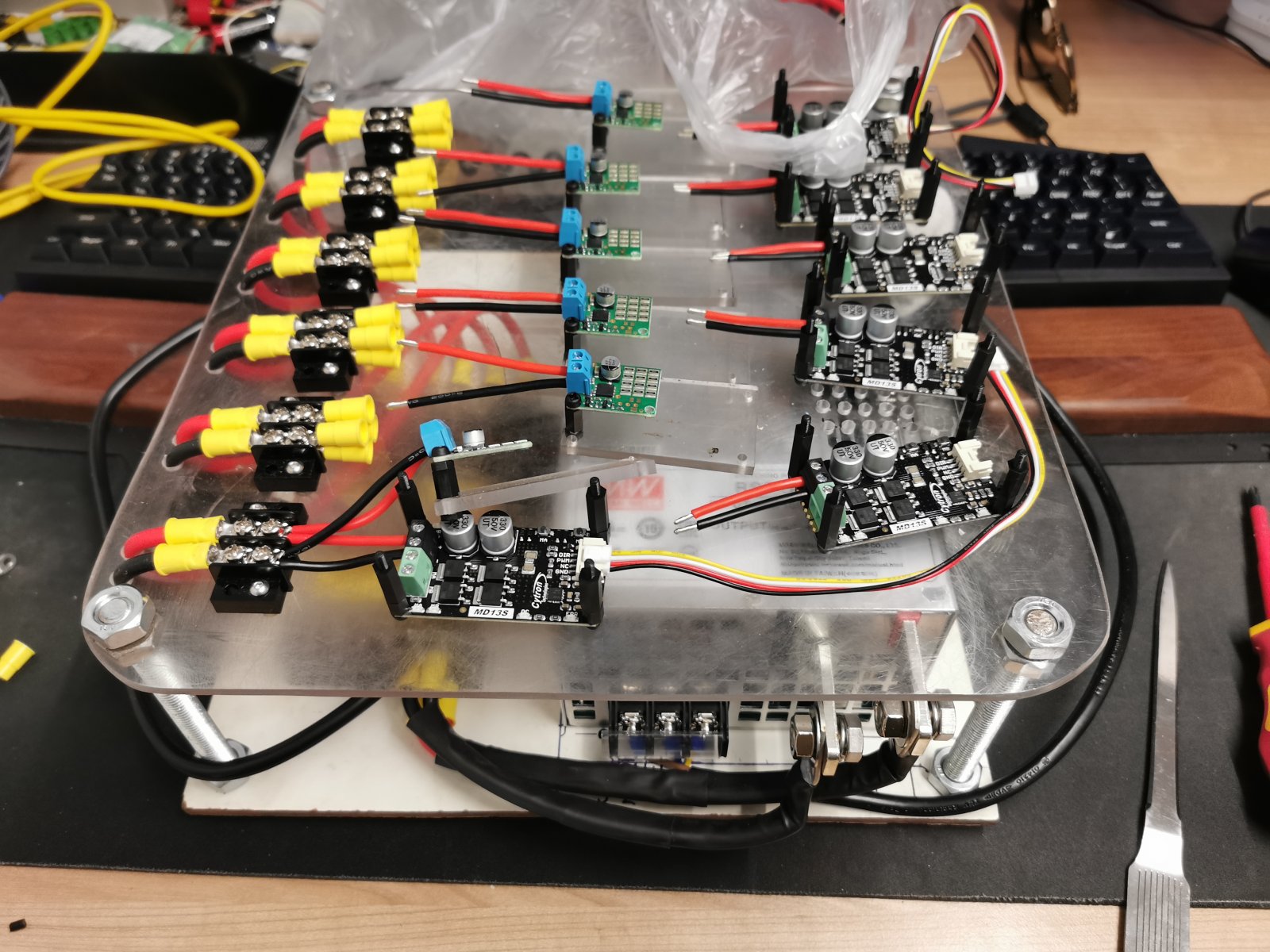

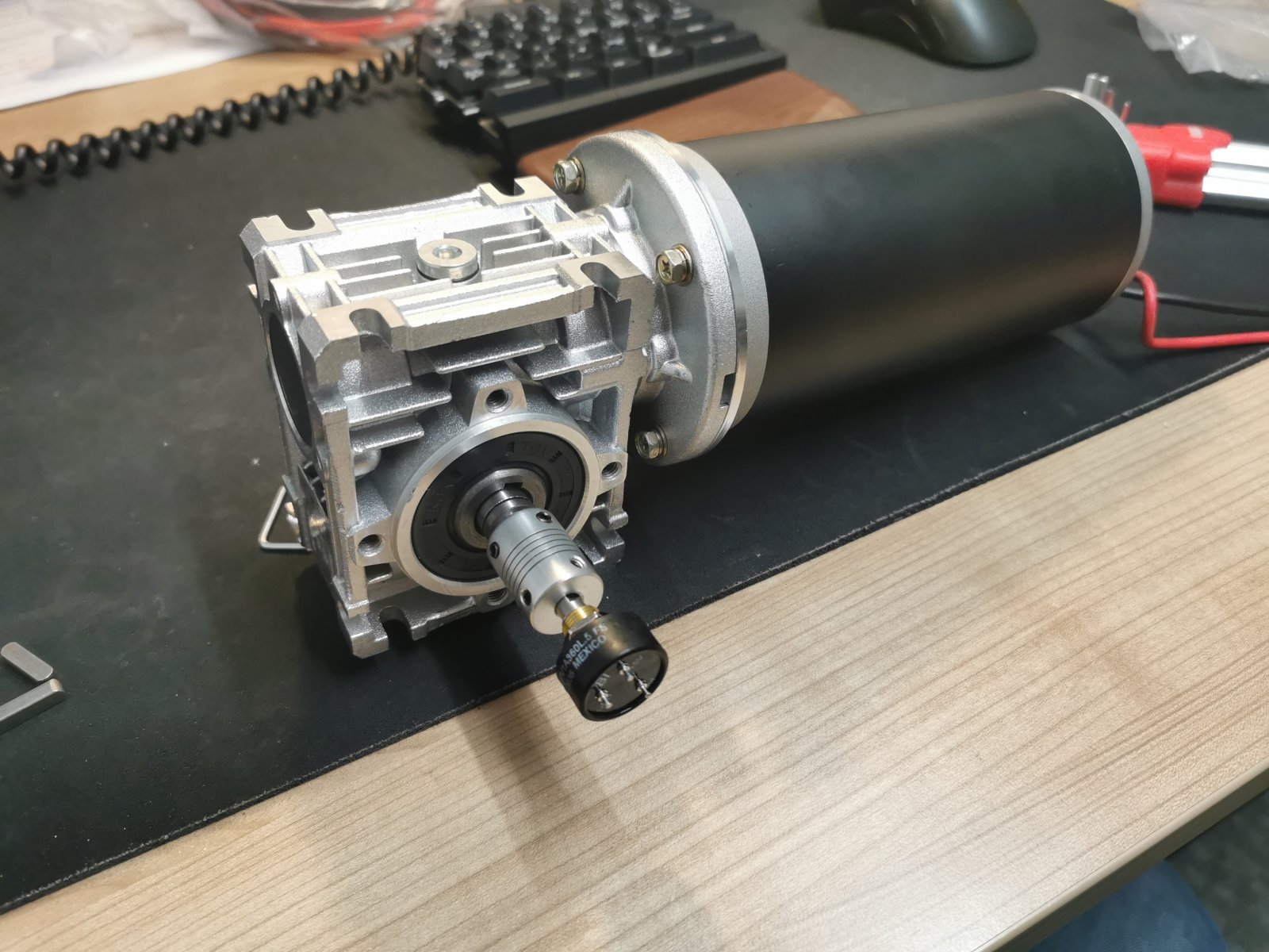

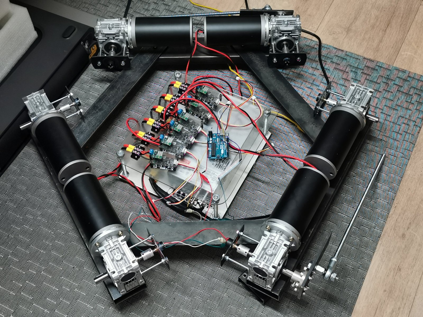

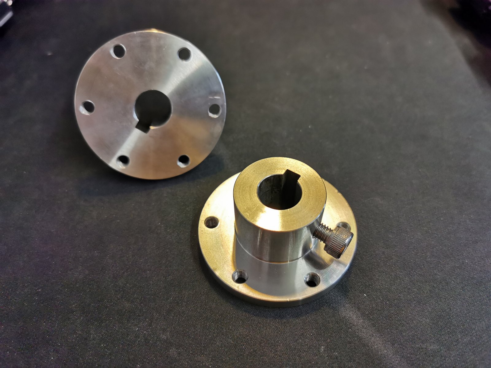

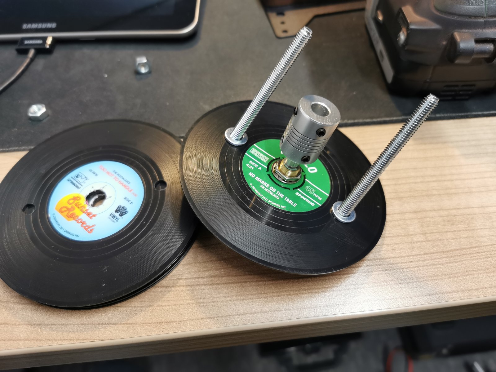

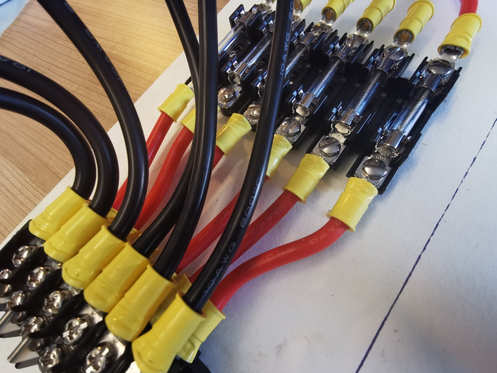

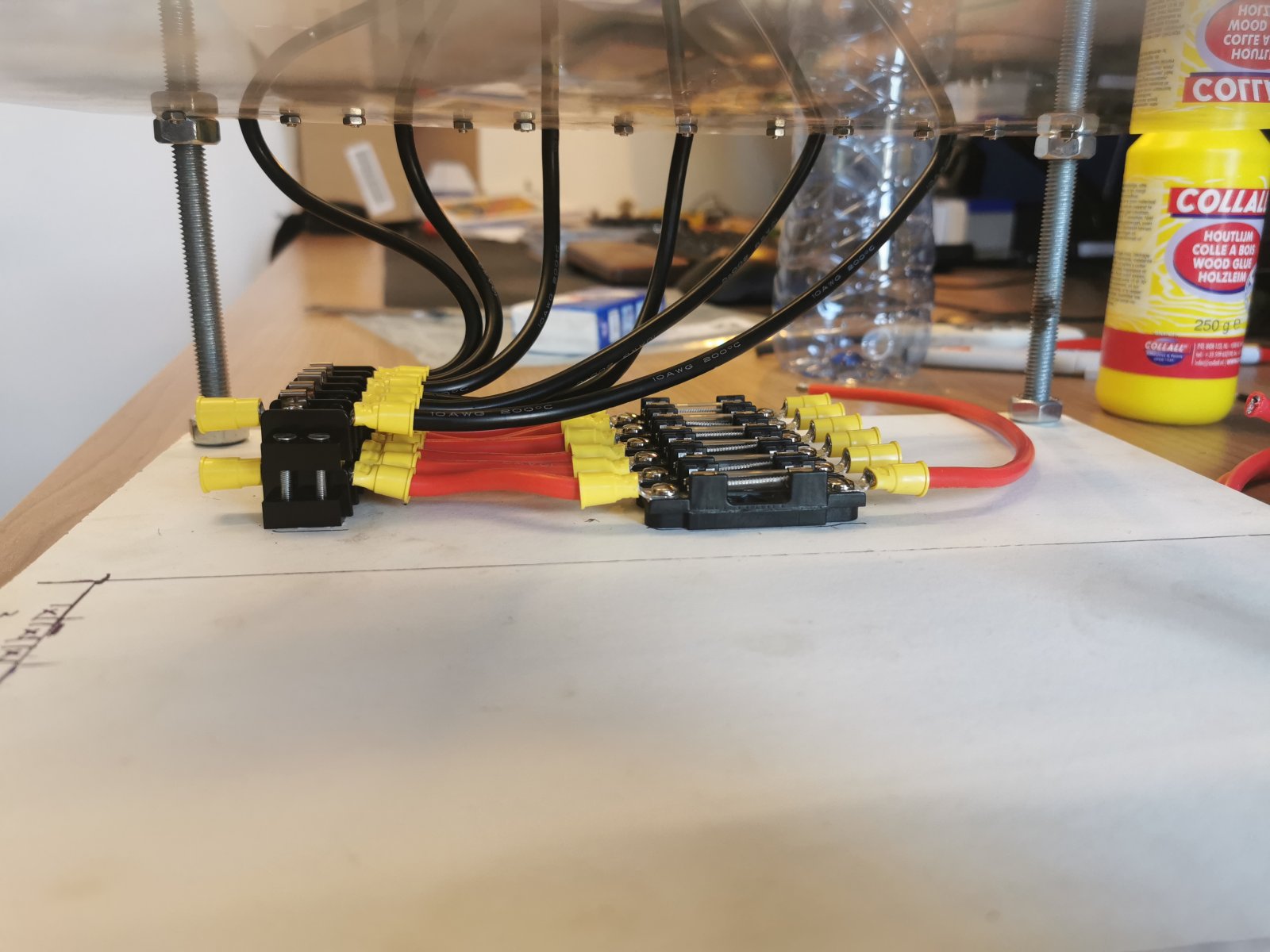

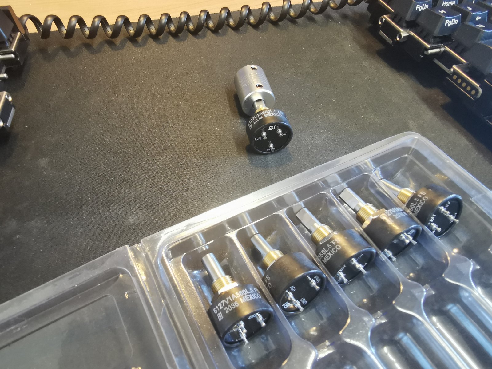

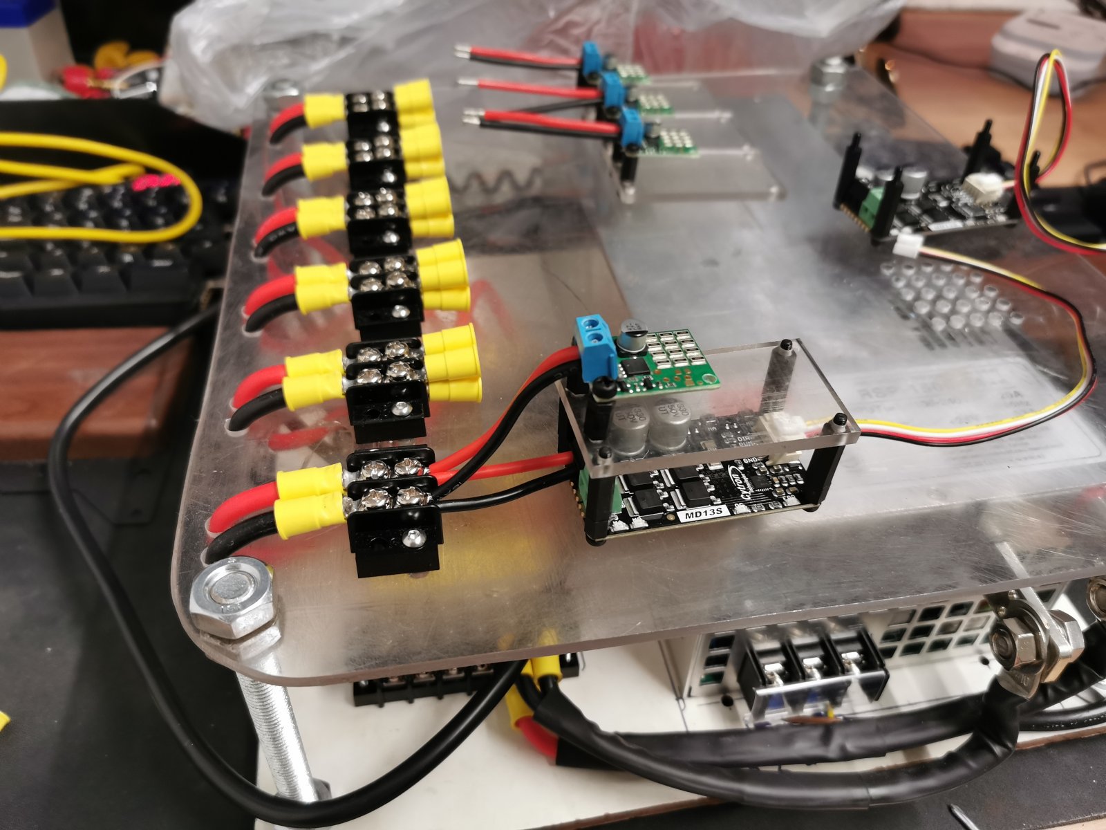

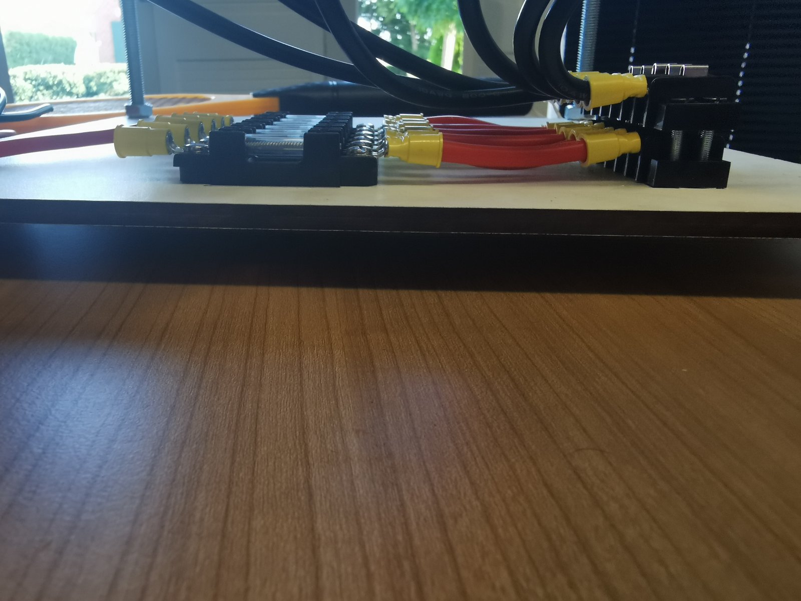

    Just in: 360° hall sensors, they fit my couplers perfectly, which will be mounted directly on the backside of the customized shaft. :) I have no levers for the shaft yet, but have a friend that can probably design and cnc this at his company. But that's for a later time.
    I also made some progress on cabling yesterday. I must say I underestimated the work/time this takes. But it's coming along nicely.
    IMG_20200921_160839.jpg IMG_20200921_160931.jpg IMG_20200921_160952.jpg IMG_20200921_161120.jpg

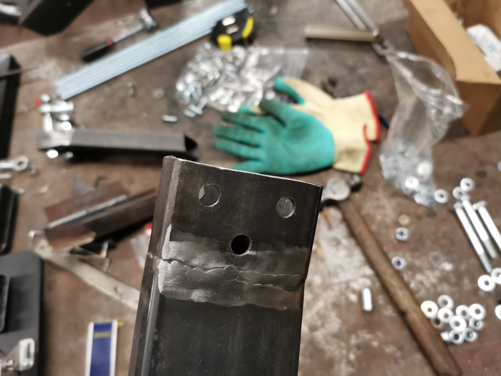

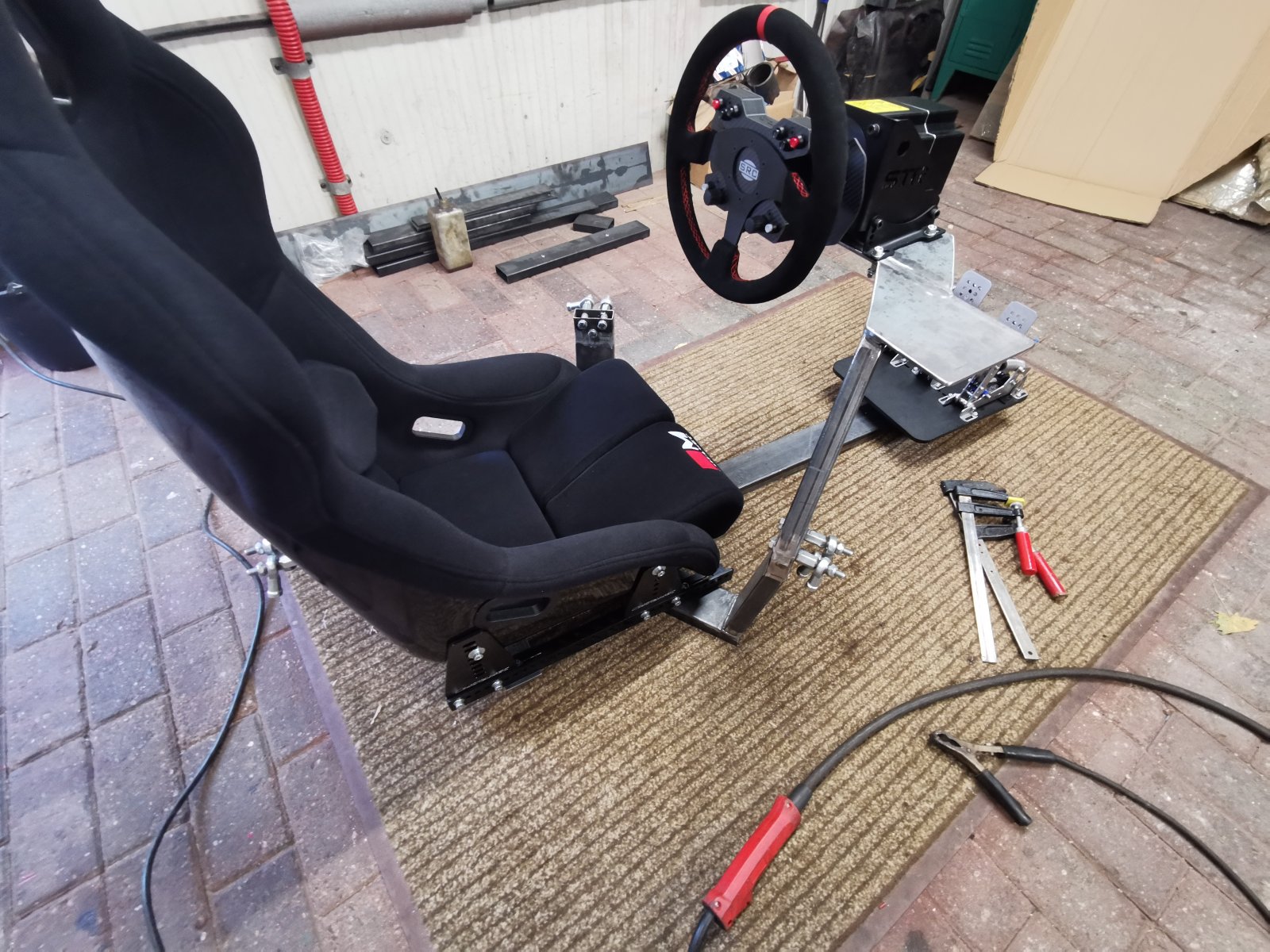

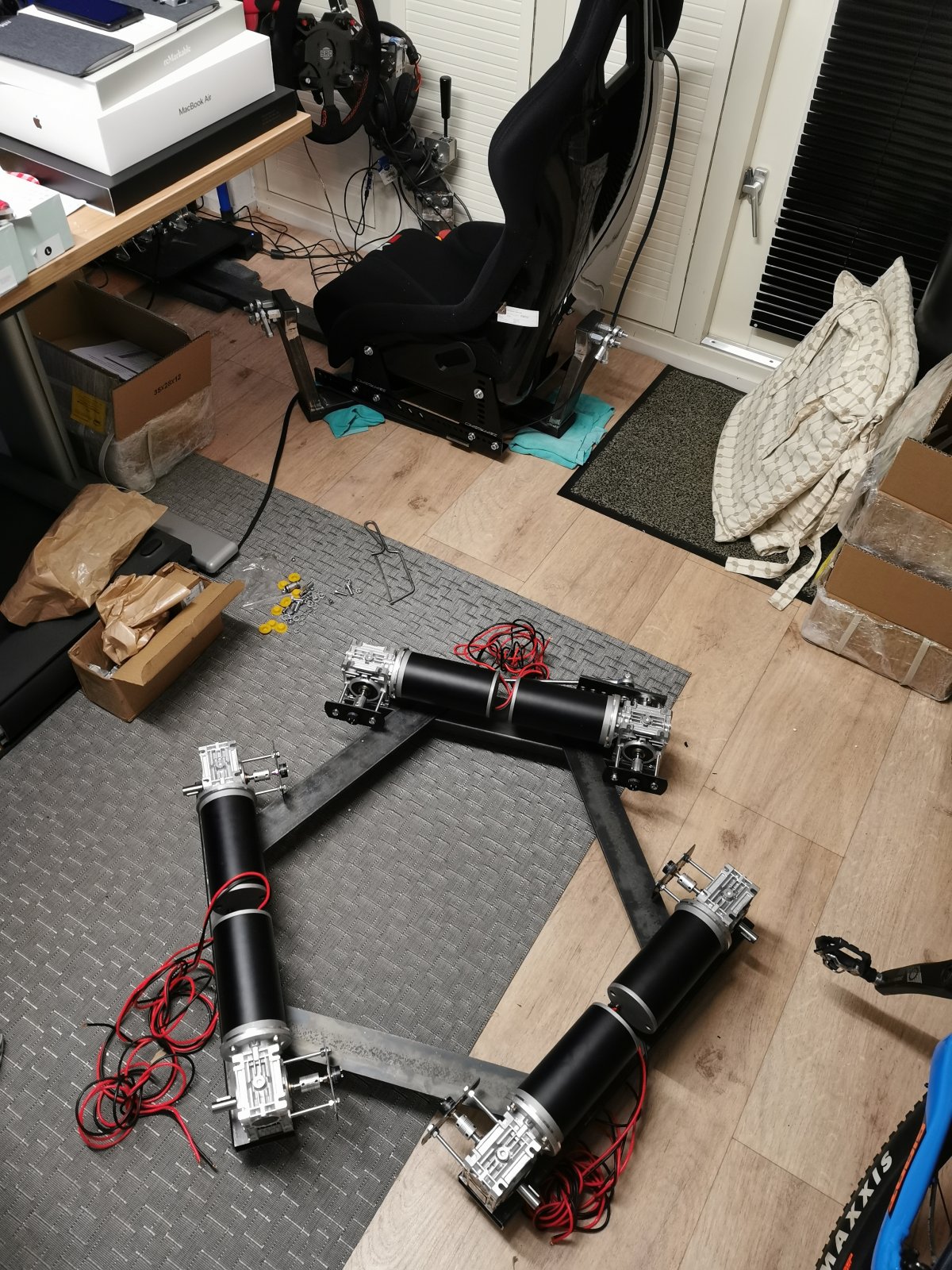

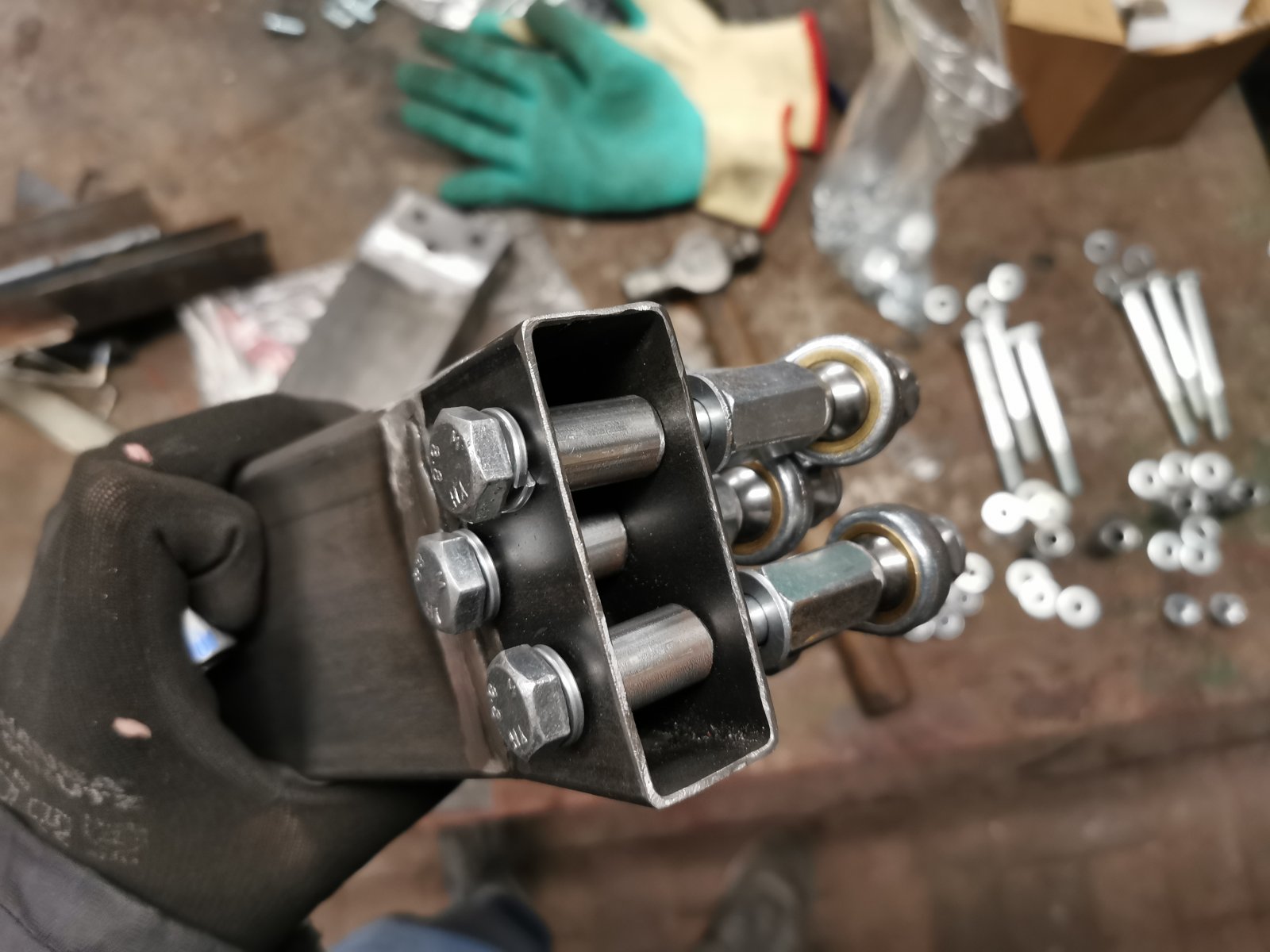

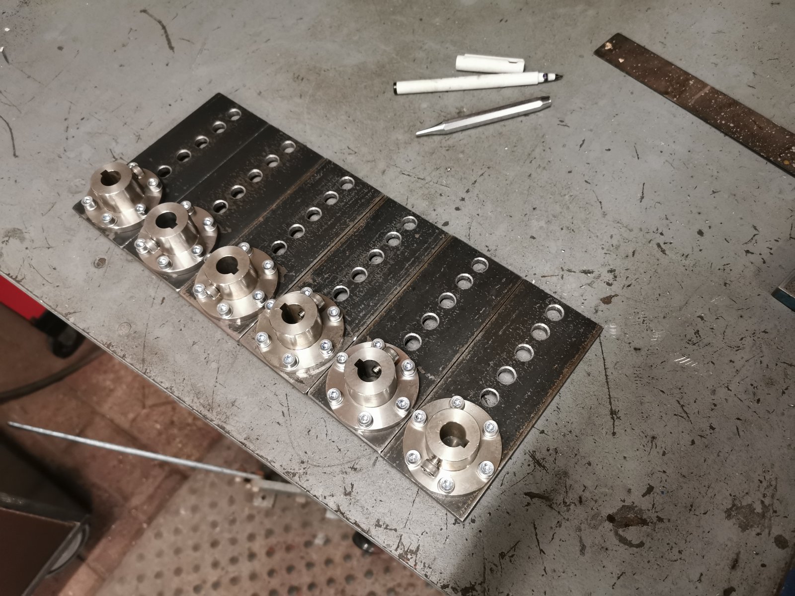

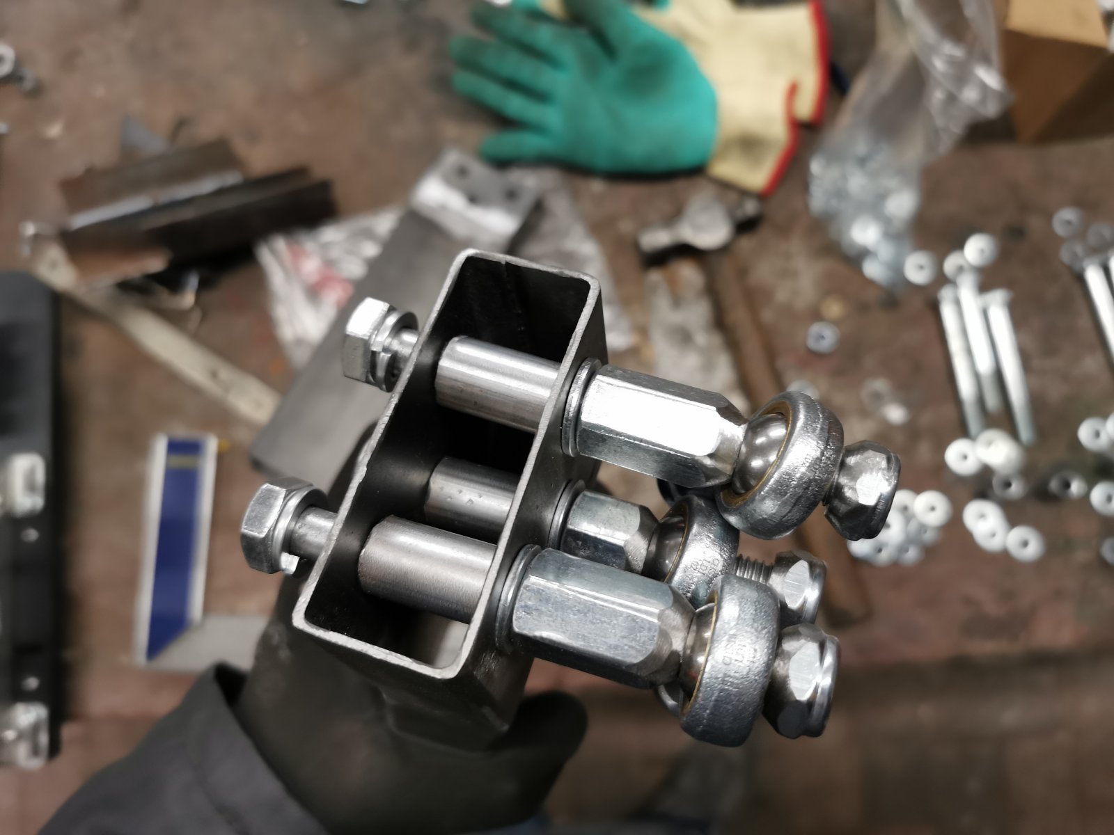

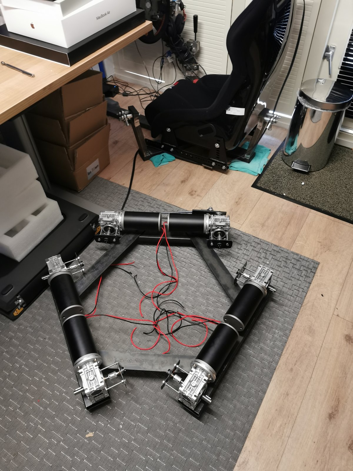

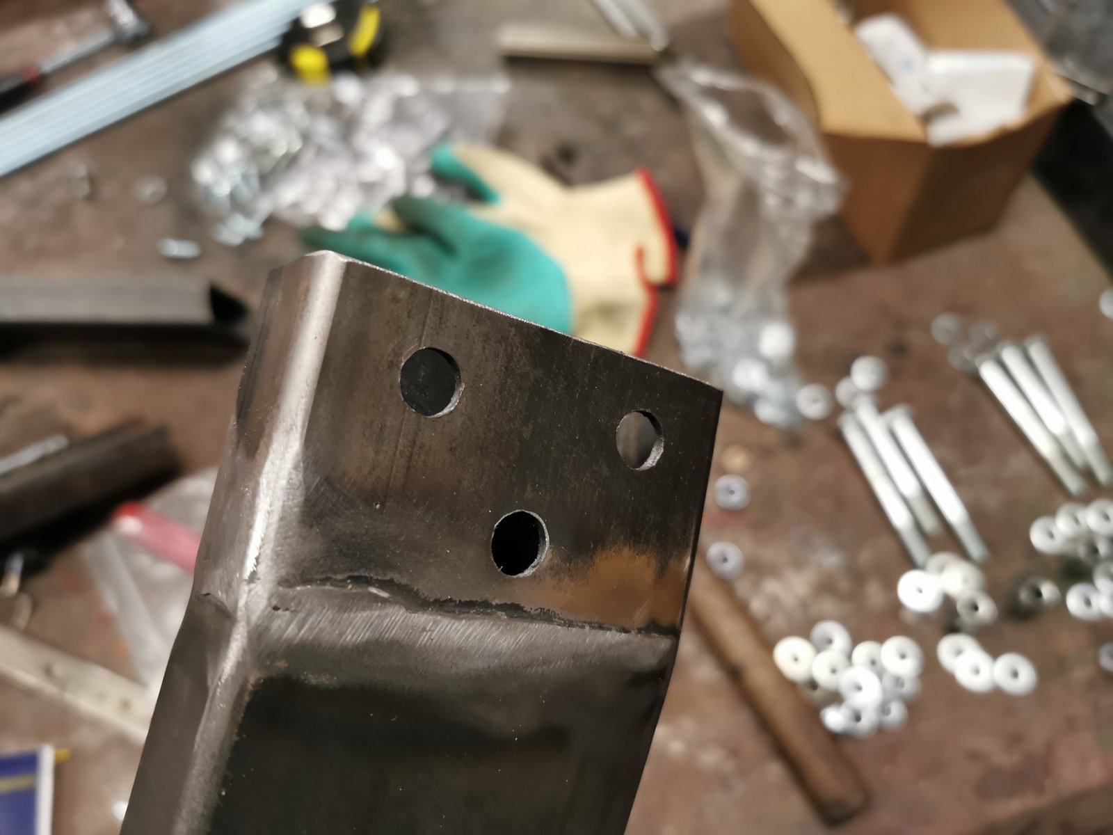

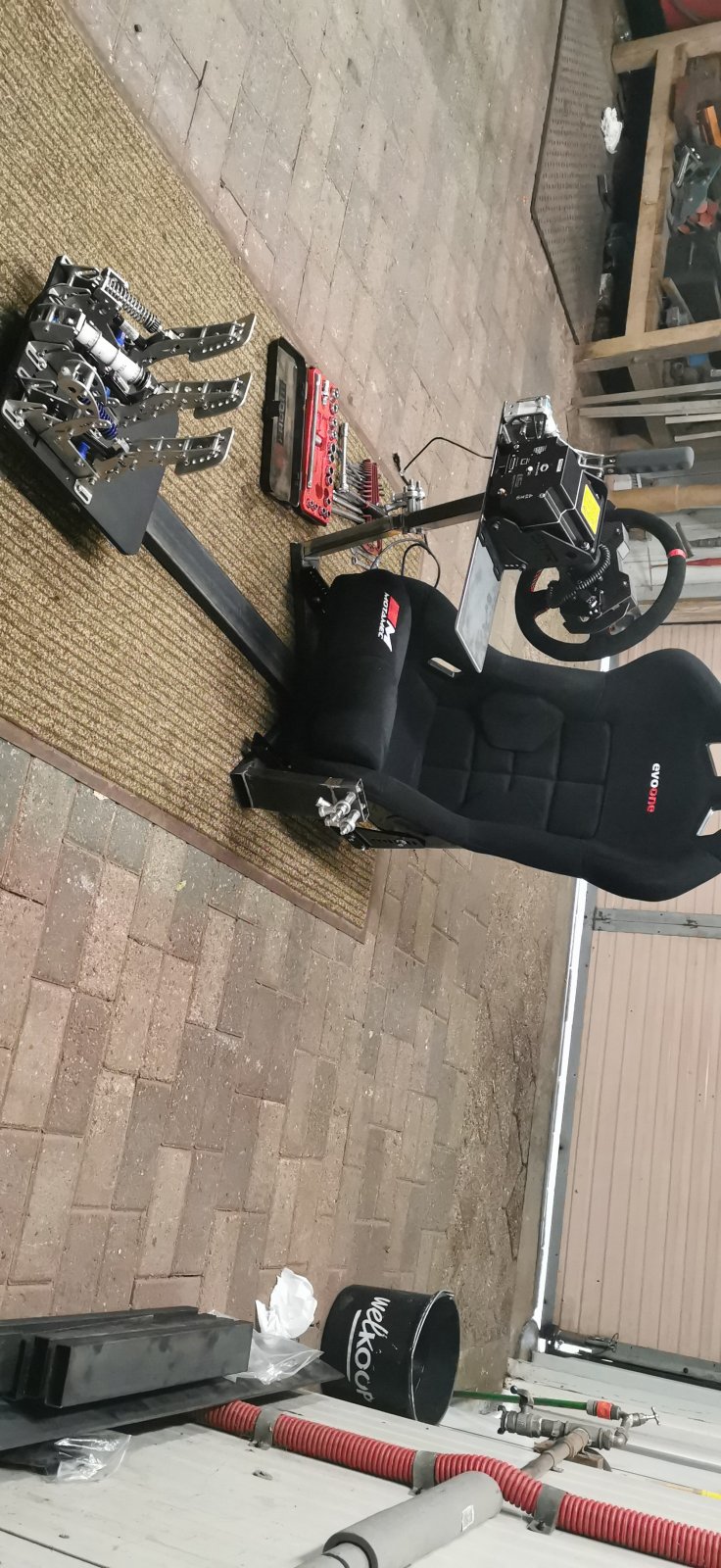

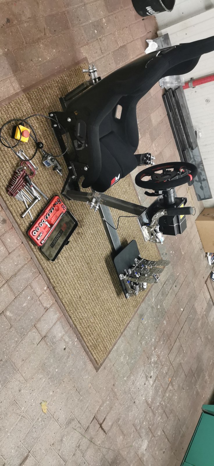

    Still haven't received motors... (after 2 months of ordering). I had contact with Sunrise motors. And they asked me to pay another 90 dollar for shipping due to covid or something. They said that the motors are now finished and ready for shipment. I have paid the extra 90 dollars. But honestly I am not happy with the way they do business since their terms stated that the motors would be shipped within 25 days after first deposit.

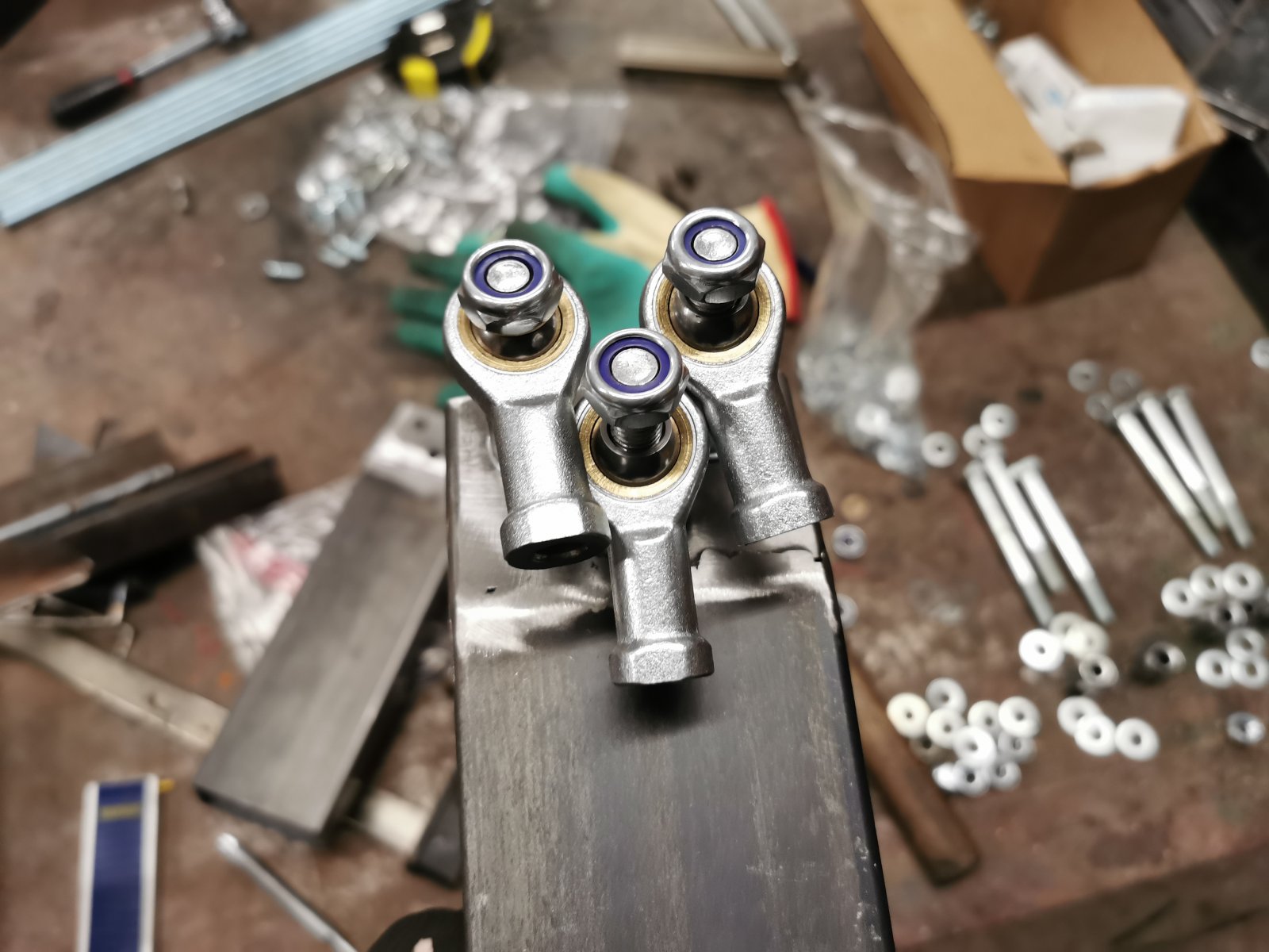

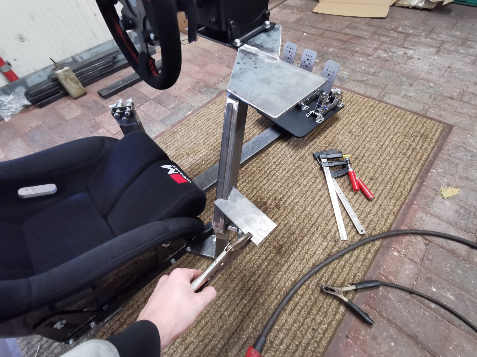

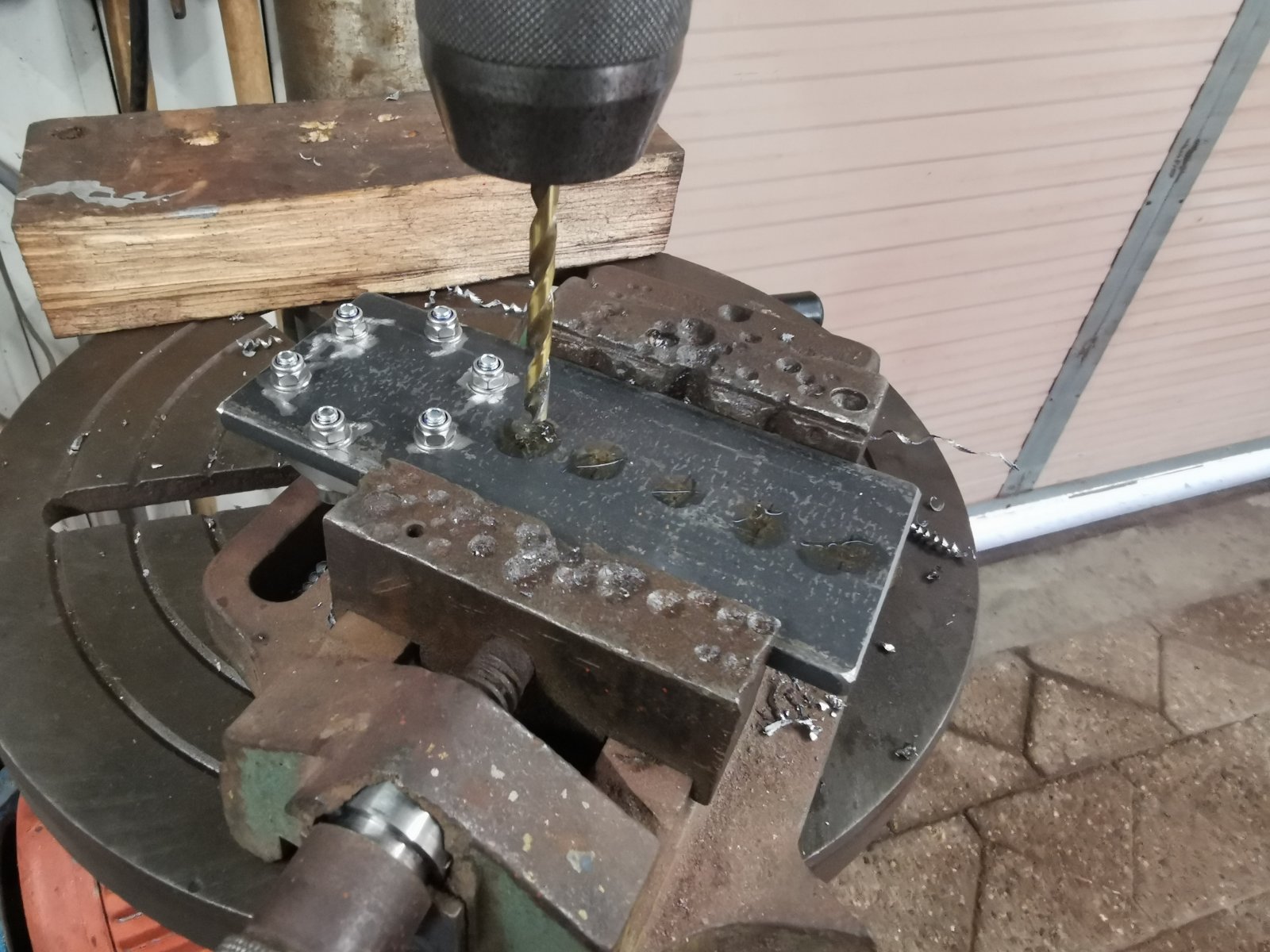

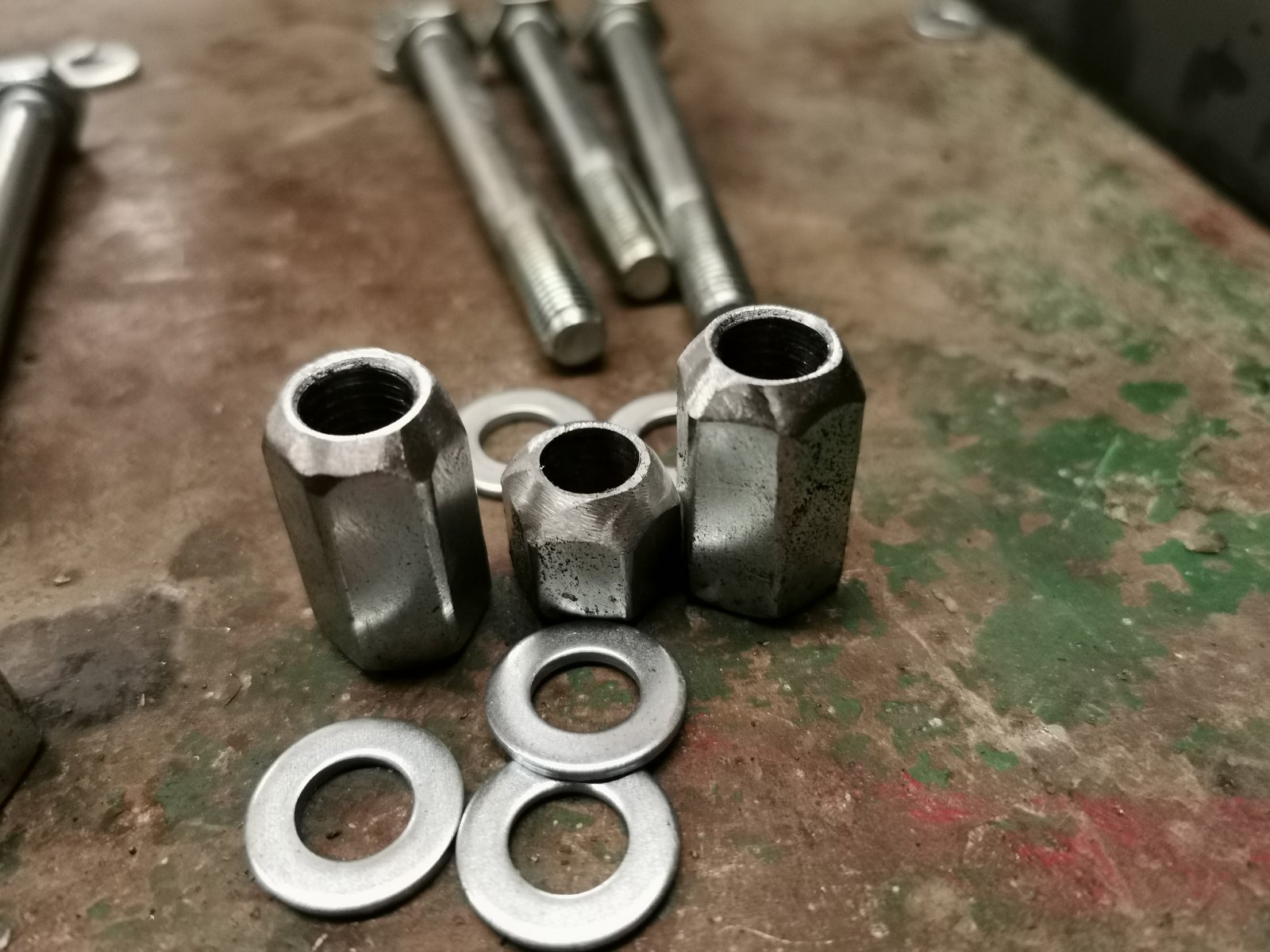

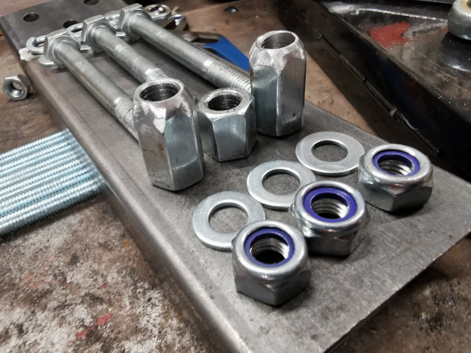

    Anyway, I figured I should just get started with the top frame already, and not wait for the motors, because who knows how long I have to wait.
    A week ago I received my racing seat, the simucube 2 sport, Heusinkveld Ultimate pedals, and shifter and handbrake. So I was able to create a new design from scratch with exact measurements. I then ordered all the steel with the correct measurements cutted in the correct length. I have been welding, cutting and drilling holes for a couple of days. The result being that I have completed the top part of the rig. My initial measurements where not completely satisfying when seated. The steering wheel was too close and to hight. So had to alter it a little bit. But now it's pretty much perfect :) I already have done some races (way to much fun honestly).
    Yesterday I connected the VR headset (HTC Vive around 4 years old by now). When I bought it 4 years ago I only used it a couple of times to play "Onward" (FPS game, also a blast). But other than that never really used it ever since. Now it comes to good use again! I installed KartKraft yesterday and man, what a ton of fun that was. Very realistic. Because since 4 years the technology for VR has improved a lot, I might consider upgrading to a better headset, but for the time being the HTC Vive still does a great job! :p
    Below some pictures of the progress of the build itself, and the result so far :)

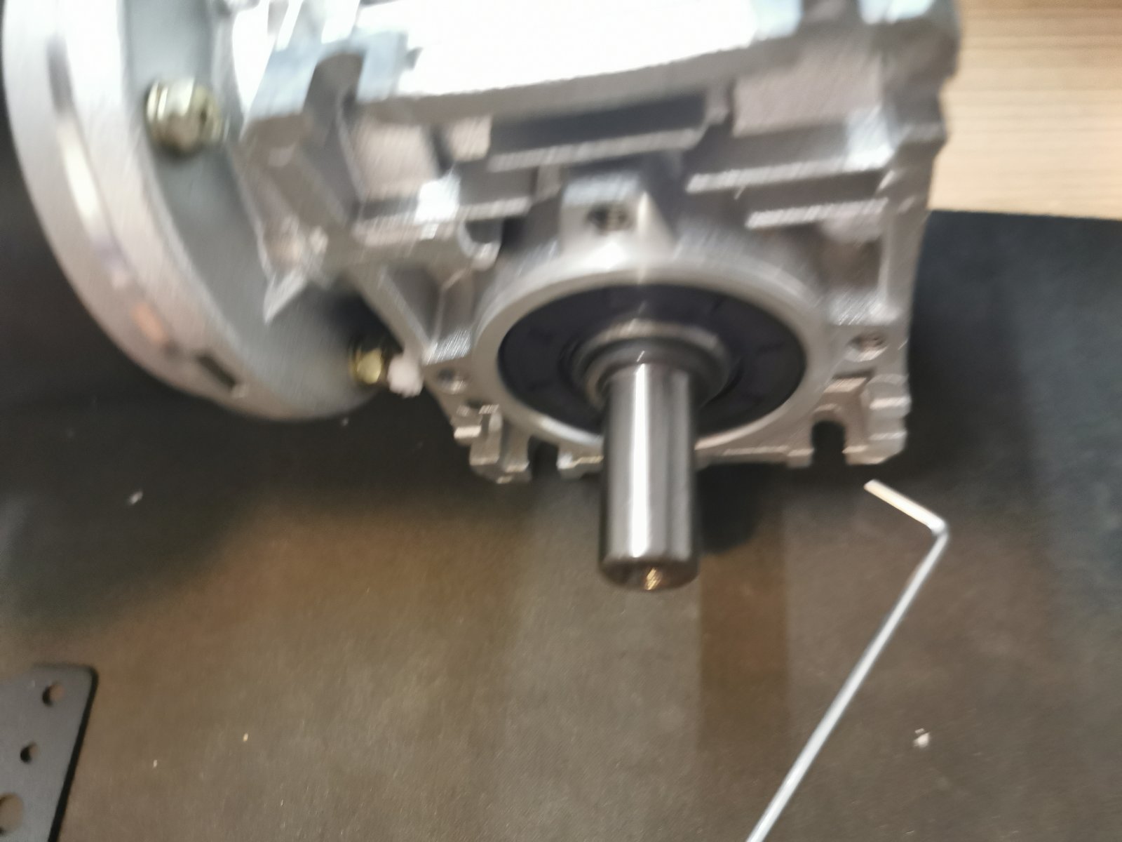

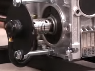

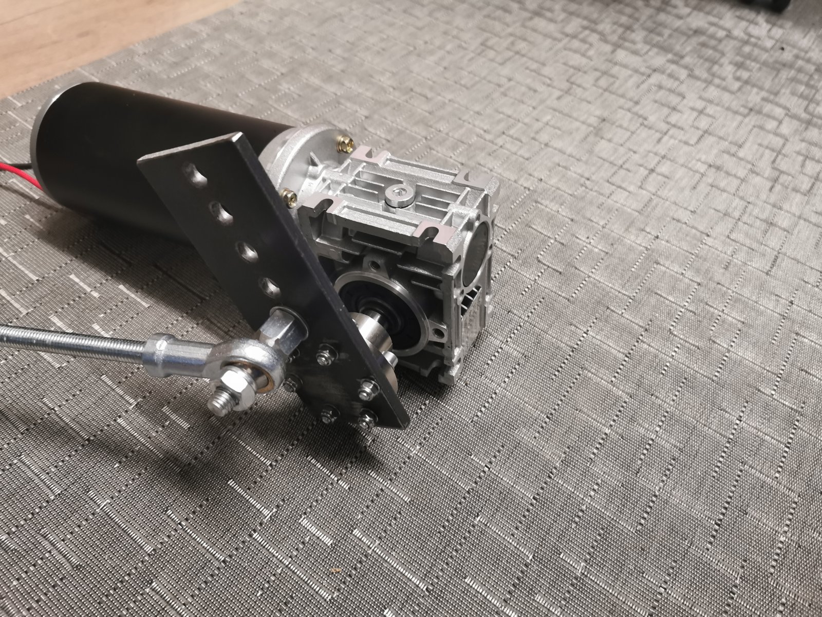

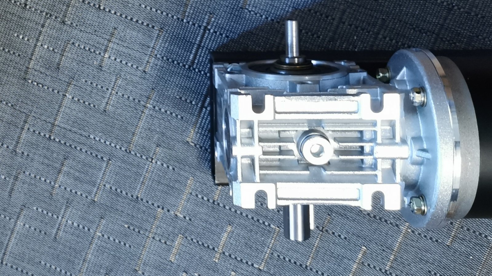

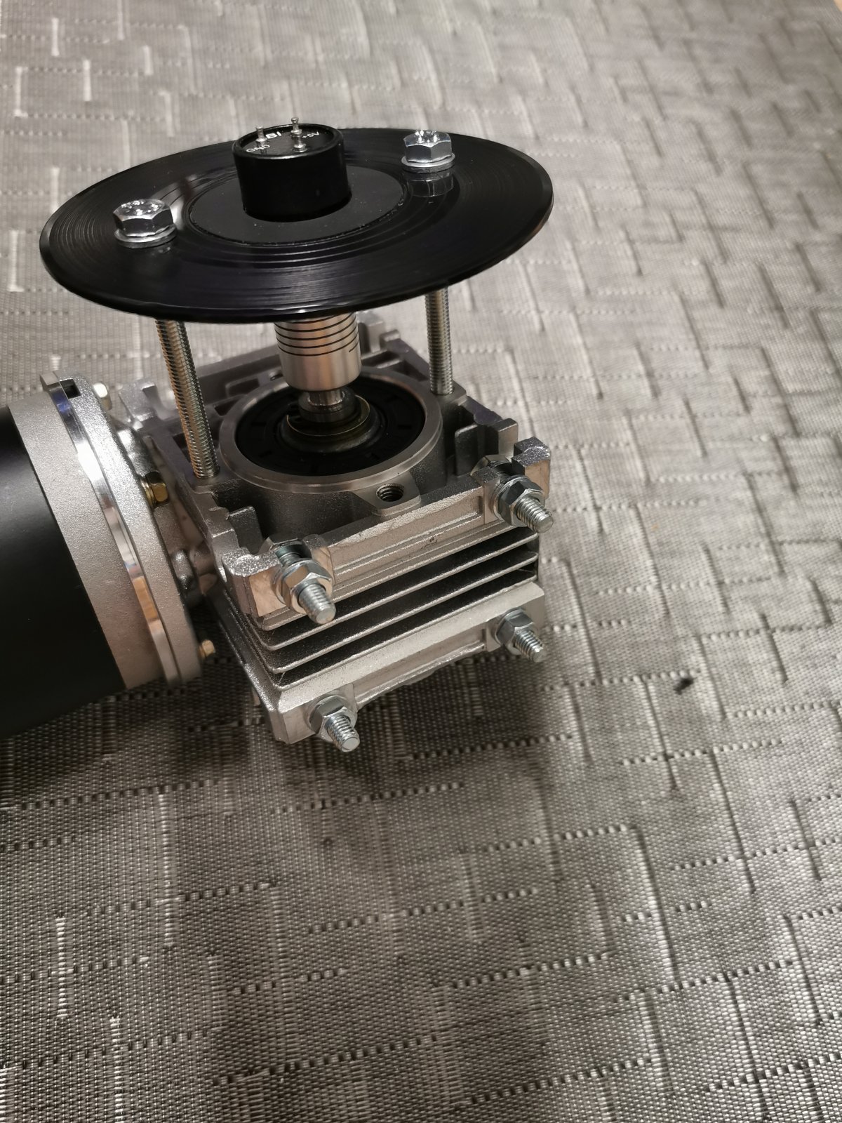

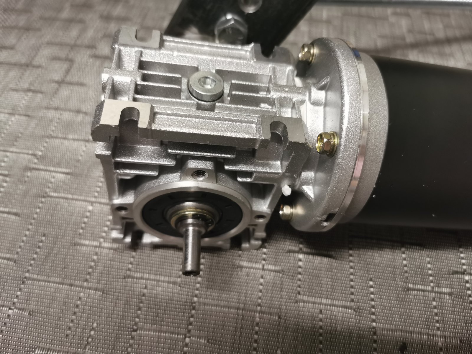

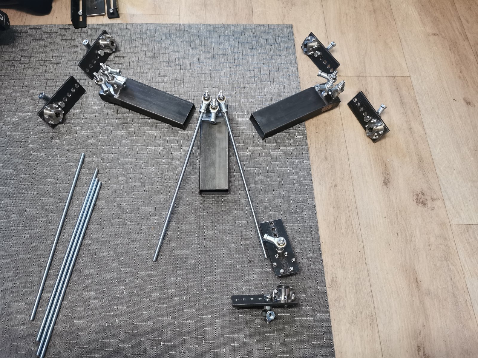

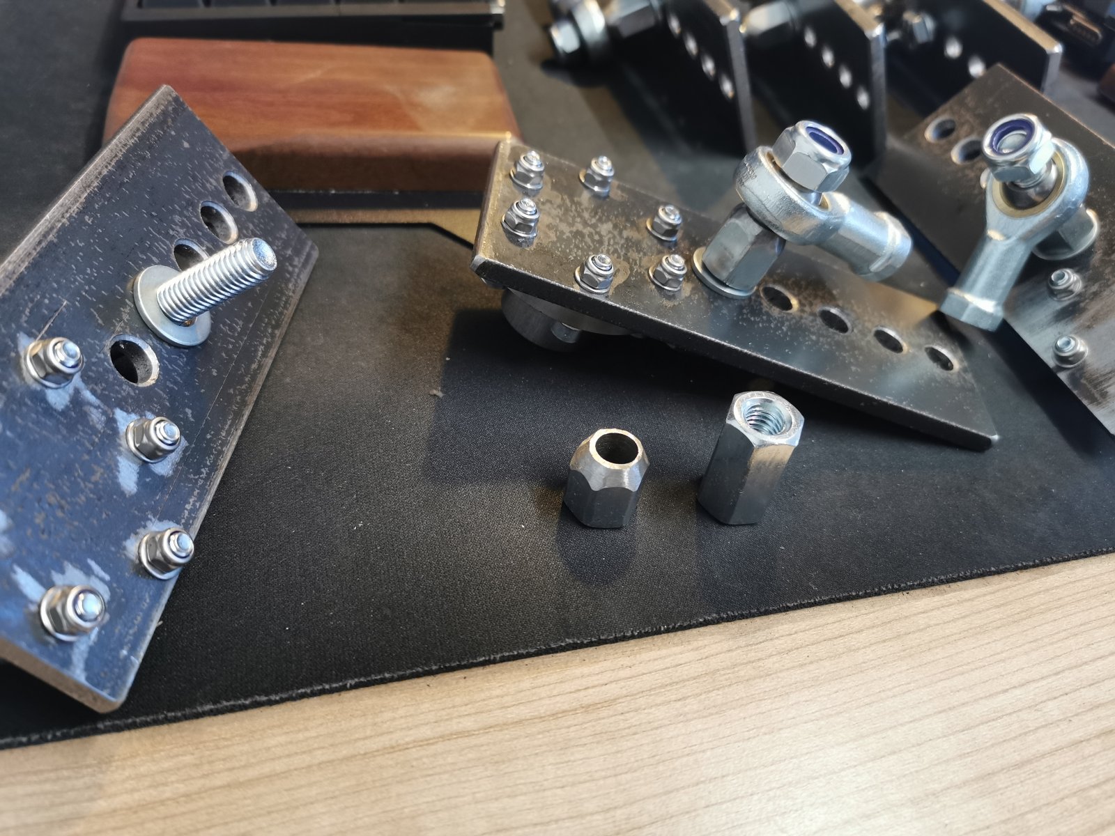

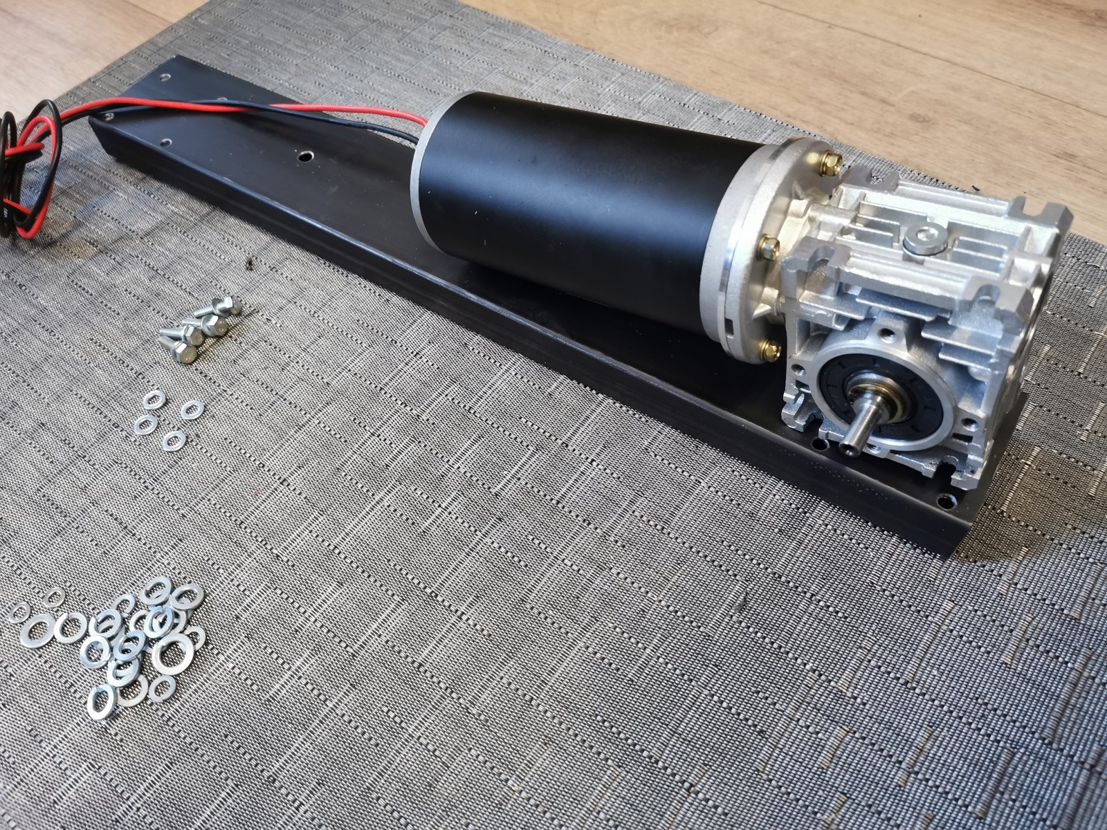

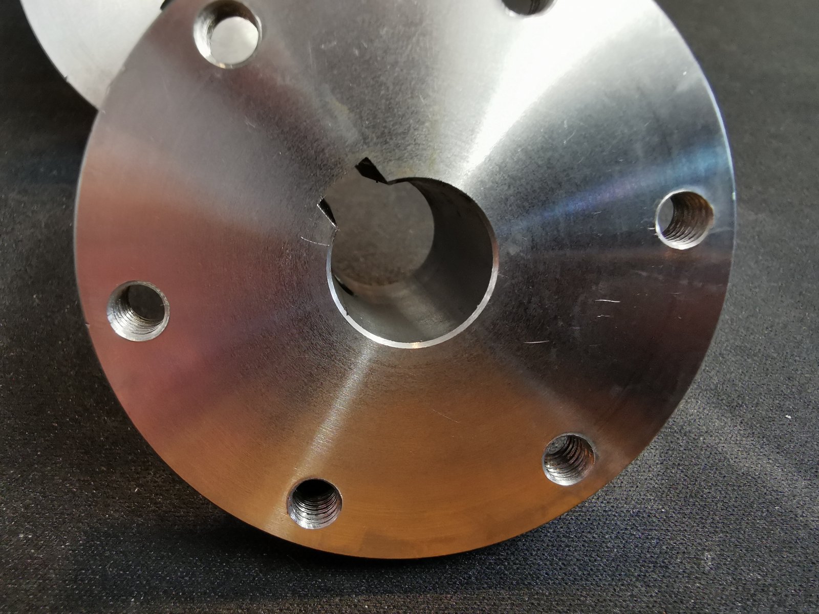

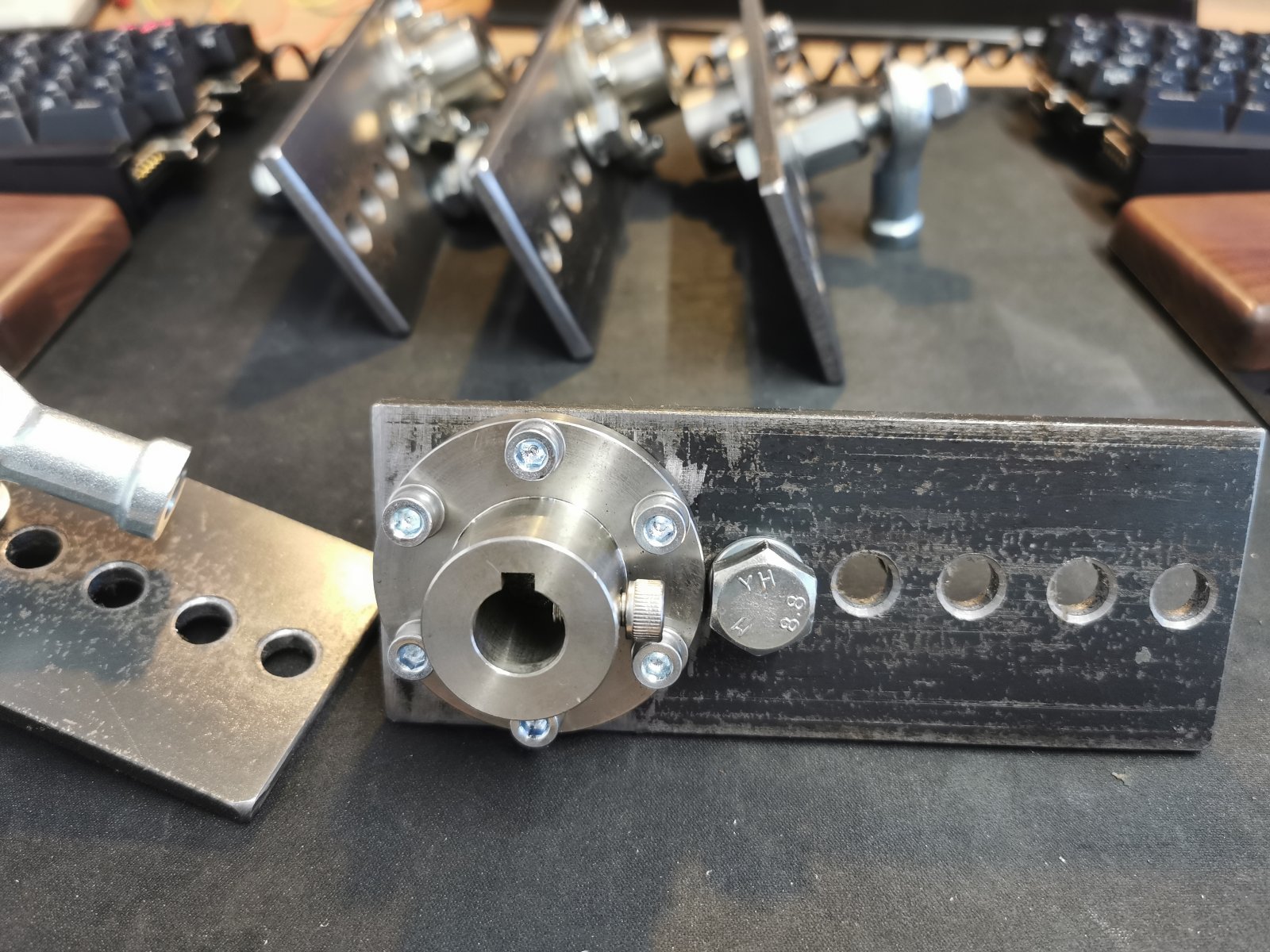

    I received motors today, that's really fast shipping. So I am happy about that :). I am trying to find a good way to attach hall sensors right now. Some pictures for now, as you can see the shaft was customized to fit the coupler/hall sensor nicely :)
    IMG_20201110_170318.jpg IMG_20201110_170325.jpg IMG_20201110_170337.jpg IMG_20201110_170350.jpg

    Great to hear that.

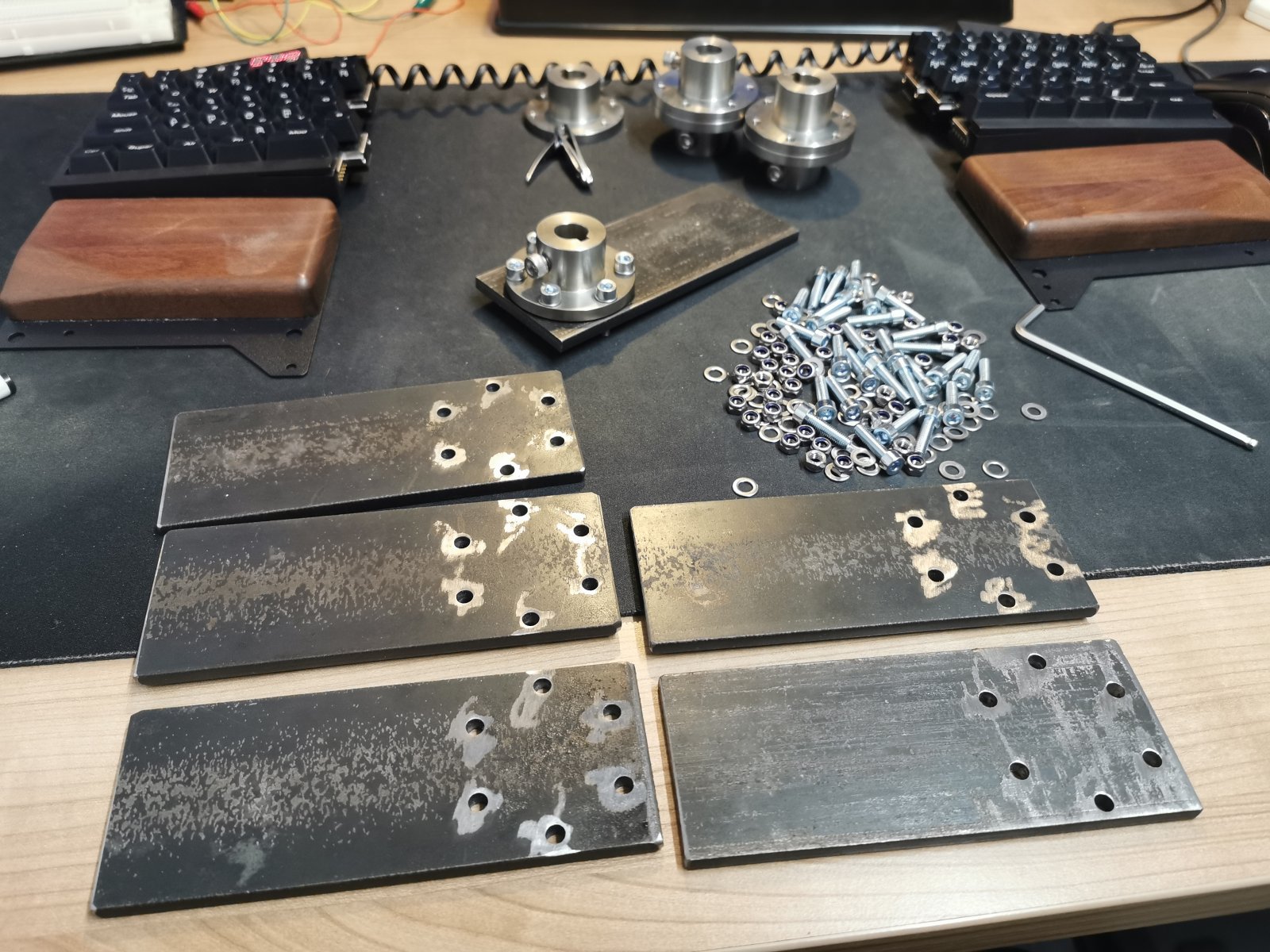

    I cutted a round steel plate with 4 holes that go to the side of the motor to fix the sensor.

    Something like this
    • Useful Useful x 2
  18. Rens
    Rens Member
    Aug 21, 2020
    79
    517Coins
    +29 / 0 / -0
    Oh that simple he, that's probably the easiest and best way to go about it. Very solid, thanks for the tip/share :thumbs

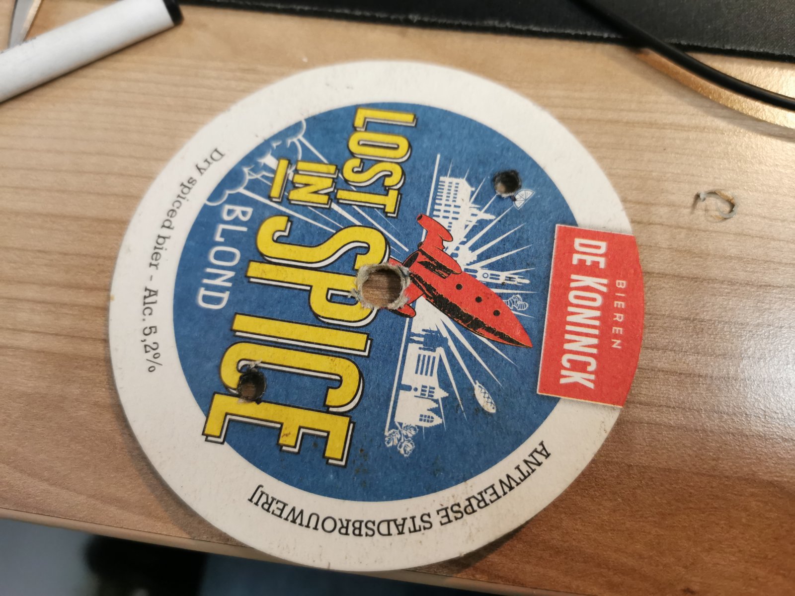

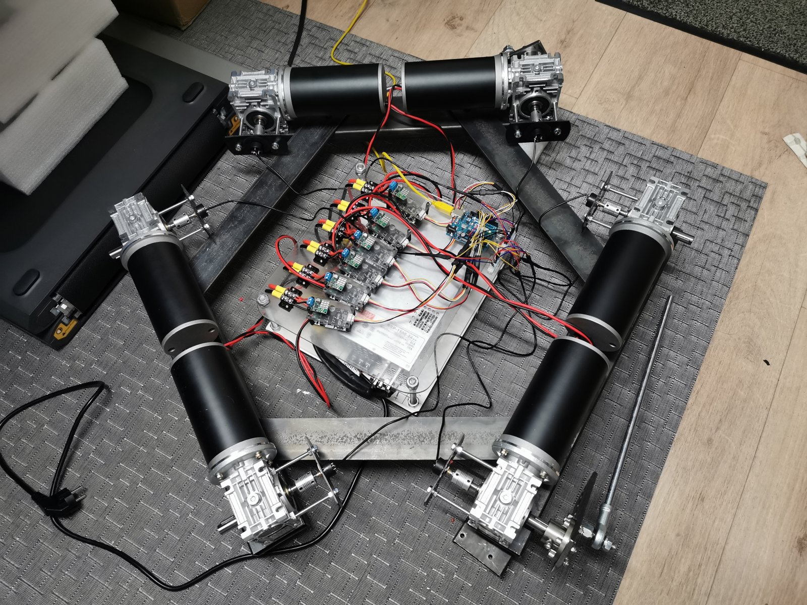

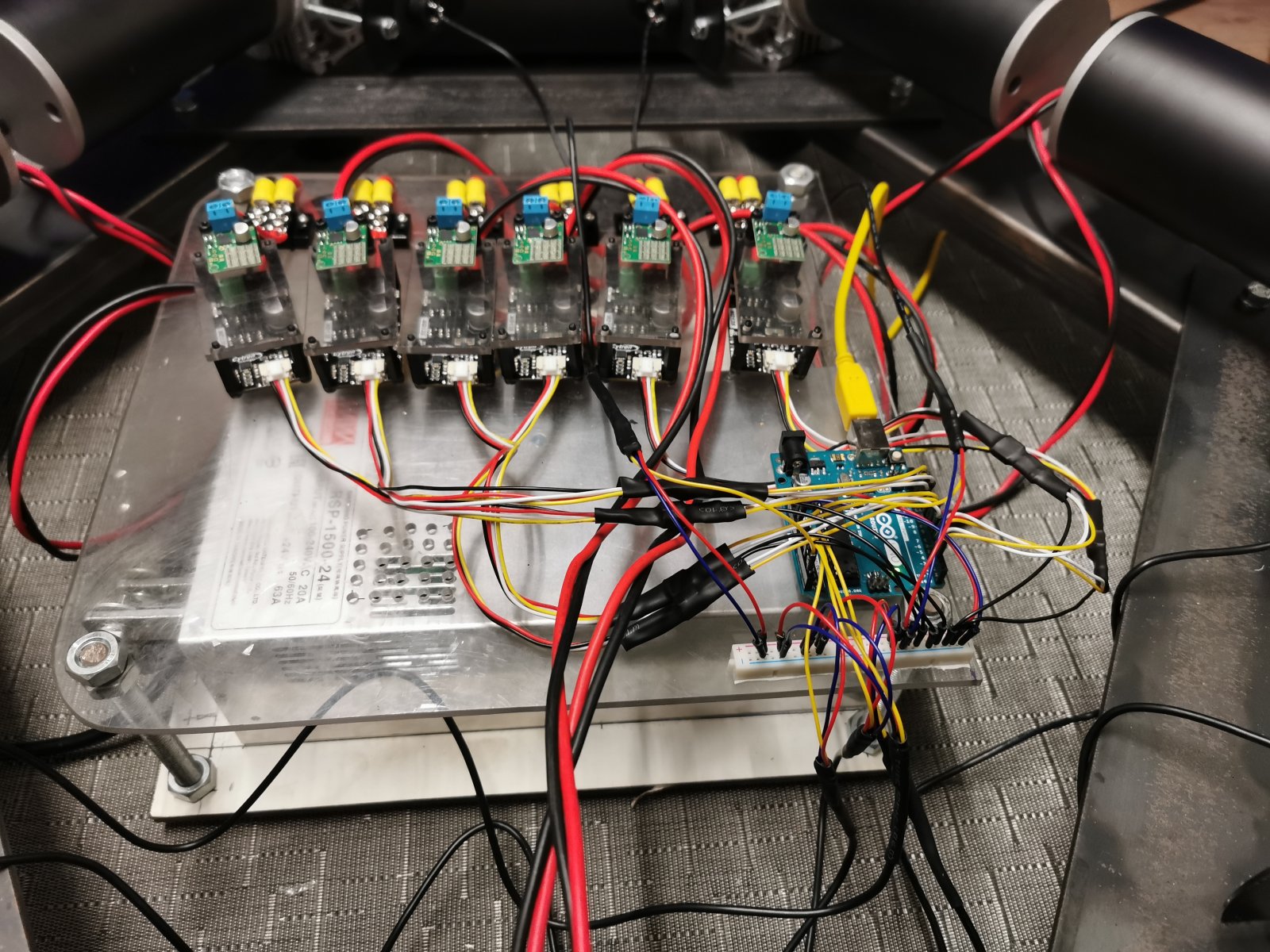

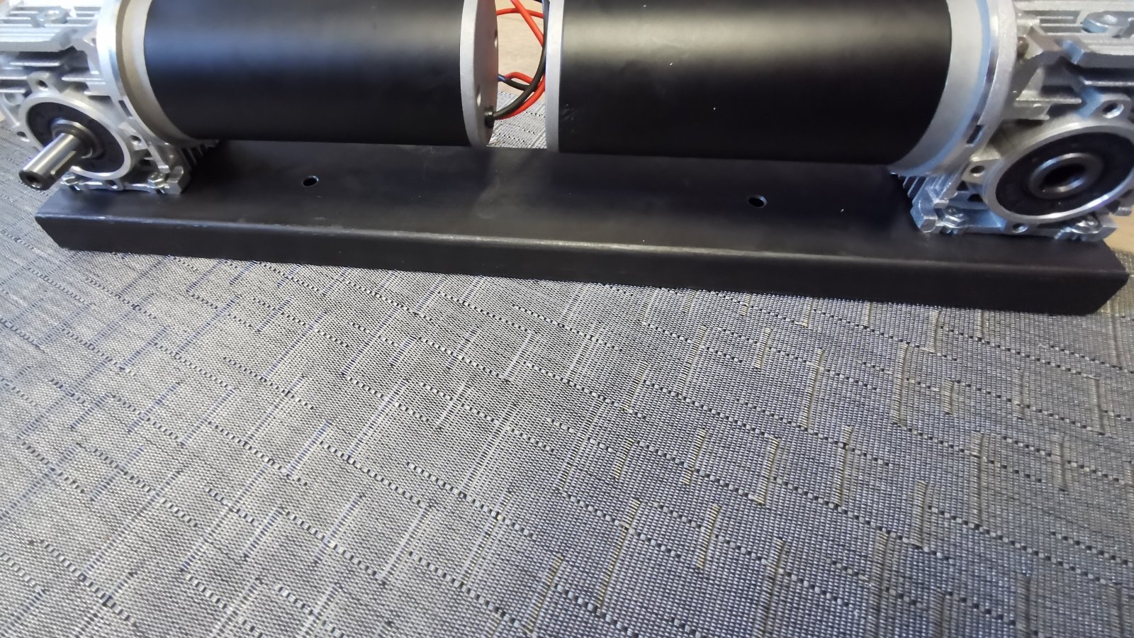

    So I have been making good progress. Worked f9r 2 days on the code to improve it. It all seems to be working quite good/smooth (without any load that is). Regarding pot attachments, I used "beer" coasters. Theybseem to be doing a perfect job. They were round at first but had to cut them of, otherwise the plates that connect/hold the motors together wouldn't fit. But otherbthan that I didn't camr accross any unseen/unplanned issues.
    I have tried to put pressurebon the motor with my feet/leg amd the amp measured was max 1.5 if I remember correctly. The motor driver was warm after some time under load but you coukd easily touch witj your finger.
    I am still planning on adding gas springs to help with load. And maybe add some heatsinks to the drivers and maybe a fan. But will have to see how the test goes with the rig without a person in it before I add more weight. I probably have to adjust PID a little bit too based on the total load.
    Here are some pictures and some videos:
