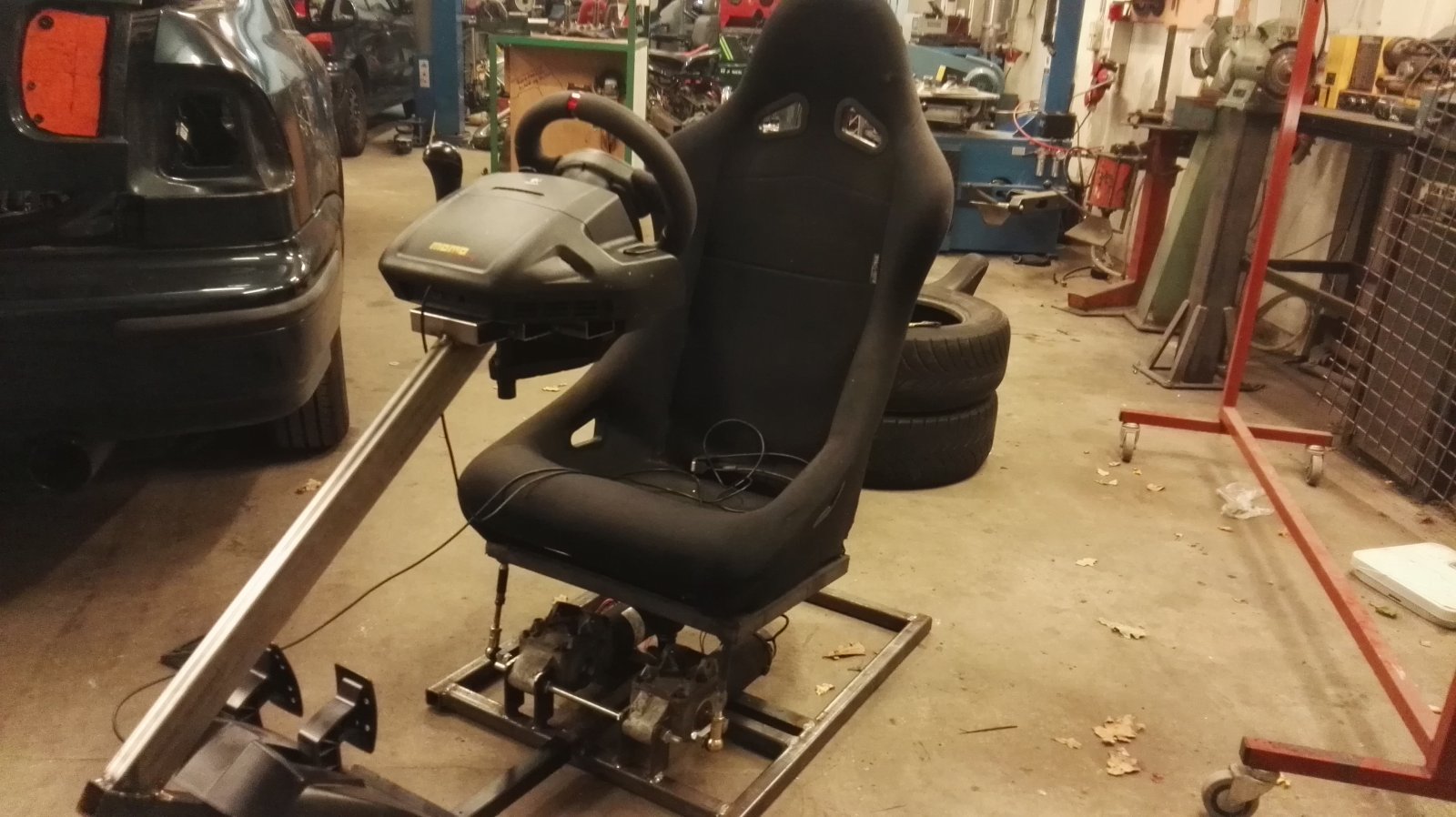

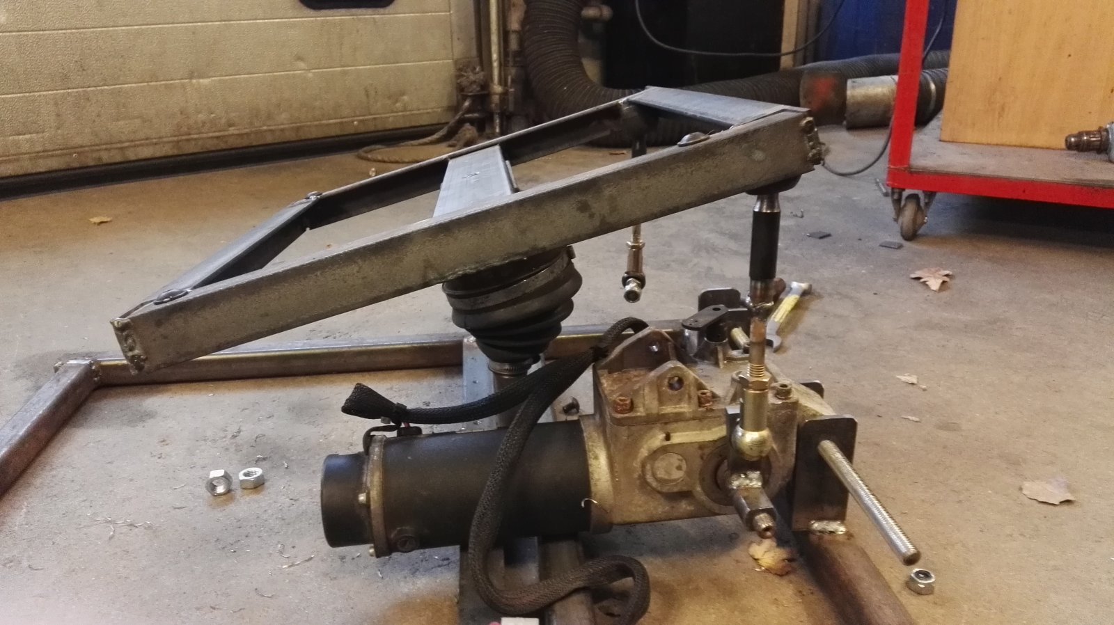

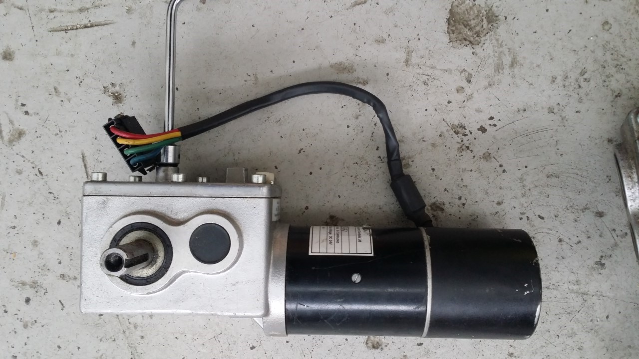

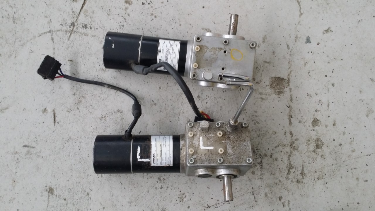

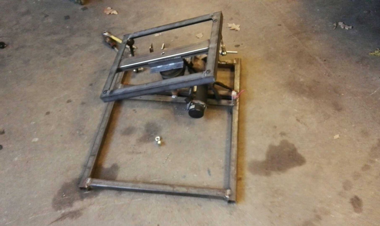

    I spent the entire day building the frame for my sim as I couldnt wait to start on it as I'm waiting for my H-bridge and Arduino to come in the mail :p Here are some pictures with some notes attached to them! No sketches were made before we started the build, but we had a decent idea of what we wanted to do. The motors are from a Jazzy 1122 wheelchair that we found that was going to be thrown out, so we salvaged it a few years back and found an awesome use for it now! :D

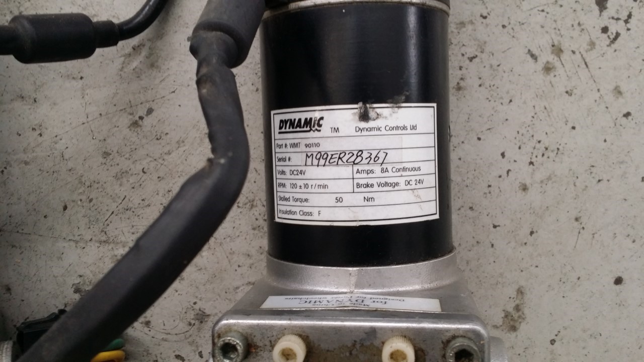

    The motors name are specifically Pride e660. I couldn't find any info on them except that they are 24v.
    Here are the base frame with one of the moros attached ( Sorry that i havent got any fotos before we attached them)
    Only one was attached at the time of this picture as we test-fitted them, and then prepared them for mounting of the pot-meters afterwards.

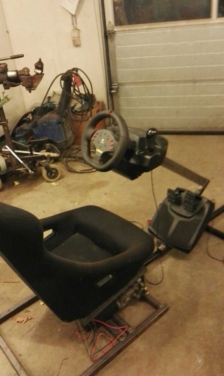

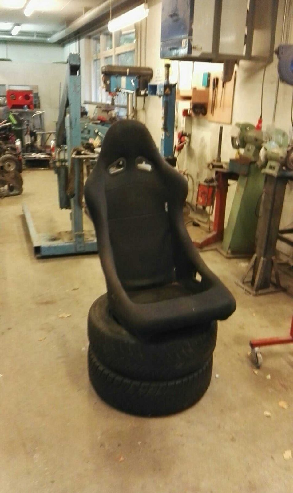

    IMG_20161022_161957.jpg Heres the seat that we wanted to mount on the base frame, its an old racing seat that my brother had before he got a new one for his racecar.
    1477146015155.jpg Heres the entire frame, with the seat mounted and the wheel/pedal module attached, we wanted it seperate as it would save space in an already cramped up room if we wanted to store it away. Only the seat moves. IMG_20161022_195900.jpg 1477158793627.jpg
    Hopefuly there will be more pictures in the following week when i get my arduino and h-bridge, untill that, i still got some welding and stuff to do to make this frame perfect! :)

    The steering wheel does not move much with a single long tube?
    Hoping to see your progress :thumbs

    +11 / 1 / -0
    Thanks! :) And at the moment after some testing by moving the seat around by hand it doesnt seem as it shakes that much, but if it becomes a problem we will probably reinforce it. We're also working on making the steering wheels height adjustable, as it is right now connected to the pedal-base that can be moved front to back :)

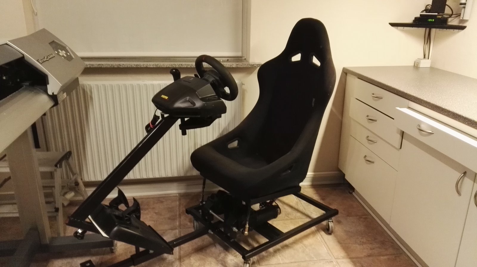

    Update on the sim! :) We assembled the entire chair sunday after painting it, and after smoothing out some edges and stuff like that. Here are some pictures:
    IMG_20161023_194957.jpg I'm really happy about the frame so far, and we mounted some wheels to the base for easy moving around :) Some brakes will be added later.

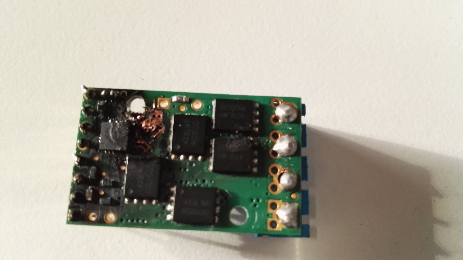

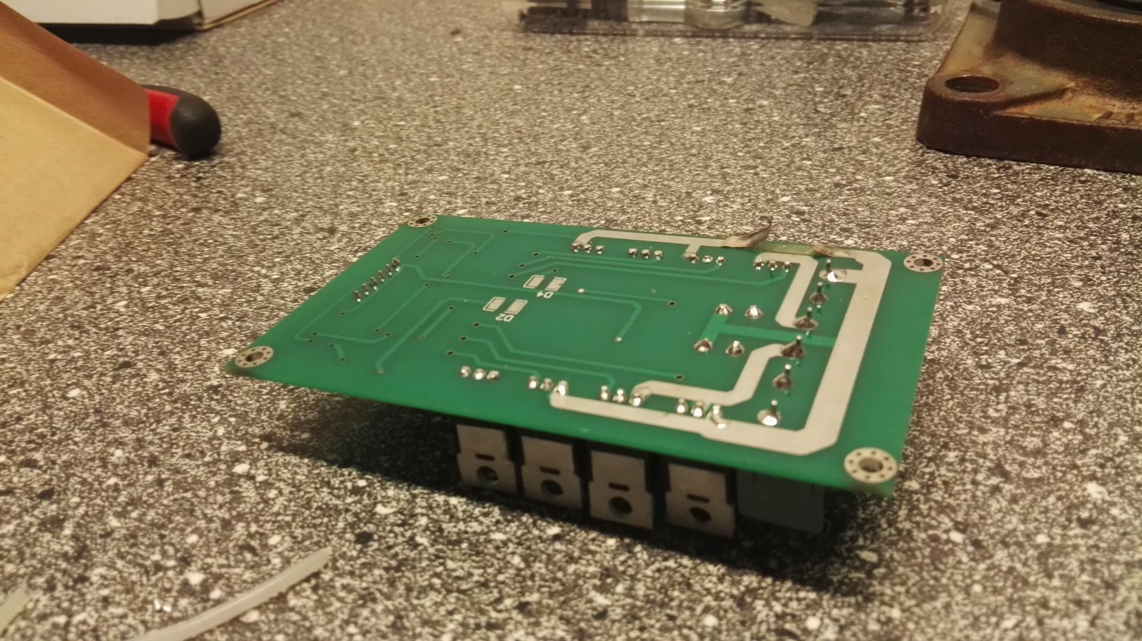

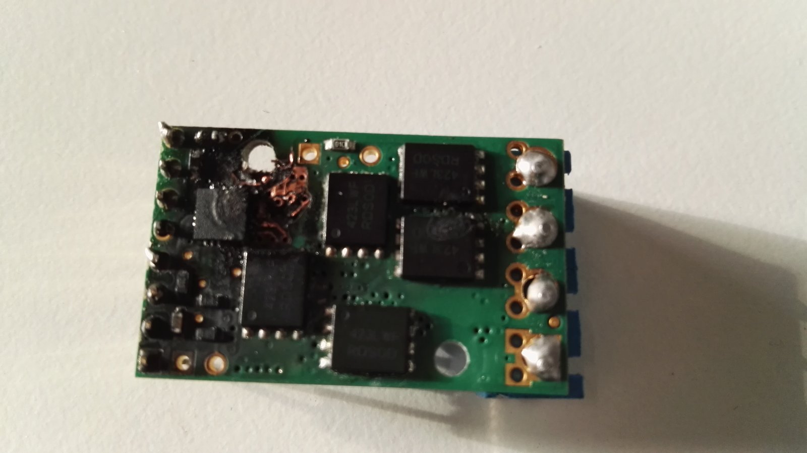

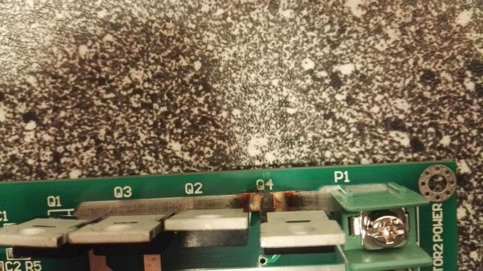

    I finally got my arduino in the mail today with my h-bridge, which i chose before reading about some peoples experience with it (it was the cheapest 24v 10amp h-bridge i could find for like 20 bucks or so) and well as fine it looks...
    IMG_20161025_200303.jpg It couldnt even handle a 3 amp load from a small battery that we found while testing it :( it began to smoke after 5 minutes of playing around with the arduino, and suddenly it sparked and now it looks like this:
    IMG_20161025_200247.jpg IMG_20161025_200258.jpg Please do not buy these cheap h-bridges! :D I just ordered 2x pololu 28v 20 amp motor drivers which should do the trick nicely, although they were a bit pricey :p The arduino works perfectly though, and its nice to have that in my hands after a few years without one, they're so neat! The h bridges will hopefully arrive friday, and I'll update the thread when(if!) it works :D

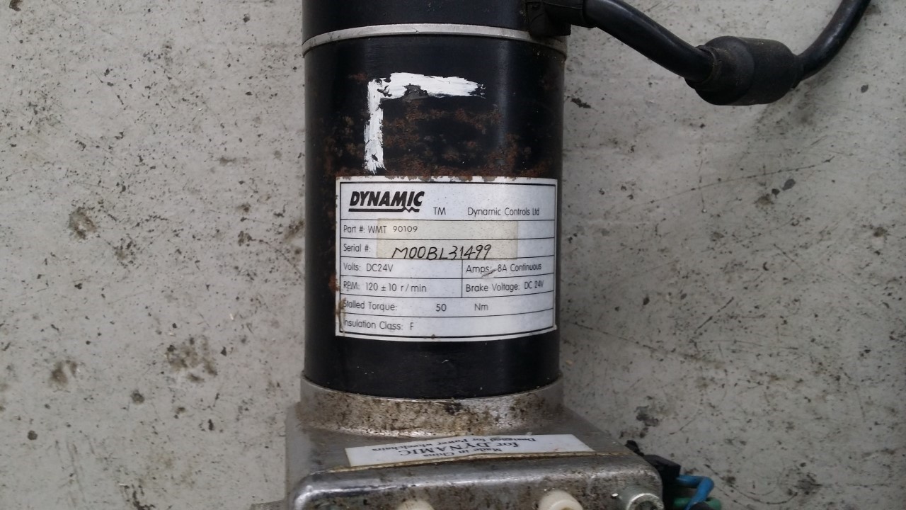

    what sort of rpm / power are your wheelchair motors ? - they look like a good solution to me !
  8. Nick Moxley
    17,056Coins
    +2,506 / 30 / -2
    Specs on the Jazzy motor's are located in Miltons thread, titled "CXC Replica" These motor's aren't 100% ideal but that can be found for Cheap cheap and they have a VERY VERY robust gear setup as seen here.

    Again, I had no specs on them, but after some very rough calculations they had about 100 rpm or so at 24v (calculated from some brochure i found about the wheelchair online)
    At 255 pwm and about 21 amps and 24v it can throw me around like i was light as a feather, and they measure about 40 degrees celcius(the pololu h bridges) when i measure how hot they become, and thats without any heatsinks.

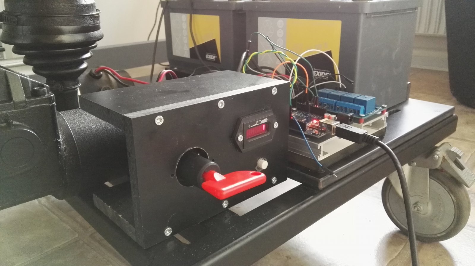

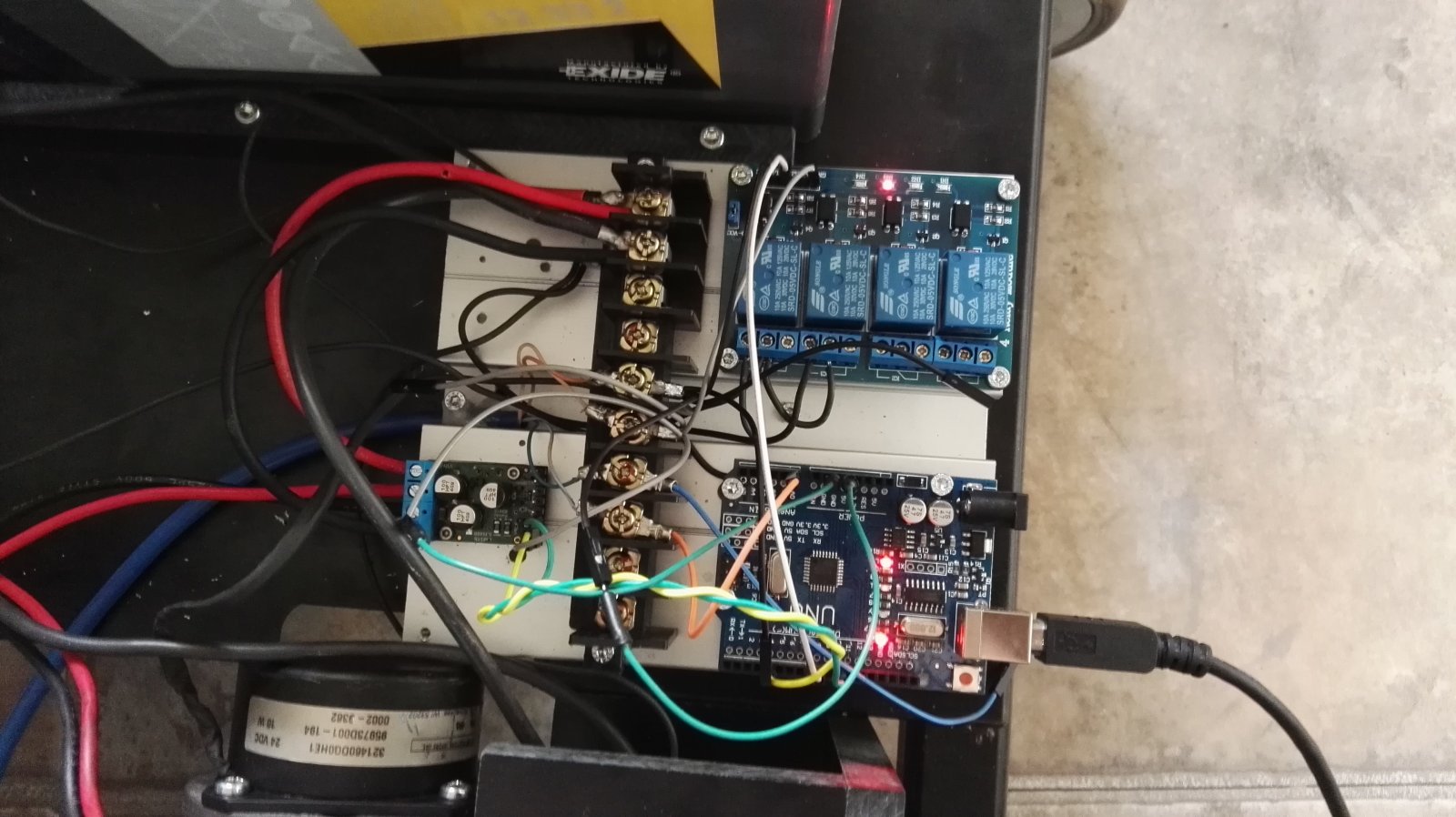

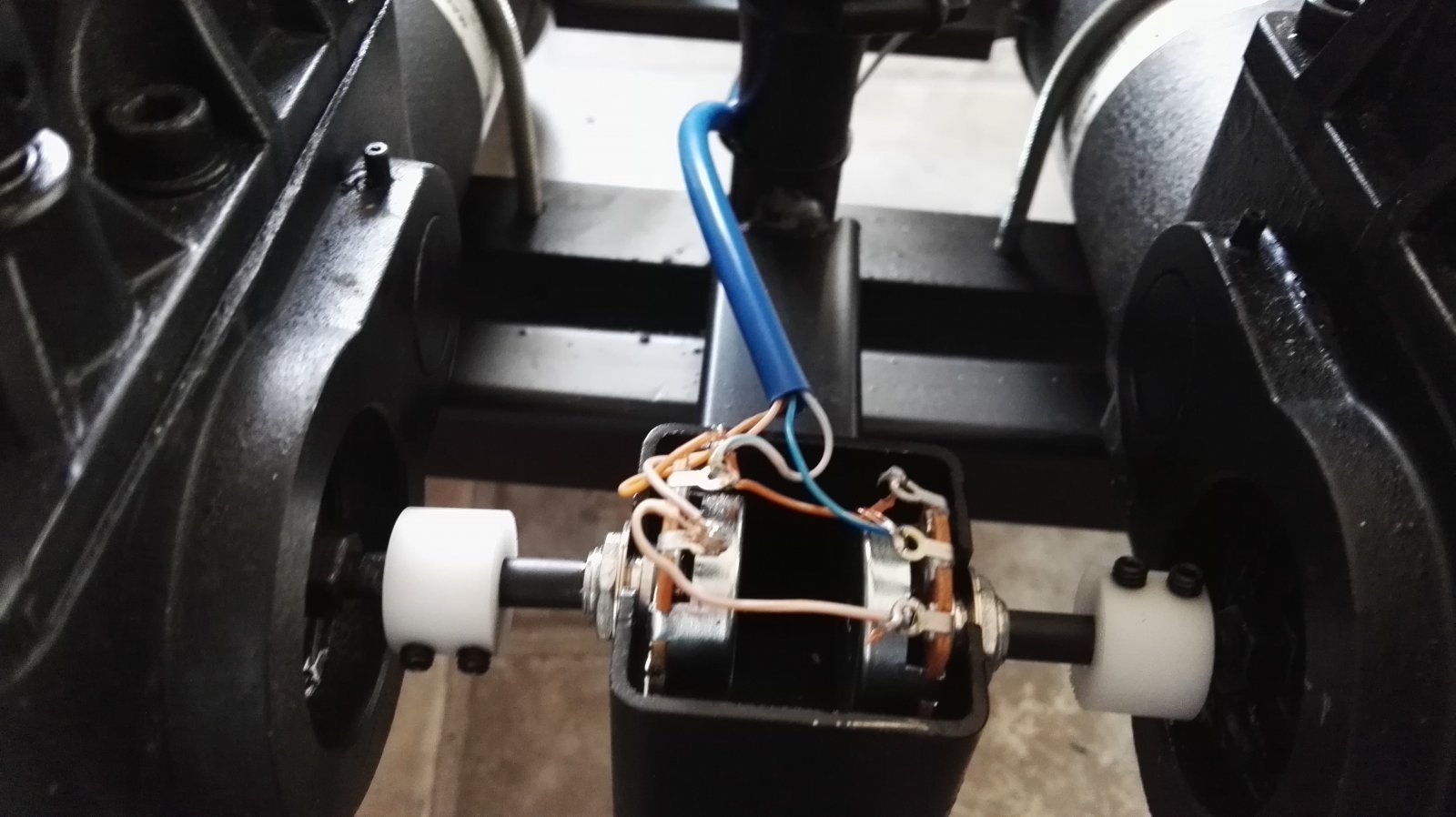

    IMG_20161111_102739.jpg After having been through the trouble with wires everywhere we took the whole week and tried to make it all neat and fancy, with an emergency switch, a battery gauge and mounting everything on some aluminum incluing the h-bridges so it all acts as a huge heatsink. IMG_20161111_102754.jpg
    Heres a great pic of everything from above, this is also after the whole rebuild where we wanted to have the pedals and wheel moving as well, so it wasnt just a seat mover. IMG_20161111_102800.jpg
    A nice little pic of the potmeters and how we mounted them :) the wires used are just an old ethernet cable, looks good compared to our first soldered solution that looked like shit :p

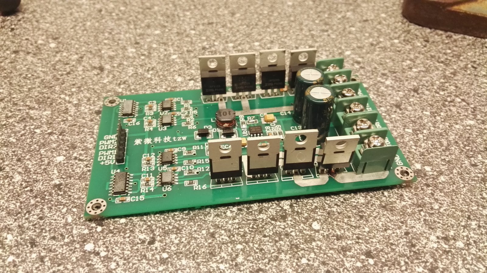

    1 pololu 24v21 g2 h bridges that couldnt withstand touching an earthed motor while running, pft, what a load of cheap crap ;) our mistake, the other one survived, even tho it was straight in this ones flames, it looked black, but we dusted it off, ordered two new ones (might wanna do a traction loss later on, so now we have the h bridge) and now we take wiring very seriously :D

    Second test of the motion sim, after adding the pedals and wheel to the movement, so much nicer, and the h-bridges barely get lukewarm :)
    The clicking noise is a relay that we added, so the motors had a physical brake. They are wheelchair motors, so they are freewheeling when not moving, so to avoid the "shaking" it had trying to get into its position, we ordered a 5 dollar relay on ebay and added that, works like a charm!
    Other than that a plexi-glass box was added to the electronics to protect them, and some wiring was done :)

    Personally I think you are overdoing the axis throw both in terms of the additional strain on the motors and for use with VR.
    With my levers I use 40 degrees up and down from horizontal. Over about 38 degrees and the effective use of torque drops of rapidly, which means the motors have to work a lot harder.
    For VR precise and fast motion adds a lot to presence.
