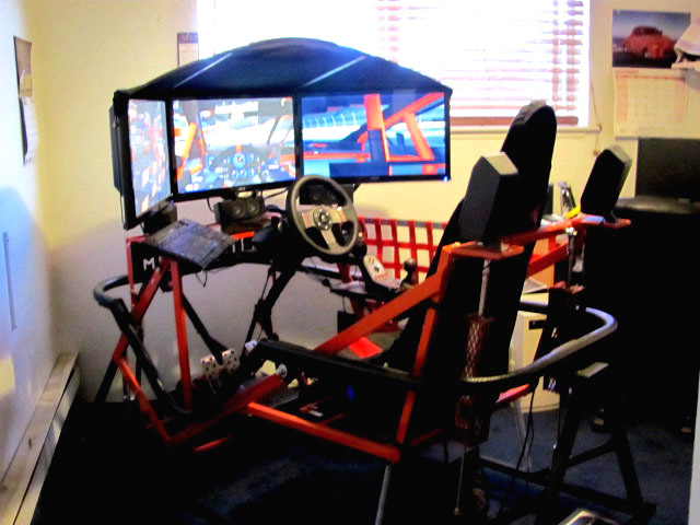

    Just come across this rig as I was running a search -http://www.imotionsim.com/Home.php
    No pricing and the web counter is showing 214 so probably a new web site / new product.
    Update: - $4995
    Interesting design in that they look to have crossed a Frex type 'seat shifter' with a Simcraft rig. Instead of having the pivot underneath the seat they have pivoted the seat cradle so the seat, pedals and monitor moves. Beefier looking actuators, possibly SCN6 units ? The actuators work in the same way that they do on a seat shifter rig whereas the Simcraft uses one actuator for pitch and the other for roll.
    Would probably be good with a static triple screen setup, also easing the load on the actuators.
    Can't yet see from the videos how the third DOF is obtained.
    Haven't seen a configuration like this before.

    Thats a a nice looking unit you have there
    You could build a frame for outside the current sim, you would have to design a frame inside as well to achieve the two pivot points. Thats for a joyrider style design sim.
    or if you are keen you could build a base for under neath with a pivot pint and make a 2DOF using some large dc motor. 12 volt boat winches would be the go to shift the whole thing.

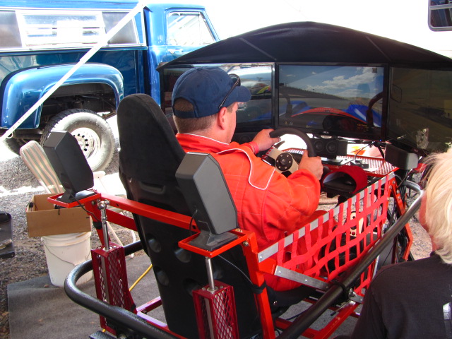

    I built the i Motion Sim. I just added the 3 DOF with three 3D monitors. Am still working on web site and will be adding video and pictures. Took it out to our local race track and let racers try it out! Got great feed back and everyone enjoyed it! I've made the ride as realistic as possible.
