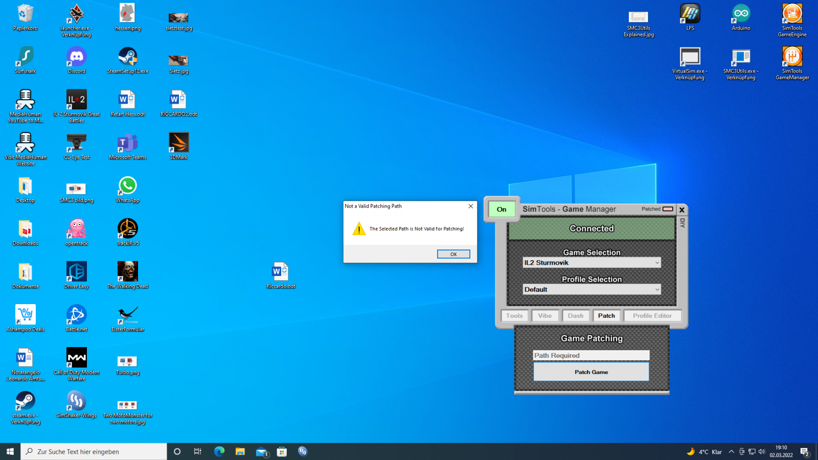

    How to patch it.
    As described, I simply dragged the pulings over with the mouse

    Always get that it does not go to patch

    The directory path is not correct, it needs to be where IL-2 is located.

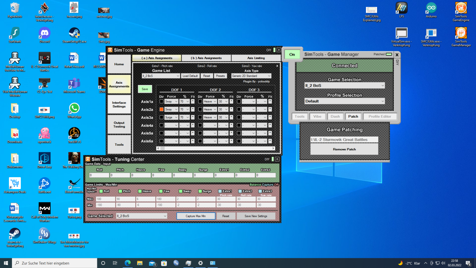

    have managed to patch it but no signals come up

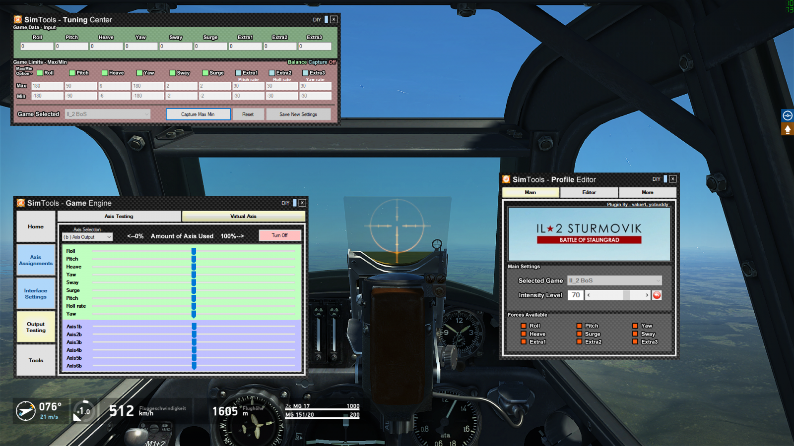

    the motors always lose the centre position, the podi must be readjusted again and again and the motors always burn
    22,127
    154,388Coins
    +11,179 / 57 / -2
    This shows that data s not flowing to the Tuning center, suggesting the patch path is not correct or external interference by the likes of Anti-virus or firewall software.
    As an aside, intensity levels should be at 100% except in circumstance where there is vulnerable hardware, such as SCN actuators.

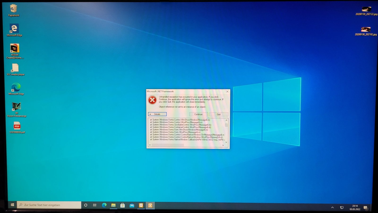

    Help yesterday reinstalled Win10 because I got Networks error message from the beginning, now after the new installation plus Simtools the message is back, what else can I do.

    I have re-installed the network, but unfortunately the same error message still appears.

    Hit the Details button on the error message to show the full details, copy and paste those here and @yobuddy could have a look.

    System.ComponentModel.Win32Exception (0x80004005): Only part of the ReadProcessMemory or WriteProcessMemory request was completed
    at System.Diagnostics.NtProcessManager.GetModuleInfos(Int32 processId, Boolean firstModuleOnly)
    at System.Diagnostics.ProcessManager.GetModuleInfos(Int32 processId)
    at System.Diagnostics.Process.get_Modules()
    at SimTools_GameManager.frm_GameManager.tmr_IsGameRunning_Tick(Object sender, EventArgs e)
    at System.Windows.Forms.Timer.OnTick(EventArgs e)
    at System.Windows.Forms.Timer.TimerNativeWindow.WndProc (Message & m)

  20. yobuddy
    51,658Coins
    +5,204 / 19 / -0
    This is a new one for me, so I did some searching on google, and it seems to be somewhat common.
    In all of the fixes presented at various sites and even some YouTube videos, it seems it may be a problem with either permissions, hdd errors, or a bad stick of memory.
    Let's start with Antivirus thou, what are you using?
    Maybe install avg free and give it another try.
    Let me know what you find, and we can go from there.
