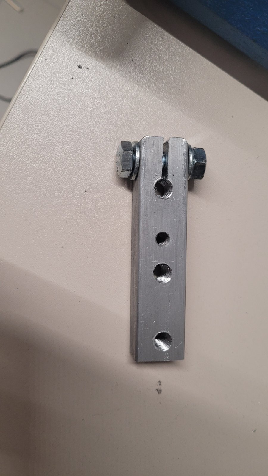

    I really wonder how good your motors support each other with that position.
    I also thing that your levers are to long for that motors. I have two holes in my lever. one at 4cm away from the shaft (for racing) and one at 6 cm (for flying). I use two 370w motors.

    The placement of the roll motor means it has very little inherent design leverage and far less than the pitch axis, wiper motors are not very powerful so you need as much inherent design leverage as possible within space constraints. In other words the further the motors are from the pivot the better, which is why shoulder mount design is popular for wiper motors, as it gives the maximum inherent design leverage.
    The lever CTC length is likely too big, as per previous advice. At a guess try 40mm.

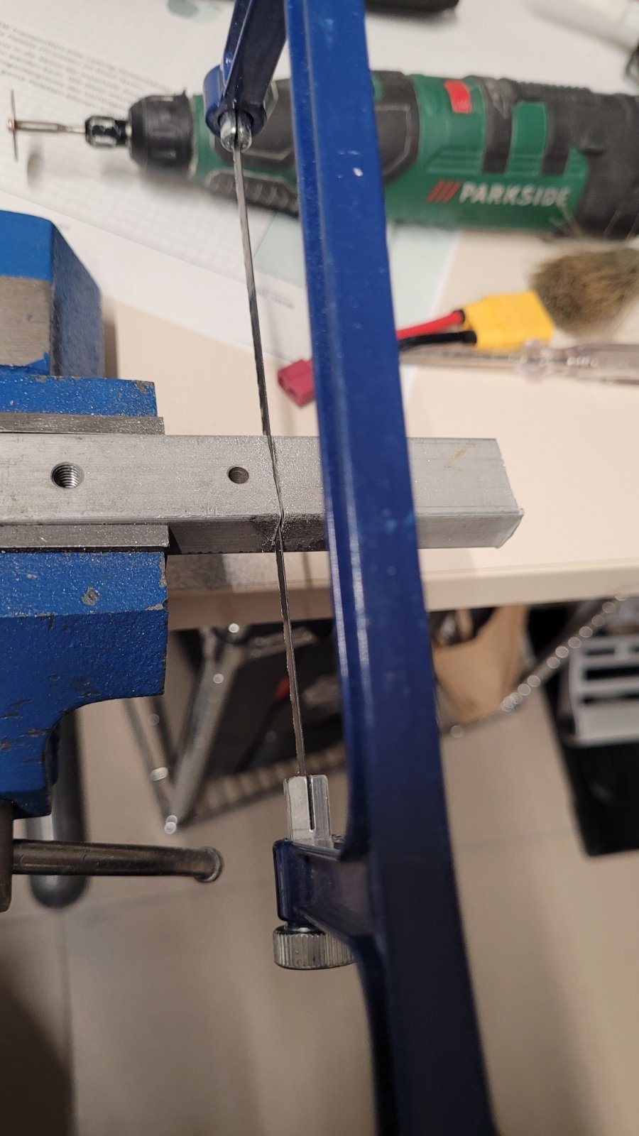

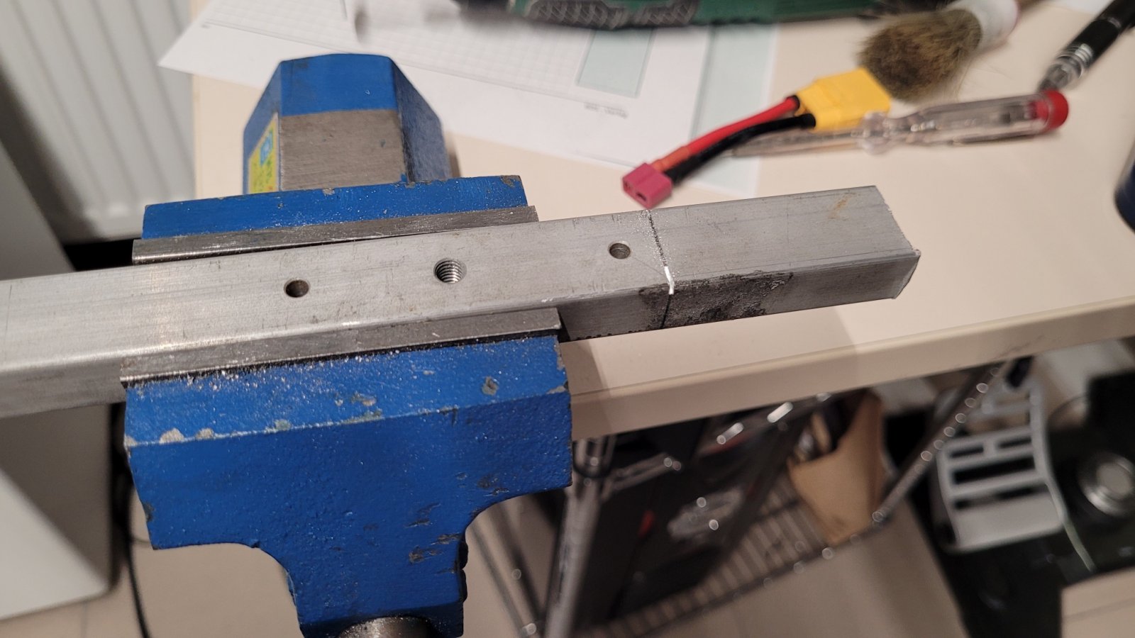

    Sorry it took longer would have to wait for material
    as a bracket here in Germany was not to buy I was forced to build it myself of course with high priced tools LOL

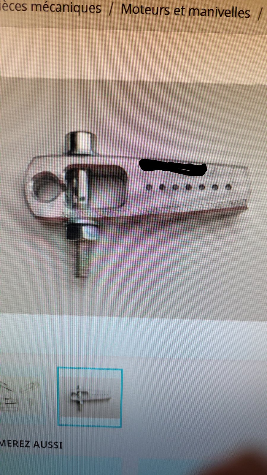

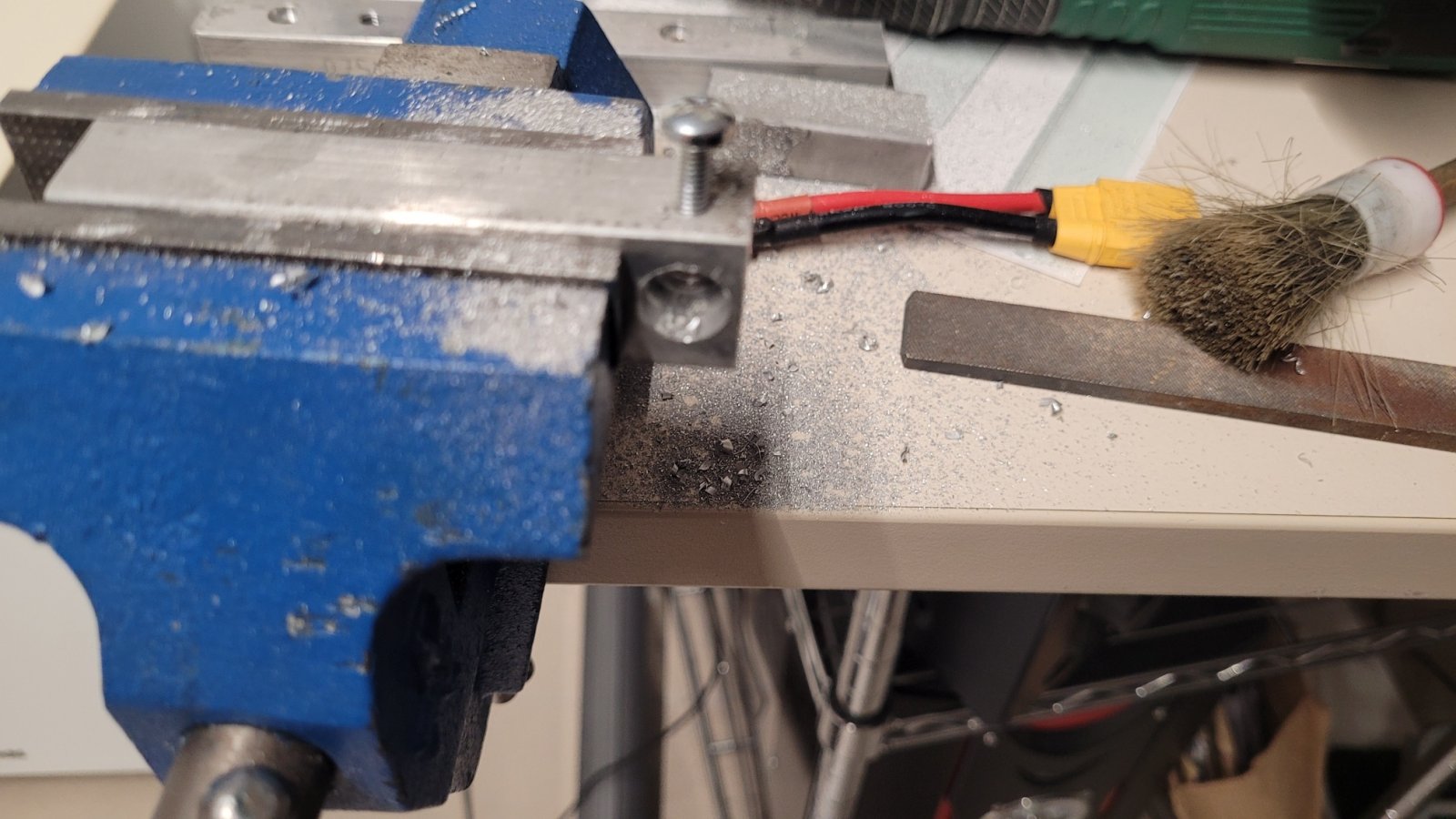

    This is the original part I rebuilt

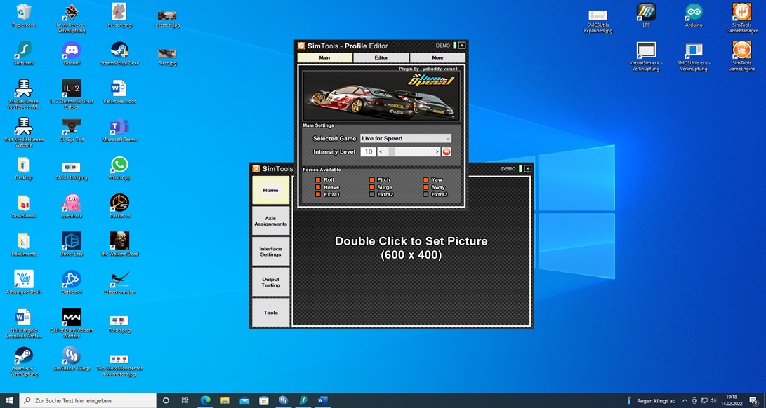

    these are the settings what i have

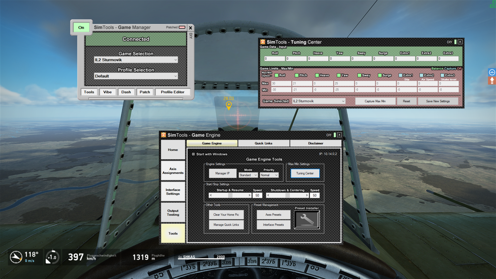

    Leave the intensity level at 100%.
    Does everything work as expected in Output Testing?

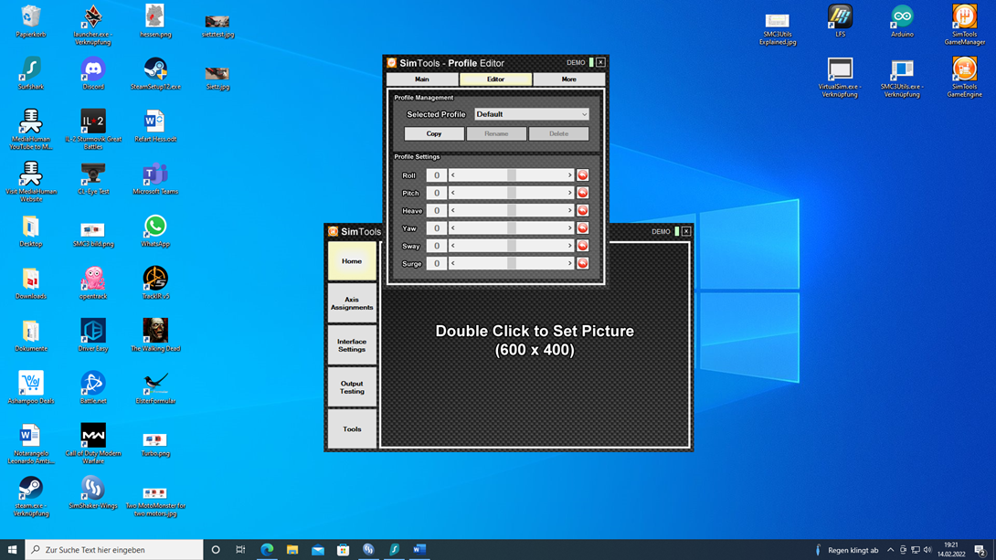

    What are your Tuning Center settings?

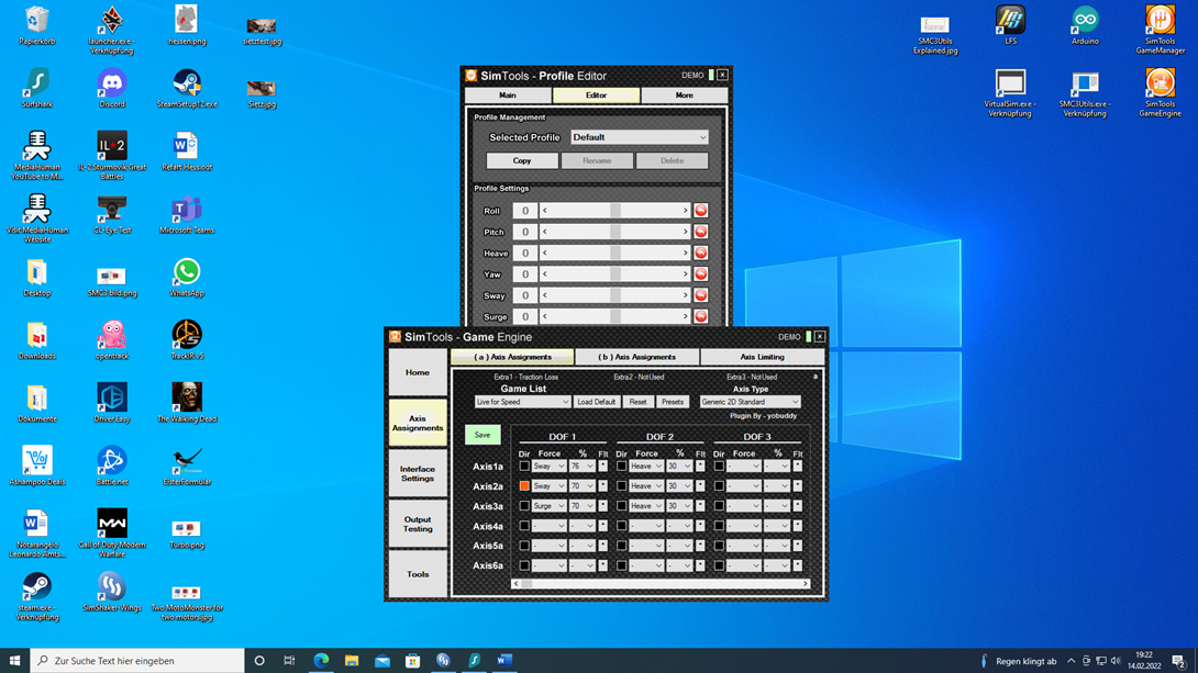

    Help Sim does not work[​IMG]

    What are your Axis Assignments and did it patch successfully?
