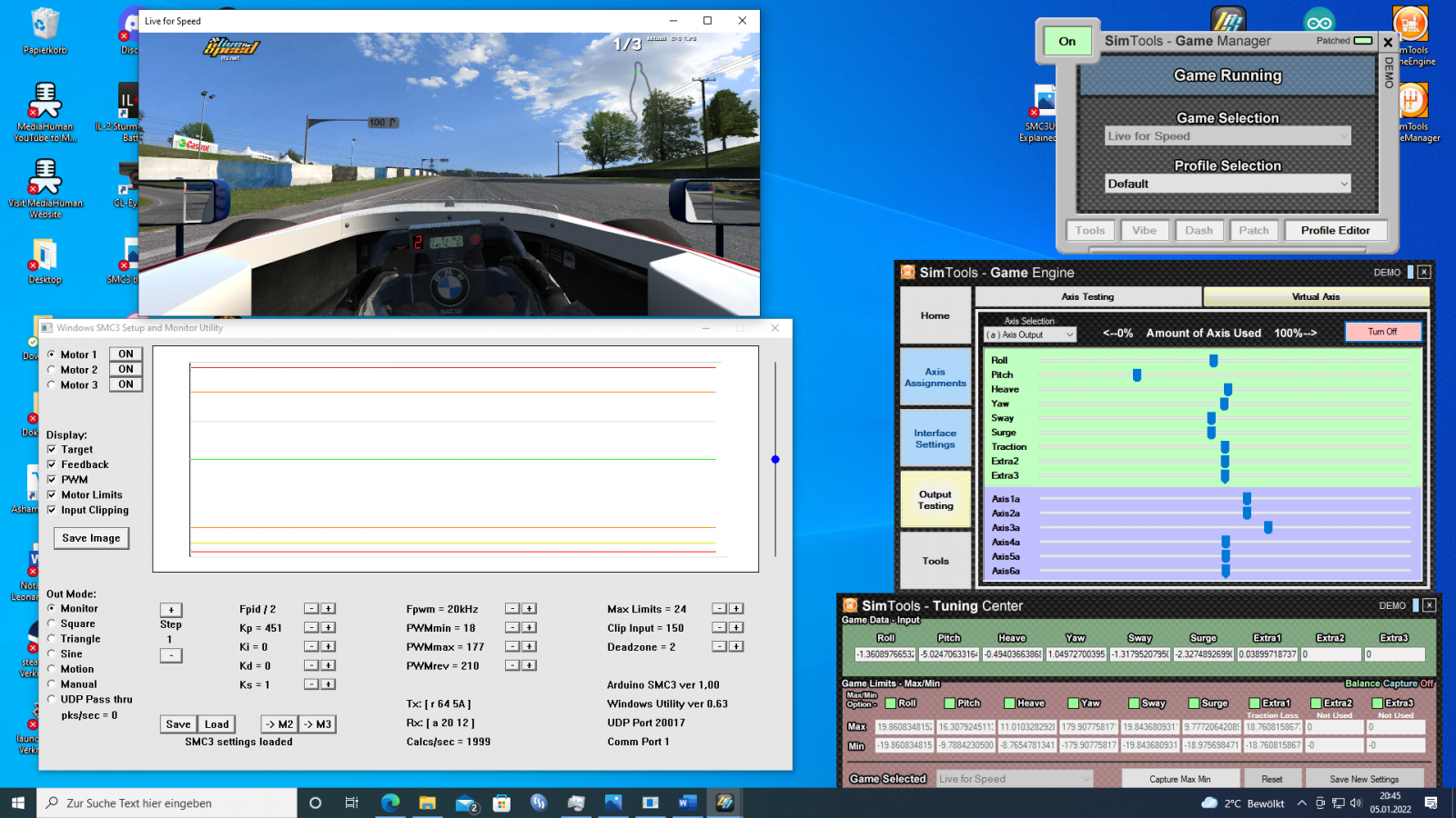

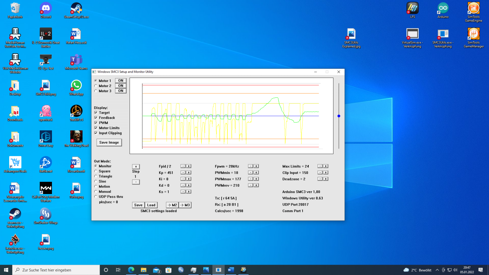

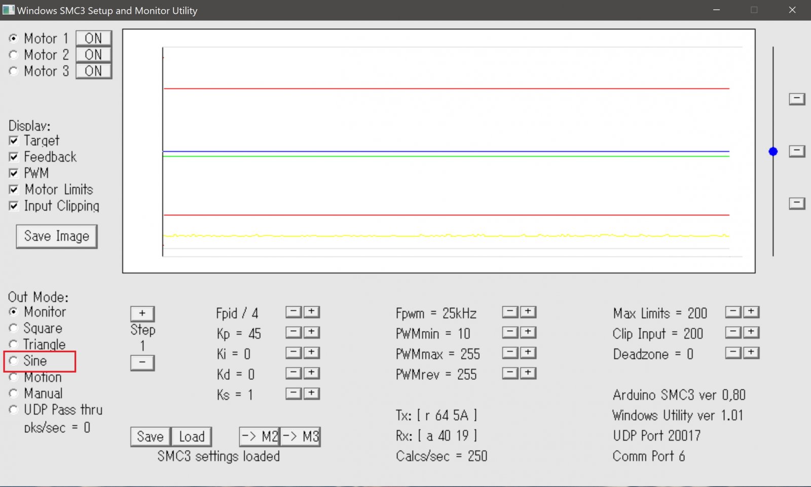

    when i move the podi this is the result and motor turns like left and right and stops
    22,129
    154,400Coins
    +11,181 / 57 / -2
    SMC3 must be properly configured and working as expected before messing with SimTools.
    You can't run SMC3 and SimTools at the same time, it will cause a port conflict.
    The SimTools Tuning Center shows game data, so that part looks fine, but you need to sort out your hardware and SMC3.

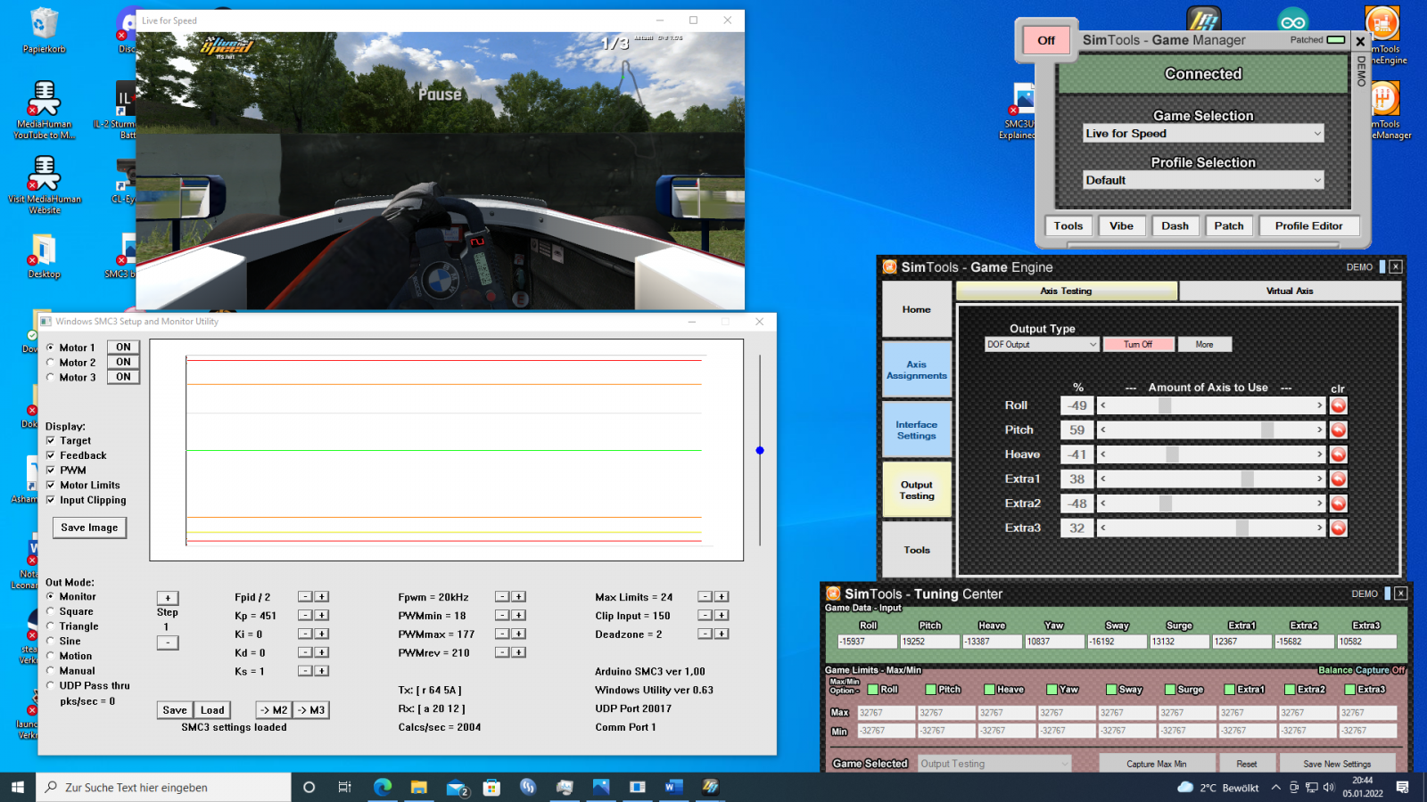

    Do you hear a "peep" when you turn on the sim tools output test?
  8. Skuldi
    Skuldi Member Gold Contributor
    Aug 16, 2020
    53
    Germany NRW
    265Coins
    +37 / 0 / -0
    click on Sine and see if something moves

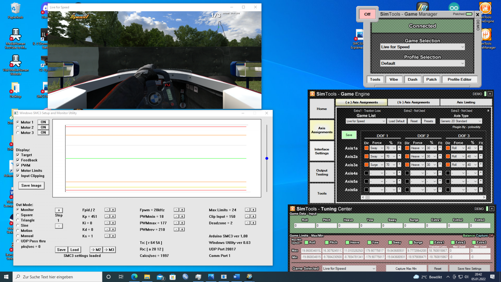

    @noorbeast thank you I thought it had to run with everything I even ran Arduino program with it
    today i will test it thanks :)

    yesterday I could still hear a "beep" when I switched on the output test of the SIM tools, today I don't hear any I don't know why
    22,129
    154,400Coins
    +11,181 / 57 / -2
    I am guessing the beep was a USB disconnect notification.
  12. Skuldi
    Aug 16, 2020
    53
    Germany NRW
    265Coins
    +37 / 0 / -0
    Yes, you get a beep when simtools can not connect with the arduino.

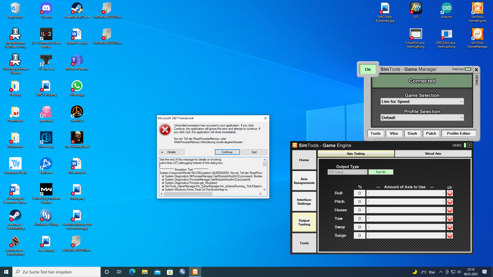

    since today i get this error message
  15. xmcnodx
    xmcnodx IL2 Sim with 2Dof
    Sep 7, 2021
    99
    Schmelzer
    Zirndorf Deutschland
    94Coins
    +19 / 0 / -0
    System.ComponentModel.Win32Exception (0x80004005): Nur ein Teil der ReadProcessMemory- oder WriteProcessMemory-Anforderung wurde abgeschlossen
    at System.Diagnostics.NtProcessManager.GetModuleInfos(Int32 processId, Boolean firstModuleOnly)
    at System.Diagnostics.ProcessManager.GetModuleInfos(Int32 processId)
    at System.Diagnostics.Process.get_Modules()
    at SimTools_GameManager.frm_GameManager.tmr_IsGameRunning_Tick(Object sender, EventArgs e)
    at System.Windows.Forms.Timer.OnTick(EventArgs e)
    at System.Windows.Forms.Timer.TimerNativeWindow.WndProc(Message& m)

    enabled.
    For example:
    <configuration>
    </configuration>

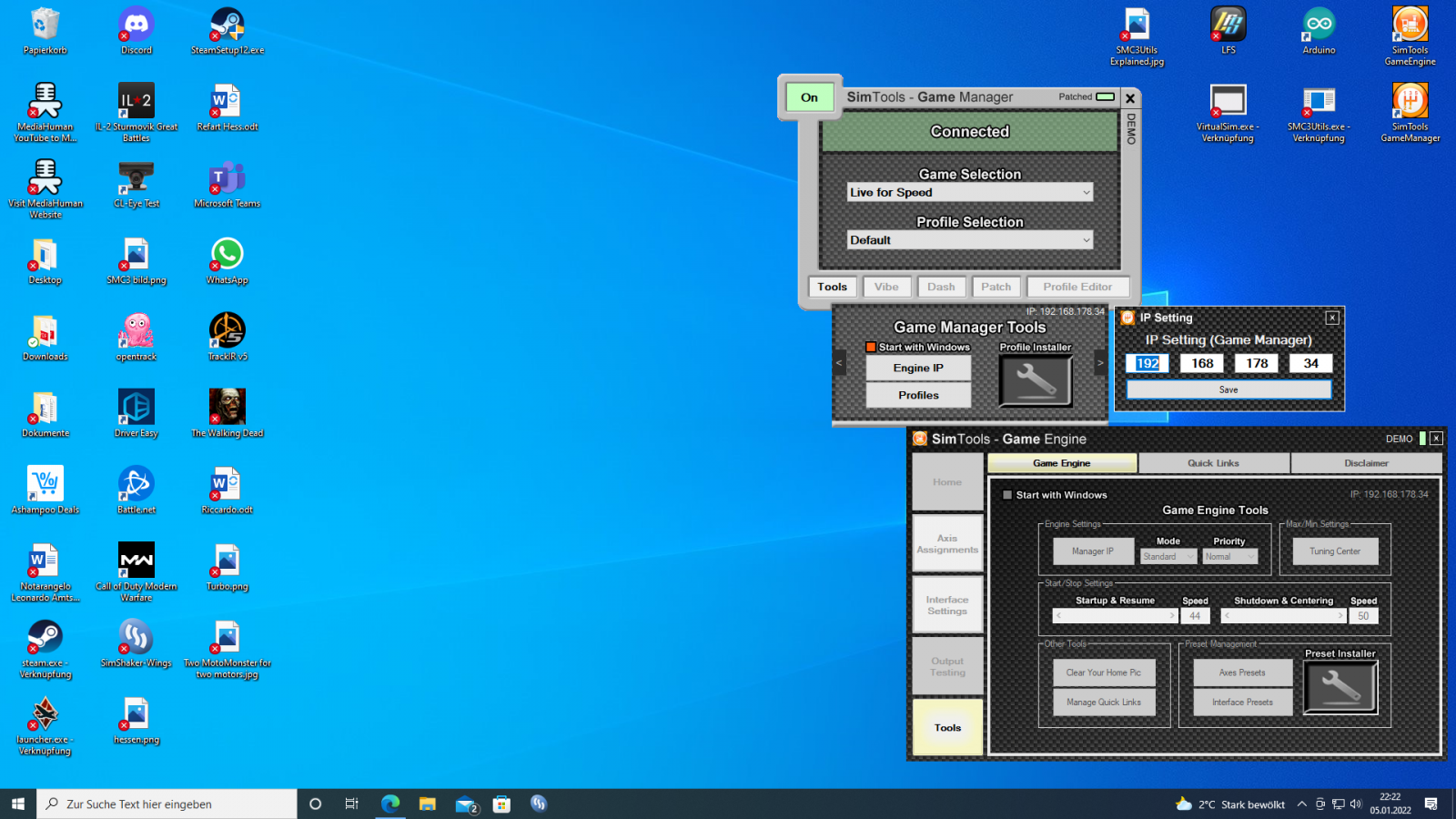

    because of the NET Framework problem i have completely deleted simtools and reinstalled all inputs and yes i have a signal my small test motor jumped from left to right in the game as well as in simtools when testing output
    the NET Framework problem appears but everything still works
    anyway i am happy that it works now i can go on and order the engines
  20. noorbeast
    22,129
    154,400Coins
    +11,181 / 57 / -2
    Good that you are making progress, but you likely need to resolve the .NET issue, as it will probably affect game plugins.
