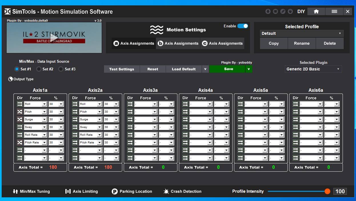

    Hello, en Simtools V3, I don't get movements from the motors in Il2, I see that the telemetry works, the numbers vary, but the motors do not move.
    If I test the axes from simtools the motors work, but the game does not seem to move the motors.

    @Pastrana,
    What does your axis assignments look like for the game buddy?

    @Pastrana did you get it sorted i have the same problem

    @value1 Thanks very much for writing this plugin. For me using my 4DOF platform, I needed to swap the Surge and Sway assignments. They seem to be the wrong way around in the plugin?
    Surge was working on the rudder axis in game and sway was emulating surge. Swapped them around on those two motors and all is good now. Thanks again for the plugin.

    For now it is easier just to reverse the DIR settings, as a quick fix.
    I am flagging it for @yobuddy, as part of the work with the new v3 repository plugin system is standardizing plugin axis settings.

    @noorbeast Thanks for the info mate. Just so you know, I actually had to assign the sway and surge assignments to different motors, i.e sway had to go onto the surge motor and surge onto the sway motor for the axis to do what the plugin was commanding. Not just a polarity change on the motors themselves.

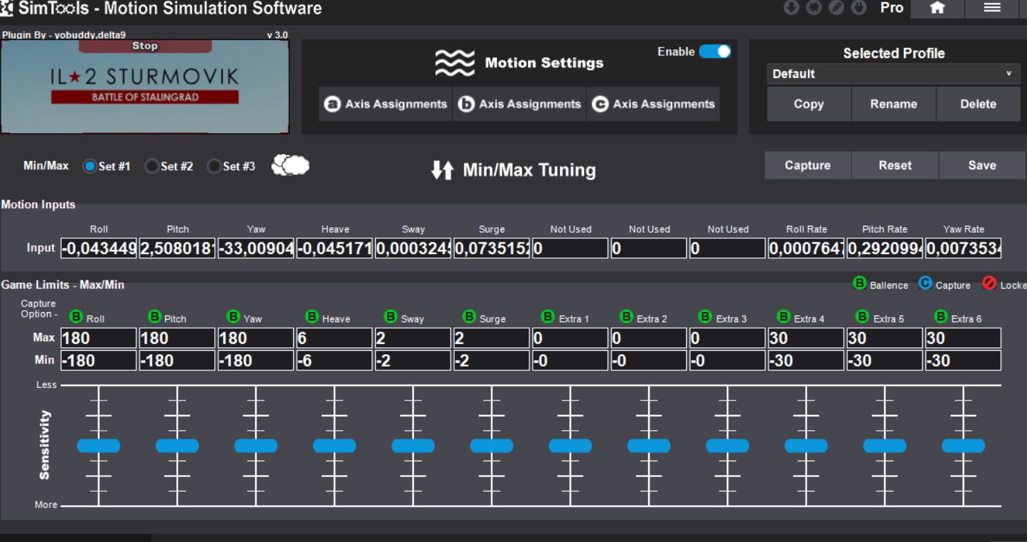

    I just tested this with the virtual plugin builder and I am seeing surge and sway values coming in as they should. I get sway movements when I roll left or right and surge movements when I nose dive and pull up. I am also seeing correct movements in a tank. Have you tried this in a tank?
