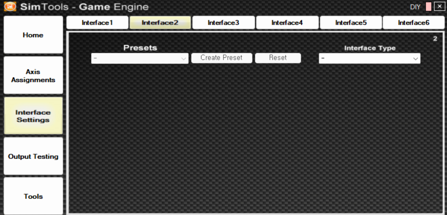

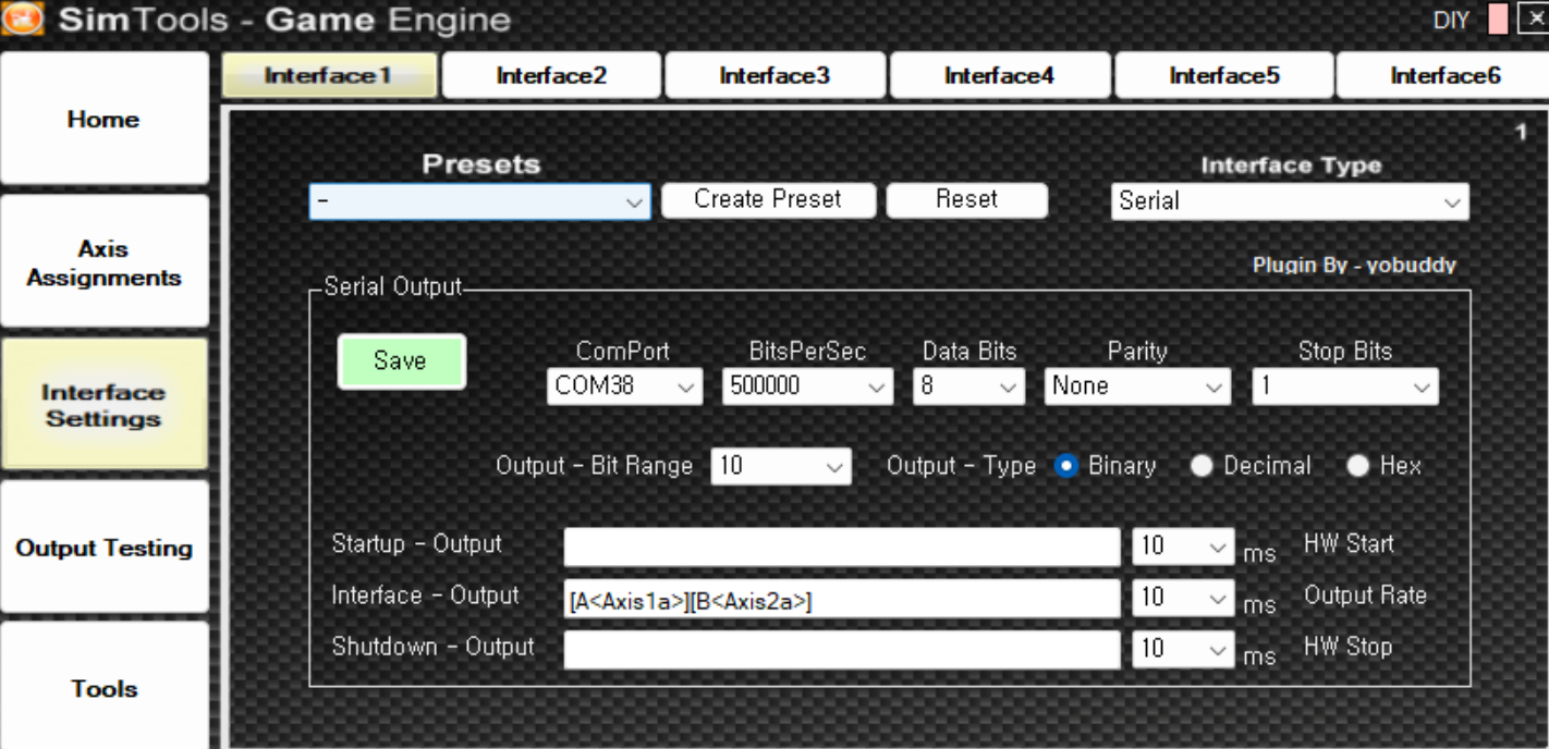

Question idle lever position problem
Discussion in 'SimTools DIY Version' started by Brant, Apr 3, 2024.

    Yes, It looks like your using the same com port for both interface 1 and 2.

    COM Port is just right. It's 38. I disconned all ports except Motion and I checked when 38 was connected then it would work. COM Port is not the problem.

    Are you doing this:

    I don't use Interface 2.
    I downgraded simtools v2.5.
