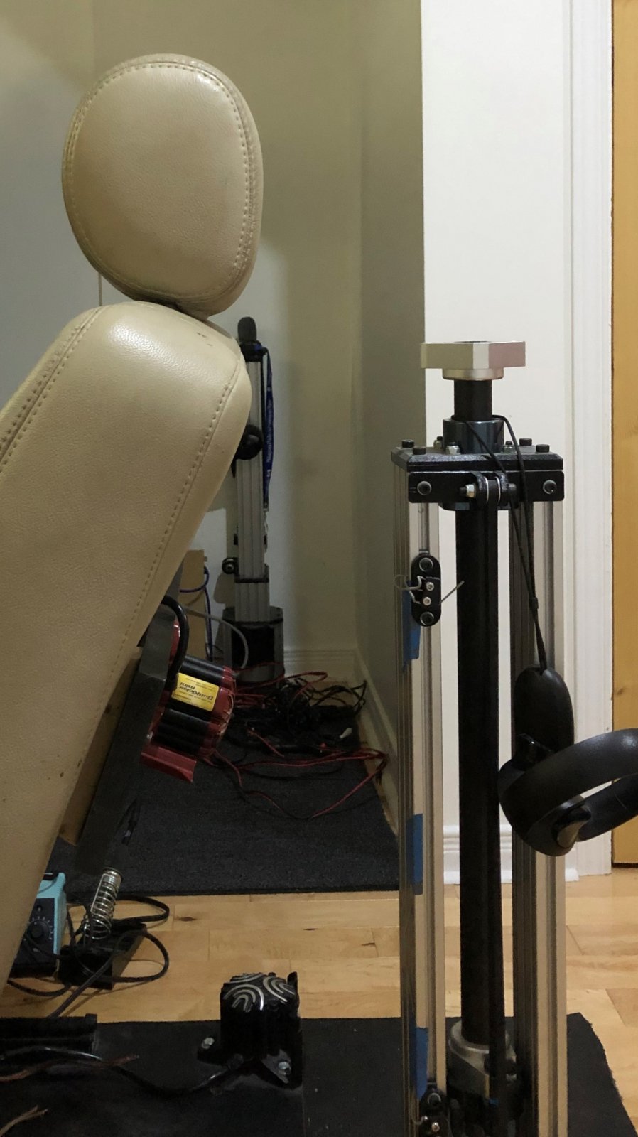

    Fast forward to COVID-19 lockdown and I'm back on simracing. Cannot finish the 6DOF now (time and money), but am willing to take a faster and easier route to use the 2 actuators for a 2DOF seat mover.
    But, imagine the situation, it's a canon to kill an ant: 2 heavy duty 500mm travel linear actuators to move a chair. :)
    Problem is, unless I raise my seat (and platform) considerably, I cannot fit the linear actuator on a standard 2DOF setup:
    (even at a 45 degrees, I believe the actuator is too big).
    Any ideas on how to accomplish this???
    Thanks in advance!
    21,592
    151,215Coins
    What about a 45 degree angle, high mount and use axis limiting or the range of actuator that you could actually use.

    This is what I believe would be the only option... But the high mount would mean higher than headrest. Do you believe it would be ok?
    Limiting the axis will be mandatory in any scenario.
    21,592
    151,215Coins
    It would have lots of leverage, and look a little strange, but I can't see why it would not work.
    Of course the other option is to break down the actuators and make them shorter, to fit the desired use.

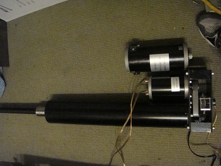

    I was about to pull the trigger on the "Next level style" when I remembered of another option.
    @SeatTime, any cons mouting the motor like your earlier build:
    I can easily modify my actuator to move the motor like this, reducing overall lenght by 160mm, which I believe will be enough.
