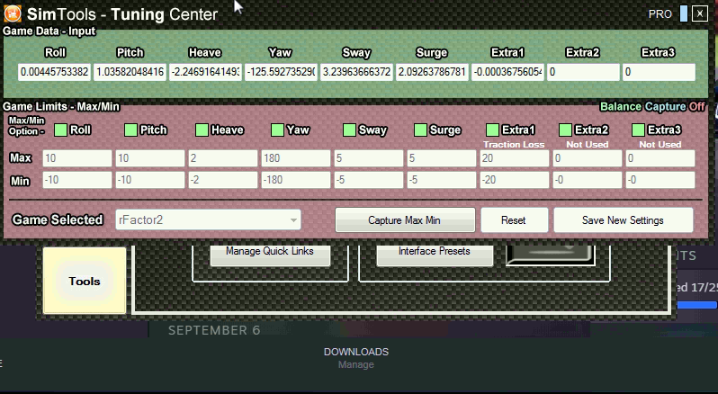

    Can you please post a picture of the Axis Assignment and the Tuning Center while the game is running.
  14. Gadget999
    1,959
    11,983Coins
    +484 / 10 / -0
    here is the tuning centre - I don't seem to be able to access the Axis Assignments whilst the game is running

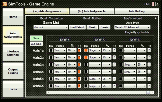

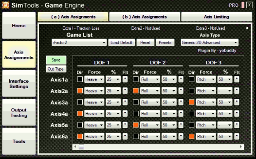

    21,585
    151,124Coins
    The TC shows game data, so it is working, either your configuration messed up or something is interfering.
    Can you please post a picture of the Axis Assignment, the game should not be running.
    Does Output Testing work as expected? f so it is likely settings, if not then likely interference.
