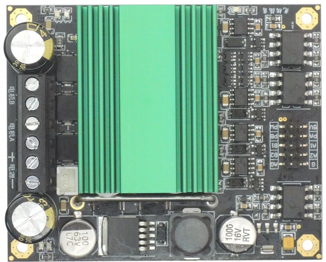

    Hi everyone, new member here, congrats to everyone on all your builds and knowledge! I'm in the process of building a 2dof and have a question regarding the ibt2 controller.
    Does anyone know if 2x ibt2 controllers can be connected to 1 motor to increase the power ? I have read that It might be possible but I'm still not sure. If someone could chime in on this please would be much appreciated. Thanks

    It is possible: https://www.xsimulator.net/communit...tor-driver-more-power.5482/page-7#post-125407

    I use 3 of them on my 6dof sim
    They have been very reliable

    Hi @Gadget999 the 100a controller arrived today, am I correct that it would use mode 1 smc3 ? If so, could you give me a rough idea on how it would be wired ? Cheers

    hi Jason - i wired it the same as the IBT-2 iirc
    how many DOF is your sim ?

    It's 2 dof, currently running smc3 with ibt2 Chinese controllers. Mode 2

    iirc its 2 direction pins and a pwm pin for each channel

    Would that be A1 A2 and B1 B2 are like the pwm pins on the ibt 2 ?

    No i think
    A1 cw digital
    A2 ccw digital
    A3 pwm signal
  13. Jason 1979

    Its a great board, there is a lot of built in protection and it can switch 100A i think it can switch 200a for short periods of time also !
