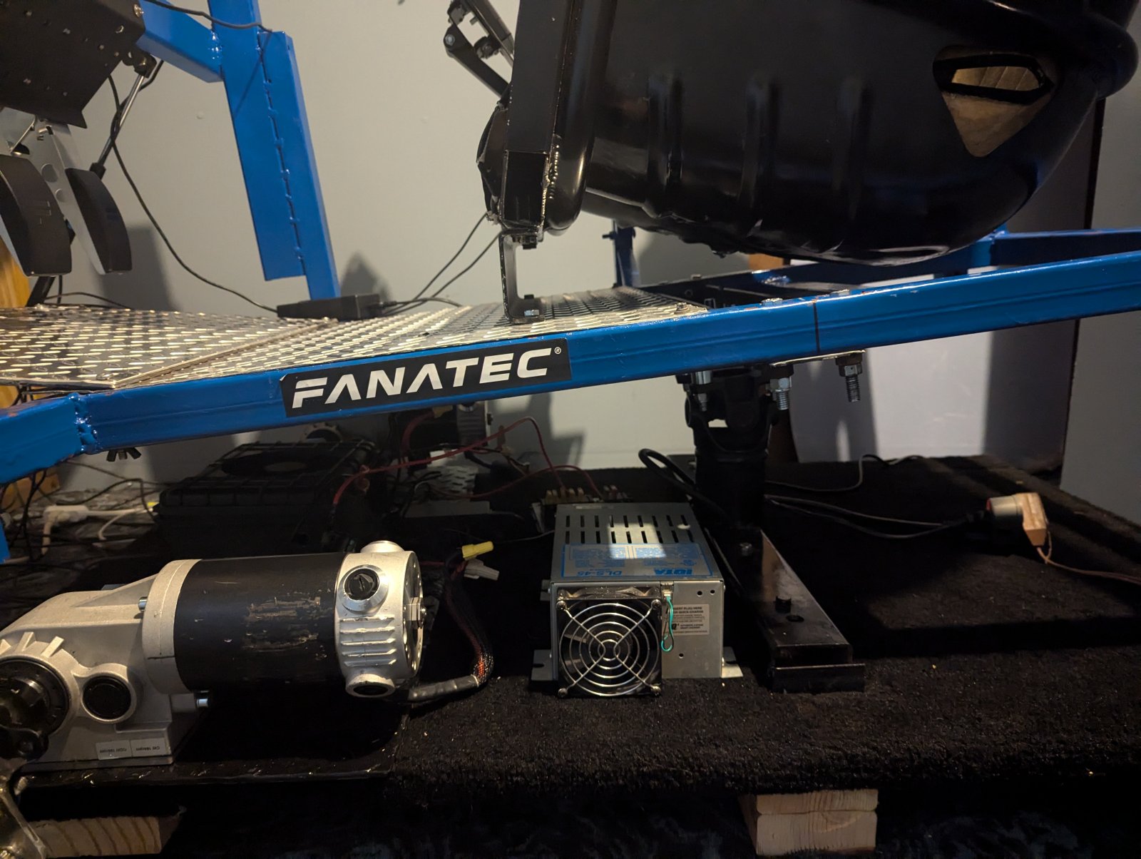

    I have 2 24v motors and when I am using SMC3 Utils, I put one of the motors in motion and it goes up and then down real fast, Something is blowing my IBT-2 and it will put my power supply in safety mode. I guess the motor is back feeding power at the time it goes in the opposite direction fast, It seems to be okay in slow motion. I am wondering what can I do to protect the IBT-2 from getting shorted out?

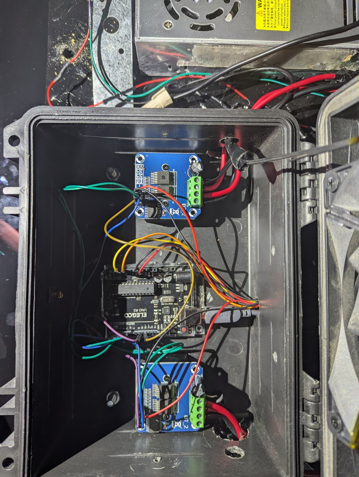

    Ok so I got it where it works fine till I hook the platform to it and a couple minutes later it blows a ibt-2, Can anyone tell me what it could be? PXL_20240818_232215696.jpg PXL_20240818_232328395.jpg
    21,509
    150,674Coins
    +11,018 / 55 / -2
    Are you running 12v or 24v?
    Other members have reported issues running IBT2s at 24v, irrespective of the published specs, dropping the voltage a little seems to make a significant difference.

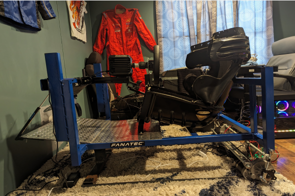

    Wanted to give you a update and maybe this will help others. I found one problem killing My IBT2's was I was asking the motors to pick up to much weight and forcing a lot of amps in to the ibt2's. I moved the u-joint to the center of the weight, And that fixed blowing ibt2's. I felt like after I did that it everything worked but was to unstable, It movement was fast and rough. I swap over to 12v and the movement feels real and smooth. I don't know why anyone would want to run in 24v, The sim feels real in 12v, And in 24v it felt unreal fast and violent. I want to thank you for your help. PXL_20240821_211537462.jpg Screenshot 2024-07-14 113009.png
