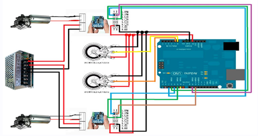

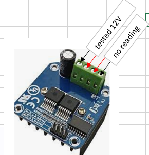

    I am having issue with getting my motors turn on. I followed the SMC3 instruction, schematic for wiring up to IBT-2 with my Arduino. When I tested with multimeter, Arduino code (SMC3.ino) uploaded with Mode 2 selected. I have notice the green line on AMC utility software is on the bottom of the graft.
    I ve got power(12v) on IBT-2 but no power on M+ /M- terminal. I have check many times on the wiring ...everything hooked up exactly as it should be.
    Can someone please help, I have been stuck here for 3 days trying to figure it out...no joy!

    Does the green line move when you turn the potentiometer ?

    No... the Green line doesn't move when i turned my pot. Its stay on the top of the graft. or bottom if i swapped the positive and negative. very frustrated.

    Check the pot is the correct voltage and resistance

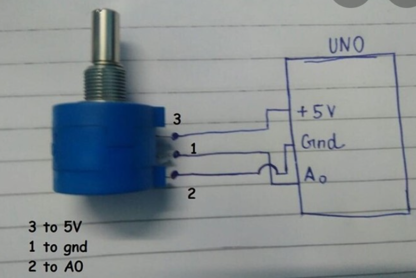

    this is the Pot I am using...I wonder if its a good one?

    My Pot is made by:
    BOURNS
    PN is 3590S-2-103L
    RES 10K ohm +/-5%
  7. Ties
    Ties New Member
    Apr 6, 2020
    - 18Coins
    1 = 5V 2
    1= 5v 2= V+ 3= gnd, 1= red 2 = yellow or green 3= black. Have you tried swapping wire 2 with 3?

    Yes I have swapped. I also checked with multimeter. I am not sure this pot is good for SIM building. I found out it is multi turn potentiometer. not sure it will make any different?

    I have resolved my issue...It turns out it is my Multi turns Potentiometer that isn't compatible. I had ordered this yesterday. Now we wait. ...AGAIN! Haha

    You using Arduino analog port 0. Is the IBT Connected to the correct motor control set for motor 1, 2 vs. 3? The code tells you which PWM control pins on the Arduino control which motor. If you are getting a PWM signal and it is hitting pin 2 on the IBT, you should be good. I you want to follow the ways of the purple path if your POT is on A0.

    After I replaced my Pot, Everything is good to go. It turns out that i was using a multi-turns pot which is causing the problem and green line is not in the center or the chart.

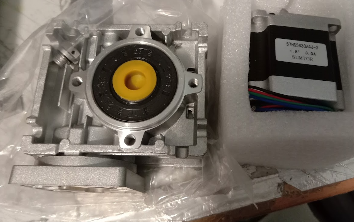

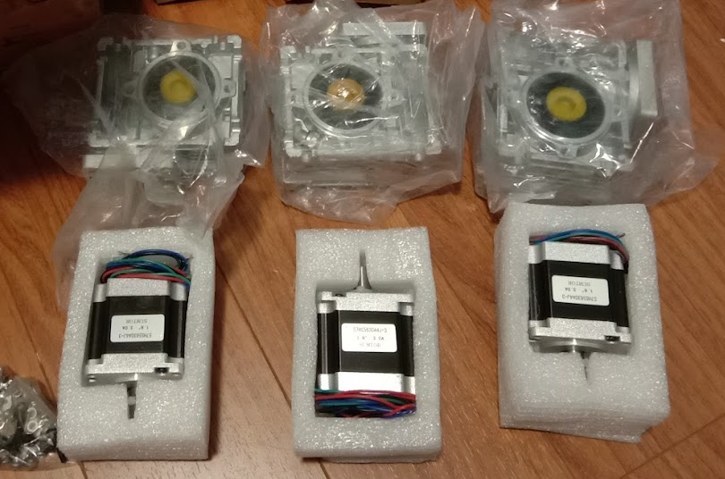

    I just received my new worm gear motors today. it comes with stepper motor. I was wondering if anyone successfully uses these type of motors with IBT driver?

    IBT can't drive stepper motor, I think your idea can't be realized with SMC.

    Yeah, thanks for the respond. I realized that after i read on the forum...I need to use stepper motor driver in order to run these motors. I will also need some code for it too.
