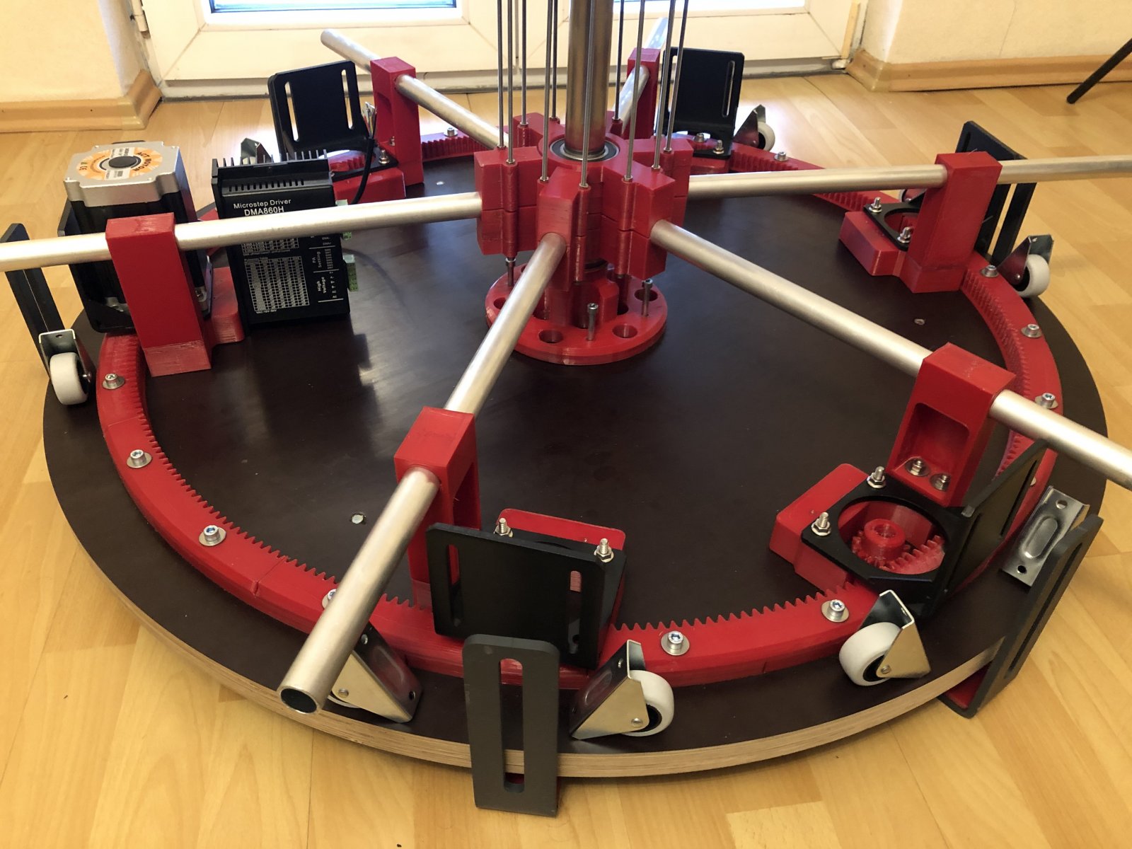

    I am currently building a 6DOF with no limit YAW
    The motors used are
    "Nema34 stepper motor 126mm 12Nm 6A Φ14mm Keyway Bipolar 1700oz-in"
    And the regulator is
    "DMA860H 2.4‑7.2A 18‑80VAC"
    The power supply is a
    "Siemens Delta 48V rectifier power supply"
    my problem is that the motors do not start and brake smoothly with the Arduino code that I found in the forum
    And then the Arduino code does not have to go back to -179 ° at over + 180 ° Yaw, but continue with + 181 °

    I did not look at the code in a detailed way, but the trick for the full rotation, is to travel the shorter distance.
    Imagine you have 10000 steps for a full turn, from 0=0º to 10000=360º.
    If you are at step 8000 and want to go to step 5, the shorter distance is 2005 steps increasing, not 7995 steps decreasing the step, so you will keep increasing the step.
    Like I said above, I'm adding to my software (Mover) this type of rotating Stewart platform, but mounted in a wall.
    Might be my next rig. Need to find a good and cheap solution to build it.
    I see you have the motors rotating (travelling), after 1 or 2 turns it might have a cable problem.
    On my thoughts, I thought of using fixed motors and a kind of cable system, like a big belt to move the joints.

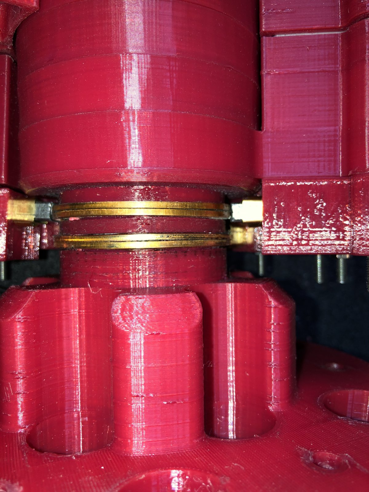

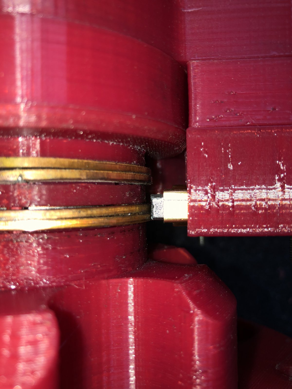

    +2,092 / 21 / -2
    slip rings are fine for logical signals but quite expansive for power
    eager to see more :)

  10. RacingMat
    2,233
    21,068Coins
    +2,092 / 21 / -2
    DIY slip rings! very nice :)

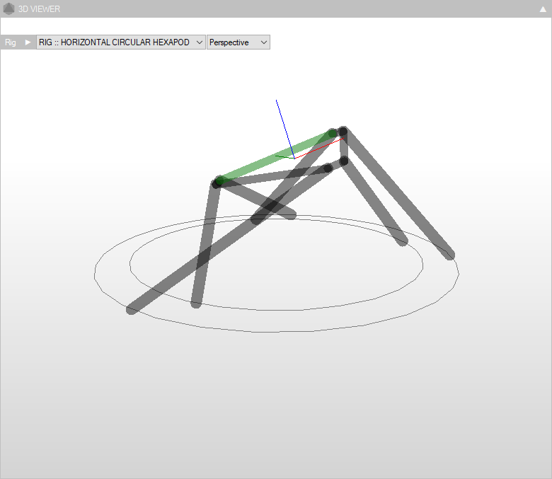

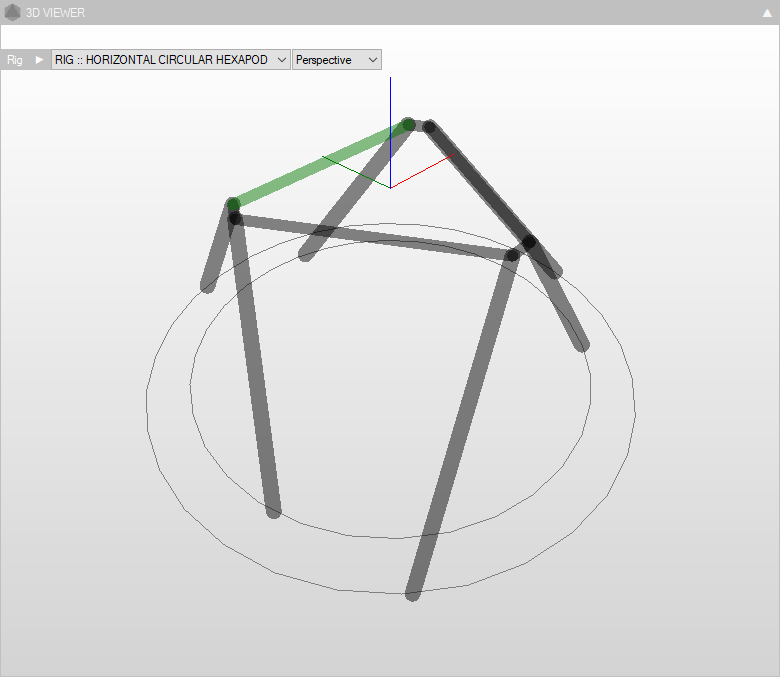

    Been working on this type of rig like I said. Just made some evolution yesterday:
    My objective is the wall mounted rig, but I will keep the horizontal one also.
    Calculation is working, but there's no limits test yet (beyond rod size and overlapping floor joints).

    In this rig, there are no actuators, motors move the bottom joints around a circle.
    I think ranges are less than we have with actuators, but with two circles, we allow the rods to swap positions and then we get higher ranges.
    Not sure I'm explaining it well
    Edit:
    Better explanation
    With two circles, rods can swap positions not colliding. This increases the range.
