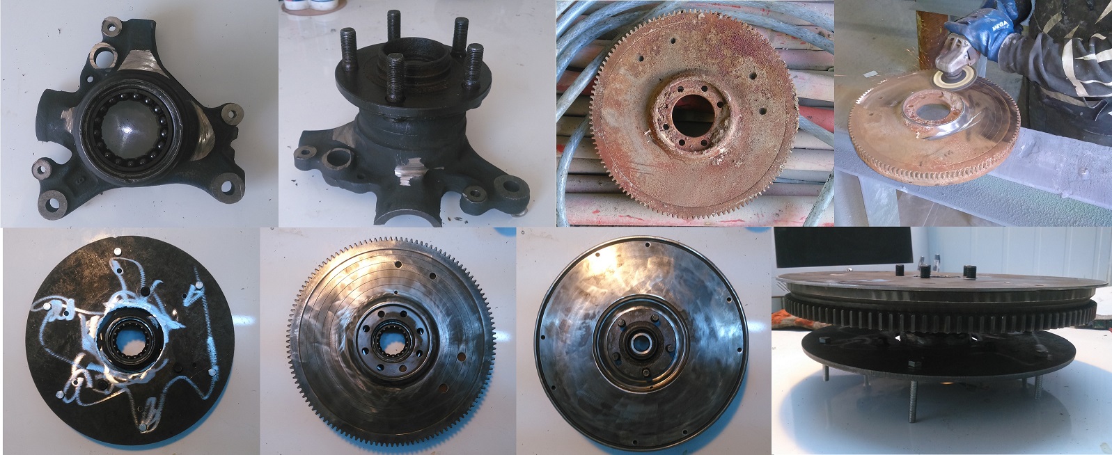

    Hello, friends !
    Here one project decided to experiment:
    Now is time to connect the Arduino and the H-bridge...., and I need your advice;
    - How would you advise to connect such a device to be able to "remap" the rotation of the platform or on the pedals or the steering wheel (depending on run games)
    Thank you.

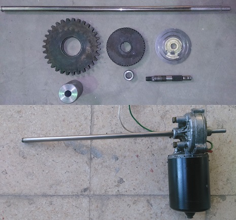

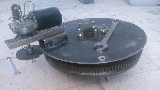

    You're right, it's DIY-roto, all parts I use from the car scrap ))),
    - plz. look at the attached photos and you will understand everything:
    I need your advice on how I can connect Arduino and H-bridge to the platform rotates depending on running games ?
    Thank you.
