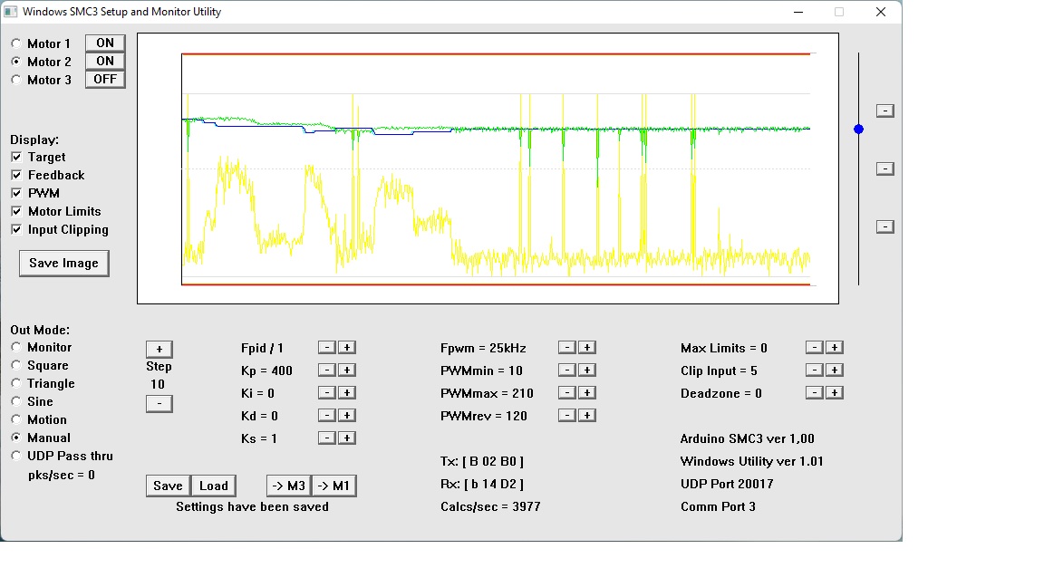

    As the title suggests, I have a problem with the motor calibration on SMC3. Following the tutorial to the letter but the green cursor of the potentiometer cannot be brought to the center, trying to bring the blue target up everything works by moving it to manual but the limits cannot be calibrated.

    Just to be clear with the un-powered motors in their neutral mid position you should be able to remove the pot, turn it by hand until its line is mid graph in SMC3, then carefully reteach the pot.

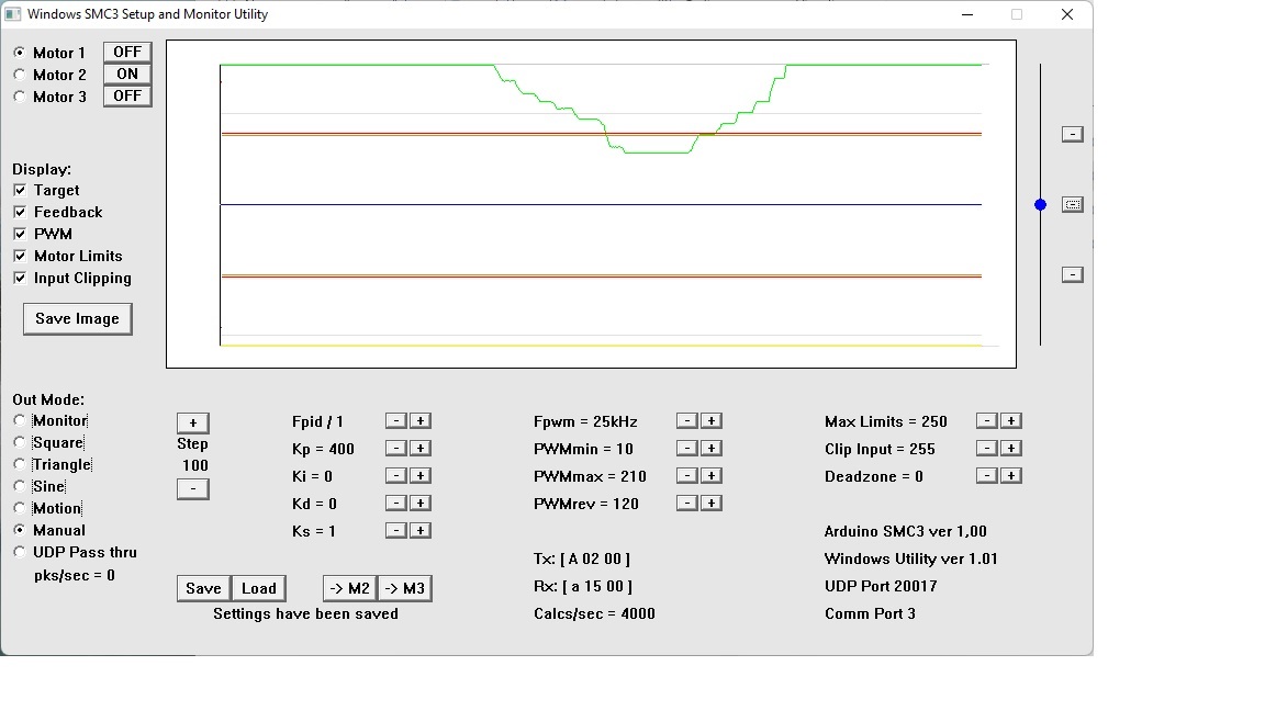

    Hi noorbeast thanks for the immediate answer, in this picture you can see the maximum excursion of the potentiometer, I can not bring it to the center

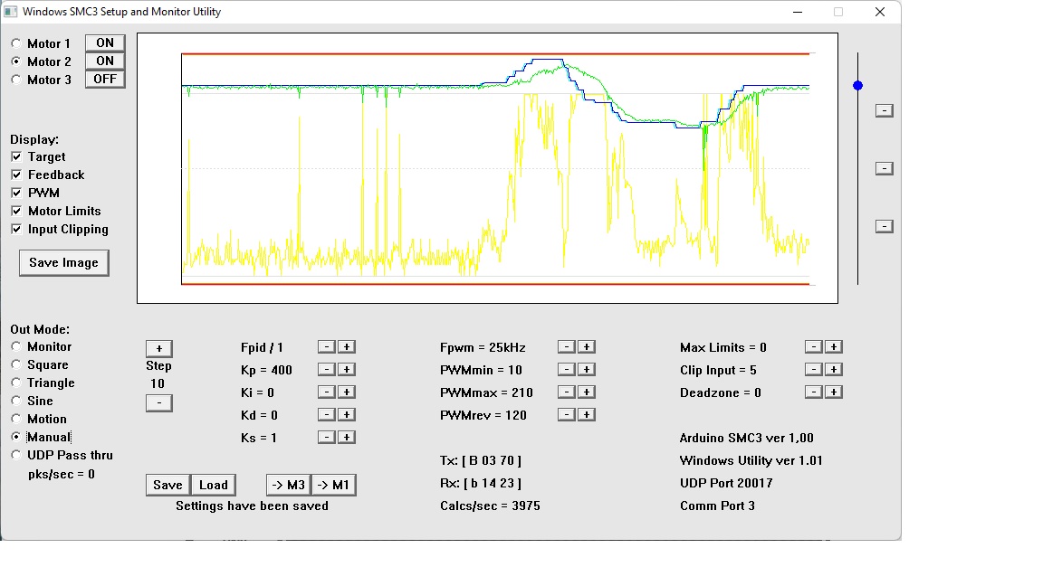

    As you can see from the first image, with the motors powered, by moving the cursor manually the motor behaves correctly by reversing the rotation, only that the limits cannot be adjusted to those values so far away and there is a risk of breaking the potentiometer that I am leaving not tightened.
    21,581
    151,100Coins
    Additionally your Max limit is set to zero.
    Clip Input is very low.
    Clip Input Used to create a band at either limit of the target range beyond which any values sent to the SMC3 are clipped. In addition to this clipping, if the motor feedback does move beyond this range (typically through inertia), the SMC3 will attempt to brake the motors hard by driving them in reverse until they are back out of this limit zone. The value can be anything from 0-255 (however can’t be less than the current limit setting). Reverse braking is applied in the band between the Clip Input and the Max Limit settings. Reverse braking can be disabled - refer to PWMrev.
    Max Limits Used to create a band at either limit of the feedback range beyond which if the motors move (typically through inertia) the SMC3 will automatically shutdown the drivers and keep them disabled until reset. This is essentially a safety mechanism if something goes wrong. The value can be between 0-255 (however can’t be greater than the current clip setting).

    I had to set those values to get the feedback travel inside the limits, if you look at the last image setting the limits correctly the potentiometer excursion stays out and the motors don't turn

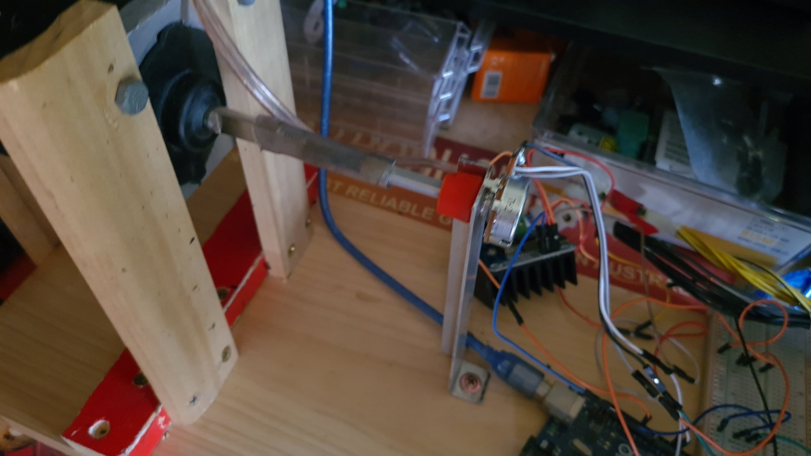

    hi need some help green will not follow the the blue i believe i have wiring rite. thank you

  18. noorbeast
    21,581
    151,100Coins
    And are the posts physically attached to the motors via a coupling?
  19. yaksnip
    yaksnip New Member
    Aug 1, 2012
    6
    - 47Coins

    you are sure you have wired everything correctly.
    Could you post some pictures of the wiring
