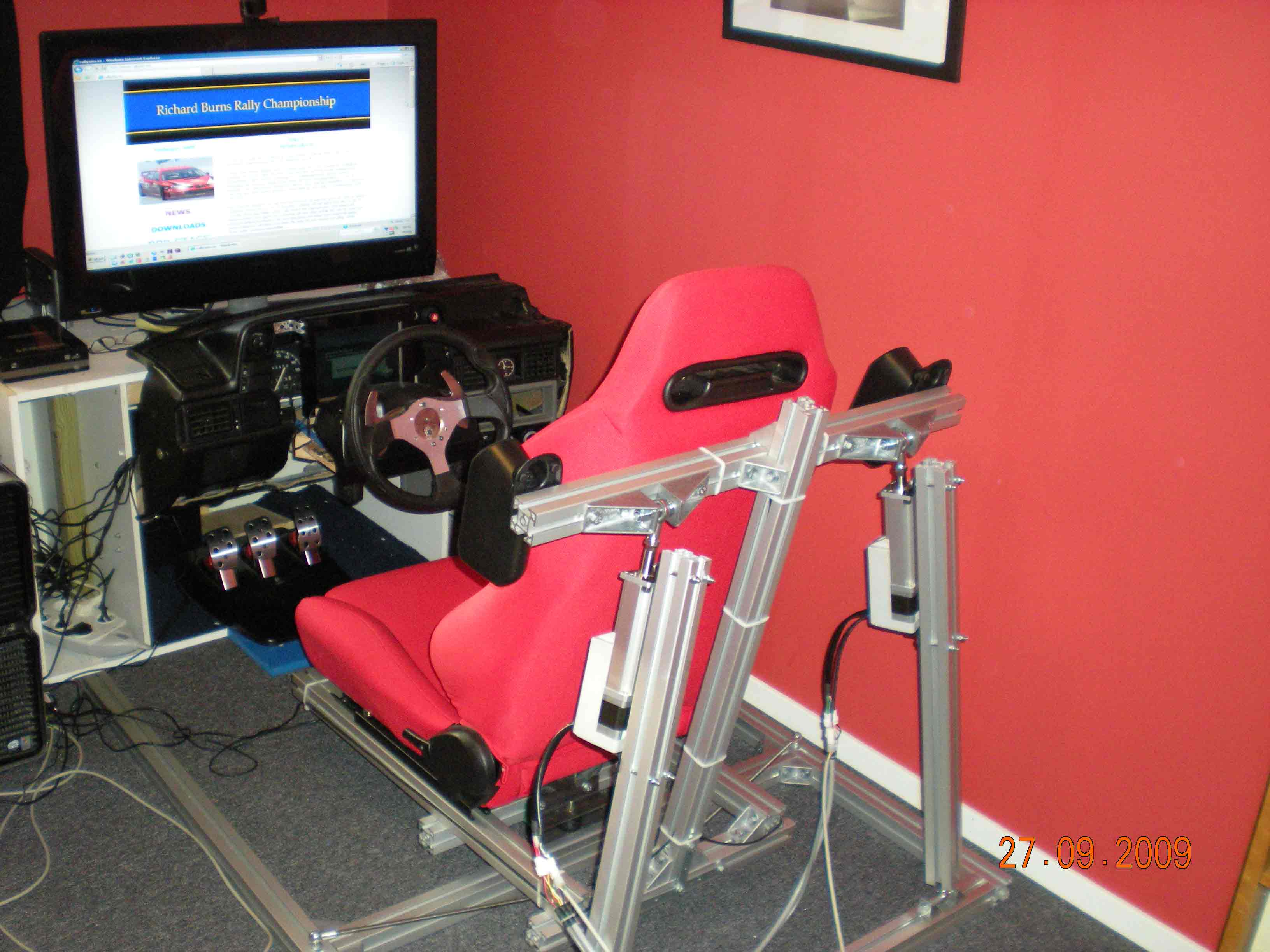

    Finally my x-sim rig is finished!! Had a few problems along the way but with help from you guys
    and a lot of thinking so are they just a memory. The actuators are there in the x-sim Profiler BUT ... i can´t start any game. I´m running -xsim21communityRC4-2103- on ONE computer. When i press data2 -it´s starting to send ,but Nothing happens.
    I have a qadro core cpu,windows xp 32-bits. What´s the starting procedure for this on a single computer? And what do you recommend for basic settings for the acuators?
    I have worked thru the whole FORUM for some hints that will work for my problem,i think.
    Thanks Michael

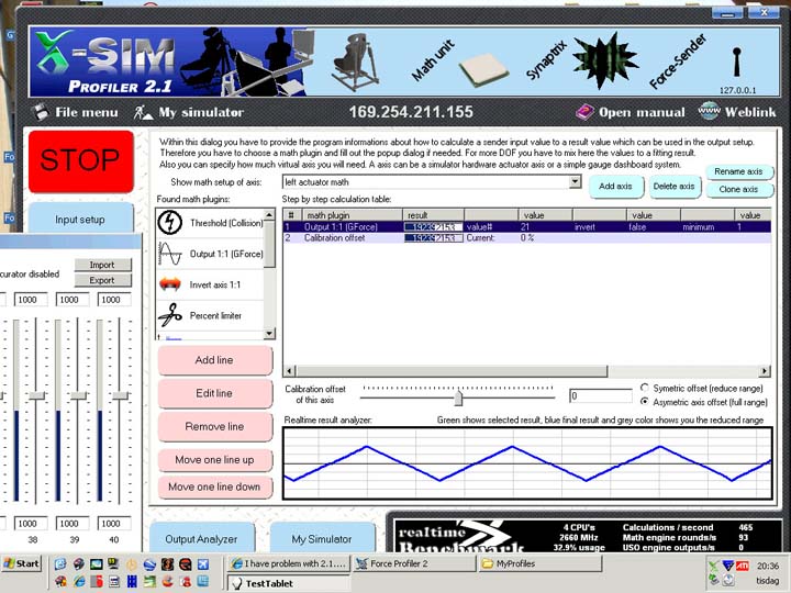

  4. ribban
    ribban New Member
    Aug 1, 2009
    28
    Sweden
    0Coins
    This test worked --------
    1. Insure SCN5 is detected and displayed
    2. Start the sender application and select the test plugin.
    3. let move the test slider 21 in auto mode
    4. press try connect button
    5. go to the math setup and insert a axis
    6. insert a gforce with effect 21 and automode
    7. now there must be drawn a sawtooth line
    8. go to ouput setup and to Synaptrix IO
    7. choose axis and a SCN5 as direct output
    BUT - whith a game nothing happens. Using a HEX adapter and RS232/usb.
    The test worked so the adapter must be ok. ? :?
    Regards Michael

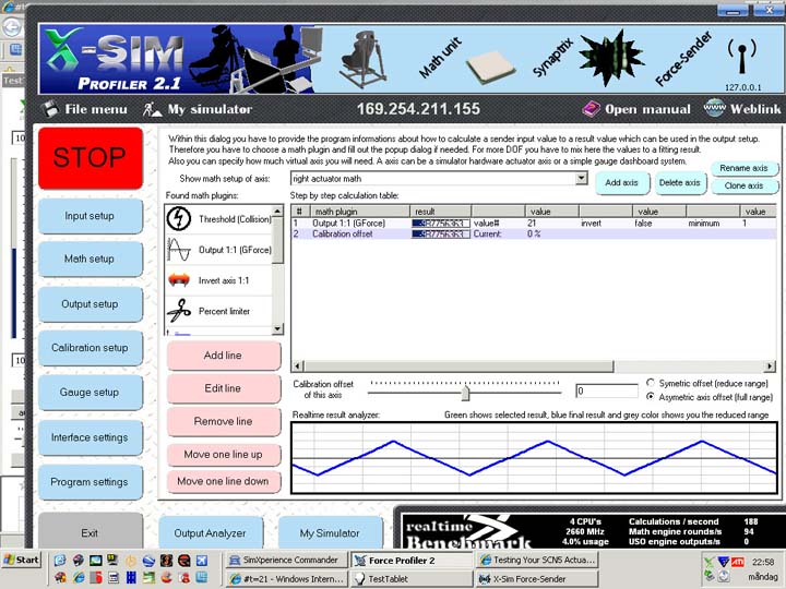

  11. ribban
    ribban New Member
    Aug 1, 2009
    28
    Sweden
    0Coins
    Interface.
    thanks Michael
  12. ribban
    ribban New Member
    Aug 1, 2009
    28
    Sweden
    0Coins
    This and no actuator moving.
    Thanks michael

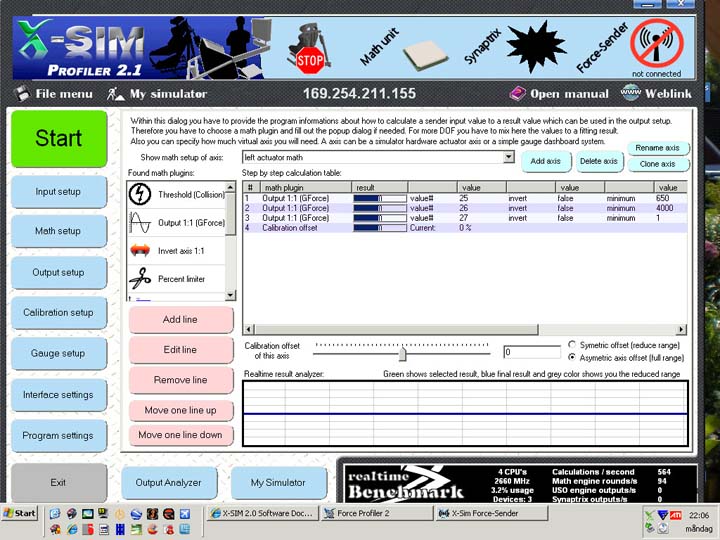

  13. ribban
    ribban New Member
    Aug 1, 2009
    28
    Sweden
    0Coins
    Line change for RIGHT ACTUATOR in the Output Analyzer with LEFT ACTUATOR markt in the MATH SETUP ????
    thanks for helping me, Michael

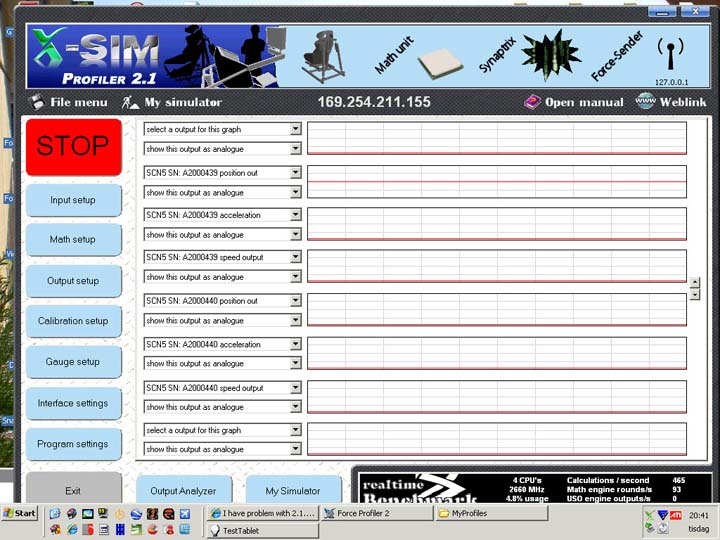

  14. ribban
    ribban New Member
    Aug 1, 2009
    28
    Sweden
    0Coins
    I am SURE that i forgot some setting,but what. :(
    when i follow this video the actuators are moving. http://www.youtube.com/watch?v=L3qTJxwvE2c&feature=player_embedded#t=21
    But not when i put in the data myself see post above.
    Are there any special startingorder for Force Sender and Force Profiler and theres plugins?
    Like-- start Profiler first and choose plugin (+ mabye somthingmore) and then start Sender and choose plugin?
    Regards Michael

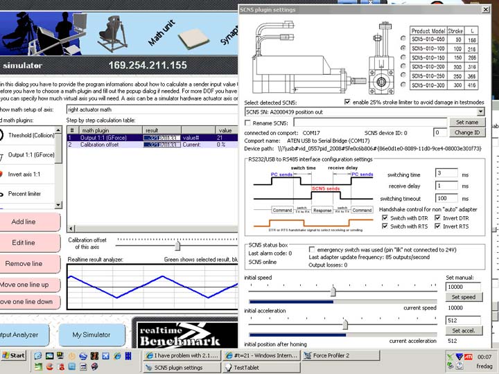

    Just got it working!! :yippiee: Changed the settings in the SCN5 profiler like you suggested.
    Now it´s racingtime!
    MANY thanks to you sirnoname for tips and hints!! Priceless.
    Best regards Michael
  17. ribban
    ribban New Member
    Aug 1, 2009
    28
    Sweden
    0Coins
    This picture is taken while the actuators are running.
    Last adapter update has the value wandering beetwen 83 up to 91 outputs/persecond.
    Hope that is what you mean?
  18. ribban
    ribban New Member
    Aug 1, 2009
    28
    Sweden
    0Coins
    could even set switching time 0 and recieve delay 0.
    Safe as long there are no Output losses ?
    regards Michael
