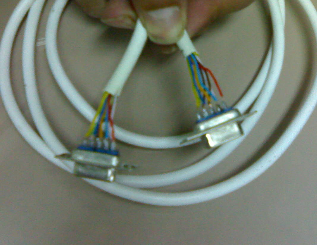

    dear freinds
    lets see the pix of my cable that i made it myself,i dont know if there is any problem
    involve this cable or not:
    i solded every each wire on both sucket exactly the same pin to pin.
    thank you &
    best regards
    Hooshang
  5. tronicgr
    tronicgr
    What operating system? You need Windows XP for the Ponyprog to work perfect. There are some workarounds for Vista/win7 but too difficult for beginners!

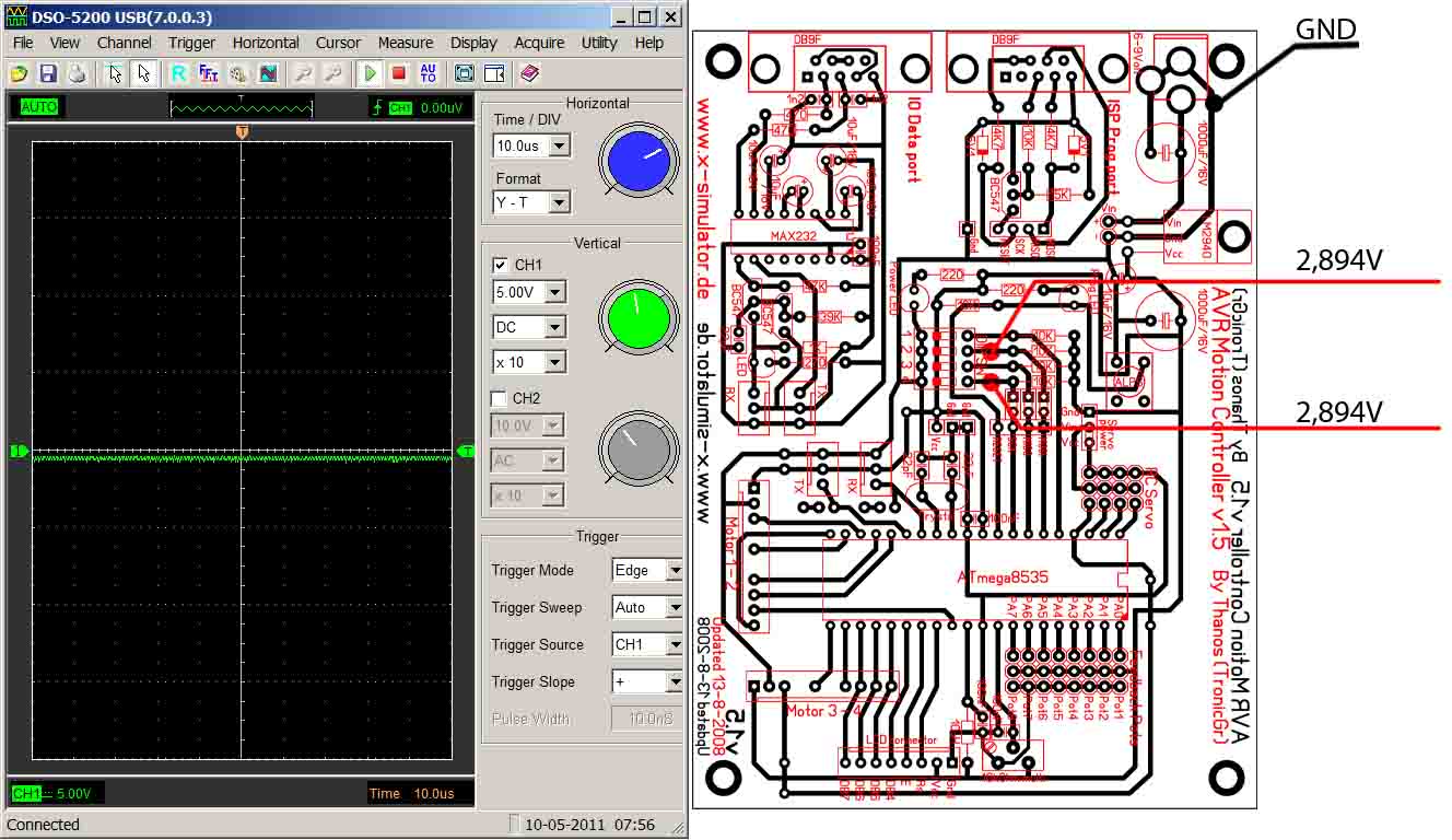

    hi Tronicgr
    my operating system is windows XP
    but as i said before i have extra voltage on sw2 and sw 4
    dont you think my problem somehow involve with this?
    look at this pix
    my board show 4.350 on sw2 and 4.870 on sw4 ?!?!?...
    thank you freind
    regards
    hooshang

    hooshang Active Member
    Jul 6, 2011
    273
    275Coins
    +157 / 3 / -0
    i got it too :yippiee:
    hello freinds
    thank you Thanos
    and also thank you Tonquitesobrigado meu amigo
    as you said it was connection cable :clap:
    best regards
    Hooshang

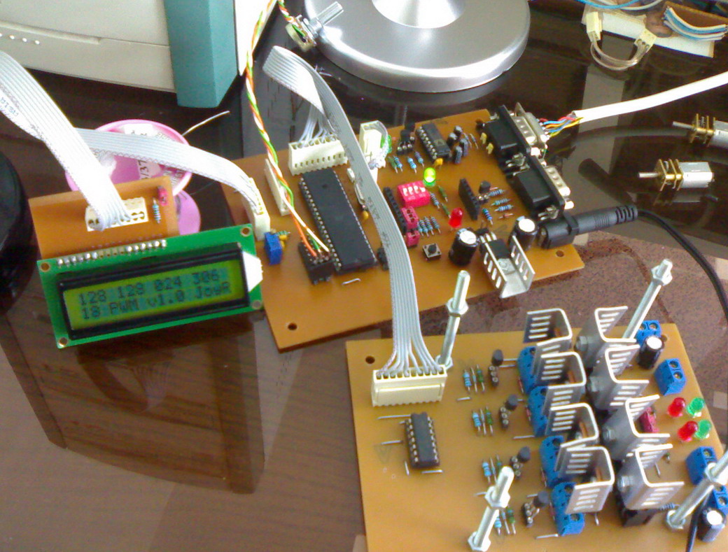

  8. tonquites
    tonquites Member
    Jul 24, 2009
    41
    Joinville, Brasil
    280Coins
    Congratulations Hooshang, :clap: :highfive: :clap:
    I very happy to know its your susseso. :yippiee: :yippiee: :yippiee: :yippiee:
    It was a matter of time before you got too. :rofl:
    Now comes the mechanical simulator, hehehe :thbup:
    One important thing, before turning their windshield wiper motors to make sure they are isolated, because without isolation can cause damage to your H-bridge!!! :eek:
    A big hug for you.
    Regards
    Everton

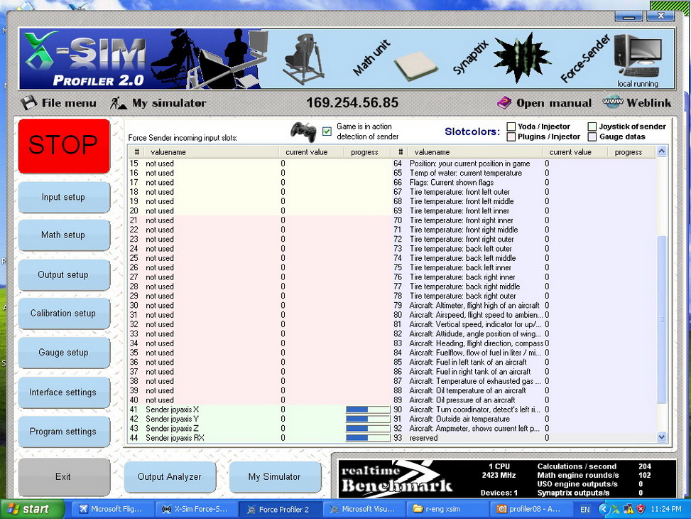

  13. hooshang
    Jul 6, 2011
    273
    275Coins
    +157 / 3 / -0
    hello again freinds
    need help :sos:
    there is still long way
    i have this, there is no values,what is my problem?... :?
    and i have also this !?... :?
    does X-sim2 also support Flight simulator X ?
    regards
    Hooshang

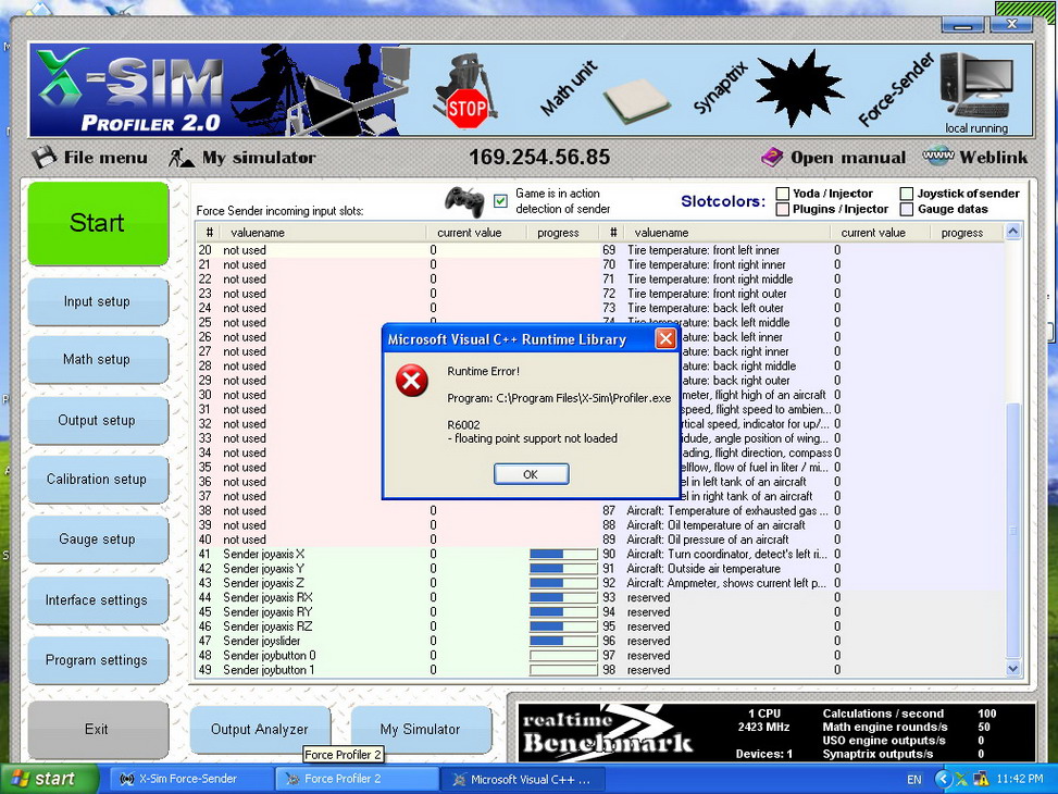

  14. hooshang
    Jul 6, 2011
    273
    275Coins
    +157 / 3 / -0
    hello my freinds
    need help :sos:
    i can't connect force-profiler to my Flight simulator
    i followed profiler manual :no:
    i've checked LAN connection :no:
    use another computer :no:
    but still no values coming to force -profiler
    please tell me what should i do?
    thank you freinds
    best regards
    hooshang
  15. hooshang
    Jul 6, 2011
    273
    275Coins
    +157 / 3 / -0
    hi freinds
    i have fixed all problems :yes: , and now software is connected to
    hardware and i can send commands from fsx to my motors
    but there is another problems of pitch and roll setting,please help me how can i adjusting
    amount of movement :?
    thank you & regards
