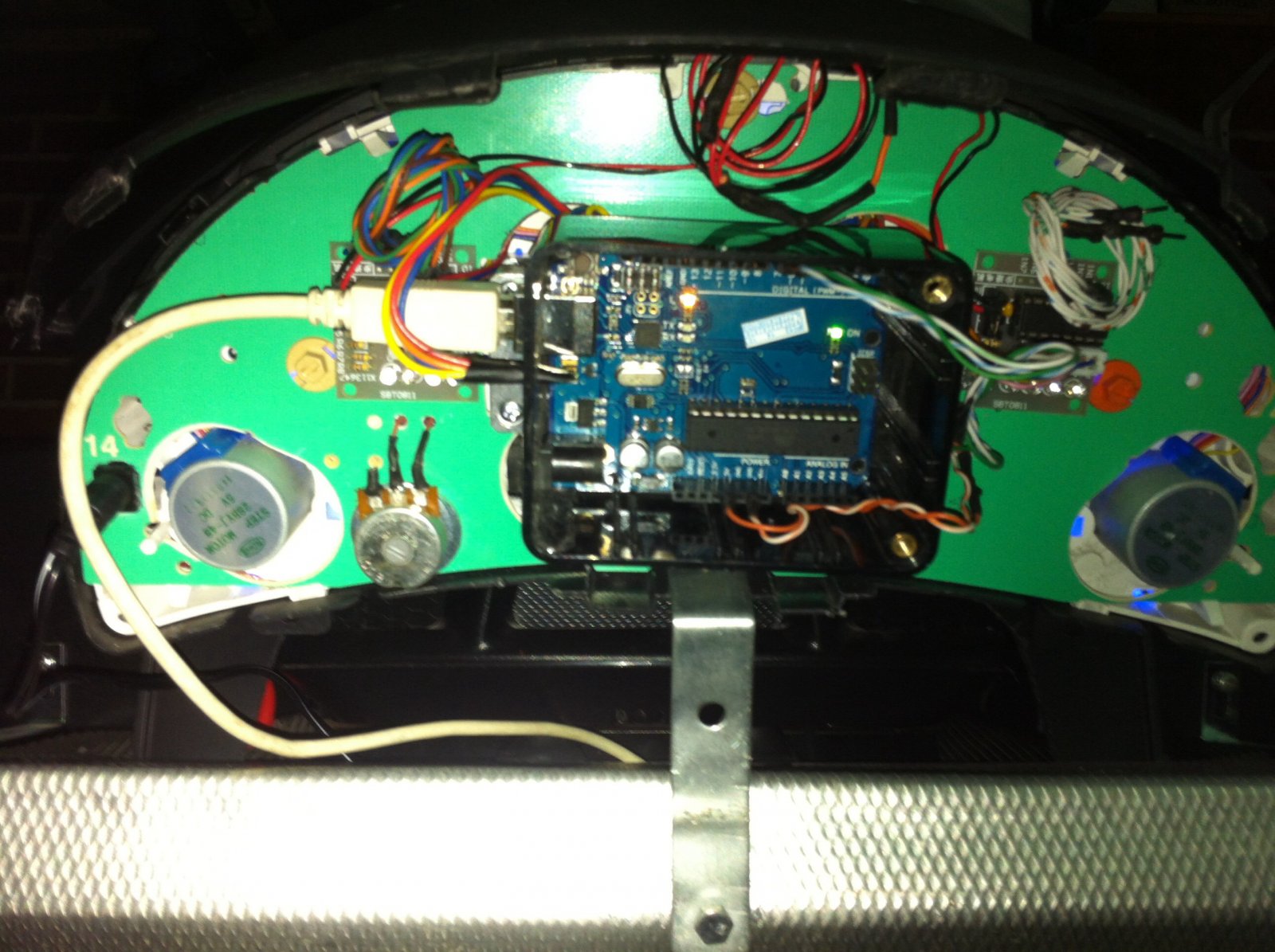

    As per dashboard I have the only Ard code to run steppers as a dashboard by using the GameDash - warning we don't have dashout for any of the codemaster series as yet including the Grid's , sorry.
    Just finishing another dashboard privately , person doesn't like forum sites, and I have known him for a few years so I can trust his not reproducing it for sale, And I can see too that yours is for you, mmm planning another I see already.
    We found mounting the steppers was not a hard task as they are quite small but a hole needed to be cut in the circuit board in order for them to fit.
    Smaller ones on the left and right where fails for running the water and fuel, now changed out for mini RC servos, as they don't need to be fast or smooth like the speed and rpm. Pot adjusts the dashlights, it glows a nice blue.
    As for needles hot glued in place on stepper shaft.
    This whole build will be made posted when finished and all info and codes will be supplied too.

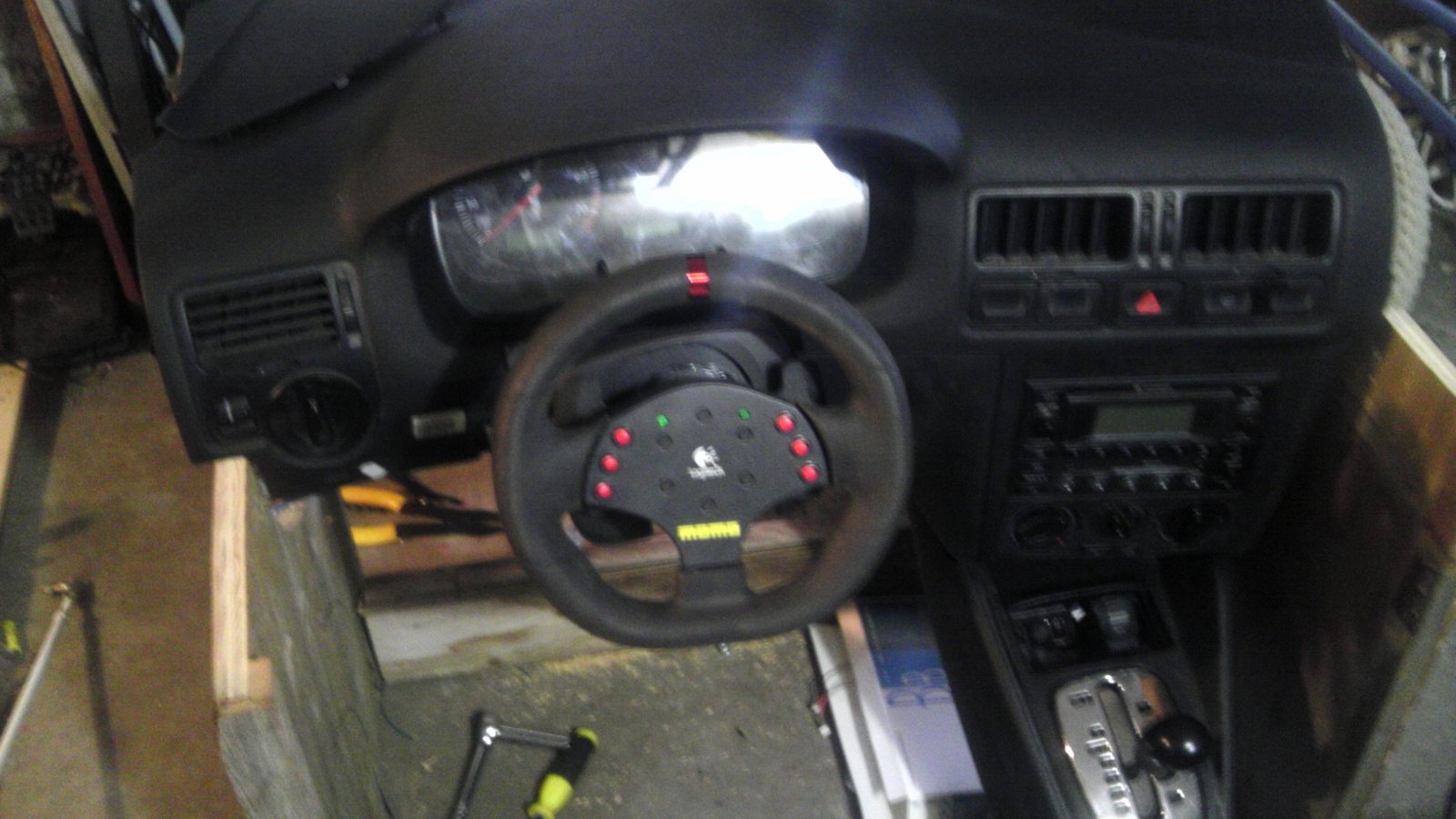

    Step 1 of the dash is finished. Lights are a go and the steering is mounted. IMAG1107.jpg
    It wasn't a easy feat to preform. I had to finally take my personal cars dash apart to figure out the wiring.
    It ended up being pin 20 was positive as the dimmer control and pin26&27 needed to be tied together and positive. Also nothing works unless pin 16 is connected as a always on positive.
    The on/off switch cuts the circuit at the psu pin out.
    The next step will be to start measuring for the frame and platform support.

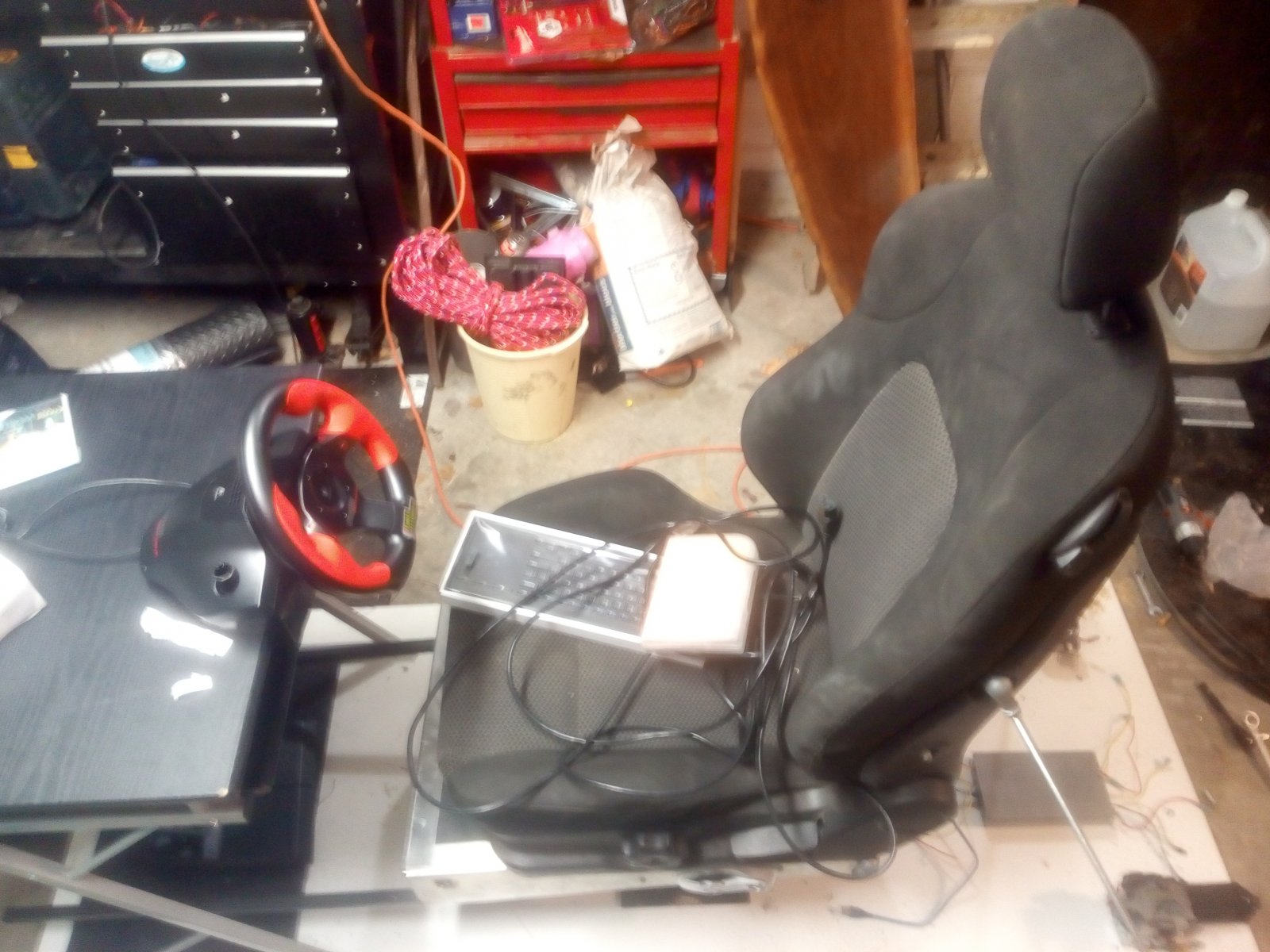

    Iam back after a year of having sat on the car seats sitting in my garage thinking to myself someday I'll build another simulator. I started again and I believe I'm going to change the name of this thread from "new to building a simulator" - "what have I forgotten/ what is new and improved"
    this time I'm using a seat out of a Hyundai Tiburon which side mounted onto to roof railings from a cloth gazebo. I had some stainless steel from an old BBQ which I built around them. I'm kind of starting this thread a little late where I got most of the seat if not all completed I have taken just a few pictures during the process as I was more apt to keep going but I've installed speakers and a subwoofer into the seat' mounted it an old CV shaft I found lying in a scrap yard and I'm going to move it using two Ford Escort windshield wiper motors. Now I'm moving back into the programming aspect since its all built and Here I am rereading my old thread to see " what I have forgotten and what is new"

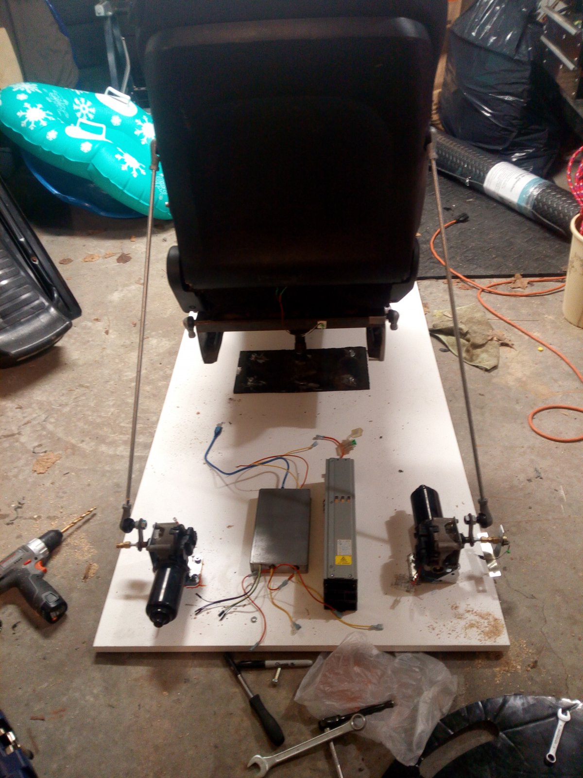

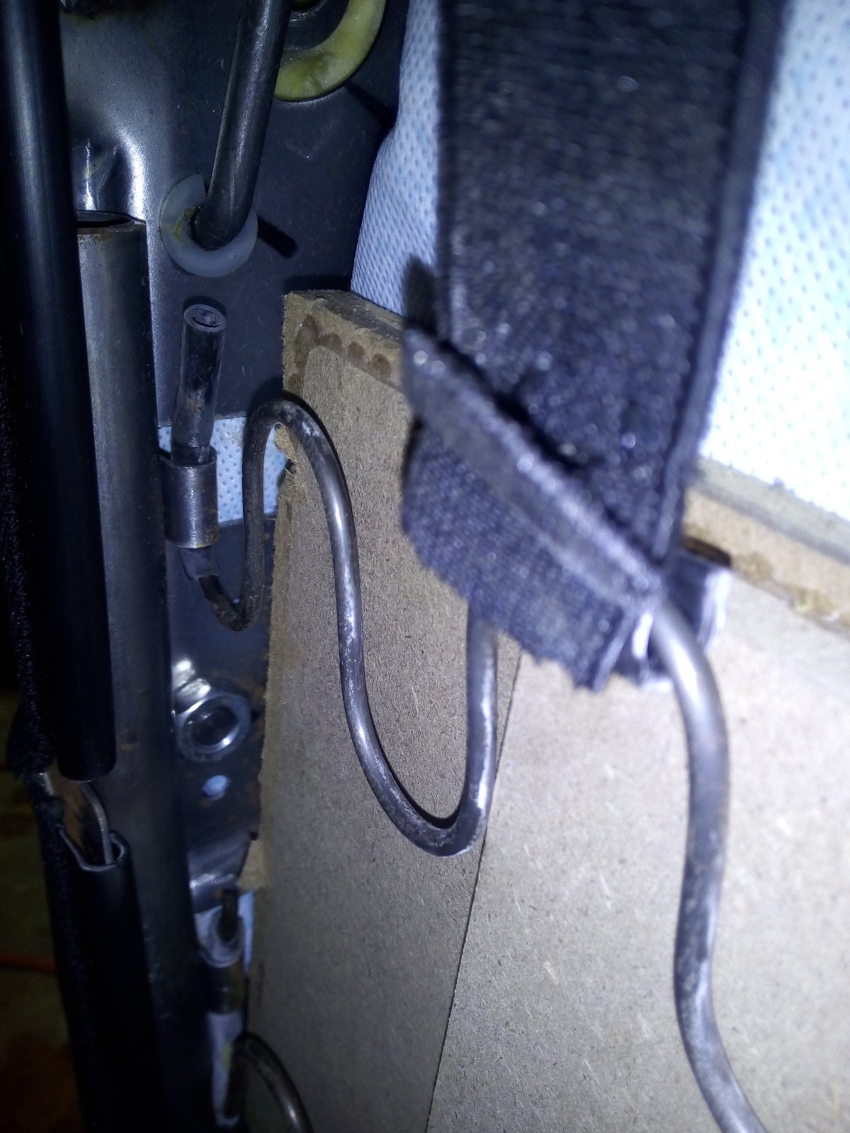

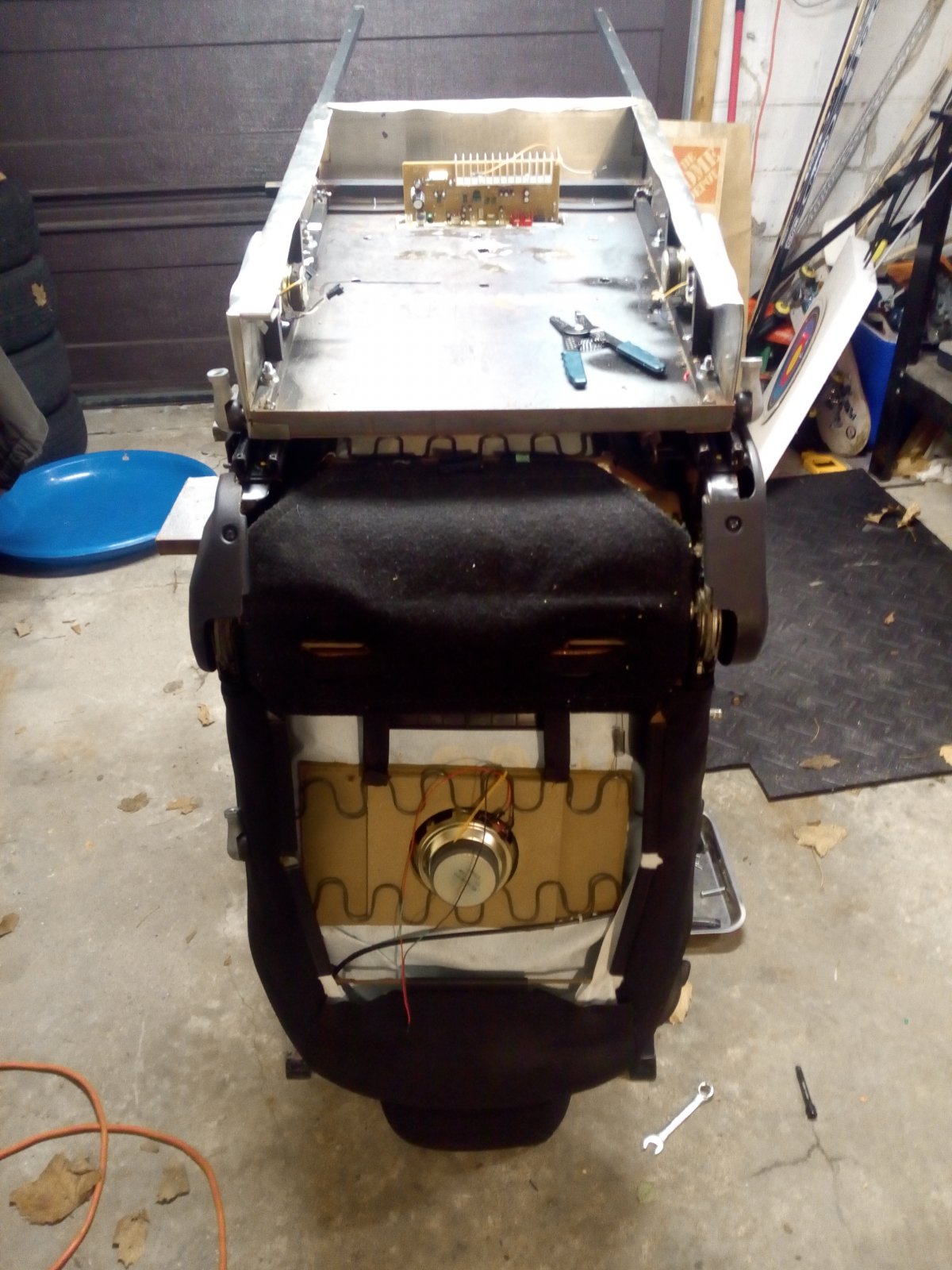

    I bought a Dell 8300 today for $200 to run the simulators program. And here are some pictures of the project in my chaotic garage.
    the first is of the sub in the seat.I ripped it from a old play seat I found at a value village. $20
    The 2nd is if were i found so convenient holes in the tibberion seat frame for my upper tie rod ends.look near the botttom left.
    The 3rd is of the rough lay in of the ard, and motor board. I put them in a silver spray painted vhs box. lol and I thought "well these are useless"
    the forth is the rough placement of the steering deck
    and the last is just a overhead shot.
