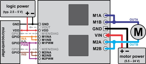

    Is this power supply any good?
    My controll board is rated 12 a continus so I didn't want to go above that.

    Absolutely not! :eek: You’re thinking is in reverse here. You want to have more amps than you should ever need if possible to “supply” everything with enough current aka amps. :) The dual vnh5019 can deliver up to 60 peak amps with both motors. So ideally having that at minimum would be good I would think but you may get by on a lesser amperage rated power supply if it can deliver higher peak amps for a long enough period. Adding more amps than necessary wont hurt anything though in normal operating circumstances.

    Btw Another benefit I didn't think to mention earlier was that if you had gone with two single vnh5019 motor drivers instead of the dual, then you could have gone with individual power supplies on each one to split the load up.

    Or another option would be to buy another dual motor driver and then use it with the one you already have as a single driver like this. This will double the available amperage available to each motor.
    Here is more info: http://www.pololu.com/docs/0J49/7
    @bsft It would be fantastic if Pololu would make a jrk using this configuration also!

    The downside though is if you were to use the full power output of the dual turned into a single, you're back to looking at larger amperage power supplies again! But probably two of them this time! Although a large enough single power supply may get the job done for both drivers like the second one I posted above if you're motors peak amps don't go to high.
