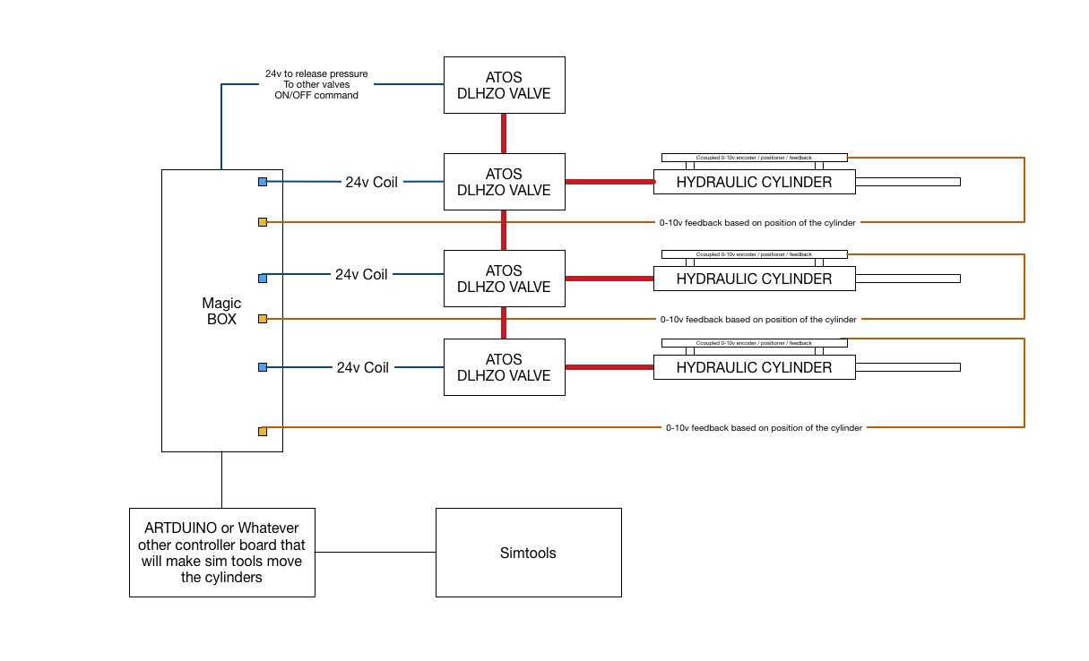

    attached you can find a quick sketch of what I am trying to achieve. basically my objective
    I will draw one up quickly of what in have done to make the cylinder move with the pot and another showing what I have done too blow up my amplifier

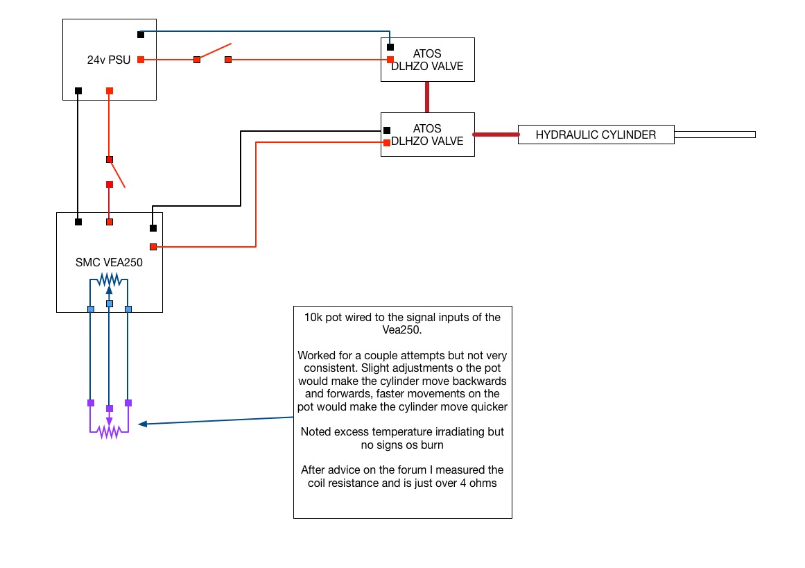

    Attached is a diagram of what I have done top make the cylinder kinda work with a. manual 10k pot and the VEA250, however I noticed a bit of temperature irradiating from the board... Hydraulic sim working with pot.jpg

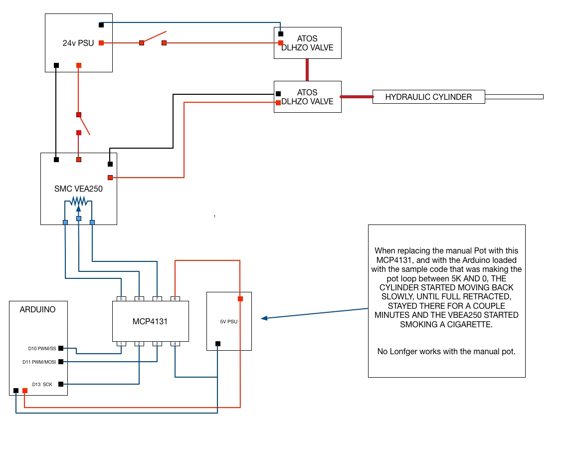

    Attached is the diagram of what I have done with the Arduino/MCP4131 that blew up the Amplifier

    Looking at the specs for the vea250 and altos valve.
    Max output of vea250 1A@24vdc
    Altos valve coil although it is unclear wants about 2A@24vdc.
    Not really surprising that the vea250 burnt out.
    The pneumatic vea250 controller isn't suitable for your hydraulic proportional valve.
    I think the best way for you is to treat the altos valve coil and transducer as a motor.
