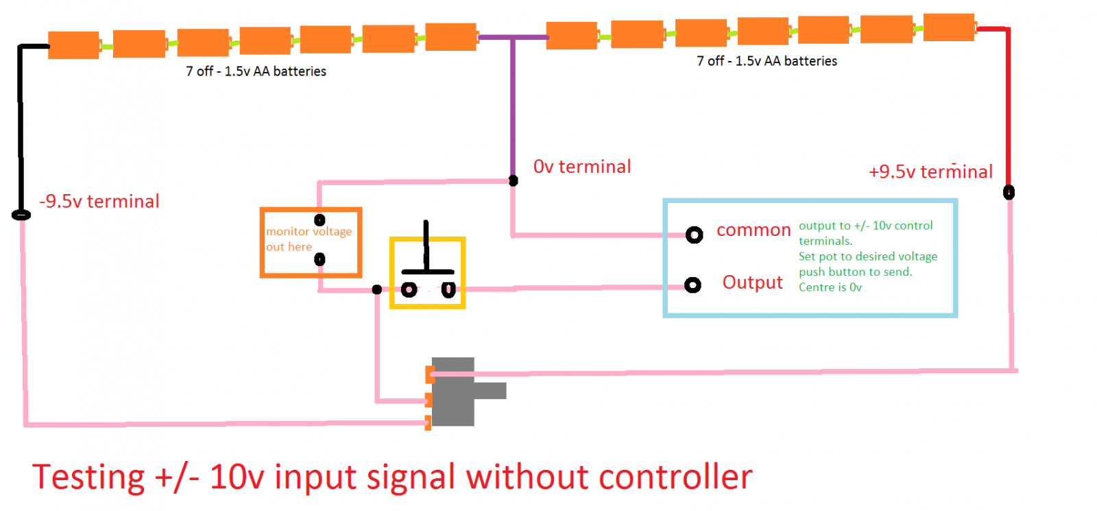

  19. OZHEAT
    OZHEAT Active Member
    Oct 26, 2015
    208
    Australia
    2,459Coins
    +106 / 6 / -0
    3DOF, DC motor
    @Marco Dias
    here is a simple drawing of a control for testing +/-10v control valve.
    Disconnect batteries when not in use as it draws current through the pot and will flatten your batteries
    You can also use 9v batteries.
    Set the voltage you want via the pot monitoring voltage with a multimeter. Button is there for safety.
    Push button to send signal, release button to stop
    I'm not really sure where you are headed with the SMC controllers.
    You need to draw up a plan of what you need/want to do, without a plan you are going to be wasting a lot of money.
    To me all you really need is a signal conditioner and rufus' smc ardinio code(maybe modified depending on type of signal cond you use).
    Easiest wäy I can think of doing it is to mod smc to output 0-50-100% pwm with no dir. Send pwm to a +/-12 op amp and bobs your uncle...
