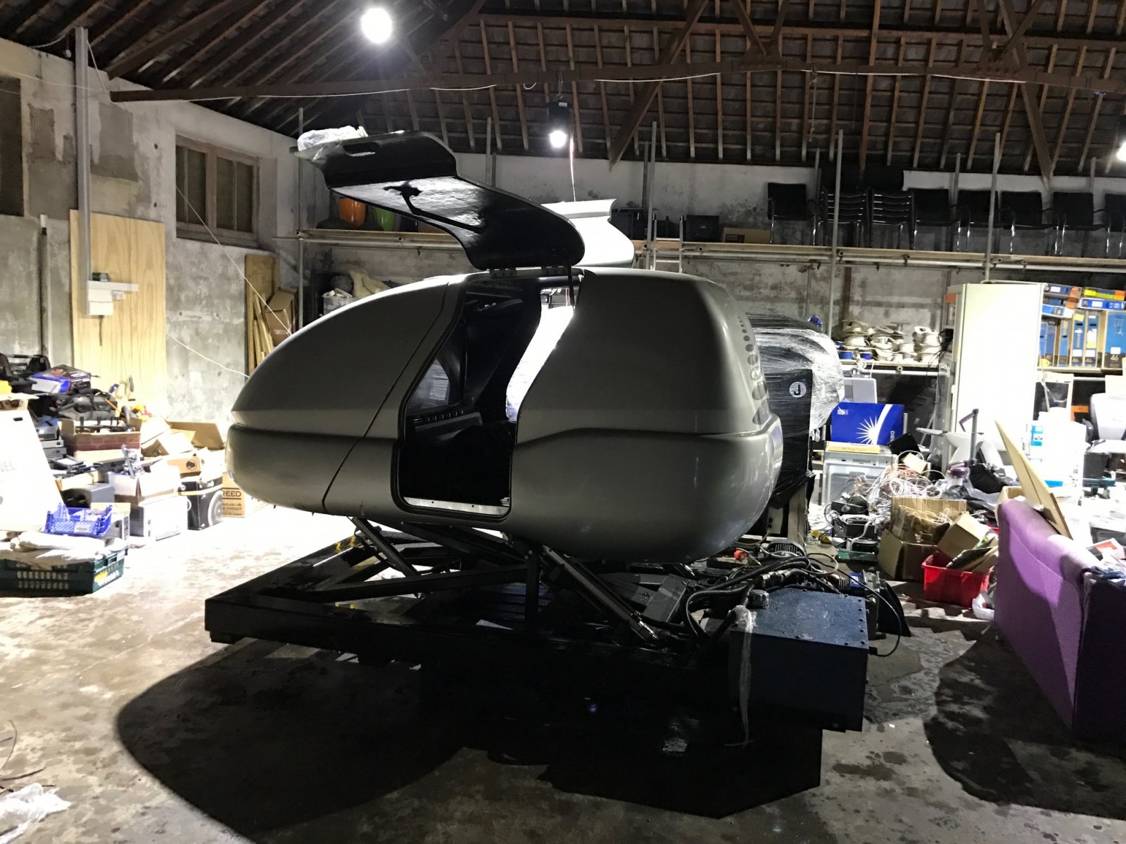

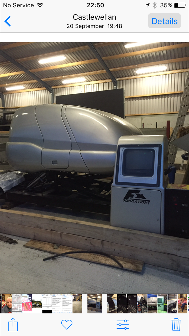

    DEAR ALL
    I HAVE BOUGHT MYSELF A VERY LARGE AND OLD HYDRAULIC SIMULATOR
    THE PRODUCT IS A FX SIMULATION MIRAGE U2
    I would like to convert this machine to work with a racing simulator..
    'For now I am not bothered what game will work and not.
    Will be happy to make it work with any game at all... flight or racing sim.
    I would like to hear your opinions and if there is any pros reading this some guidance/ help would be appreciated.
    Many thanks for reading.
    Marco

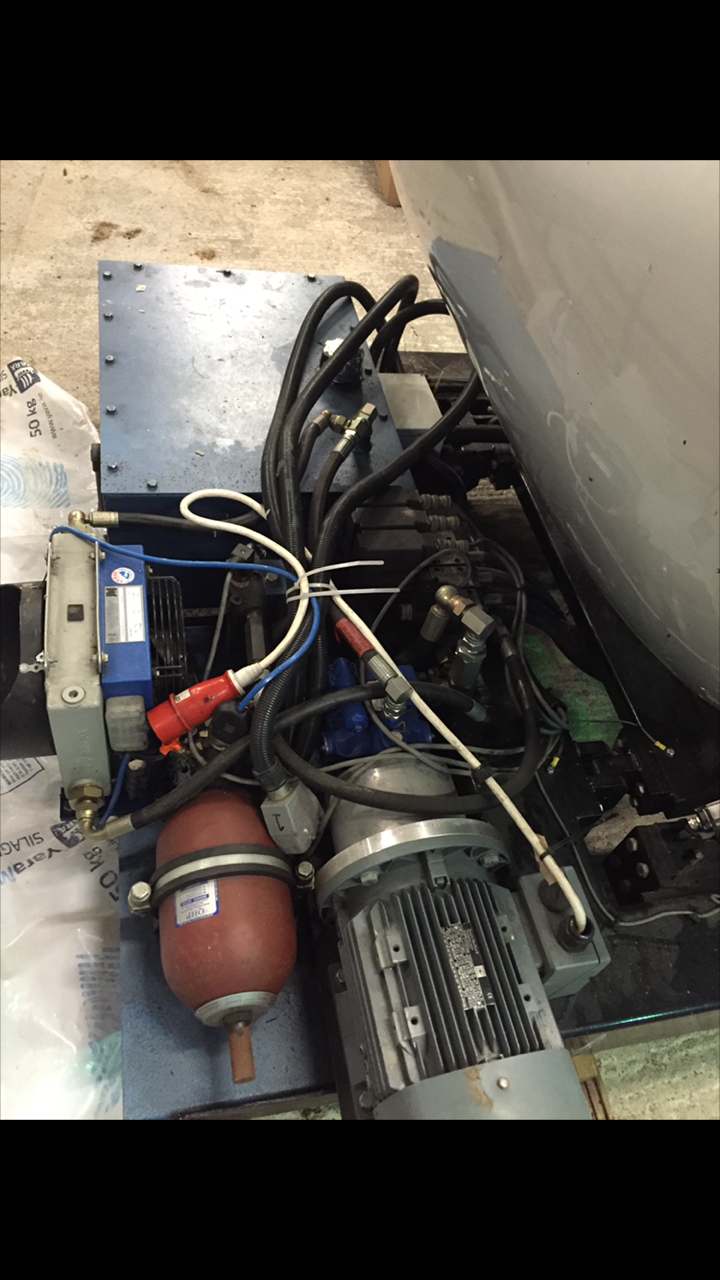

    Not much as far as specs..
    It's an idraulic system. As it looks it has 3 electro valves that intros 3 actuators...
    The main controller it;s pretty old and obsolete.
    Planning on monitoring it's operation and see what sort of signals ho backwards and forwards.
    It has A of and looks as the bridge between the comouter and the hardware is done via serial through a micro controller
    Made by SYEL CP50... no information available about it...
    Motor is a 5.5kw 3phase motor.
    Don't have a 3 phase supply so gonna order a 15Hp single phase to 3 phase converter to get it going.
    Would be great to have help on this venture.
    Many thanks for your reply...

    It's an hydraulic system. As it looks it has 3 electro valves that control 3 actuators...
    The main controller it's pretty old and obsolete.
    Planning on monitoring it's operation and see what sort of signals go backwards and forwards.
    It has a pc and looks as the bridge between the computer and the hardware is done via serial through a micro controller

    Nice toy you have.
    If you plan to drive it with SimTools it will work with every game SimTools works.
    You will need an Arduino with a special code that drives the electro valves via solid-state-relays.
    It's a 3Dof, it has 2 actuators in the back(left/right), and 1 in front(middle).
    I'm just getting envious :)

    I have made some tests today and the controller that the unit shipped with came faulty... fuming with the chap that sold it to me as I bought it as working.
    Was hoping to reverse engineer the unit to check what signals go backwards and forwards.
    The controller u it is an Italian product and there is no information at all online about it. I caontacted the Italian factory and three kindly sent me the manual.
    Looks as the controller receives data from encoders so this righ might have some sort of encoders positioned... no idea on how to get the info back into pc... looks S I need to start from scratch and strip out all wiring on the cont older box and identify what does what.
    This thing has loads of sensors..
    Doors have sensors, the seats itself has sensors, it has emergency stop switches, it has the obvious safety limit switches... pretty impressive but looks as it's gonna be a lot of work ;-)
