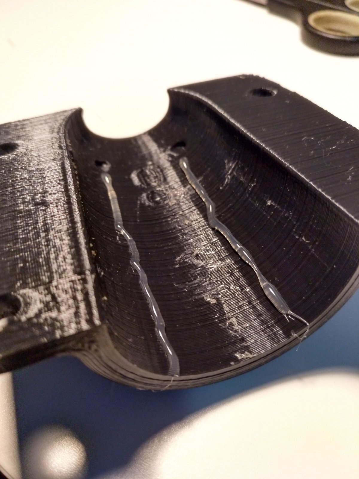

    I got the general one printed up and received it 2 days ago. Im worried that when the rig jolts up/down a bit or if i repeatedly start heaving (like when you run over grass), the vive wand may fly out. Do you recommend using anything to hold it in the cradle/mount?

    You should be able to fasten it enough so that it doesn't fly out. If the hole appears to be "too big" no matter how much you fasten (can happen depending on the 3D printer), I recommend you stick some hot glue lines on the inside of the pieces (and let them dry) for extra grip: IMG_20190926_192501_442.jpg

    Great idea. Thank you
