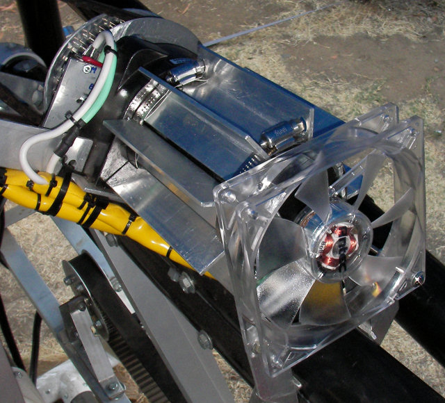

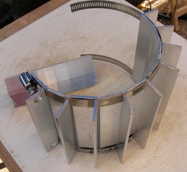

    Update.
    After a brief time away from developing, I've been running the ICE-sim with 75A on longitudinal HPMhb-150A/motor, and 50A on lateral. Attached to the motors are these simple but very effective heatsinks...the temperature on the motors dropped dramatically, especially the longitudinal one. Here are a couple of pics.
    I have now run with 250 lbs. worth of ballast before plopping my own butt into the sim (still under A.I. mode). Movement was very good and quick, and the HPMhb-150A are still breathing easy and running cool. :clap:
    Time to push everything to the limits, I think.
