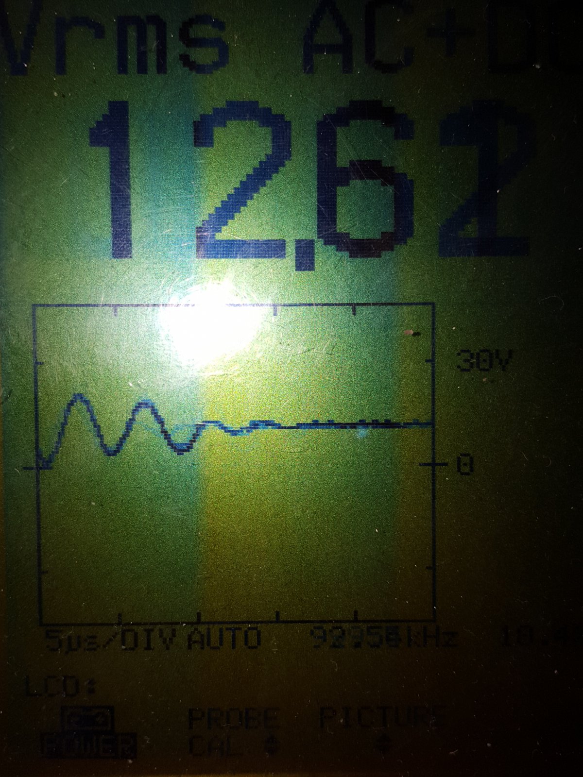

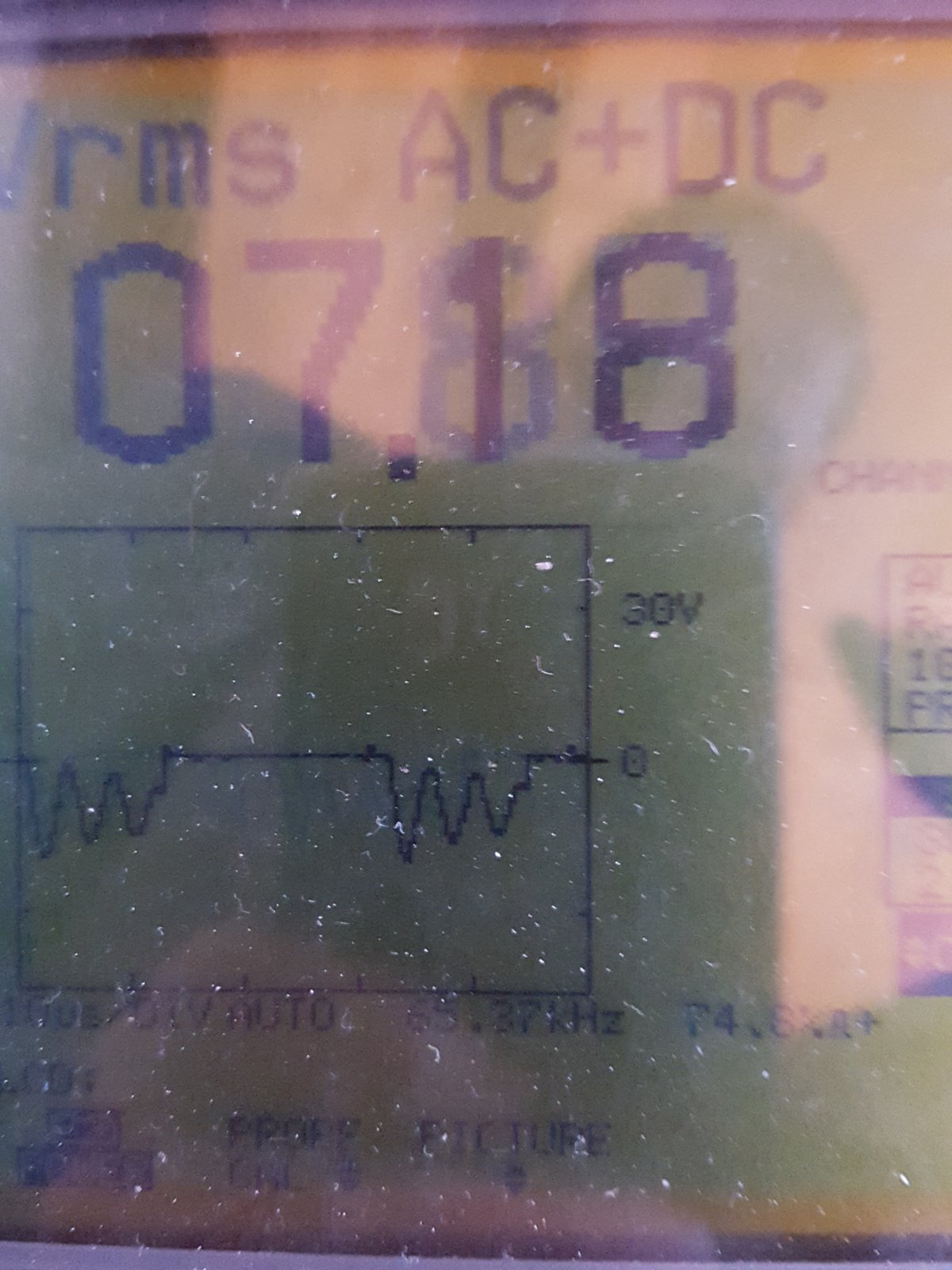

    Thank you i will try this. I want to ask you about another h bridge with ir2184 with same motor - with same motor scope look like this pic
    With some 4700uf/50v and 100nf/50v capacitors on psu close to transistor look like this
    And between power lines

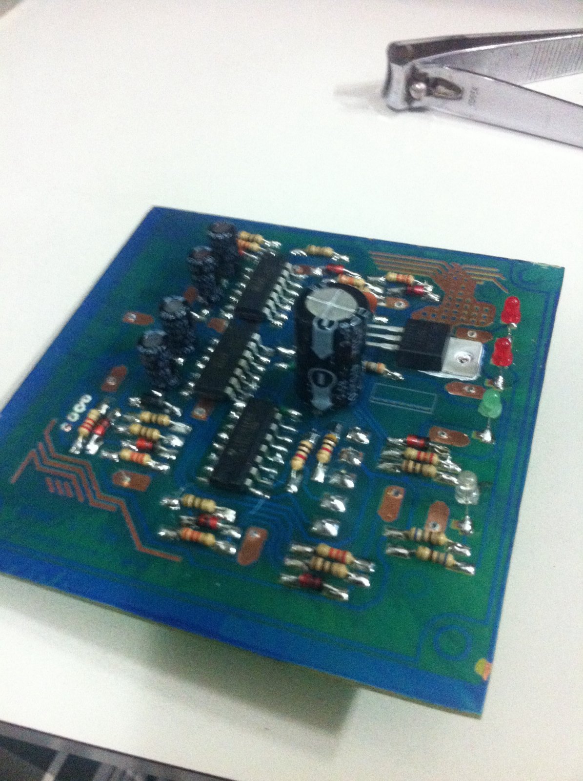

  6. denyszandonadi
    denyszandonadi New Member
    Sep 9, 2015
    5Coins

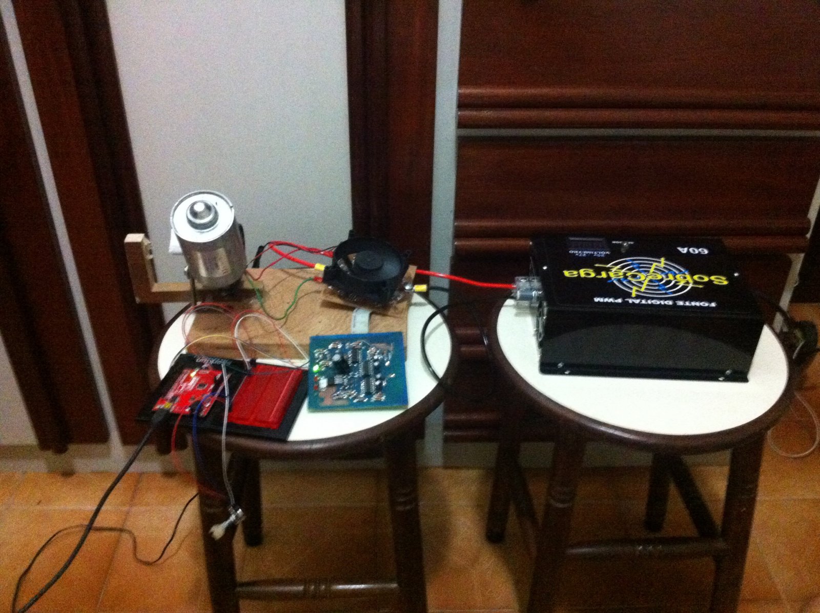

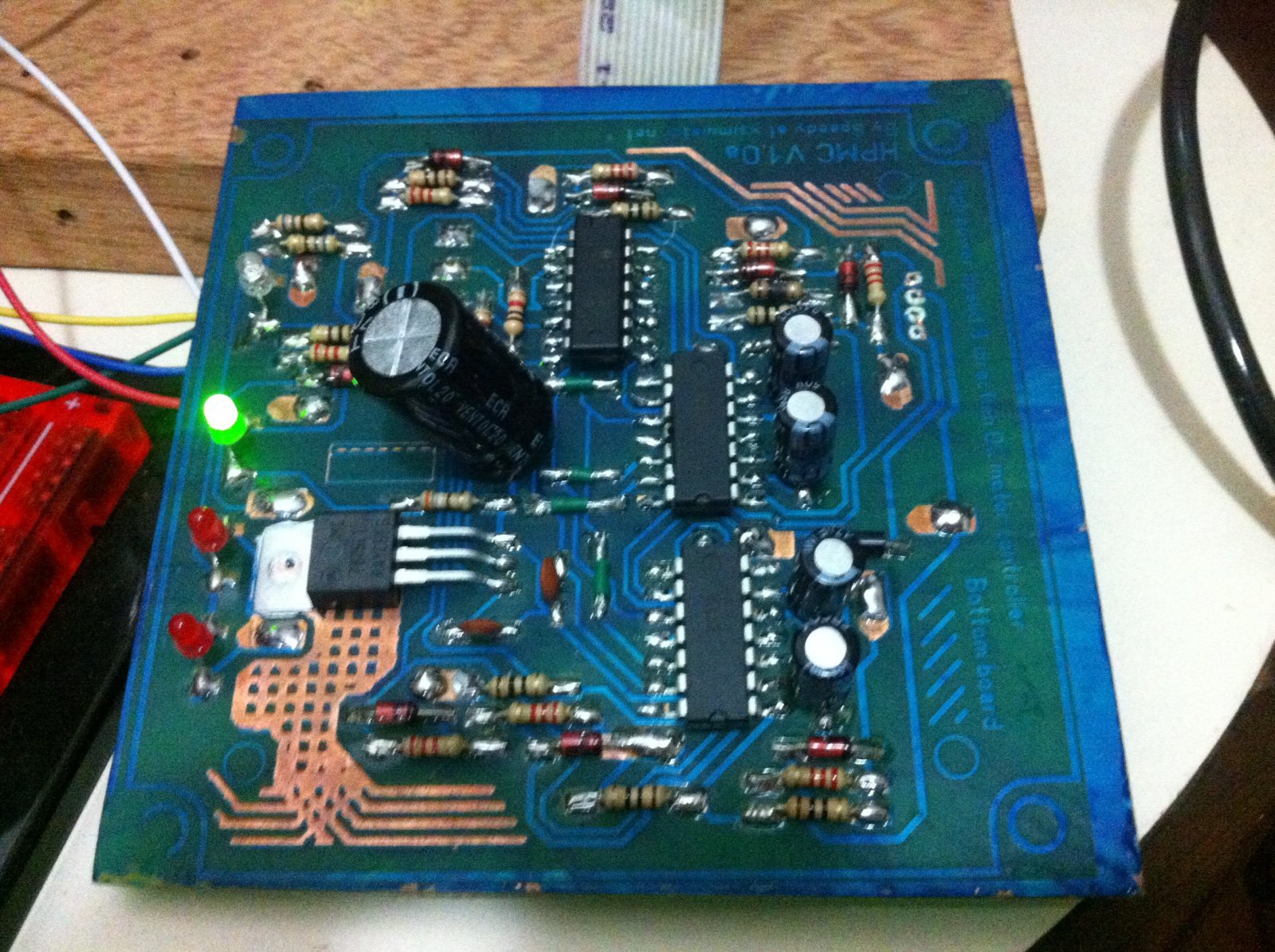

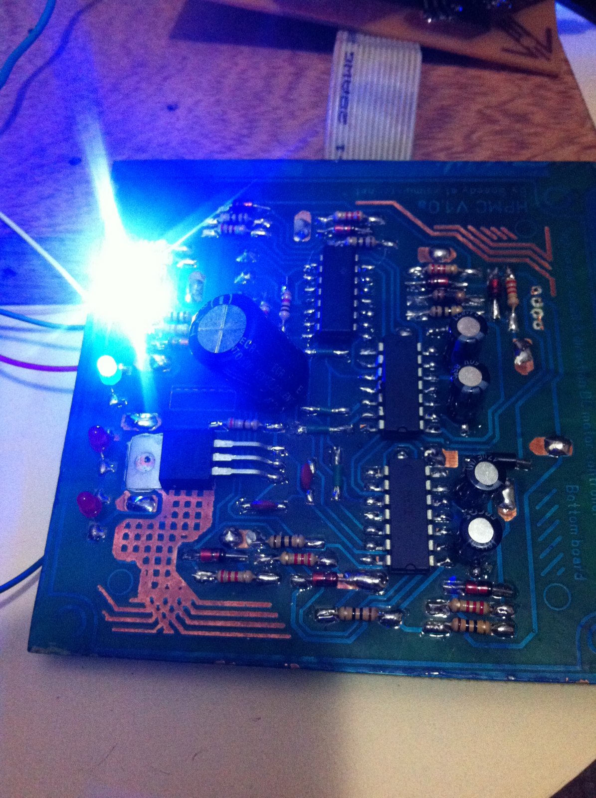

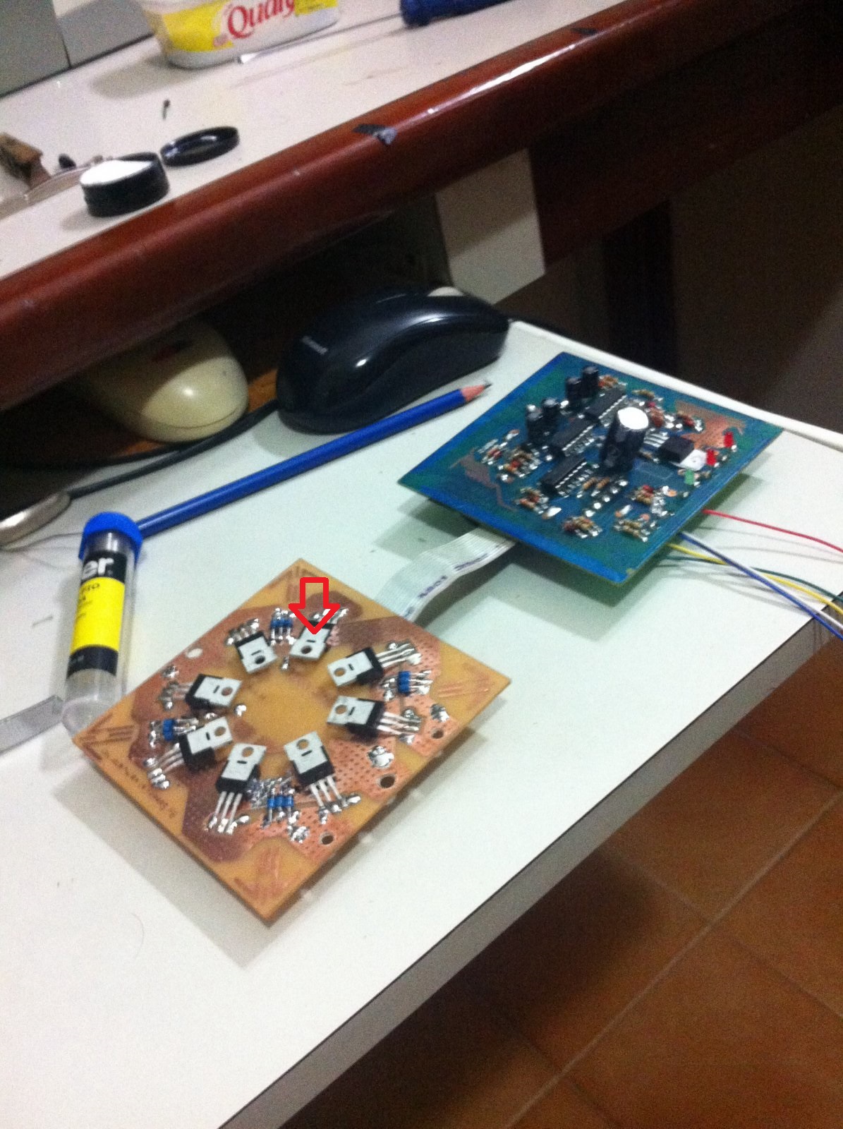

    Hi Speedy, can you help me?
    I made your HPMC, but its not working when i try to reply your test of the video.
    The leds of Power Good and Motor Power is on. (Green and Blue)
    But when I tried to spin the motor, touching the wire on 5v, nothing happens...
    Did you know whats possibly going wrong?
    Thank you!
  7. denyszandonadi
    Sep 9, 2015
    5Coins
    2 more informations:
    1- Im not using the fan pin out. I use another psu for the fan, because my motor is 24v, and I dont have another fan with 24v.
    2- The fuse of 2A blew. I have no ideia why...
    Thank you very much again!
  8. speedy
    speedy Well-Known Member
    Feb 1, 2012
    1,193
    Alexandria , Egypt
    7,951Coins
    +1,288 / 10 / -0
  9. denyszandonadi
    Sep 9, 2015
    5Coins
  10. speedy
    Feb 1, 2012
    1,193
    Alexandria , Egypt
    7,951Coins
    +1,288 / 10 / -0
    Very clear and nice boards . :thumbs
    It looks like you have a defected "IR2110" IC ... I don't know why ? ... But check for this blown resistor and the zener diode next to it ... and make sure you connect the mosfets in the same order " I can't confirm that " ...
    that resistor should drive this MOSFET .

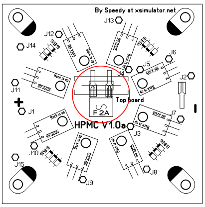

    Hi Speedy,
    Thanks for your sharing of this HPMC.
    Im attempting to build 1 initially, and then will go for 5 more for a planned 6dof with 24V motors and ballscrew.
    I have ordered all the parts but having trouble understanding just one component.
    Unfortunately my electronics knowledge is basic and I cannot determine equivalent or adequate alternative components by reading the ebay listing title.
    Im looking at the v1.0a top layer silkscreen pdf and see a 2A fuse required in the middle (Its not listed in the parts list)
    From one of the previous photos, it appears to be a resettable polyswitch.
    When I look up ebay.com.au listings, I note there are various options in voltage rating for 2A, eg 16V 30V 250V
    Is it one of these polyswitches or am I completely off the track?
    I presume it should be resettable? Given its under the heatsink and needs stripping to inspect/change it?

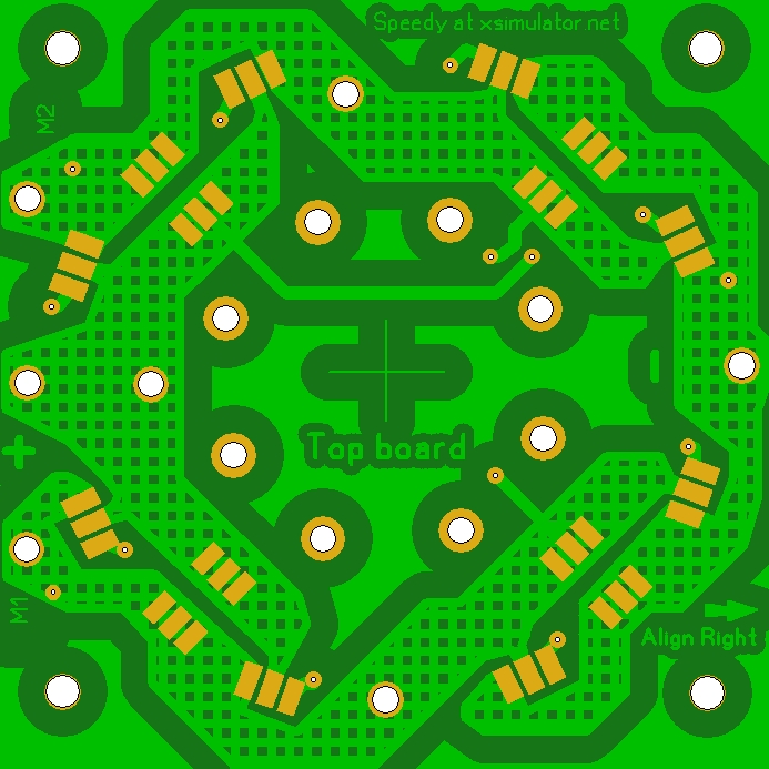

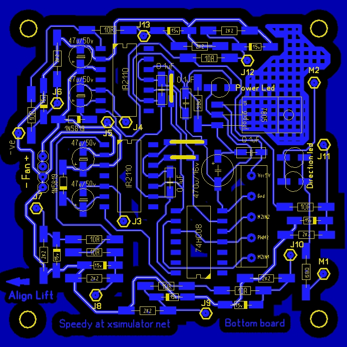

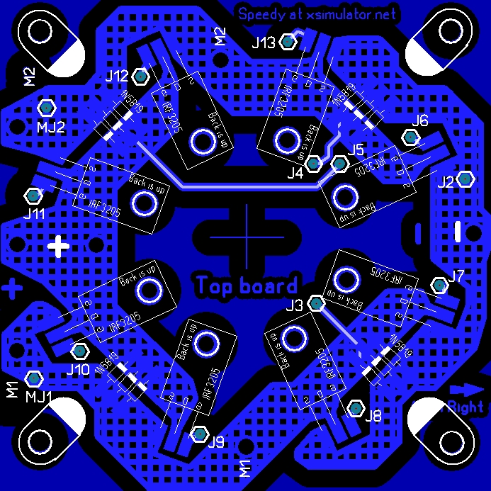

  14. Eagletrike
    Eagletrike New Member SimAxe Beta Tester Gold Contributor
    Jun 4, 2015
    15
    Let you know when I grow up
    Central Western, New South Wales, Australia
    363Coins
    +9 / 0 / -0
    DC motor, AC motor, Arduino, Motion platform, 4DOF

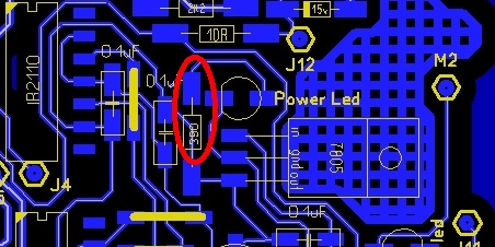

    Hi @speedy
    I was going through the thread and noticed the "new controller version". I had a look at the pictures and noticed a few differences between versions
    • No pull down resistors on motor directions before the 74HC08
    • Only utilising 2 logic circuits on 74HC08 with no shut down to the IR2110
    I checked the PDF files on the first page but saw that they are the original ones that I have built definitely a noticeable difference between the files and the pictures in post 49800. Other than the above quotes I haven't been able to find any other references to the "New Version". Was the New Version published?
    Regards
  15. Eagletrike
    Jun 4, 2015
    15
    363Coins
    +9 / 0 / -0

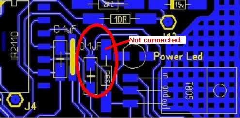

    Hi @speedy,
    While looking through the picture of the new version I found a pad not connected to a trace.
    Would I be right in assuming that this is the desired connection?
    Regards
    David
  16. speedy
    Feb 1, 2012
    1,193
    Alexandria , Egypt
    7,951Coins
    +1,288 / 10 / -0
    Yes ..thanks for pinning that out :thumbs
    I'll update it asap
    :cheers

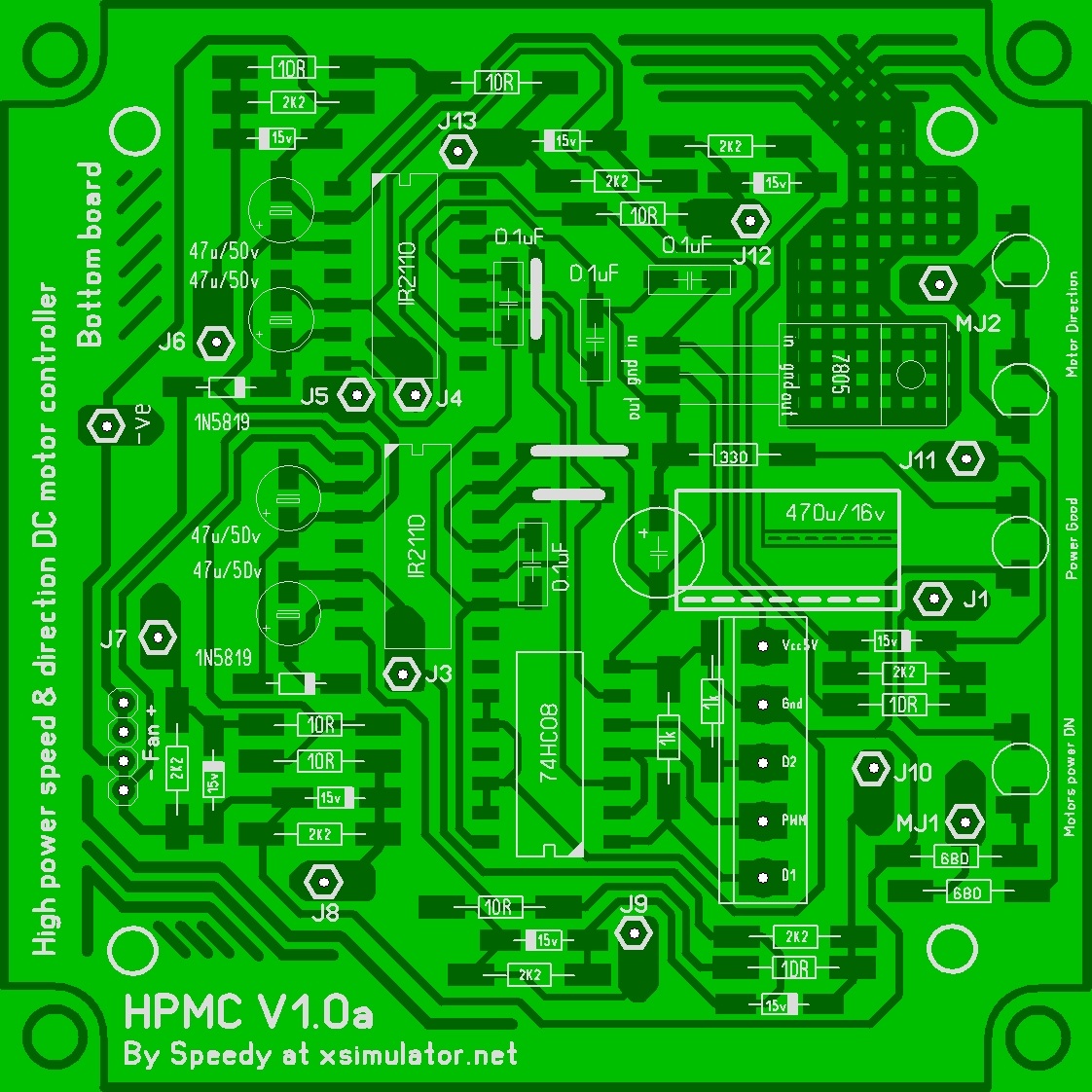

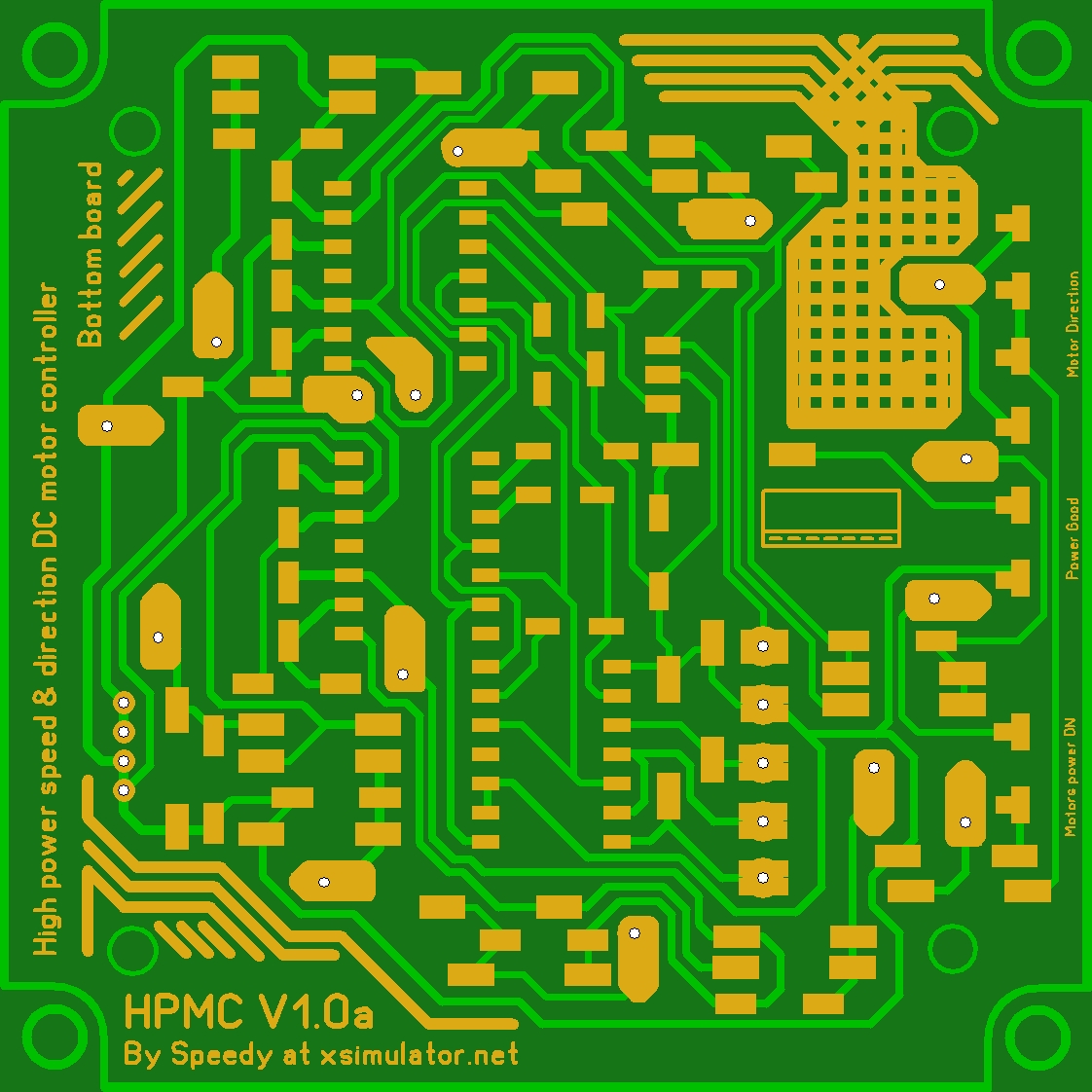

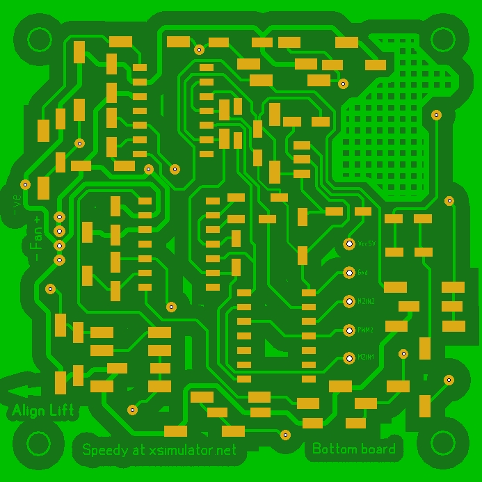

    Guys, I've read and reread this post 3 times to try to figure out how to make the PCB but I'm very confused. I thank Speedy for this beautiful project, but there are 3 different types of PCBs with different tracks. There is some difference in jumpers, in tracks, in connections. Could anyone please tidy up and clearly say which PCB is the right one? I have attached the 3 different PCBs that I found in this post, with the differences.
      File size:
      289.5 KB
      Views:
      745
      File size:
      641.1 KB
      Views:
      724
      File size:
      438.7 KB
      Views:
      764
  19. Eagletrike
    Jun 4, 2015
    15
    363Coins
    +9 / 0 / -0
    Hi @motiondynamics In my opinion the A.jpg is the latest one but I did put up a post of an error I had found which is only a few posts back.
