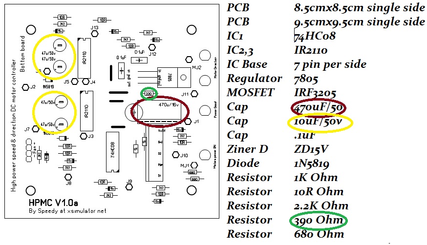

    and ind i my former comment i ask which one irf3205 what I should order becouse the companey have 2 differnt kind of mosfet called irf3205
    the first one cost 3.66 euro and the second one cost 1.76 euro and i dont know the difference between the two

    The two irf3205 have different amperage ratings, one at 75a and one at 110a.
    I'd get the 110a ones.

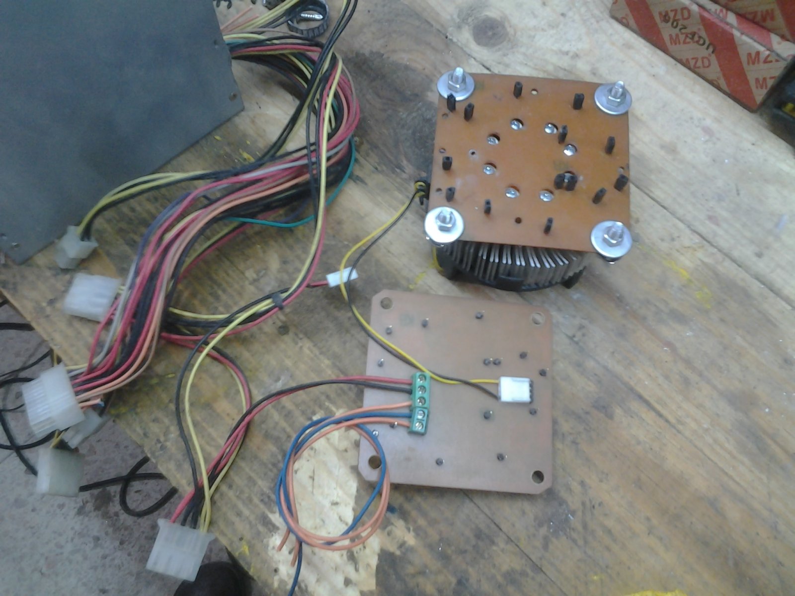

    at last i finished the h-bridge,
    https://imagizer.imageshack.us/v2/880x495q90/842/kjiiz.jpg
    https://imagizer.imageshack.us/v2/880x495q90/845/mv2q.jpg
    just want to make sure there is no mistake i edit the top board picture with text.
    dc supply + and - means psu 12v yellow and psu gnd black right?
    https://imagizer.imageshack.us/v2/278x495q90/835/g7aea.jpg
    then the gnd on bottom board for microcontroller (arduino) gnd, am i right?

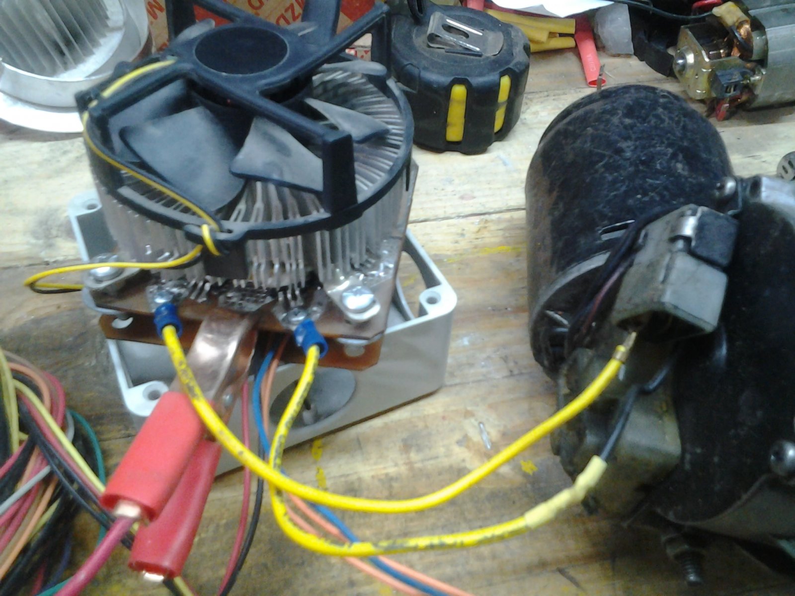

    and the last my wiper motor picture,
    there is two cable, yellow and green, if yellow cable on top board M1, then where the green cable will go?
    https://imagizer.imageshack.us/v2/880x495q90/834/tfhu.jpg
    i'm almost there :D
    thank you

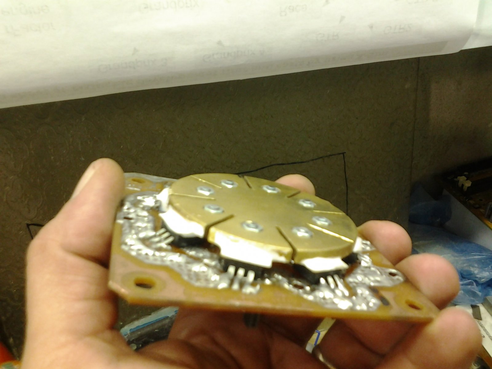

    Hi Daniel @Albeda1 ... I'm in the testing phase of the new version right now ... thanks to your help ... So I hope the update is available soon ...
    Hi @chanzu ... Nice build my friend :thumbs ... you seems like an expert ...:grin
    This controller board is for single motor only my friend ... use the motor terminals [ M1 and M2] for connecting your wiper motor ...
    You're right about all other connections but before connecting any power or so ...

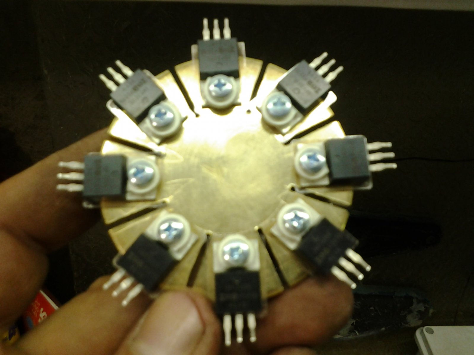

    Use a DMM or any Ohm meter to do isolation testing between the MOSFET's back and the copper disk ... there should be no electrical connection of any kind ...
    If you have any short circuit between MOSFET's and the copper disk ...
    Then the insulator bushing of the MOSFET's should be on the other side of the copper disk like this ...

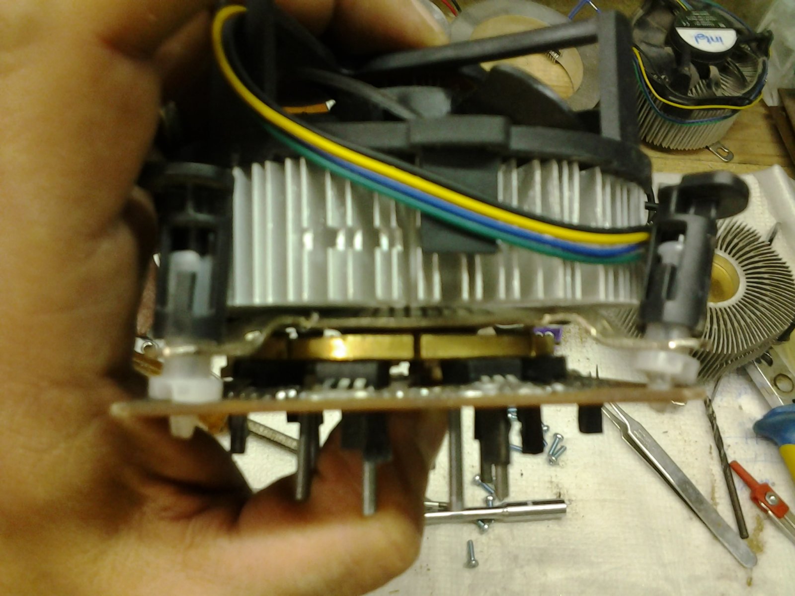

    the MOSFET's here are totally isolated from the heat sink ... with a totally flushed to surface nuts for perfect Fan heat sink mounting ...
    reducing the chance of any short circuit or mounting disturbance that may come with the fan like this ...
    I'm here using a long bolts for testing purpose only ...
    Did you drill the 8 hols of the top layer for the screw driver insertion ? ... see page 1 first post .

    @speedy oh i see, i didn't read the one dc motor :D
    thank you, but actually because overheat some pad got lifted and i have to use some kind of jumper to repair it.
    yes i drilled the 8 holes on to board, but my screw on copper doesn't through the top board.
    do you have some example code to test the motor?
    at first i tried to test with the lab power supply and test with multimeter, it seem to work.
    but when i test with pc power supply, with the 12v of course, the wiper motor just make a small move then stop.
    actually i confuse whether my circuit or my power supply doesn't work (need more ampere maybe),
    the power supply can give 12v at 13a, and when i tried to connect to wiper without circuit it can move though

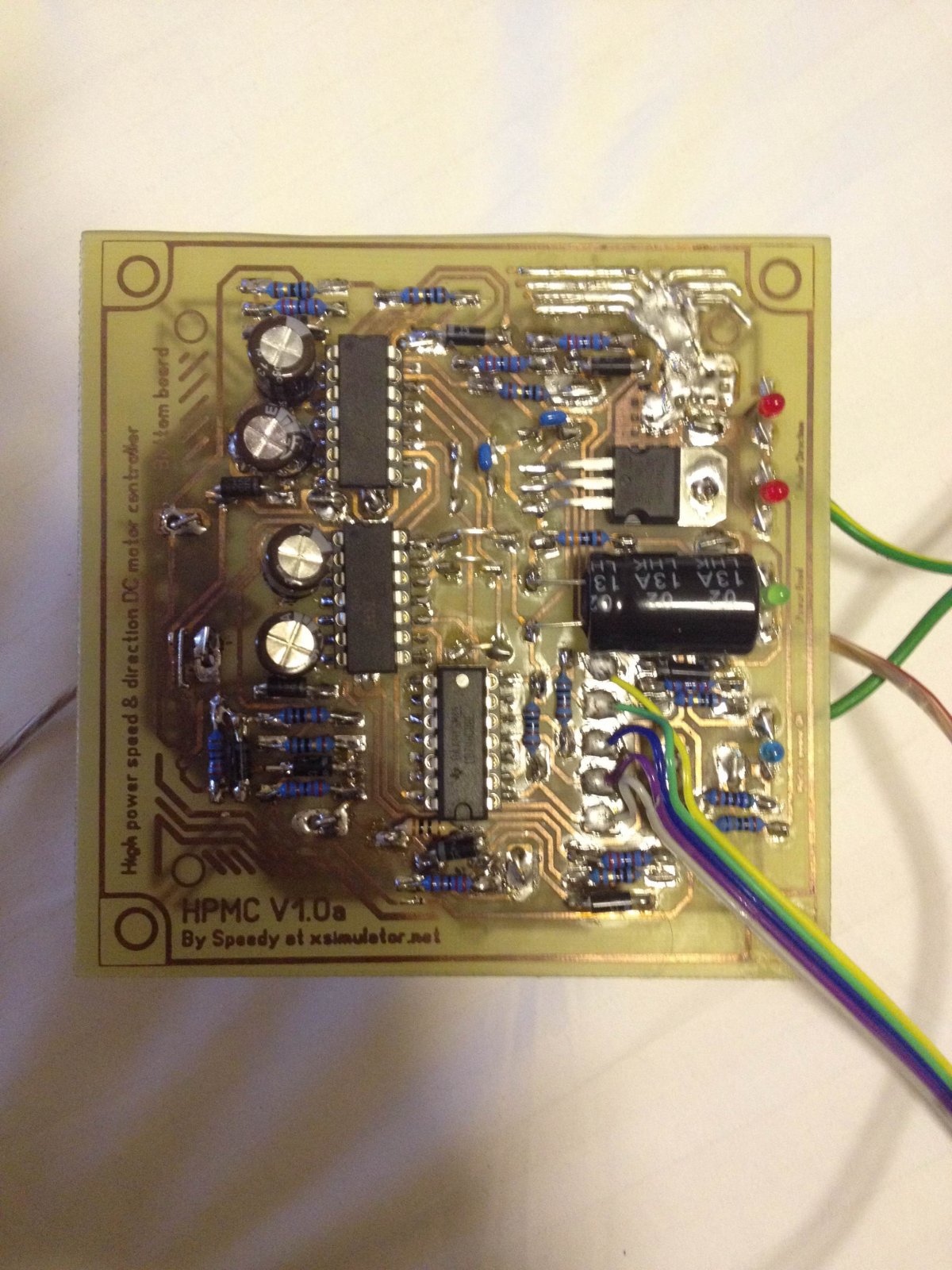

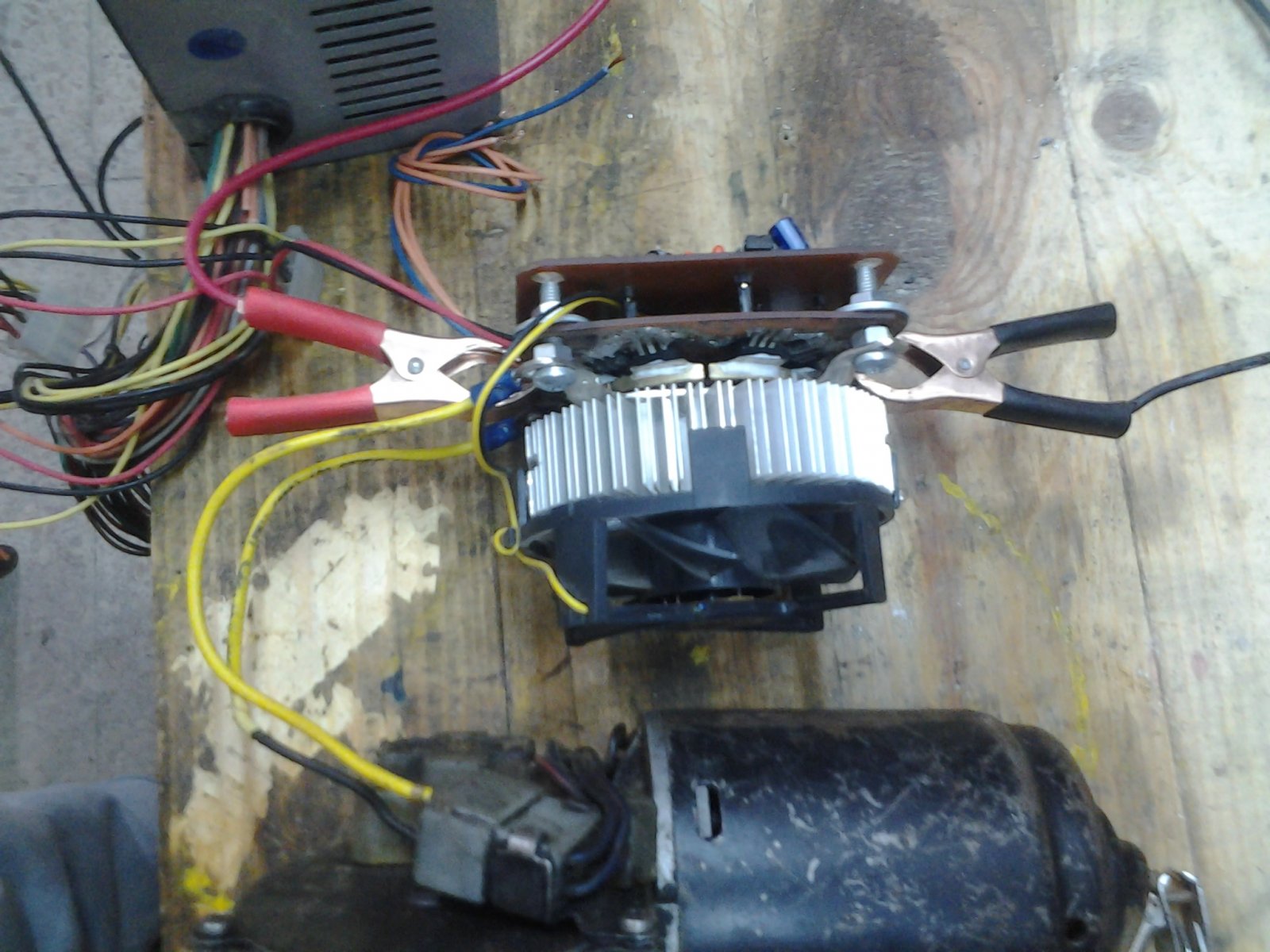

    here are connections and a run test video ...
    I'm almost finished with modification to the latest version so files on the first page will be updated soon ...

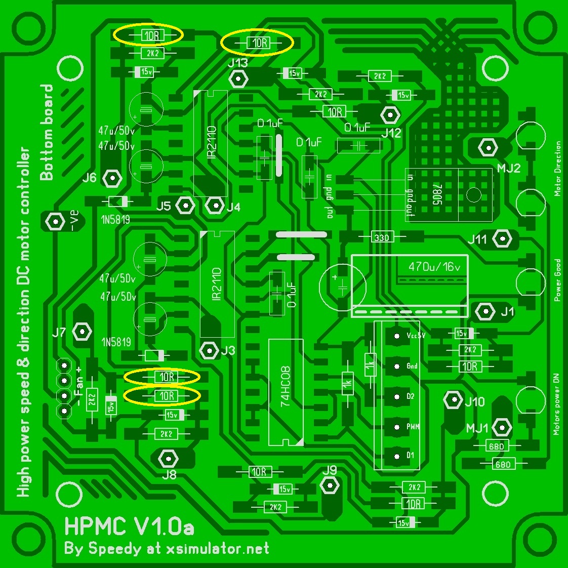

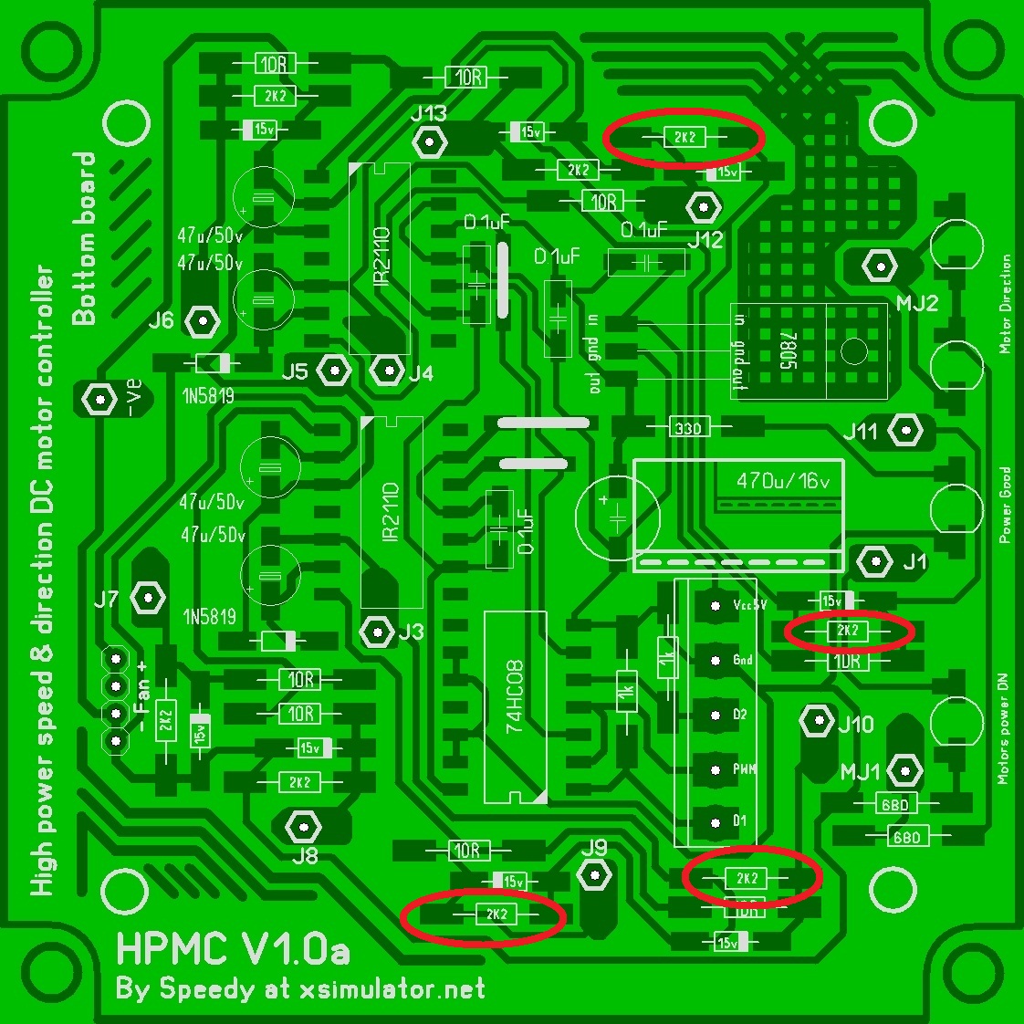

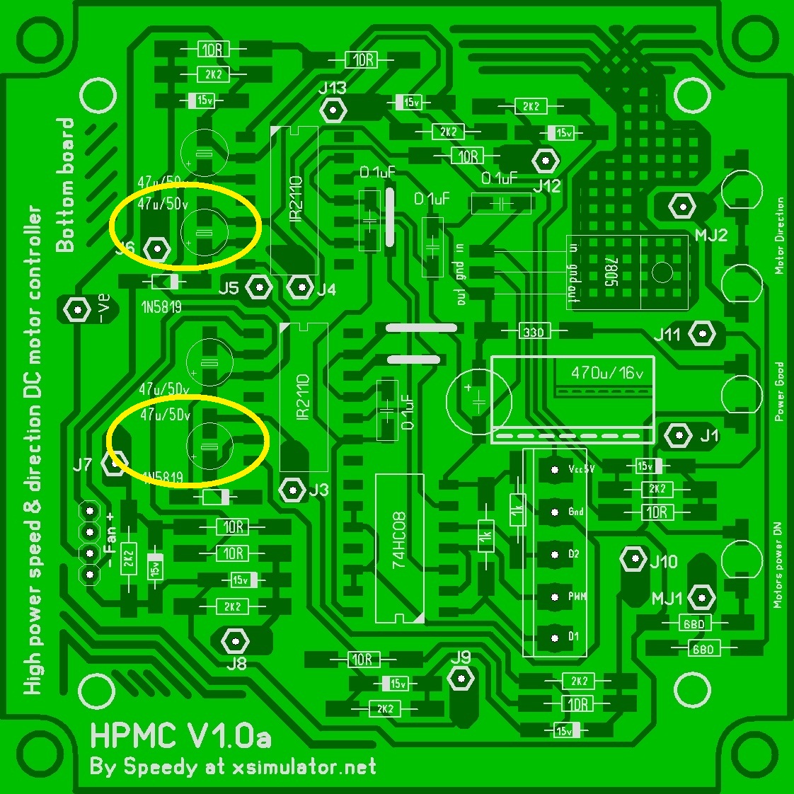

    I guess doing the layers on double side board will make some noise from motor to the IR2110 input control signal ... So check for these next points to see if they solve the problem for now ...
    1- For the boot strap capacitor some capacitors are not good and have high ESR and can't fully charge ...
    So (use 1000U/25v) to give you enough ON time (8-10 seconds or more ) for the motor to go ... before reversing direction and the capacitor is recharged again in real simulator game action .
    2- Some of the MOSFET's power requirement (gate charge ) is higher than others ... so to keep them ON all the time replace the 4 X 2.2k gate safety resistors for the high side with 10k or higher resistors , they may consume some of the gate signal charge that MOSFET's may need ...
    3- you may also use a lower than 10 ohm resistor for the MOSFET's gates of the low side to 4.7ohm or lower ... so low side MOSFET's are switched on faster than the high side so the boot strap capacitor is charged enough for the high side MOSFET's for each pulse the low side is ON .
    Other wise use a single side boards for top and bottom layers as suggested making some air gap to prevent the little interference between layers ...
