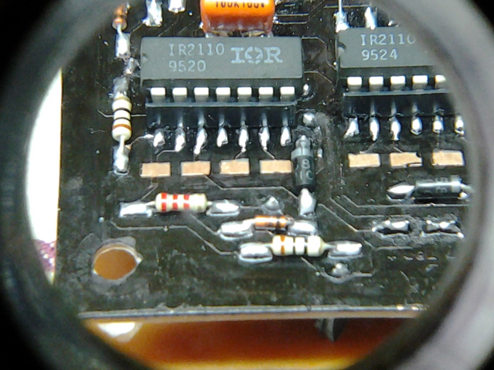

    • The basic construction of this HPMC bridge is an 8 MOSFET's N-channel type ... Driven by two IR2110 half bridge driver IC's so to build a full H-Bridge .
    • The active elements into this HPMC are the IRF3205 N-MOSFET's this irf3205.pdf is it's datasheet ... They are a good choice ... read the datasheet if you have time .
      • Note : Between the lines for the MOSFET datasheet information ...You'll notice that every thing in tables is related to the temperature of the MOSFET's ..!! ( the best operating performance is @ 25C ) ... Therefor comes the powerful cooling stage.

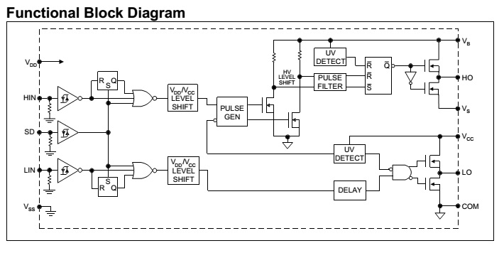

    • For the MOSFETs driving IC IR2110 this IR2110 AN.pdf is it's datasheet conclusions summery ...
    voltages and control switching speed are way beyond MOSFET's and IGBT's capabilities, so you are free to choose whatever N-MOSFET's you like ... plus It has a shutdown feature for emergency stop option .

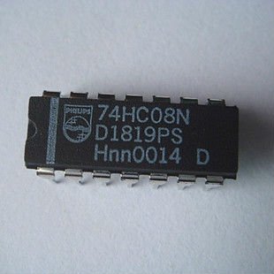

    • Also included in the circuit the 74HC08 Quad AND gate IC to get a perfectly time matched driving signals so NO shoot through could happen ever ... plus it controls the shutdown option in the IR2110 in case of malfunction in the input signals .

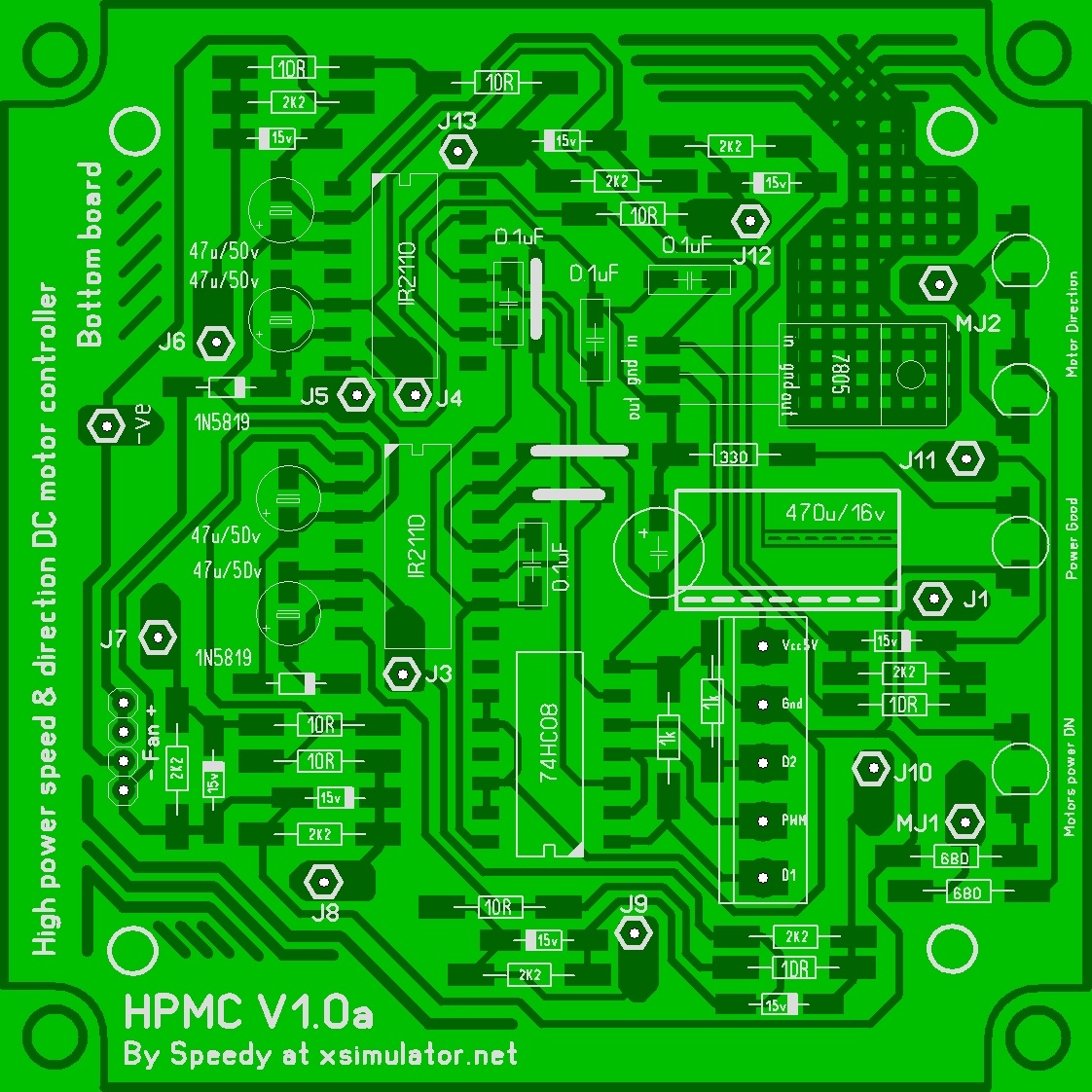

    2- How to Do it :
    • A BOM of all the components ...can be generated from a printed silkscreen PDF file of each layer ... or just use this components list.txt file ...

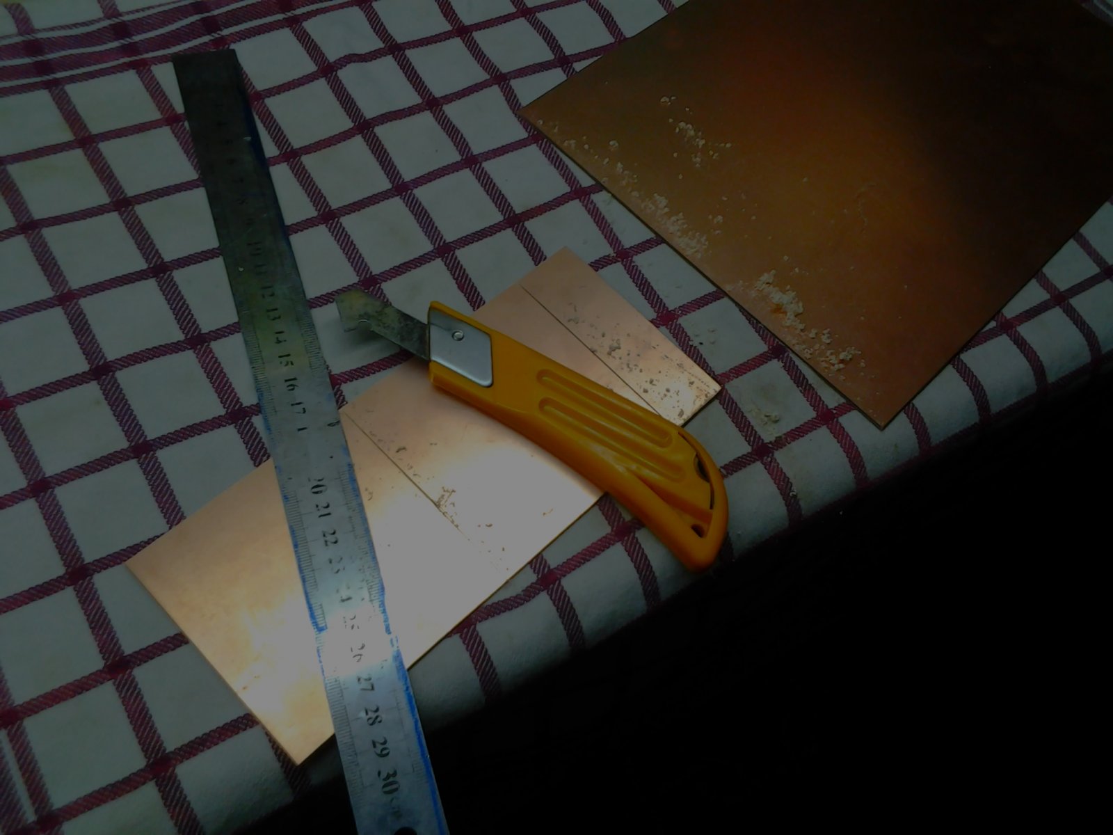

    • Single Side Board will be used by having a [ 8.5cmx8.5cm ]&[ 9.5cmx9.5cm ] PCB's that will be later mounted together back to back with copper layer sides out using jump wires linking them together electrically ...
      • Why using single side boards ? ... For unmounting the copper disk by having a full access to the MOSFET's screws using a screw driver through the Extra 8 holes made in the top layer board ... to be easy to solder/replace any defected MOSFET and fasten them again to the copper disk ... plus single side boards are cheaper .

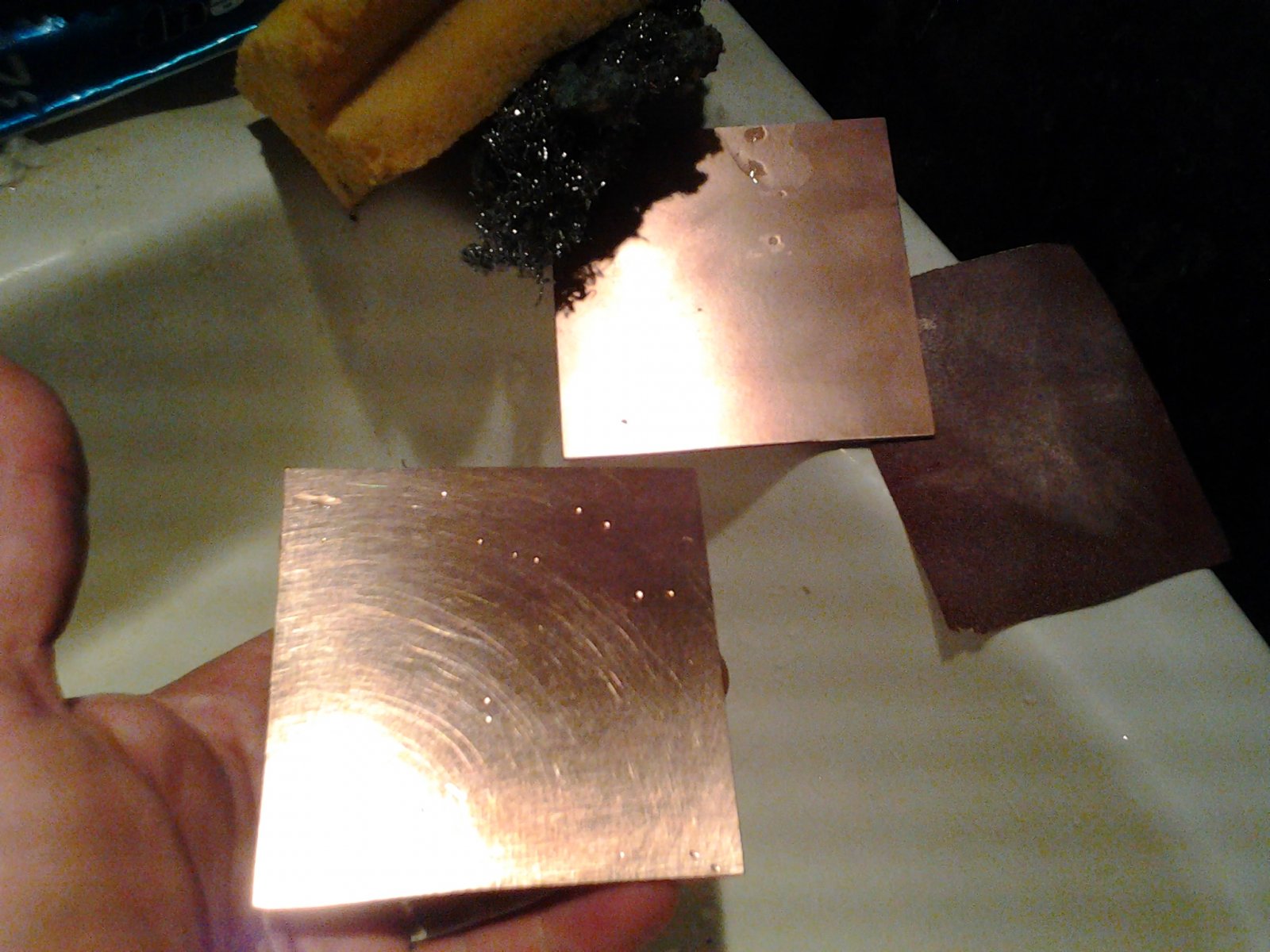

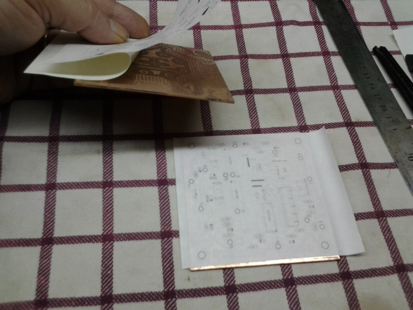

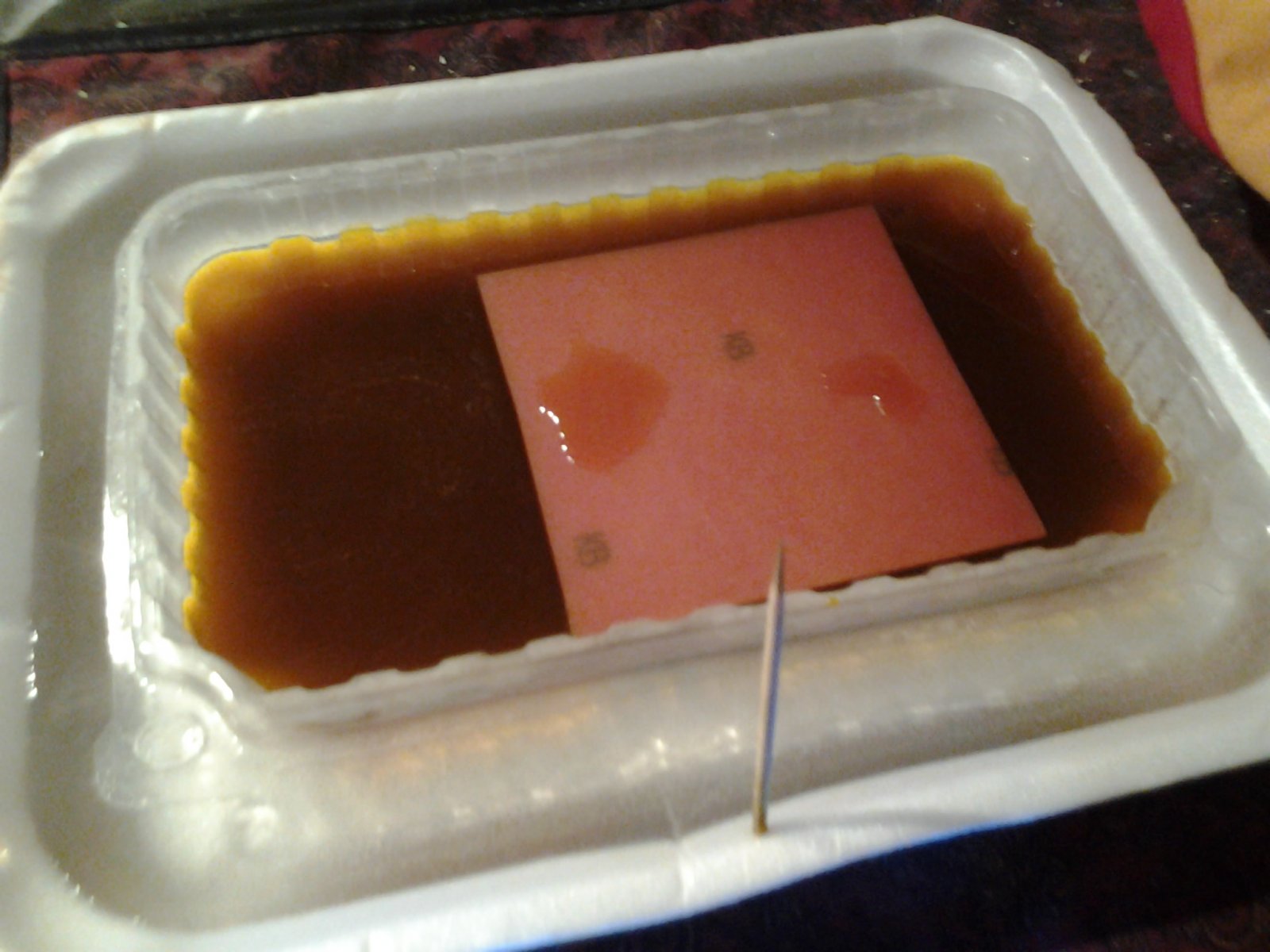

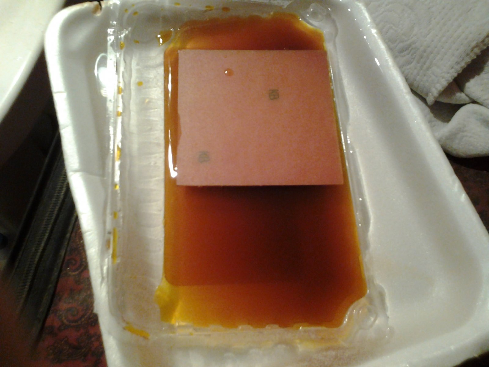

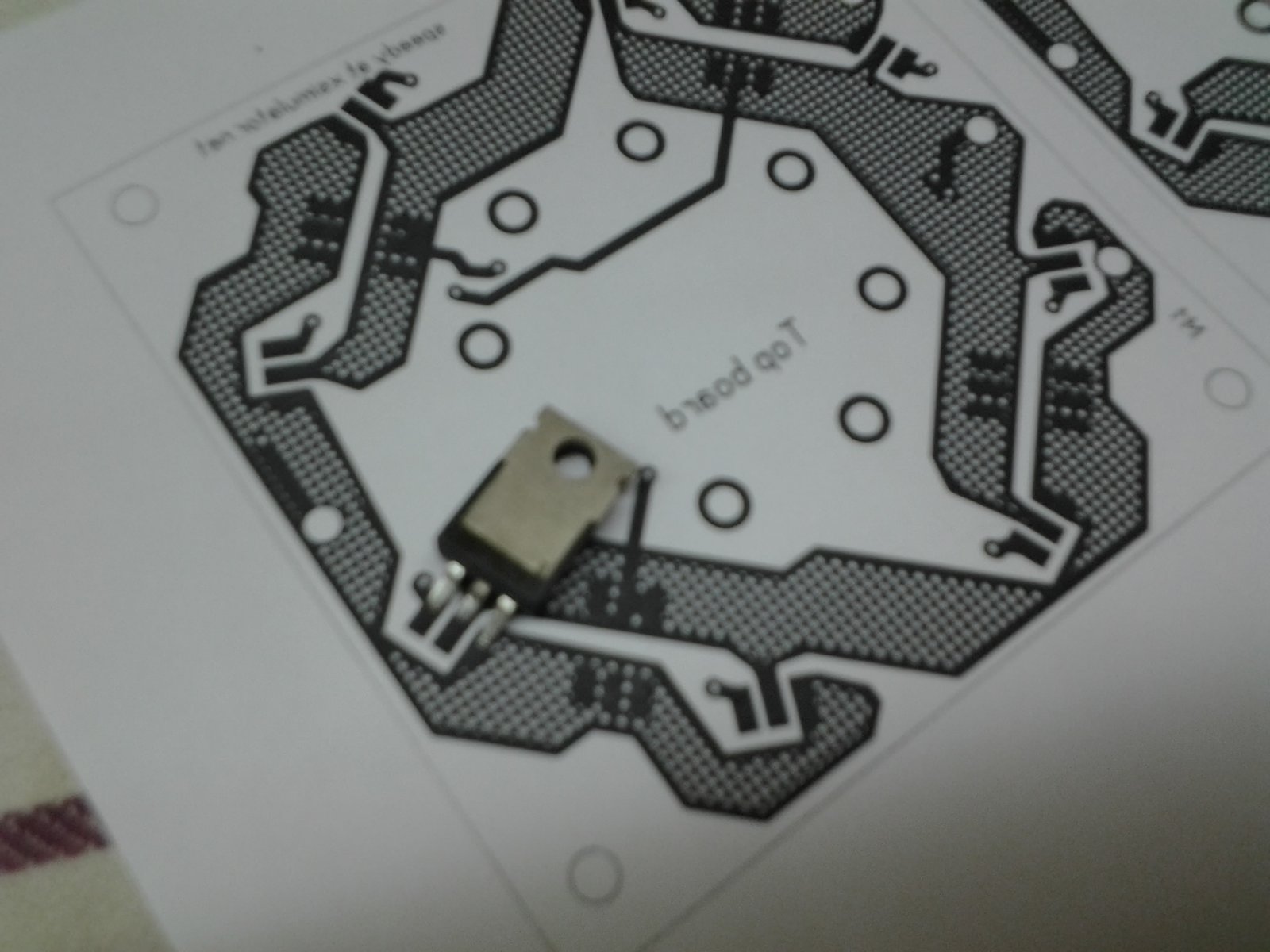

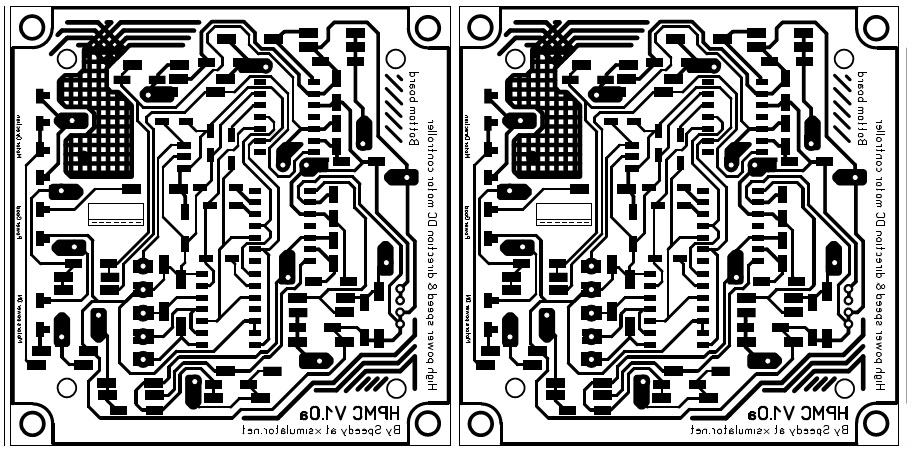

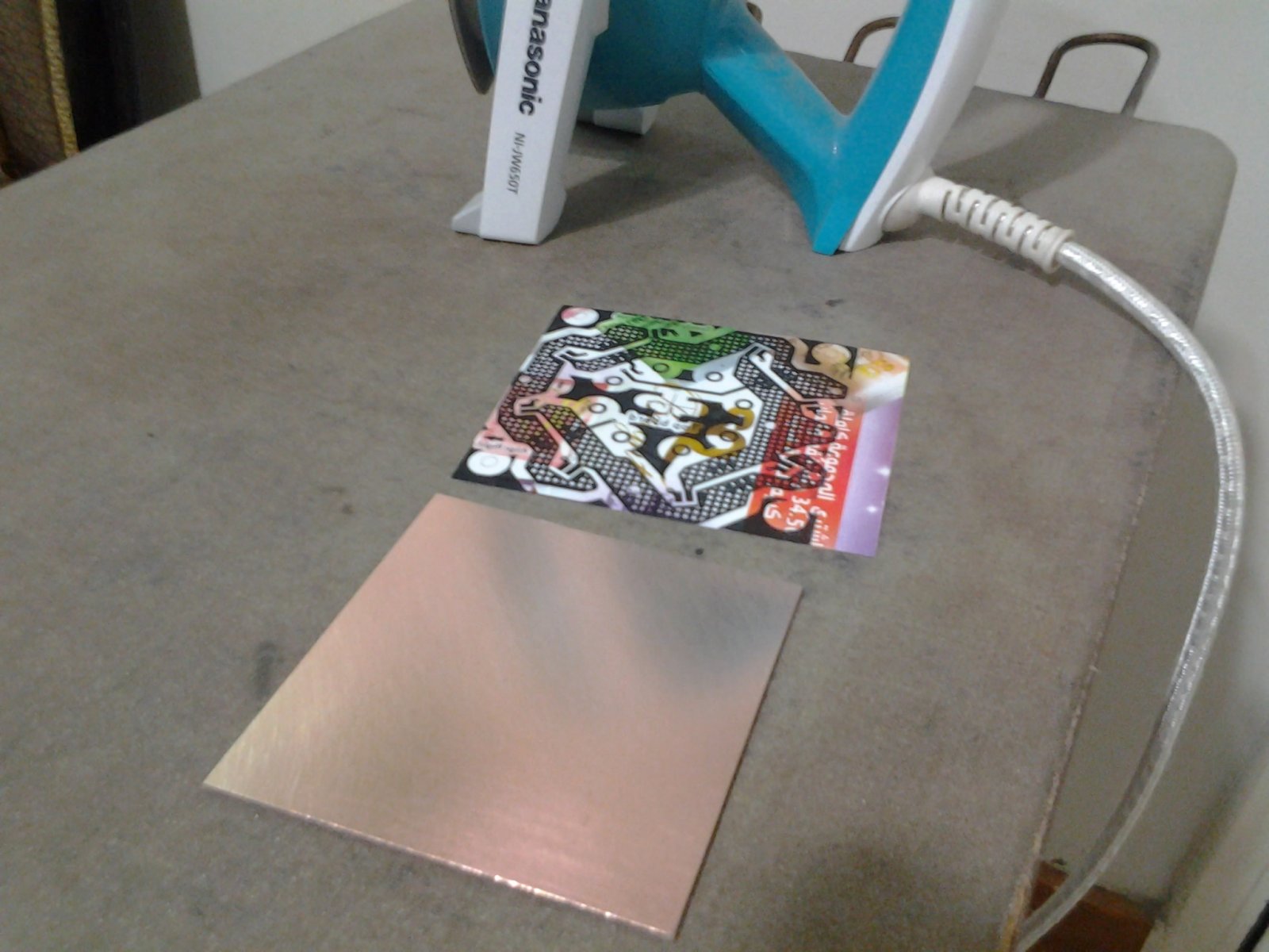

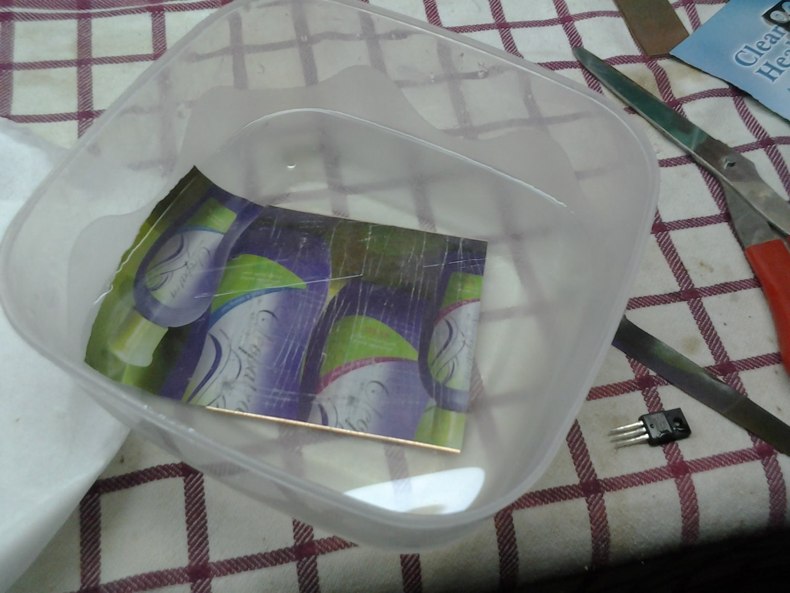

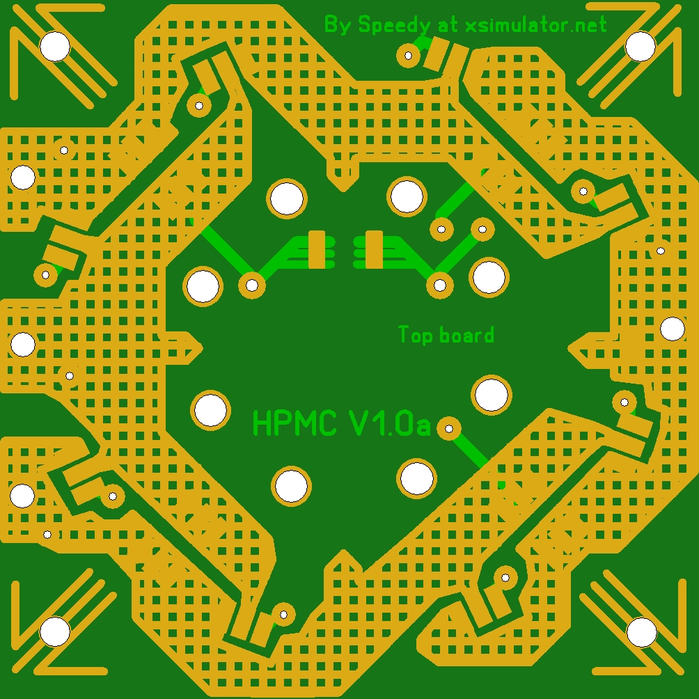

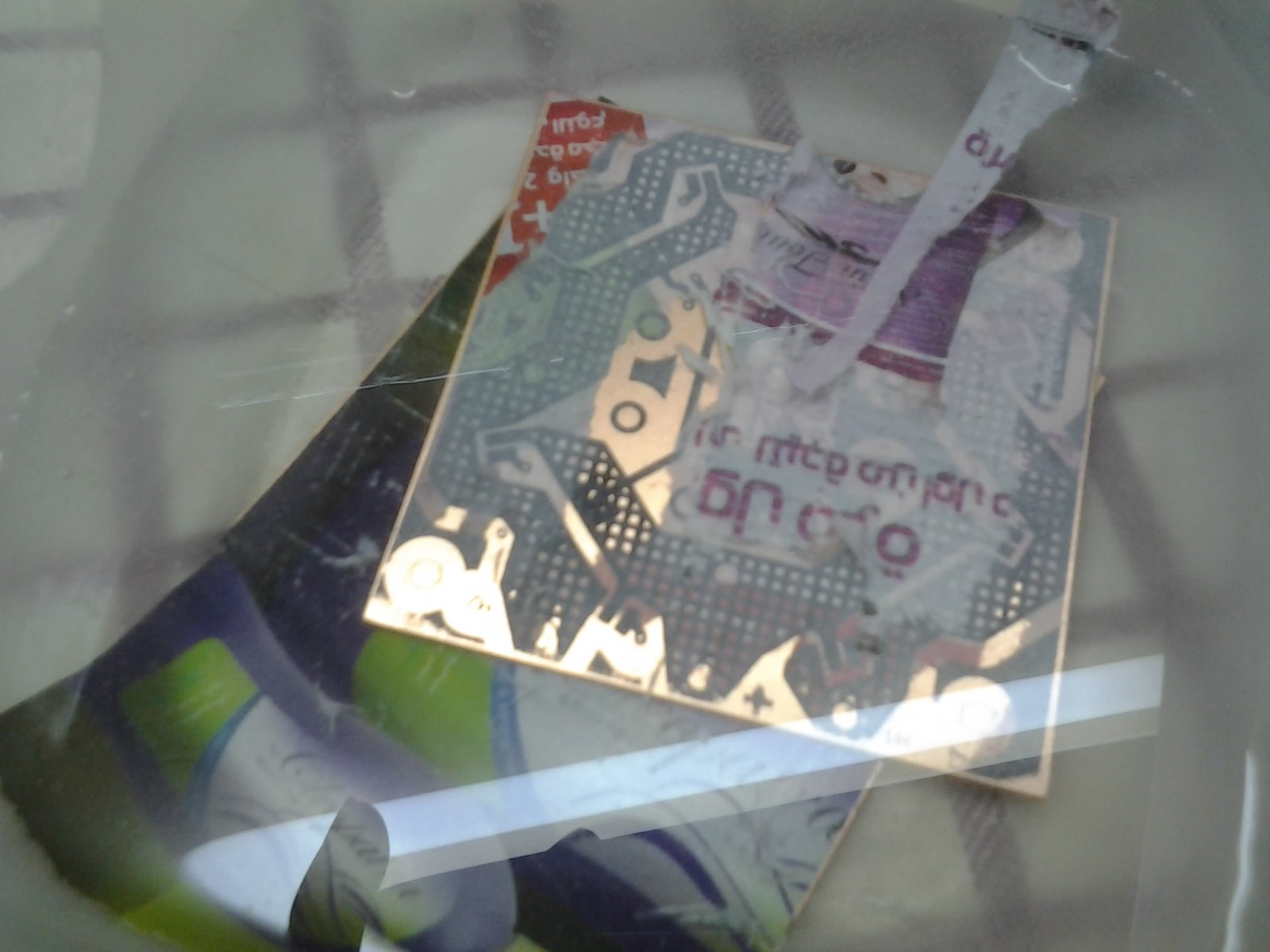

    • Etching the copper layers ... For etching both the top and bottom PCB's I used the printable 1:1 PDF files on A4 glossy paper , with a laser printer and an old women makeup magazine ... (very cheap and Amazing output board quality to do a toner transfer) ... plus a white sticker paper for the silkscreen layer ( you may leave this point for now ). Also there is tons of videos on the internet describing this issue too ...
    2014-01-15 06.28.52.jpg 2014-01-15 06.40.46.jpg 2014-01-15 07.05.13.jpg 2014-01-15 07.04.08.jpg 2014-01-15 07.11.38.jpg 2014-01-15 07.57.44.jpg 2014-01-15 08.40.17.jpg

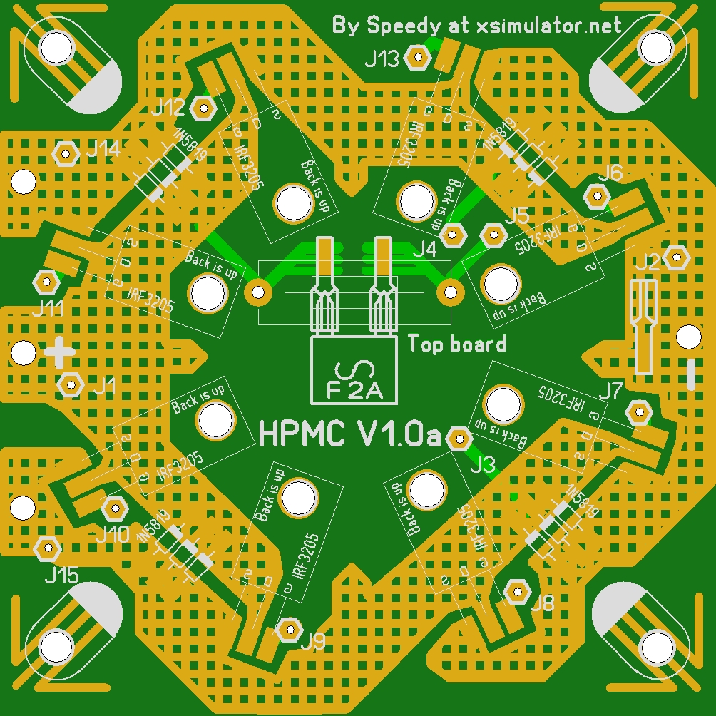

    Impotent Note : when processing layers ... ( top board will be as C1 layer and bottom board will be like a C2 layer ) ...To be look like a one double layer PCB board " BUT IT IS NOT" ... they are actually C1 layers, So the PDF files are arranged that way so you can directly print them 1:1 on A4 sheet without inverting any thing .

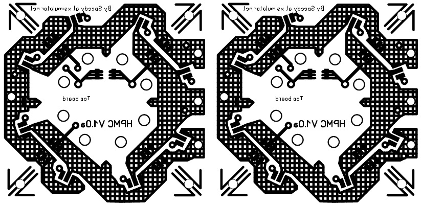

    Preview for top board copper layer printout for toner transfer process ...​

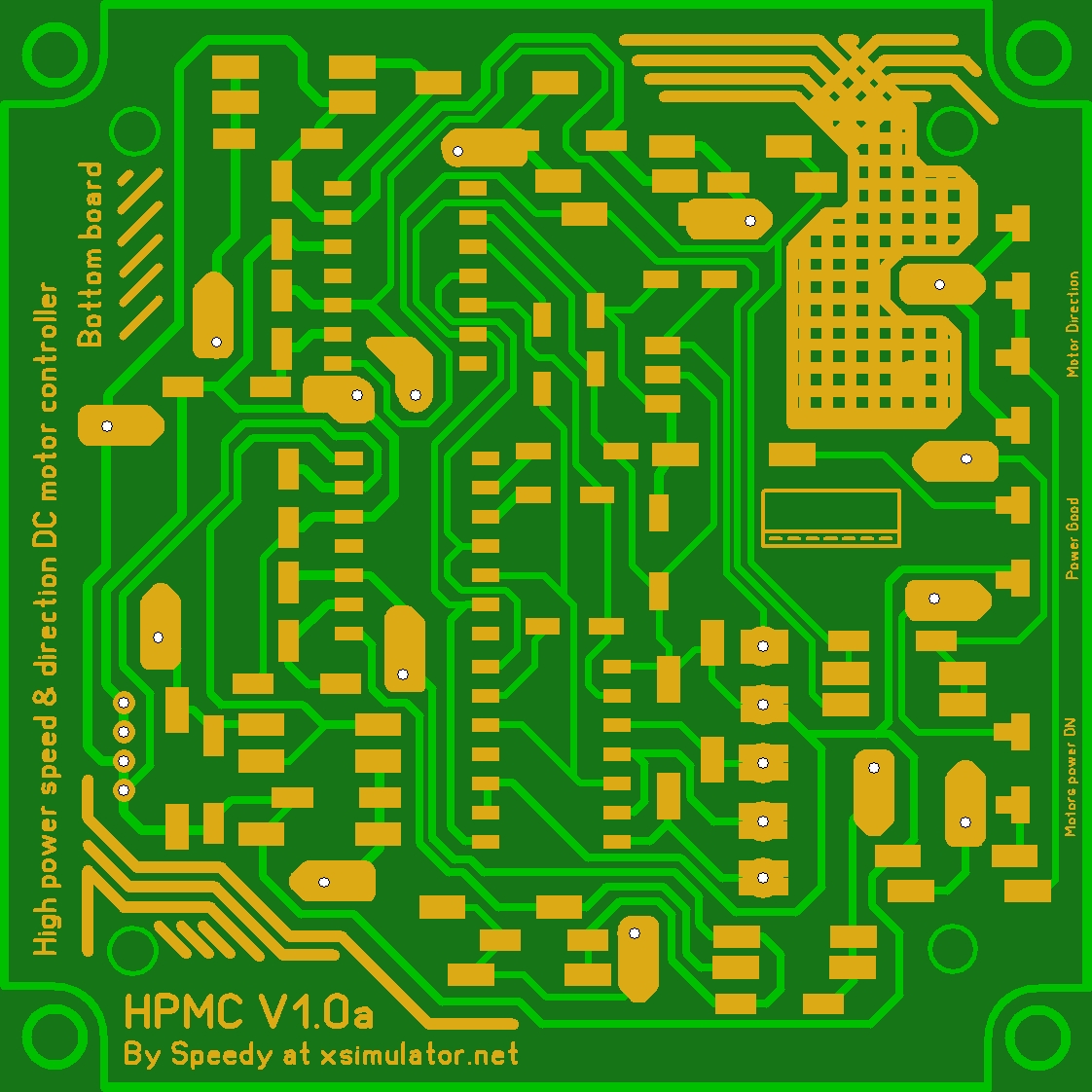

    Preview for bottom board copper layer printout for toner transfer process ...​
    HPMC v1.0a top layer copper.pdf
    HPMC v1.0a bottom layer copper.pdf

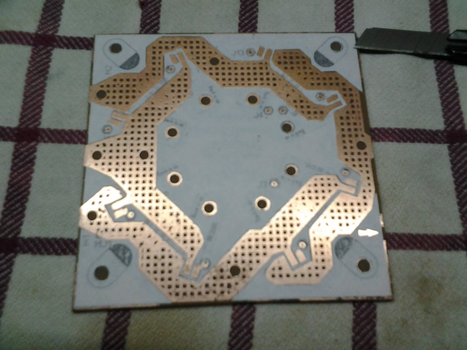

    this should be what boards look like after etching ...​
    xxx bottom board copper layer .............xxx top board copper layer .

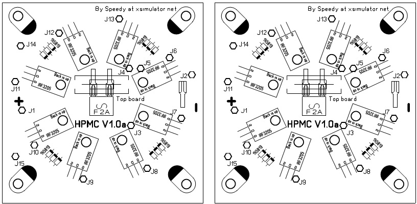

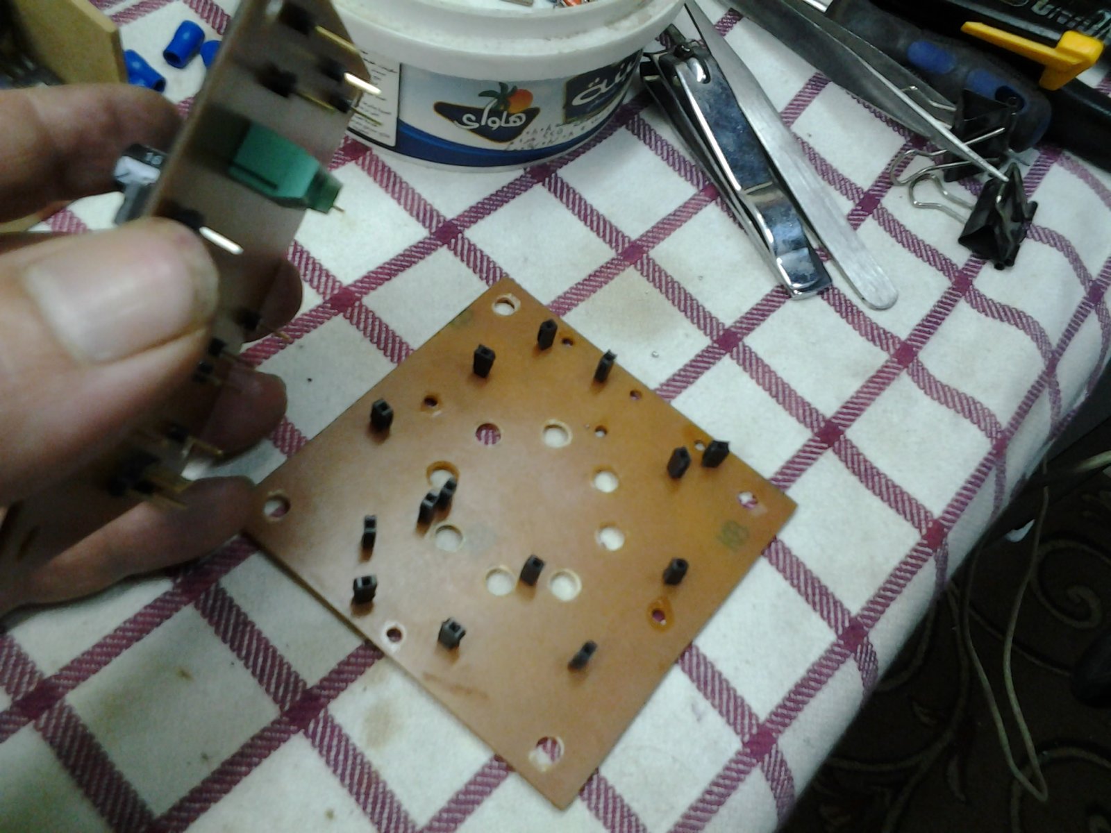

    • Drilling holes for ALL the components is spared ... due to this kind of components arranging so they are now surface mounted to the boards ... but there is some essential drilling to be done .
      So there will be 15 x 1mm a through hole jumps ... look for ( J1-... -J15 ) in the silk screen ... mounting between two boards ...
    It's recommended to : drill all holes at the same time for both boards held together with a big paper clip, So all holes are at the exact same place ...
    • and 8 x 3mm holes are required for Fan mounting, power and motor cables for each board on the sides and corners .
    • Extra 8 x 5mm holes is required to the MOSFET's mounting in the top board only( bigger holes for the screw driver ) so the MOSFET's could be fastened to the copper disk .

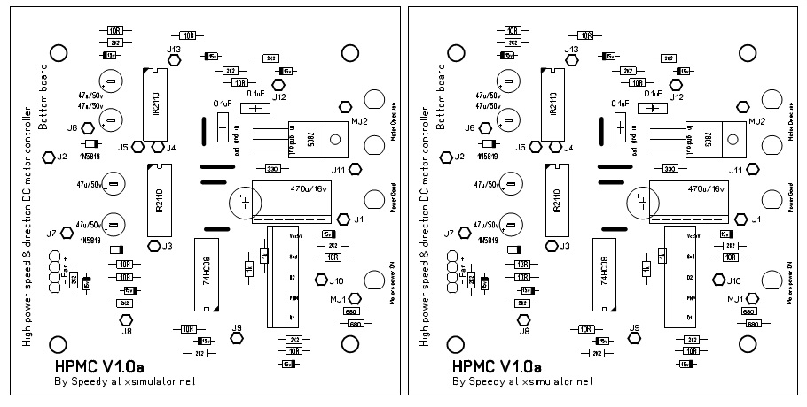

    • Silkscreen is done to the surface before soldering components to avoid making a mess with solder between tracks ...So after drilling PCB copper sides do the silkscreen layer ... use these files
    Preview for top board silkscreen print out for sticker papers ...​
    Preview for bottom board silkscreen printout for sticker paper ...​

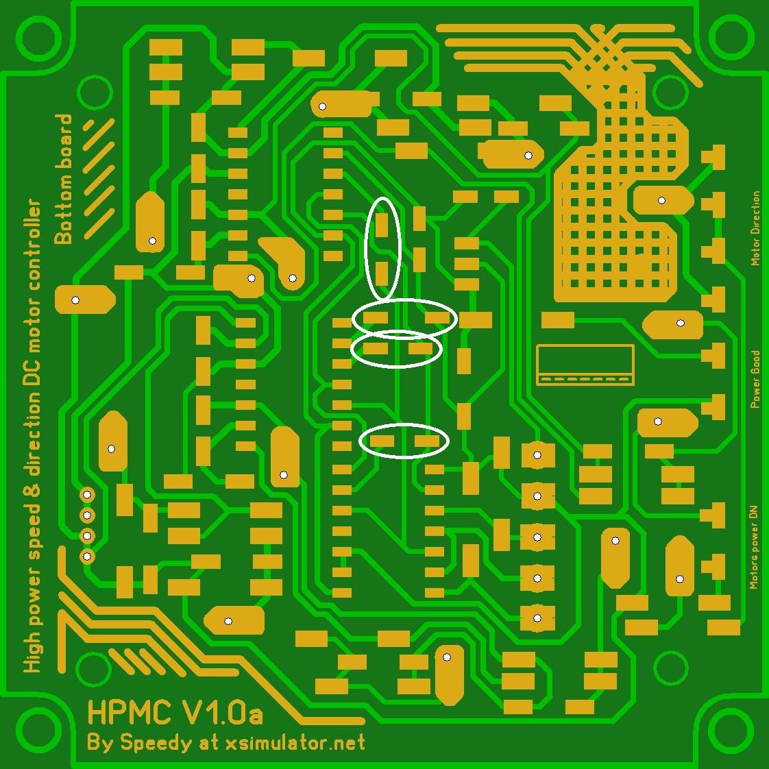

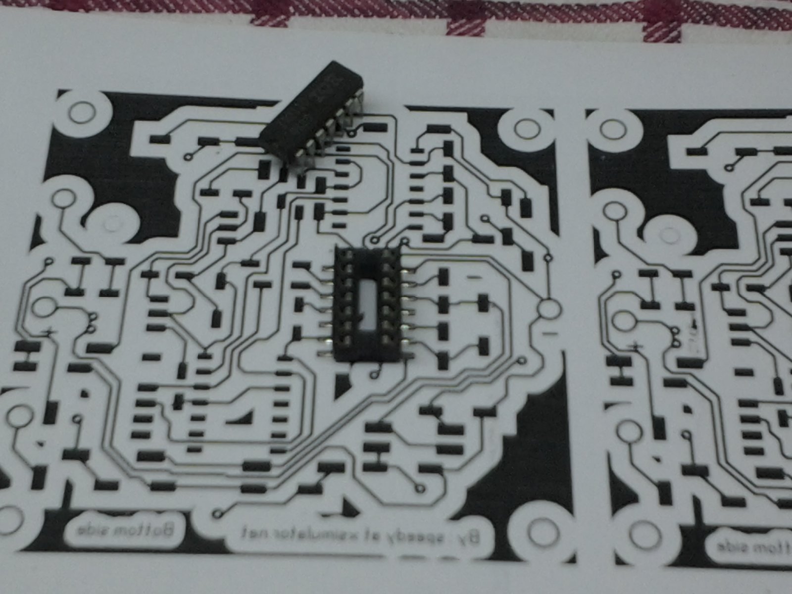

    Bottom board
    • requires to do these 4 surface wire jumps to the bottom layer circled in the following picture

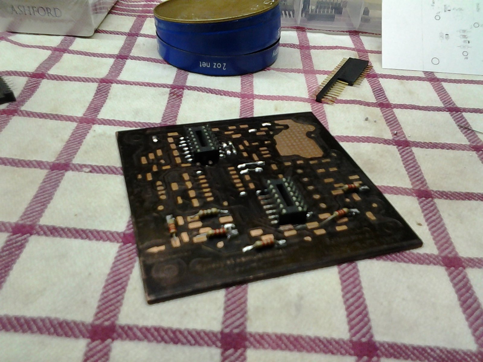

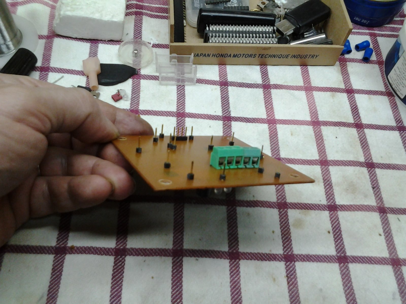

    • I prepared the copper layer to accept this easy installation for the IC base and all components .
    • start welding components small one first regarding orientation ...
    • Here is what you'll get after finishing bottom board .

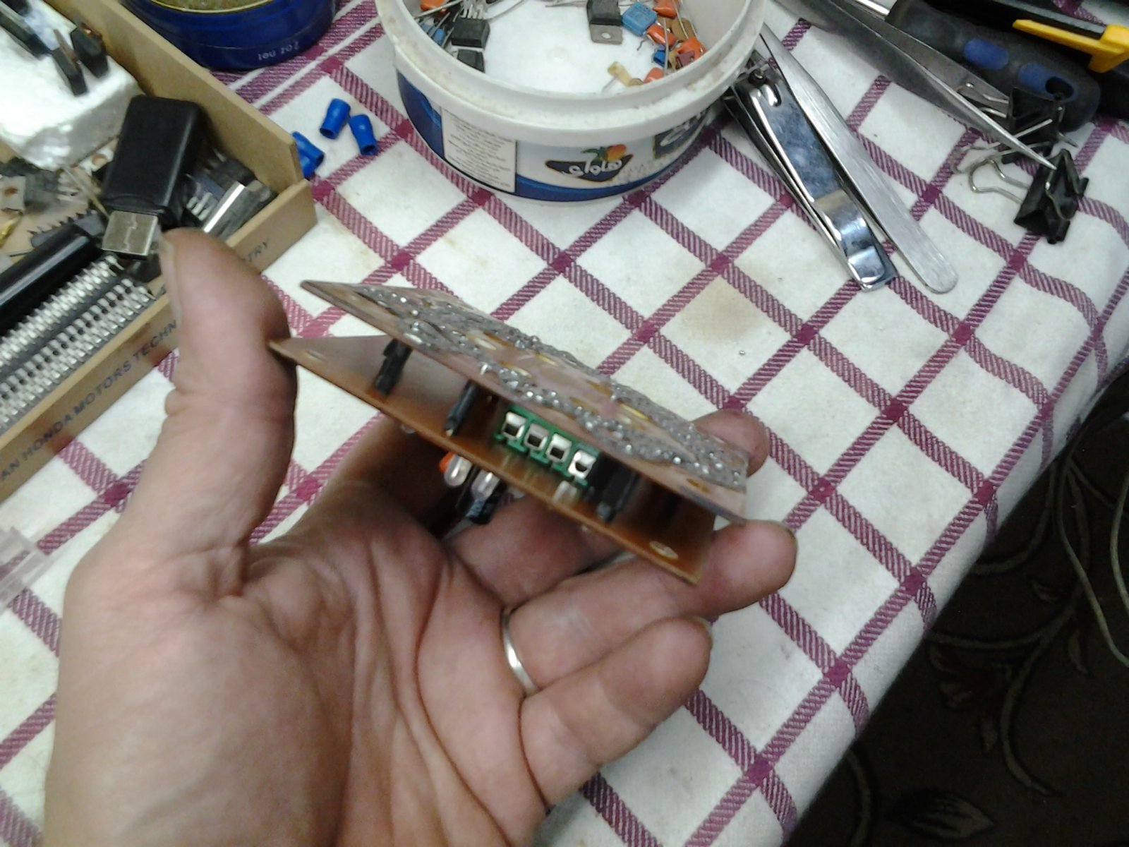

    • Now align both boards back to back and solder the through holes jumps between top and bottom board to complete there circuit ...use one male and female header or a long male header pin or any automotive pin wire terminal

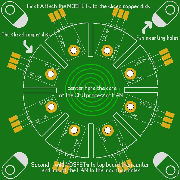

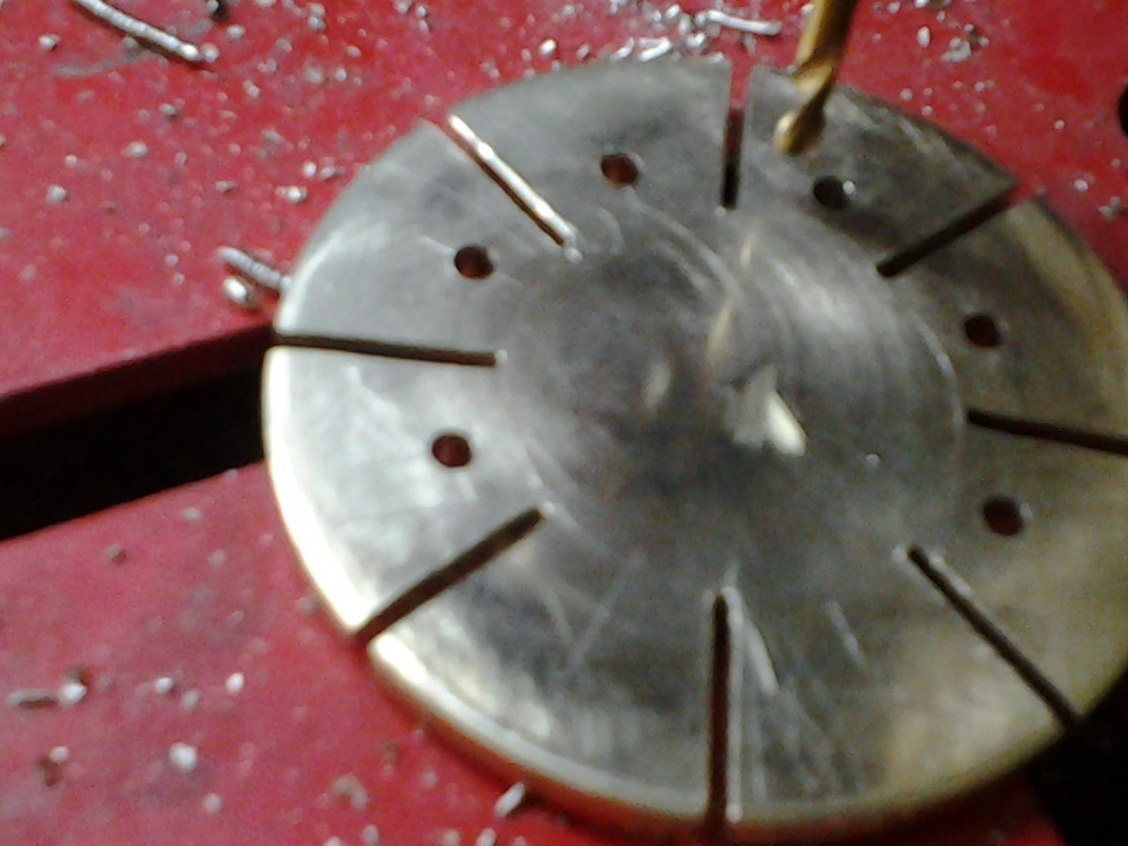

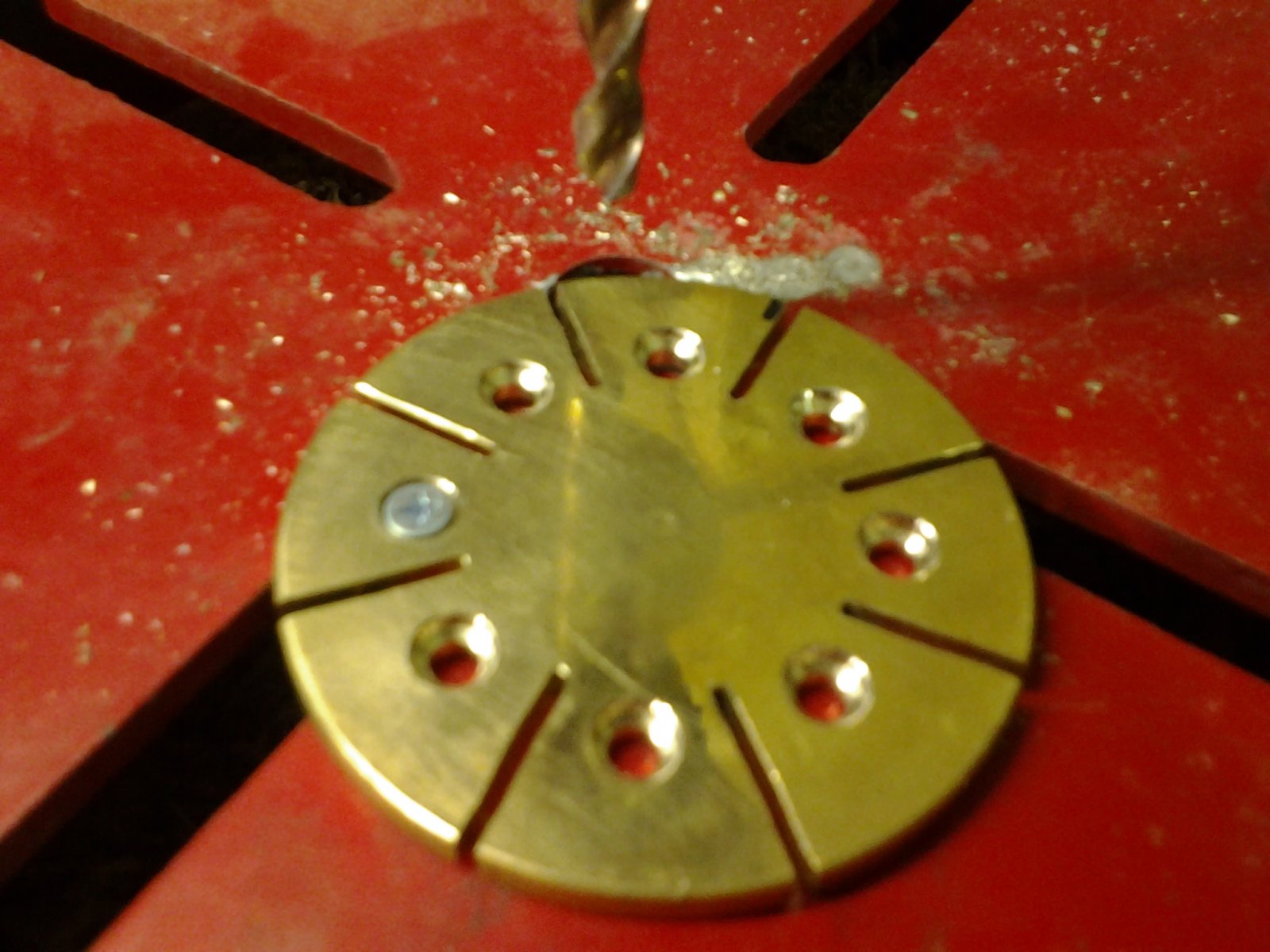

    Copper disk preparation :

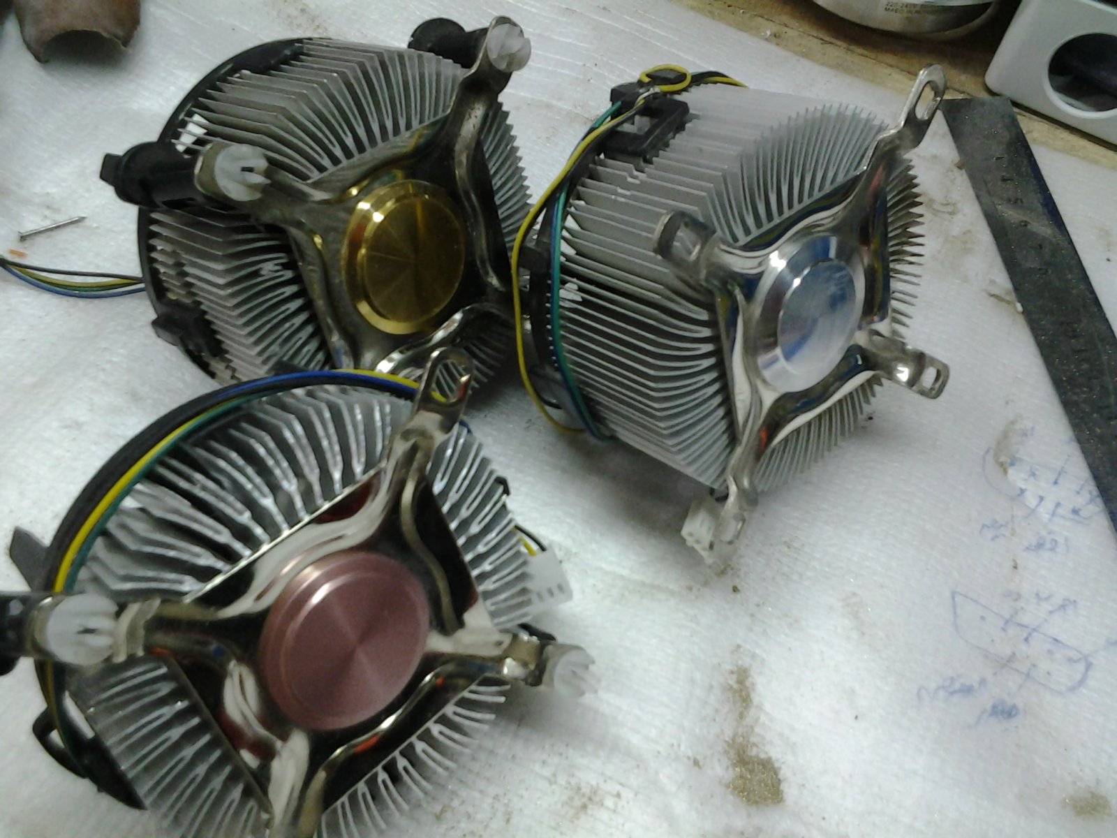

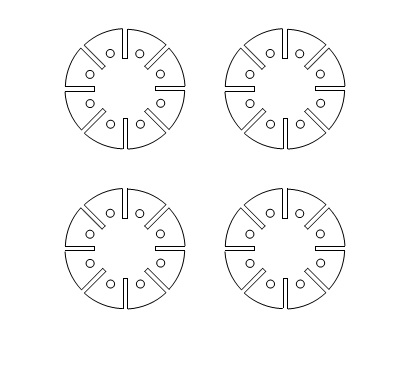

    • The cooling coefficient of the computer processor cooling fan used is amazing, and if you are a computer hardware technician (you may ask around you ) then you know what I'm talking about .
    • First ...there will be a copper disk of 6cm diameter and 3-4mm thickness ,like this .
    Pls. Don't use Aluminum instead of Copper ... Copper is best used to transfer heat like magic ... like every thing on advanced sensitive technologies around us ... And we will use Aluminum computer fan for dissipating this heat into air ...
    • For directing the heat to the center of the disk ...
    • print the copper disk drilles and slots tmplate.pdf file on paper and mark the slots and use a metal saw and open 8 slots toward the center of the disk ... then drill 8x3mm holes for the MOSFET's screws like this ... align these holes perfectly .
    • Then drill V shaped holes for the MOSFET's screws flushed top view

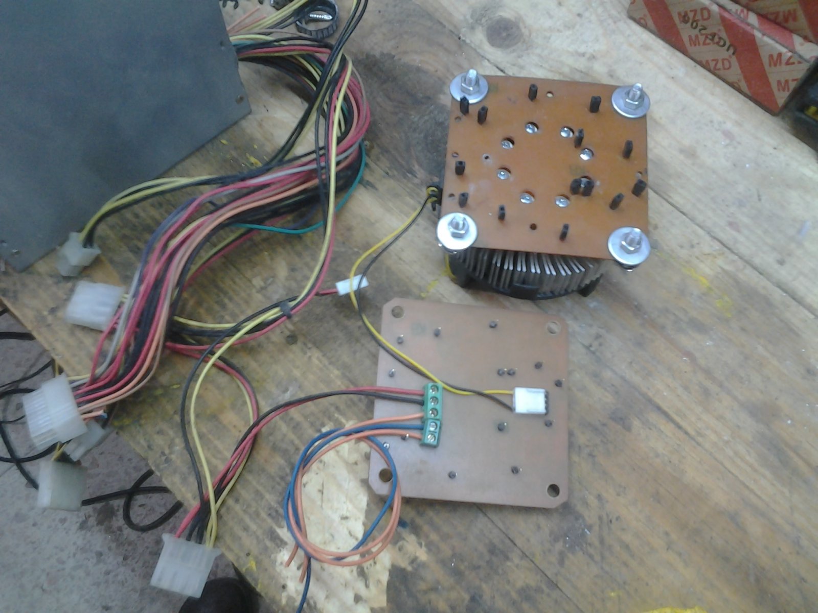

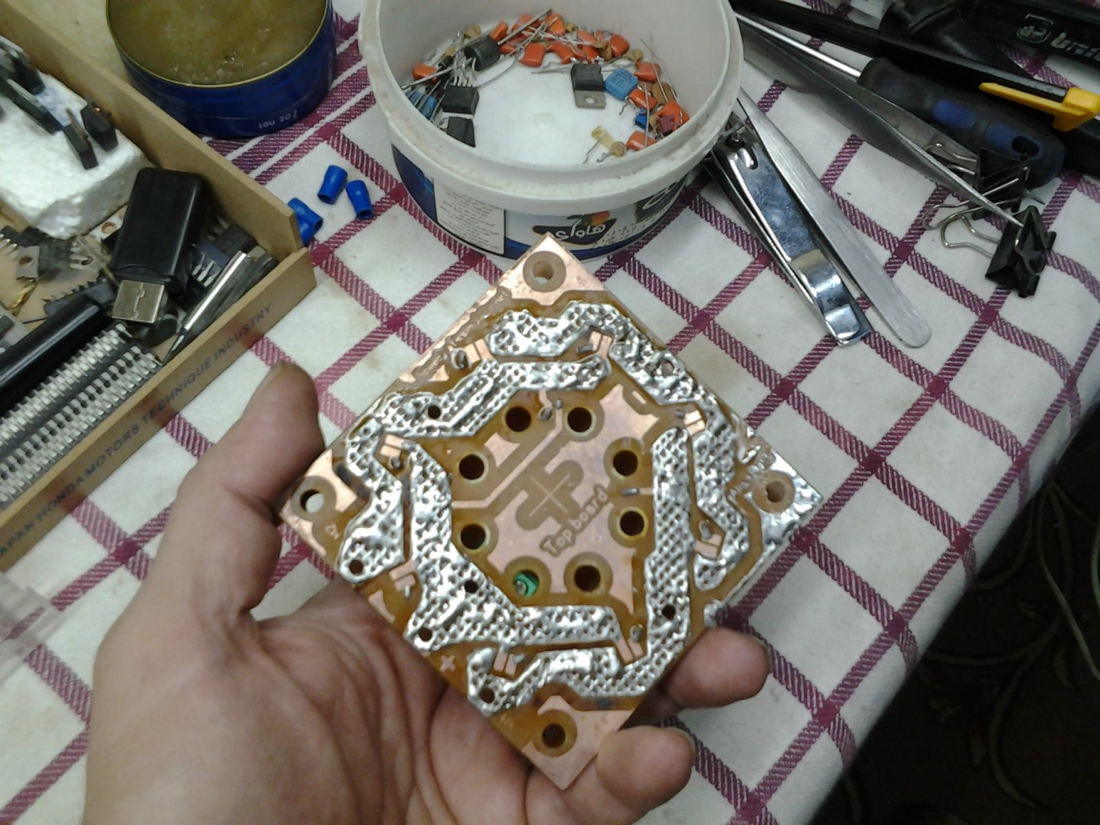

    Top board assembly
    • important work progress steps :First of all tinning the top board copper layer ... that is a very important step because it will carry all the amps to the motor ... So ,do a leveled thin shining layer of tin and try to distribute the solder all around the mesh tracks evenly ...
    • attach the diodes flushed to the surface in there places regarding there orientation ...
    • weld the through hole jumps and DIODS for the top board before the MOSFETs attachment .

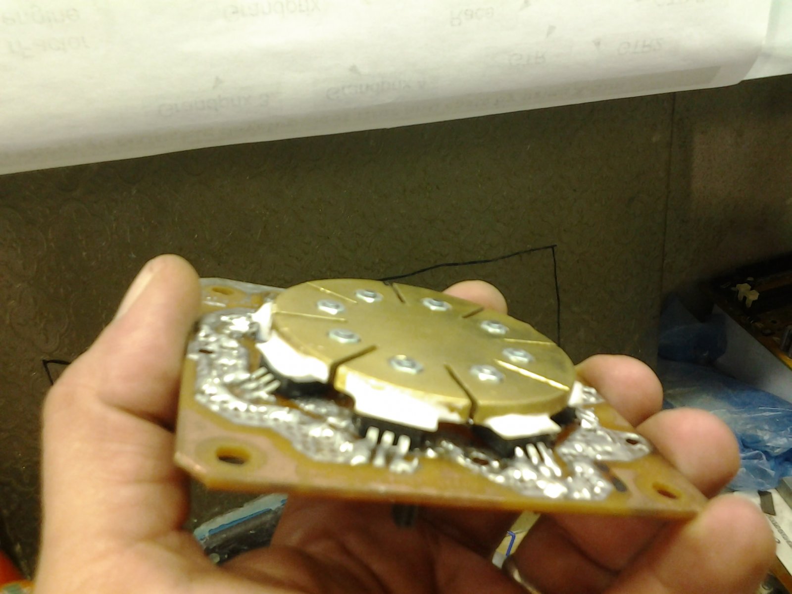

    • weld the Fuse holder to board the other side of MOSFET's ... inner space section for future easy access.

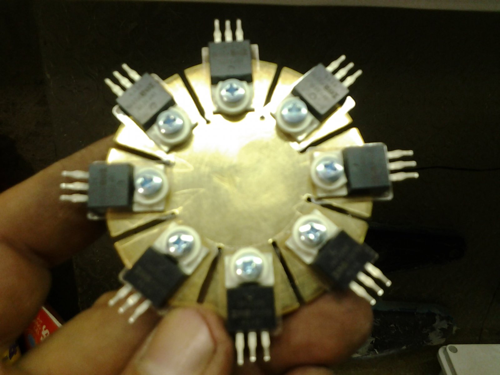

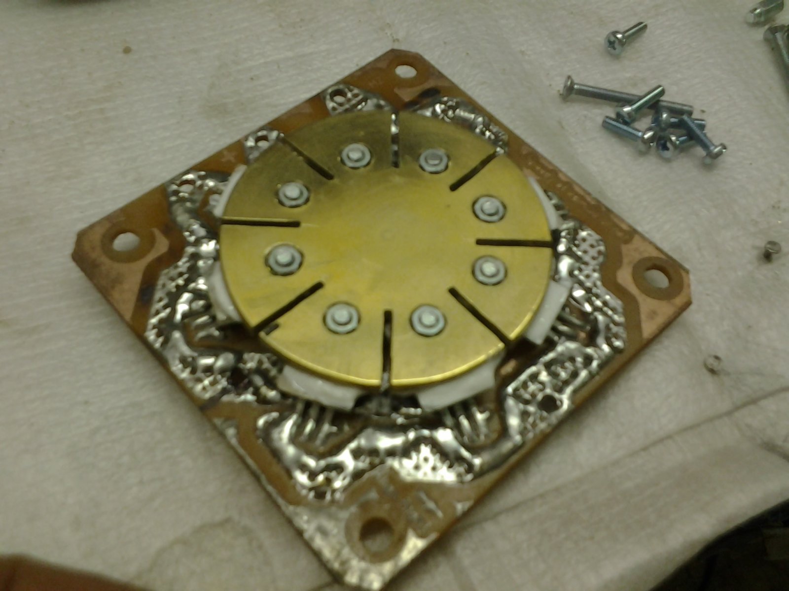

    • For mounting MOSFET's to copper disk ... don't forget to use mica insulation sheet and insulating bushing t0220 between each MOSFET and the copper disk ... like these pictures ... plus some thermal compound on both sides of the mica sheet to improve the thermal conductivity .
    • bolt each MOSFET to copper disk as previous step but not so tight like this next picture and bend each leg thick part upward ... we are here trying to solder each MOSFET from the thickest part of the leg then cut the excess part flush to the board side level .
    • Now MOSFET's will set firm when soldered to the top board ... Try aligning bolts heads with the copper disk holes then solder one leg for EACH MOSFET first then use a screw driver to fasten every thing tight ... then continue soldering all MOSFET's legs .
    • Remember to screw the MOSFET's back side to the copper disk very tight ... if not heat will not transfer to the copper .
    • Now you have the top board full assembled without the Fan ...
    • Take a good look to this picture for further easy assembling the Fan.

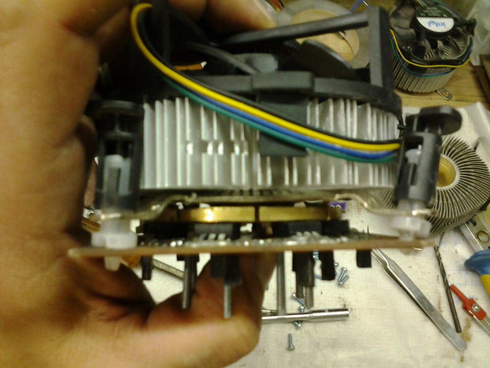

    Attaching the CPU Fan :
    • Attach the CPU fan with bolts and screws to the 4 mounting corner holes in both boards ... use some thermal compound between the fan center core and the copper disk ...
      A normal fan like this is commonly used for old computer processor cooling ...

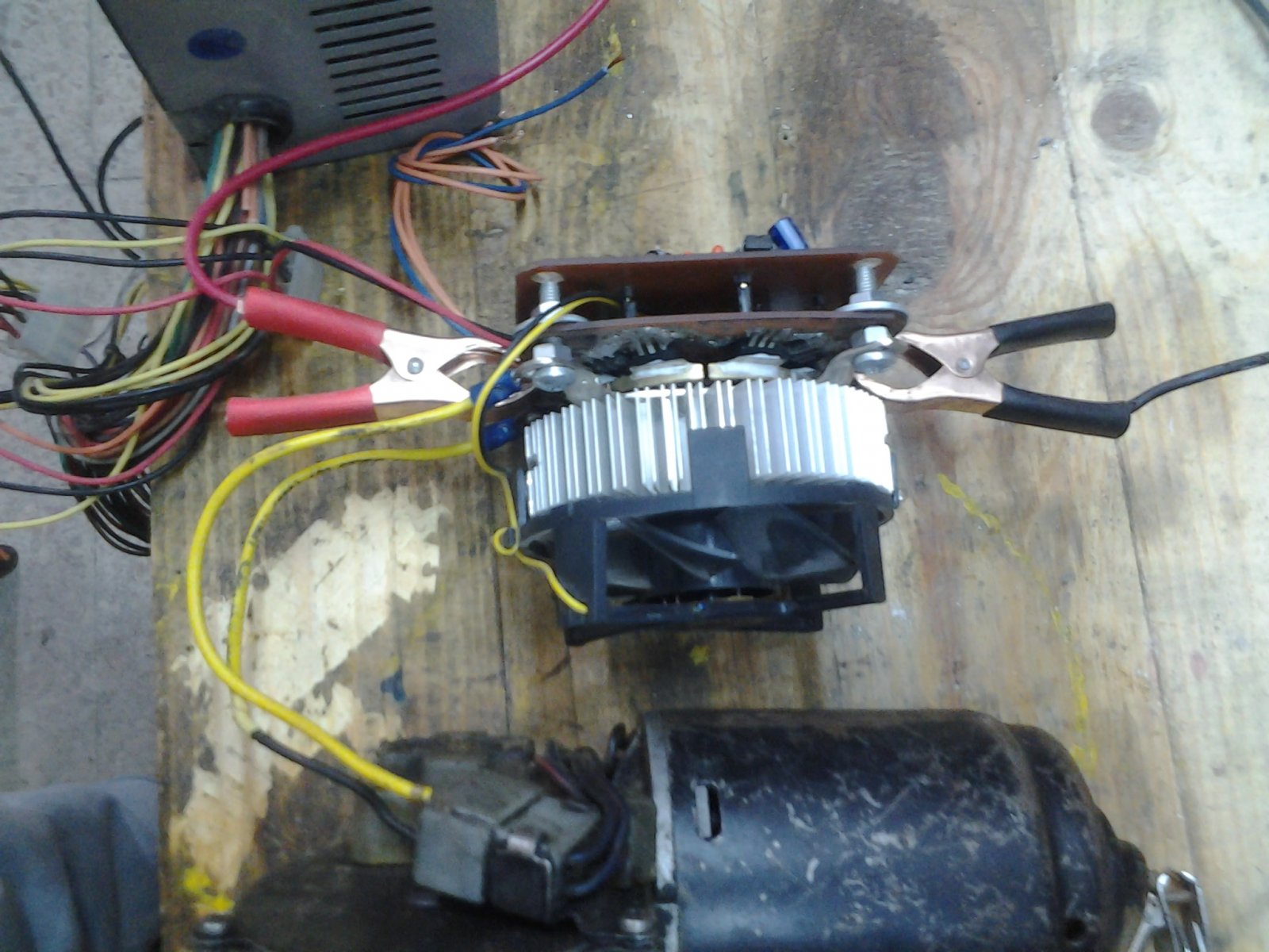

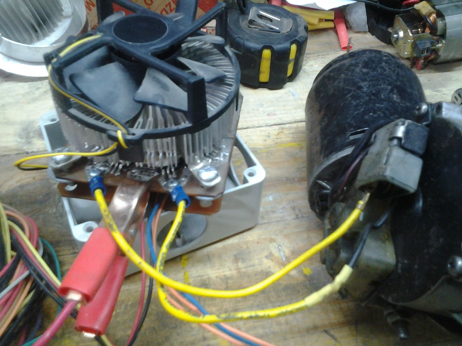

    Testing : ...
    I tested the controller on this big Bus wiper motor ...
    I Used the following steps after finishing the assembly to make a stand alone type of test for the HPMC ... powered by a 90A 12V battery charger :
    • Connected the M1 and M2 hole terminals to the motor thick wire with size 8 bolts and nuts both ends ... !!!
    • Connected the +/- hole terminals to the battery/charger with size 8 bolts and nuts both ends .
    • Connected a 5v and GND from external PSU to the Vcc-5v pin and the GND ...
    • Connect a 5v wire to the PWM pin for full PWM duty cycle signal (100% Full RPM ) .
    • Ground the D1 and D2 so the HPMC is in a full stop .
    • Get a second 5v wire and carefully touch the D1 OR D2 pins for motor forward or reverse command .
    I wish I had a bigger motor and battery to push this bridge to it's unknown maximum.

    here is some tips for preparing the copper disk I would like to share :
    1- First , please don't use aluminum instead of copper [ someone asked me for that ] and I'm telling you heat moves fast through copper .
    2- After finishing the board and the drilling s don't solder any thing yet . [​IMG]
    3- 8 MOSFET holes in the board should be drilled first ( use 3mm bits ).
    4- put the disk and the board together against strong light source and center the copper disk to the 8 holes .
    5- mark these holes onto the disk with a pencil .
    6- use the same size drilling bit 3mm and complete the 8 holes for the copper disk.
    7- use a pencil and mark a big circle of 3cm diameter at the center of the disk .
    8- using a metal saw to make slots into the disk starting from it's edge till the 3cm circle marked edge ... center these slots between the holes drilled before ... [ see picture ]... slots will help directing the heat generated from each mosfet separately to the center of the disk to the attached CPU cooler above it ... keeping other mosfets cooled as it is . [​IMG]
    9- then there you go ... continue install every thing else to the board ... when comes to mosfets just bend the legs forward to install there writings faced down to the board and the metal back is up ... and to attach them to the disk [ not the board ] you may wider the board holes to use the screw driver through them from the back side to fasten the bolts .
    - use a thermal isolating sheet and some heat compound for each mosfet to ensure a good heat conducting .
    - the easy part to attach the fan with the heat sink and centered on top above the disk [ use heat compound ] and attach fan wire to it's socket .
    article-new.jpg heat directing tword the center.JPG Cooling copper disk assymbly.JPG
    that i guess explains my idea for cooling the extra heat generated from mosfet when operating and keeping them within the operating temp .
    guys in the computer hardware field would know how much is the cooling power of this CPU fan and it's heat sink .

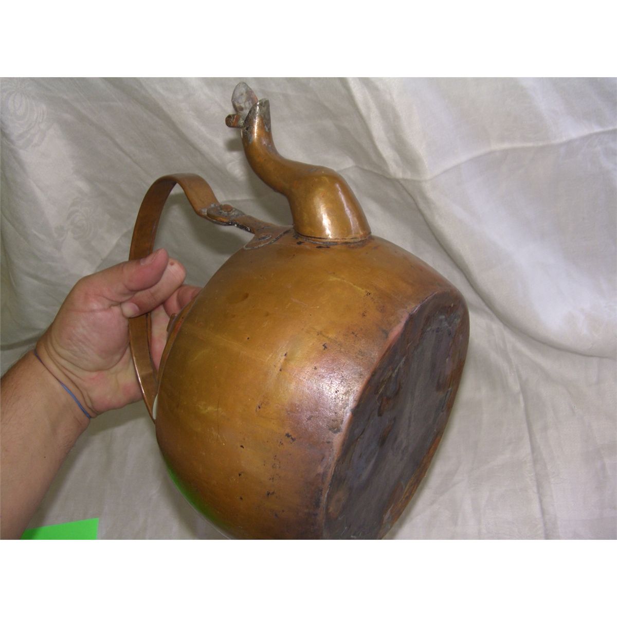

    Wow ... 13 EUR ... that's too much .:mad:
    why don't you go where you can find a Lathe machine and ask for a slice of copper with the needed dimensions ?
    Or this old pot would help ... from any scrap yard .
    cut it's bottom ...
    :rolleyes::oops::p:grin:thumbs ... Thanks Mr./Tony Stark ...
