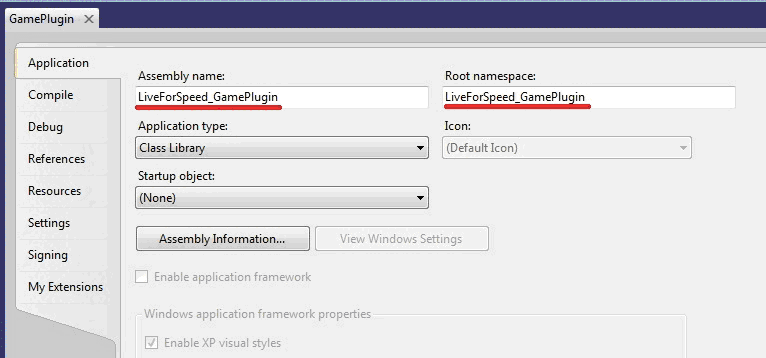

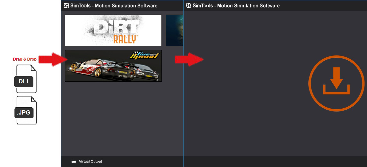

    All game plugins created for SimTools v3 are made from 4 files (with one optional):
    1)
    GameName_GamePlugin.dll
    3) GameName_MaxMin.zip
    4) GameName_Offsets.xml (Optional - used for memory hook plugins)

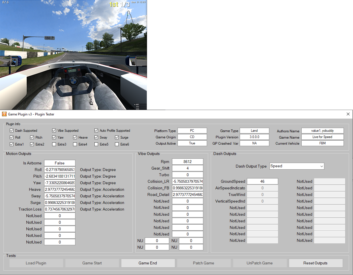

    Before we get started – Create a test app!
    I highly suggest you create a simple test app first and learn how to collect data from the game before trying to create a new game plugin for SimTools. Once you have a proven way to get data from the game, creating a plugin for SimTools will be a lot easier to put together.
    The examples below show 4 different ways to collect data from a game. Please select the example that is closest to what you are trying to accomplish as a starting point for your new game plugin.

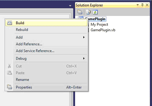

    1) Open the selected plugin by unzipping the file and then clicking on “GamePlugin.sln”.
    2) Then double click on “GamePlugin.vb” in the editor.

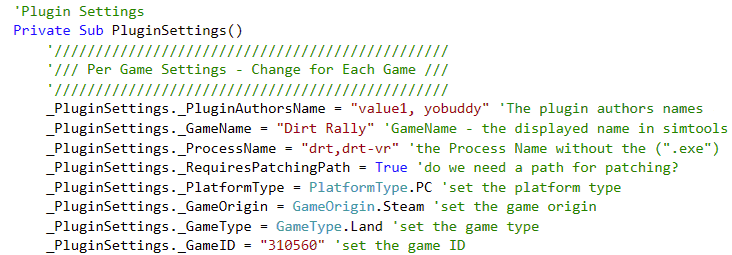

    Section 1) Game Plugin Settings
    3) Then expand the ‘PluginSettings()’ section of the plugin.
    (This is what you should be looking at)
    _PluginAuthorsName - The name (or names) of people that have worked on the plugin.
    _GameName - This is name displayed in SimTools.
    _ProcessName – The name that SimTools looks for in the list of windows processes in order to tell if the game has stopped. You can have multiple comma delimited exe names if needed. Like this (dirt2_game, dirt2VR_game, dirt2Mod_game). You do not need to add the “.exe” to the name and the exe name is not case sensitive.
    _RequiresPatchingPath – Do we need to make any alterations to the game files? When set to False, PatchPathInfo, ValidatePathPath, PatchGame and UnpatchGame never get called but the game is still marked as Patched and ready to run in SimTools. (For example memory hook plugins do not require any file patching.)
    _PlatformType
    – Is the plugin for the PC, or is it meant for Consoles? (aka - a Manual Start Plugin) When PluginType is sent to Console, PatchPathInfo, ValidatePathPath, PatchGame and UnpatchGame never get called, as the patching routine is skipped all together during installation. And the plugin is automatically set to be a manual start/ stop plugin.
    _GameOrigin
    – This tells the user where the game that was used to create the plugin originated from. It also instructs SimTools how create a launch shortcut for the game. The options are CD, Steam, Epic or Origin (Set the GameOrigin to CD whenever the other options do not apply)
    _GameType – This tells SimTools what type of game plugin we are dealing with. You can select either ‘Air, Land or Sea’. When a plugins GameType is classified as ‘Air’, SimTools automatically allows for 2 sets of Max/Min profiles for the game. (Allowing for you will have one Max/Min profile for when the plane is in the air, and a second profile for when the plane is on the ground / runway.)
    _GameID
    – This value is dependent on _GameOrigin value above. It allows SimTools to automatically create a game shortcut to launch the game. And in some cases, it can allow SimTools to automatically know where the home page is for the game too.

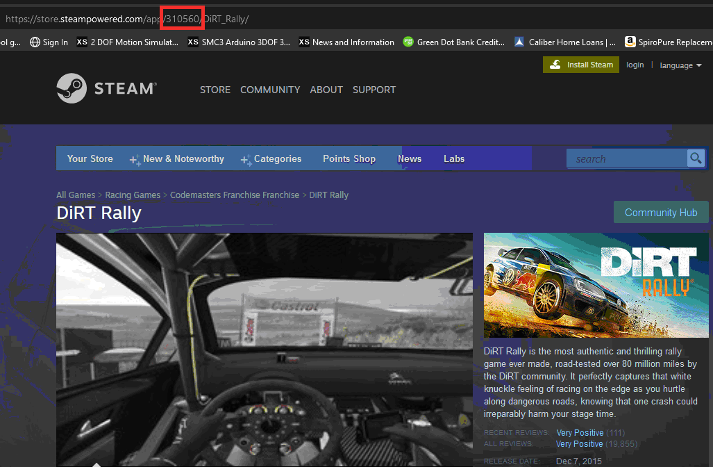

    Steam – You get the number from the https path for the download page of the game on Steam. Here I pull up the page for Dirt Rally, notice the number in the https address.

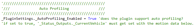

    Auto Profiling
    Auto profiling allows SimTools to automatically select the correct profile when the vehicle changes in the game. If no profile exists for the vehicle, SimTools will automatically create a profile for the new vehicle from the default profile for the game selected.
    If the games telemetry output includes the current vehicle being used, we can enable auto profiling for the game plugin. To do this we simply set _AutoProfiling_Enabled = True. And then we make sure to set the current vehicle being used to the
    ‘_Status_Outputs._CurrentVehicle’ variable.

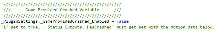

    Game Provided Crashed
    A game provided crashed variable allows SimTools to automatically detect that the user has crash and allows SimTools to trigger its internal crashed detection routine if enabled.
    If the games telemetry output includes the a variable for crashed, we can enable GameProvidedCrashed for the game plugin. To do this we simply set _ GameProvidedCrashed_Enabled = True. And then we make sure to set the current crashed state to ‘_Status_Outputs._HasCrashed’ variable.

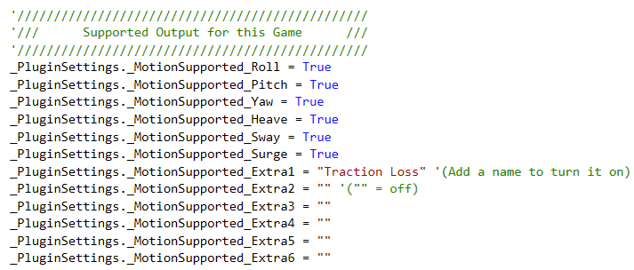

    Motion Support

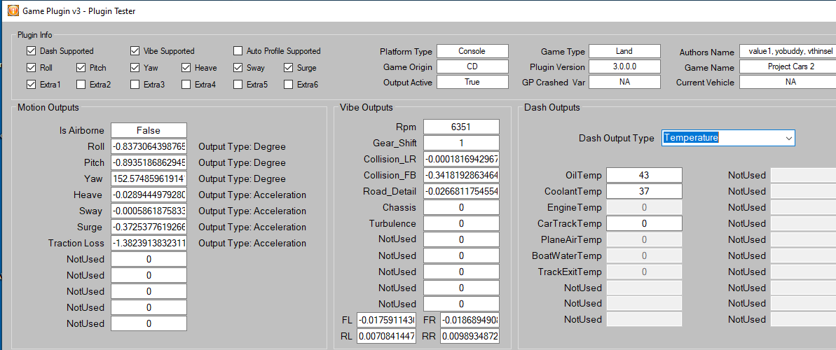

    DOF_Supported values are used to tell SimTools what DOF outputs are supported by the plugin.
    _DOF_Supported_Roll – set to true or false accordingly.
    _DOF_Supported_Pitch – set to true or false accordingly.
    _DOF_Supported_Heave – set to true or false accordingly.
    _DOF_Supported_Yaw – set to true or false accordingly.
    _DOF_Supported_Sway – set to true or false accordingly.
    _DOF_Supported_Surge – set to true or false accordingly.
    _DOF_Supported_Extra1 – “Traction Loss" Add a Force name here to set it to true.
    _DOF_Supported_Extra2 – "" Not Used set to blank.
    _DOF_Supported_Extra3 – "" Blank equals False.
    _DOF_Supported_Extra4 – "" Blank equals False.
    _DOF_Supported_Extra5 – "" Blank equals False.
    _DOF_Supported_Extra6 – "" Blank equals False.

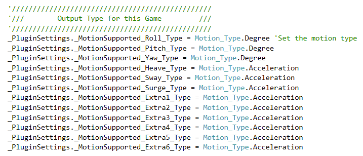

    Output Type
    This tells SimTools whether to treat the input as a degree or as an acceleration input. Acceleration inputs always return to zero when not used, where degree inputs do not return to zero and simply send the current degrees they are pointing to at the time. This value is then passed to the axis plugin so the output can be computed correctly for the two input types.

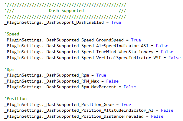

    Dash Support
    Set _Enable_DashBoard to ‘True’ to enable the Dash Output System.
    (Basic Dash Support should include Speed, Gear & Rpm)
    Once enabled, you may assign Dash output variables.
    ~ Assigning Dash Outputs ~
    (All dash outputs get assigned to the ‘_Dash_Outputs’ structure.)
    Assign the dash output variable as follows:
    (Set the corresponding var above to true or false, then assign the output as follows.
    _Dash_Outputs._Speed_GroundSpeed = .speedKmh.ToString
    _Dash_Outputs._Rpm = Int(.rpms + 0.5).ToString
    _Dash_Outputs._Position_Gear = .gear.ToString
    _Dash_Outputs._Capacity_FuelLevel = .fuel.ToString

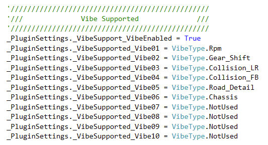

    Vibe Support (Buttkicker)
    Set _VibeSupport_VibeEnabled to ‘True’ to enable the Vibe Output System.
    (Basic Vibe support should include Speed, Gear & Rpm)
    Once enabled, you may assign up to 12 output variables.
    Here is the list of inputs we currently have for vibe.
    Vibe Input (What to output from the game to use)
    Afterburners (Afterburners)
    Chassis (FL, FR, RL, RR)
    Collision F/B (Surge)
    Collision L/R (Sway)
    Flaps (Flaps)
    Gear Shift (Current Gear)
    Landing Gear (Landing Gear)
    Road Detail (Heave)
    Rpm (Rpm)
    Turbo (Turbo)
    Turbulence (Speed)
    Weapons Bombs (Fired Weapon)
    Weapons Cannons (Fired Weapon)
    Weapons Flairs (Fired Weapon)
    Weapons Guns (Fired Weapon)
    Weapons Other (Fired Weapon)
    ~ Assigning Vibe Outputs ~
    (All vibe outputs get assigned to the ‘_Vibe_Outputs’ structure.)
    Assign all vibe output variables as follows: (Except 3D Chassis)
    (Set the corresponding var above to a output type, then assign the output as follows.
    _Vibe_Outputs._Vibe01 = .m_iRPM
    _Vibe_Outputs._Vibe02 = .m_iGear
    Assign the 3D Chassis variable like this:
    _Vibe_Outputs._Vibe_Chassis_FL = .suspensionTravel.Front_Left
    _Vibe_Outputs._Vibe_Chassis_FR = .suspensionTravel.Front_Right
    _Vibe_Outputs._Vibe_Chassis_RL = .suspensionTravel.Rear_Left
    _Vibe_Outputs._Vibe_Chassis_RR = .suspensionTravel.Rear_Right

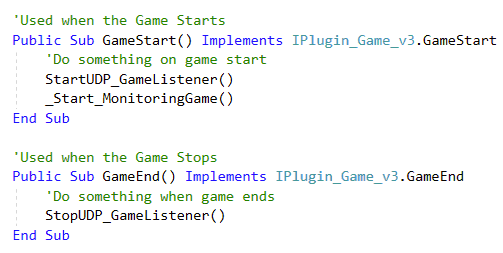

    Game Start and Game Stop
    With the GameStart and GameEnd routines below, we can start and stop the telemetry data collection from the game. In the pic below you can see that we are also collection the status of the game (Game is live or paused) and passing the status to SimTools as this is now required in v3.

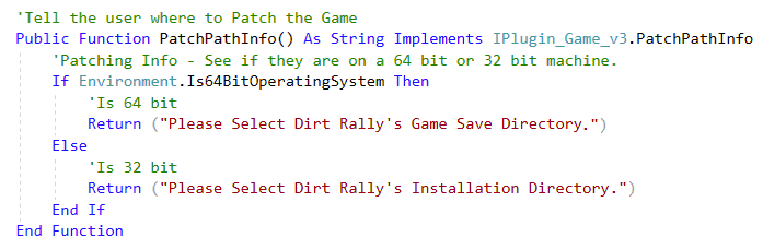

    This section will show you how to construct a patching routine for your new game plugin.

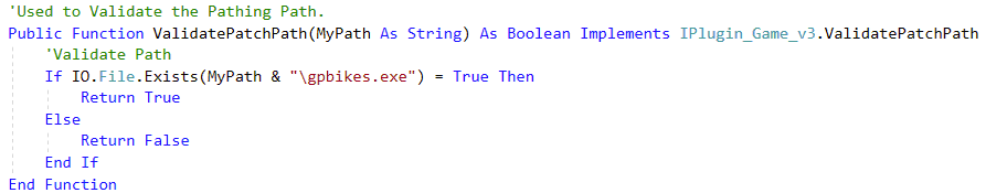

    PatchPathInfo
    This is used to tell the user the location they should patch there game at. It is presented to the user when they install the plugin.

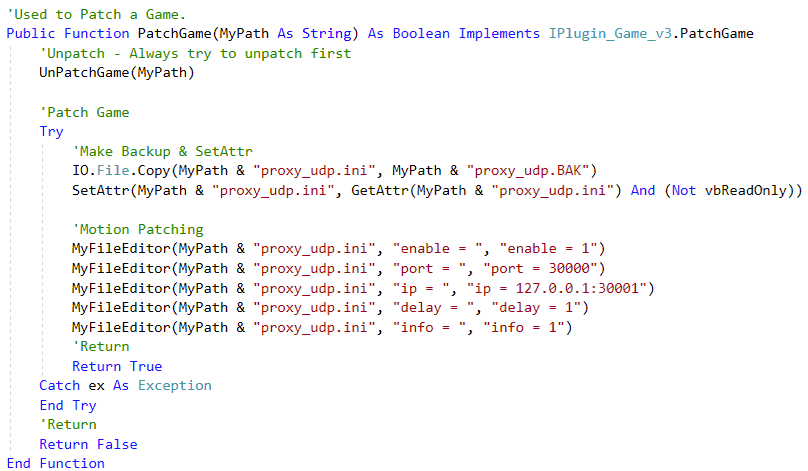

    PatchGame
    This is used to edit a .txt or .cfg file (Live for Speed plugin example) or to install a custom DLL (rFactor plugin example) to enable telemetry output from the game. I strongly suggest you always backup any file you're going to edit before patching, and always try to restore the backup before trying to patch the game. (see the PatchGame routine in the picture below.)

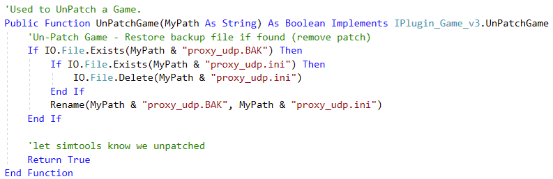

    UnPatchGame
    This is used to remove whatever alterations were made to the game during the PatchGame procedure.
    ValidatePatchPath
    This is used to validate the path passed to SimTools from the user. In the picture above, we see that the user has a valid path when the path has the file “hardware_settings_config.xml” present. (In other words, it makes the user select the Dirt Rally folder)

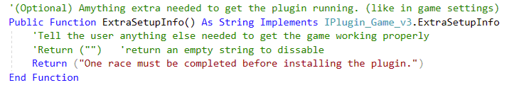

    ExtraSetupInfo
    Here we should explain to the user, any extra steps that may be needed, to get the plugin running. Like needed in game settings to get telemetry running, where there are no files we can edit during the patching process to enable telemetry.
    Section 4) Game Status
    In SimTools 3, the plugin controls when the game is active or not. This allows us to get the same ‘centering when paused’ output, no matter how the game is collecting the data. All we need to do is set the _Status_Outputs._OutputActive variable to the current state of the game.
    In some cases a variable is provided by the game, and in others where the game sends UDP data, you can simply detect when the UDP stream is active or not. For all games that send telemetry over UDP, you can simply copy the ‘Game Monitoring’ routine out of any UDP example plugin I have source available for.

    How to Compile the Plugin
    Click on “My Project”
    Make sure the “application” tab is selected. Now name the Game Plugin DLL as follows: GameName (without spaces) + _GamePlugin.
    So for this example we get ‘LiveForSpeed_GamePlugin’. Use this name for both the ‘Assembly Name’ and the ‘Root Namespace’ as in the picture below
    Right click on GamePlugin in the solution explorer and select Build!
    Your new Game plugin can now be found in the folder;
    ExamplePluginFolder\ GamePlugin\GamePlugin\bin\Release\MyPlugin_GamePlugin.dll

    How too install your new game plugin.
    Launch SimTools v3 and then Drag-n-Drop the plugin and the banner into the main window.
    Give your new game plugin a test, and while its running, and Capture valid Max/Min Settings for the game.

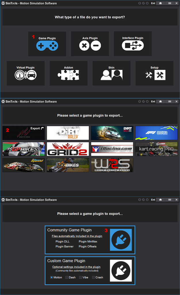

    How to export the final game plugin.
    (Please make sure you have Captured valid Max/Min Settings for the game before proceeding.)
    Click on the main menu button and select Options.
    In the lower right of the Options page you will find Export.
    Then select Game Plugins and select your game plugin to export.
    Lastly, select Community Plugin and your new plugin will be exported to "Documents\SimTools Exports".

    ~ Game Plugin Tester ~
    Here is the official game plugin tester app. (The first of the plugin tester series of apps!)
    It was built so a plugin writer can easily test all aspects of their new game plugin in a simple visual way.
    The game plugin tester can be really handy for verifying the outputs of your new game plugin, but can be used for full plugin debugging also.
    Notice you can select any dash section output from the dash output type menu.
    And you will notice the dash outputs for any section will either be enabled or disabled.
    (This action is done directly from the plugins dash supported settings.)
    Preview: Game running and I clicked the 'Game Start' button in the game plugin tester.
    Game Plugin Tester Download:
    Game_PluginTester_v2.zip
    Let me know if you have any questions.

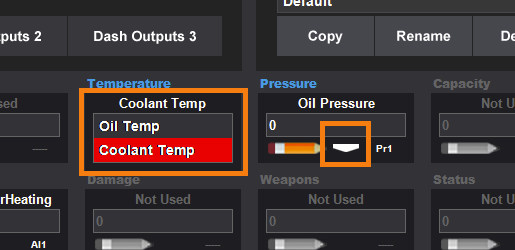

  14. yobuddy
    5,408
    50,690Coins
    +5,166 / 19 / -0
    Yep, those are them.
    When a group has more than one output option (temperature below), you will get a little white down arrow where you can select the output you want to see.
    And once you pick a selection, you can see the name used to send the output on the form.
    Hope that helps!
