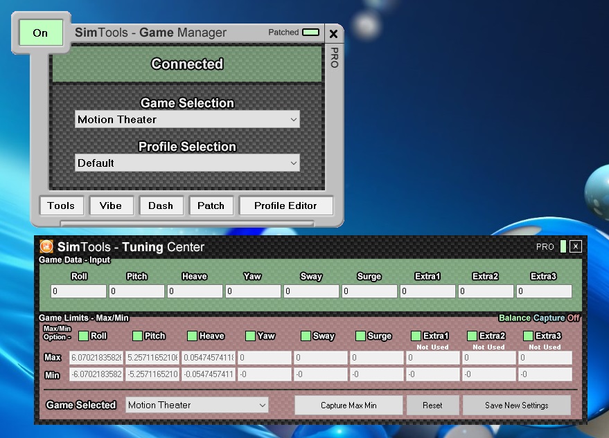

    Hi!
    I made UDP type plugin (from DIRT2). I develop my own game application. It looks like UDP packets don't go to plugin. I use C# UdpClient class. For testing I made simple receiving app and it gets my UDP packets well. Can you give me working c/c# example HOW to send UDP packets to plugin?

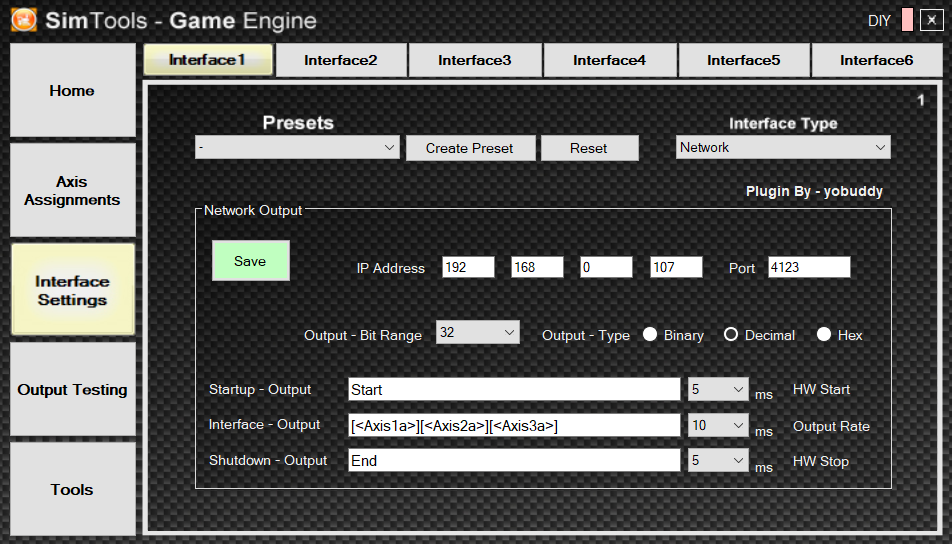

  12. syedhs
    syedhs New Member
    Jun 10, 2009
    16Coins
    In my case, the ProcessName was exactly the same down (and even down to case sensitive). AxisAssignment has been done and Interface output has also been set. Very strange..
  13. syedhs
    syedhs New Member
    Jun 10, 2009
    16Coins
    Since I can no longer edit my post (due to 1 minute restriction)..
    the ip in the image above has been confirmed to be correct. And in previous attempts, I also tried 127.0.0.1 ...
  14. AndreyGudymovich
    AndreyGudymovich New Member
    Aug 7, 2019
    29Coins
    Hi!
    I guess the Interface settings which you've done is about SimTools OUT. You plugin is for getting data from your source TO SimTools (you can ask SimTools tech. support for details)
    So if you set this Network type it means the SimTools will send data got from your plugin to this address and port. May be you use same port? In this case will be conflict.
    So check this and check that you implemented patch functions properly. Your plugin must make patch. Patching can be nothing but patch methods must return needed results.

  16. AndreyGudymovich
    Aug 7, 2019
    29Coins
    I looked at your plugin code. All must work. Le me describe what I did and I was sure that plugin is working.
    I complied my plugin. I run SimTools plugin updater and istalled my plugin. After it I started SimTools Manager and selected my plugin. I opened SimTools turning center and saw my data values from my game. mt.jpg My game name is Motion Theater. Game Data Input fields were filled with my data.

  17. yobuddy
    51,741Coins
    +5,205 / 19 / -0
    @syedhs is quite correct.
    If SimTools is both trying to recieve data on port 4123 and also send the data on port 4123 there will be a port conflict.
    For now, I would simply set the output interface port to 5555 or something else.
    You you probably will not get any data...
    Take care!
