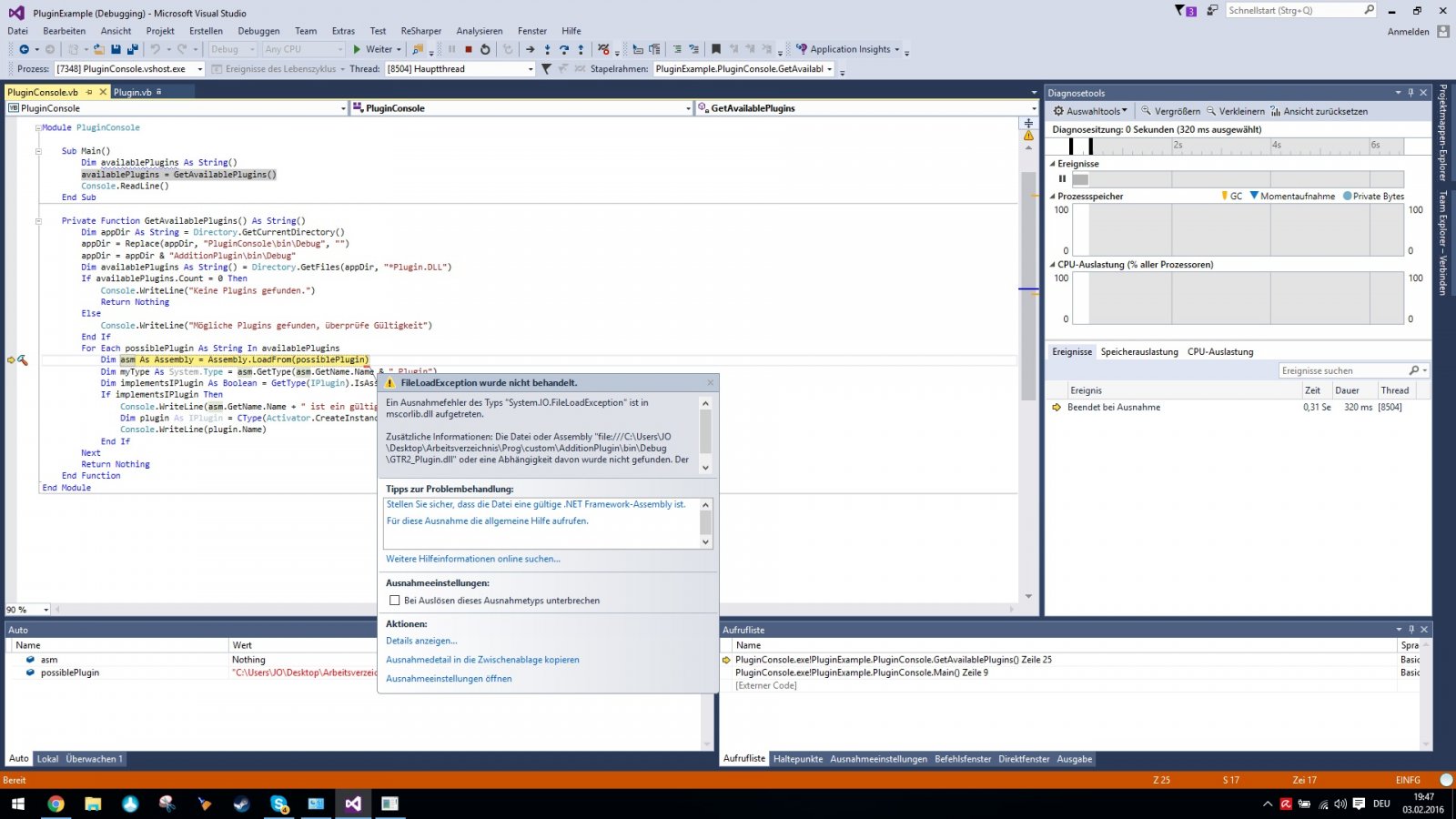

    Not Sure if you already solved the issue, but I got the same error if I forgot to build the application before compiling it (Build->Build Solution).

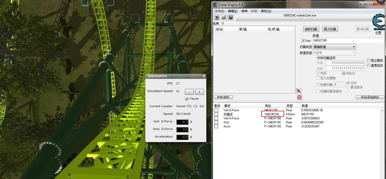

    Further to that point, there is a cheat engine tutorial on youtube where he extracts the x,y,z positions of the main character:

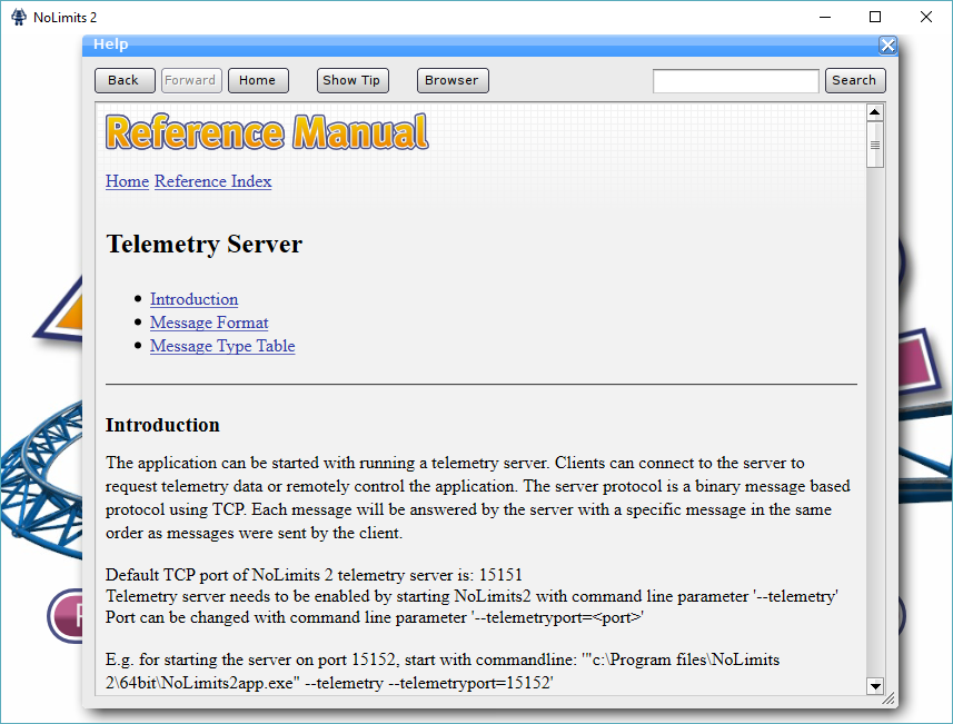

    Hi @AlexinChina
    I mean, feel free to develop a memory hoock plugin for NLS.
    However just to mention: The NLS plugin already provides surge, sway, heave acceleration, pitch, roll and yaw.
    Also NLS provides a proper API (application programming interface) which is documented in the Help file of NLS

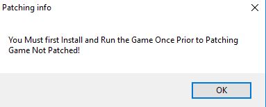

    I'm trying to create a plugin for F1 2016, but while trying to patch, I am getting this error;
    The game is installed, and I am attempting to change the LFS plugin. Being a Codemasters game, I would need to patch the F1 2016 folder in my documents, but no matter what I seem to type in the validation string, I cannot get it to patch. The plugin is nowhere near done, I was just testing to see if I could actually work out how to make Simtools create the patch in the correct location.
    Go easy on me as I am trying to learn :)
    Cheers for any help.

    Hi I'm just starting to learn about plugins myself my best guess is there's something that still points the LFS left in the plugin you have made so it thinks it's not installed ( just a guess I'm new too lol)

    Hi Daguru,
    I thought that too, but can't seem to see anything. It would be handy to know the procedure with Codemasters games, as you are not pointing directly at the .exe
    Thanks for the advice though :)
