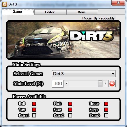

    DOF’s used for this game
    These values are used control the red dots on the Profiles Page. See below.
    They tell the user what DOF outputs are supported by the plugin.

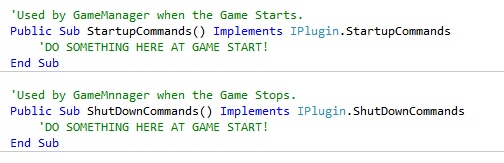

    Startup and Shutdown Commands
    if your game needs any extra commands to start or stop the collection of data, it can be entered here.

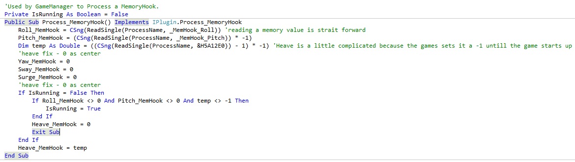

    Process a Memory Hook
    Place your end results in the output variables, Roll_MemHook, Pitch_MemHook, Etc...
    NoLimitsCoasters – Example shown - Roll, Pitch etc... memory readings are strait forward.
    No need to alter the Process_PacketsReceived subroutine when using a memory hooked game.

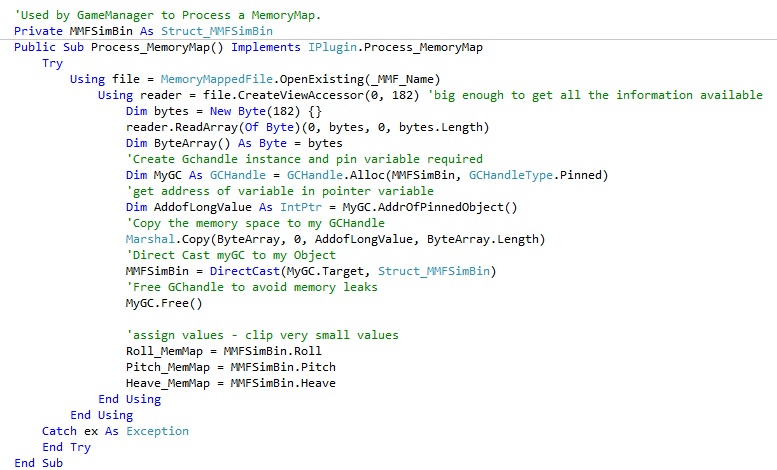

    Process a Memory Map
    Place your end results in the output variables, Roll_MemMap, Pitch_MemMap, Etc...
    GTR2 – Example Plugin - The data structure is copied from memory and then outputs are assigned to the MemMap variables.
    No need to alter the Process_PacketsReceived subroutine when using a memory mapped game.

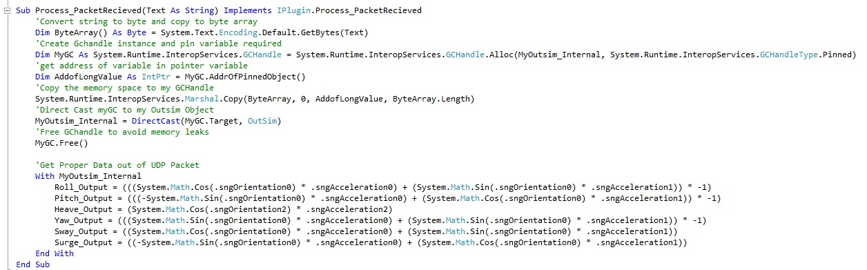

    Process the Packets Received
    Decipher the incoming UDP packets from the Game or Game Manager into Game Engine. The following is an example of deciphering the outsim udp packet captured directly from the game. See the Live for Speed example plugin for more info. Simply place the end results in the output variables, Roll_Output, Pitch_Output, etc... (There is no need to alter this subroutine if you are using a memory mapped or memory hooked game) (Used by GameEngine)

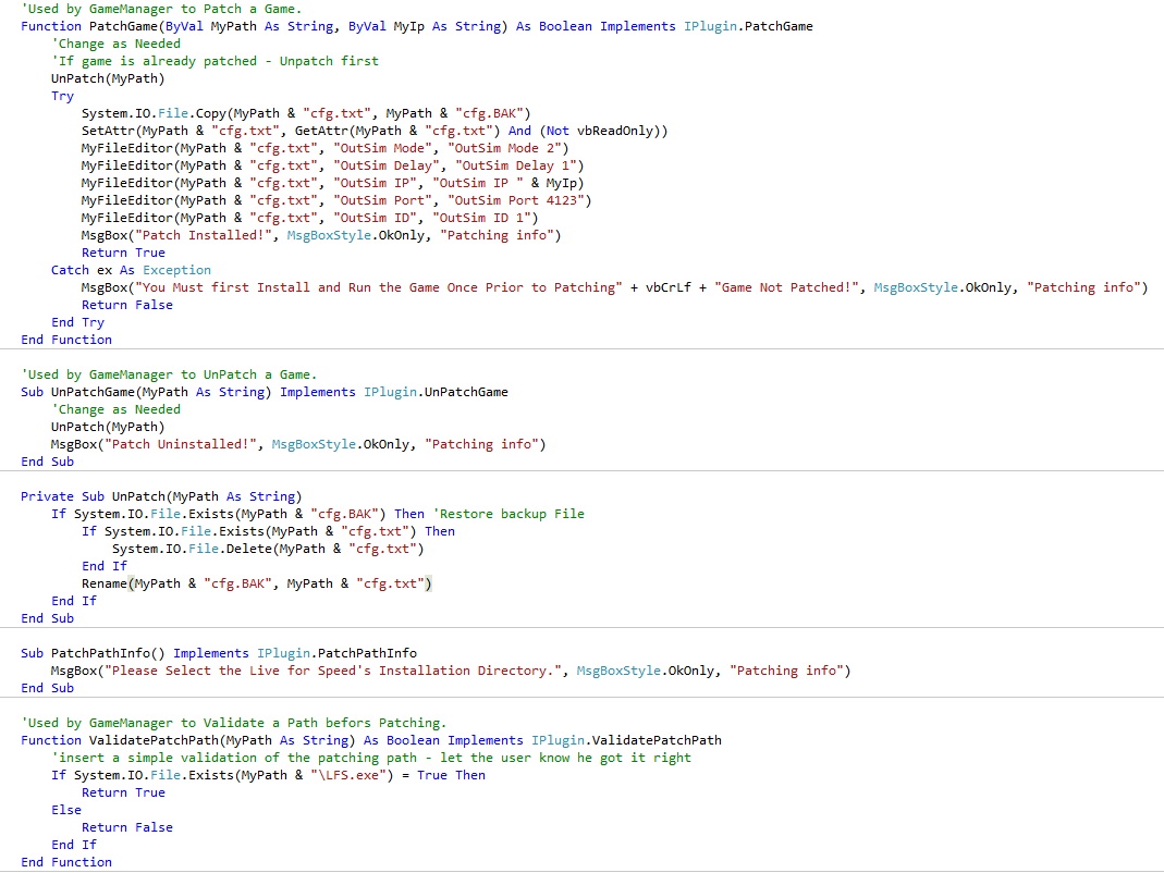

    3) Patching the Game
    This section will show you how to construct a patching routing for the game section of SimTools
    PatchPathInfo
    This is used to tell the user the location they should patch there game at. It is presented to the user when they press the “Edit Path” button in GameManager.
    ValidatePatchPath
    Used to enable or disable the “Patch Game” button in GameManager. In the picture above, we see that the user has a valid path, when the path has the file “LFS.exe” present. (In other words, it makes the user select Live for Speeds installation folder)
    PatchGame
    Used to install a DLL (rFactor plugin example) or edit a .txt or .cfg file (Live for Speed plugin example) to achieve telemetry output from the game. With most games, I made a backup of the file I’m going to edit and save it to cfg.BAK.
    UnPatchGame
    Used to remove whatever alterations were made to the game during the PatchGame procedure.

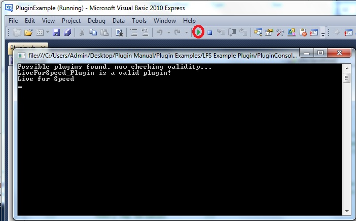

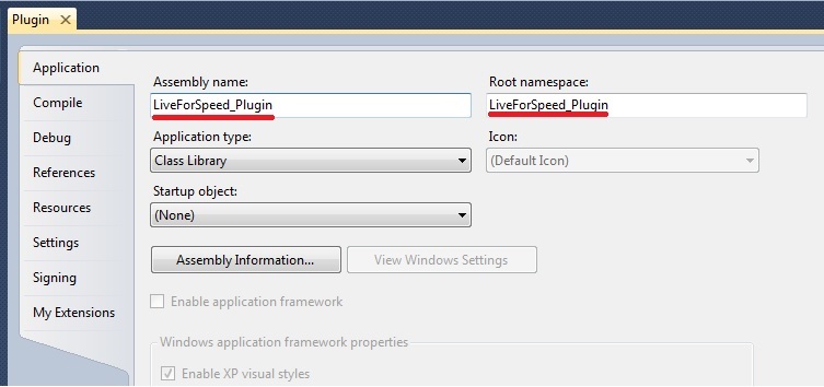

    How to Compile the Plugin
    Click on “My Project”
    Make sure the “application” tab is selected. Now name the game DLL as follows: _GameName (without spaces) + _Plugin.
    So for “Live for Speed” we get ‘LiveforSpeed_Plugin’. Use this name for both the ‘Assembly Name’ and the ‘Root Namespace’ as in the picture below
    Click the green play button at the top of the screen and it will compile you game dll and verify it as a plugin for SimTools.
    Once verified - it reads back the _GameName from within the dll itself.
    Your new game plugin can now be found in the folder:
    Example Plugin Folder\AdditionPlugin\bin\Release\MyPlugin_Plugin.dll
