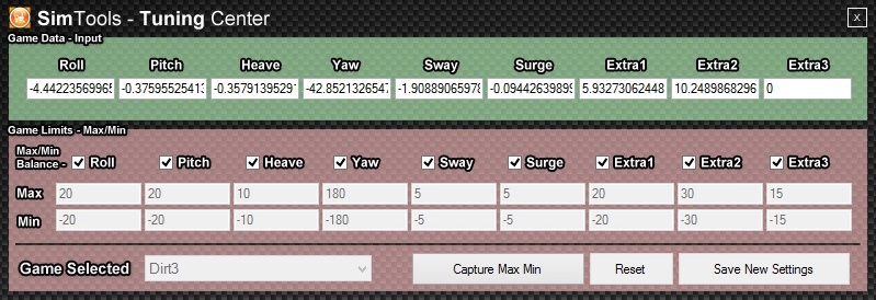

  11. value1
    Jan 9, 2011
    2,184
    Zug, Switzerland
    14,978Coins
    +3,332 / 11 / -1
    After you started GameEngine go to the system tray, right-click on the GameEngine icon and select Tuning Center
    This will open up a window like this:
  12. Matthias Griese
    Matthias Griese New Member Gold Contributor
    Feb 18, 2014
    16
    - 12Coins
    Ok I found it. I started rfactor2 in windowed mode. The values in the green area are changing. But still no motion. All other games are working very goog, like rfactor, Iracing, R3E..
    Why not rF2?. Is it now the new 860er built?
    I dont know for now

  15. eaorobbie
    20,468Coins
    +1,686 / 23 / -2
    Depends on the Min Max setting in Tuning centre. They dictate how much the sim will move on the axis.
    Yes a lot of the games where fine tuned before release but a few escaped my testing and have the original Min Max file.
    Adjust the Min Max (red area of tuning centre) till your happy with each force, it really is as easy as that.
