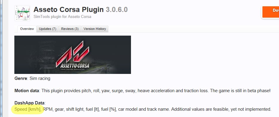

    Great combination, AC+simtools, maybe it would be possible to get the speed value out of the program with a modified plugin, and drive a big 220V fan. Another way of improving would be some simvibe like solutions.

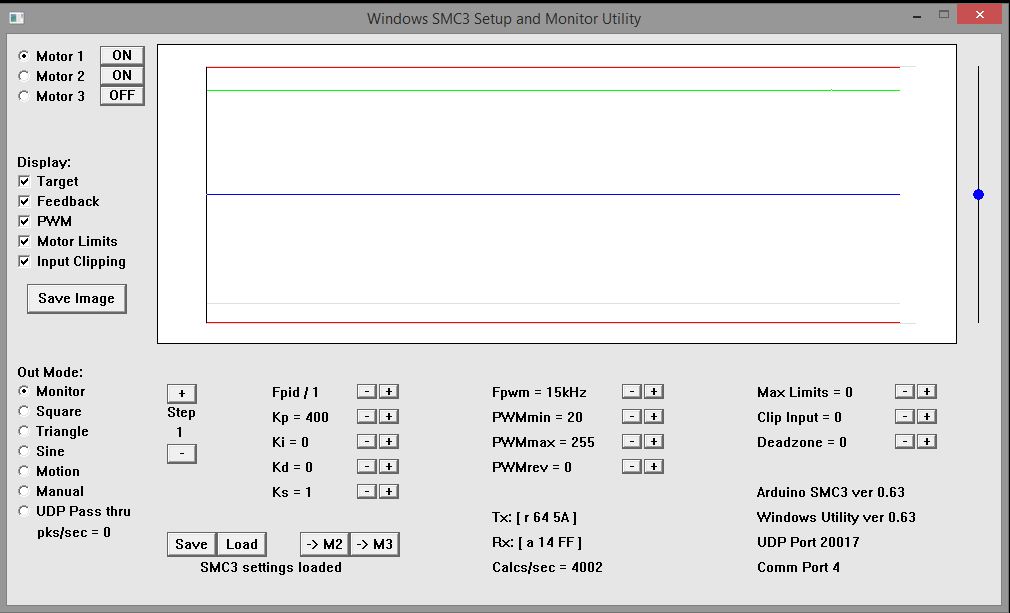

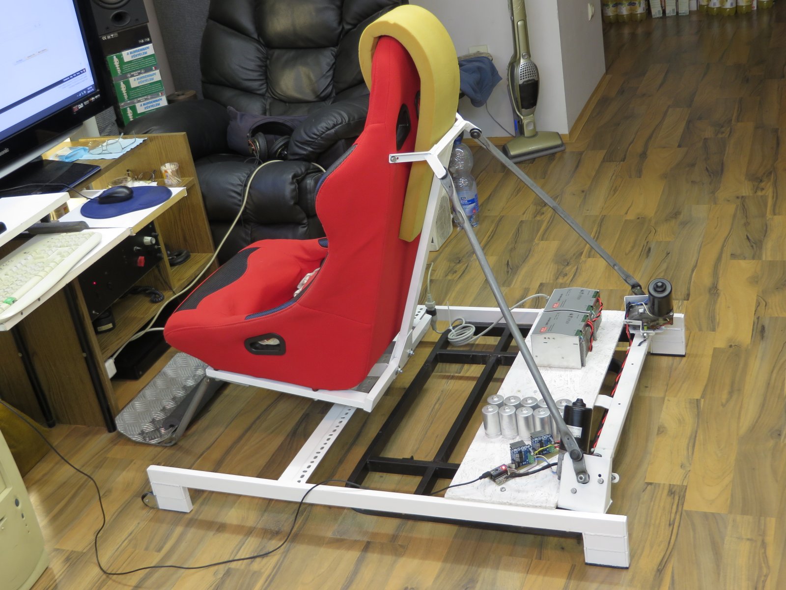

    wiper motors have a plastic gear, thus prone to wear, but i have no problem with its speed, [anyways it is driven at 24V instead of 12V] With lower speed only, there would be stable ripple but weaker.
    More problems with the slack i guess, but it is not that bad yet. [and the pot is rock steady on the shaft]

    Thanks for that, is there a way i can make an analog linear voltage from dashApp data's speed value?

    i use the slower speed on them because under load that is the faster one, faster than the fast speed [which is weaker and/or takes higher amperage] the cheap H-bridges are lukewarm. [you can experience the same effect on a windshield, the faster speed is only faster if there is no resistance to the movement of the wiper blades]
    working on 24V with the stronger connection it is capable of VERY unpleasant speeds, but i set it to 80% overall under simtools and 60% at the DOF settings. Higher than that, and it would be unpleasant. I tried to use seatbelts, but quit.
    PID setting in SMC3 is 400.
    Above that there is no smooth movement. [no rubber dampenings]

    I completely agree, my seat winches are running with PWMmax 175 now and KP 490. But the traction loss winches need a fast move but less kp, so there the PWMmax is 225 and the kp around 80 -100...

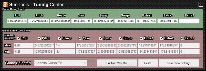

    What is your opinion on settings, at DOF settings [I have 4 DOFs set to 2 axes] each of them is set to 60%. is it too much? Can it cause saturation?
    I will set it lower.
    The other thing is USB interface output packet rate, I have set it to 1ms instead of 20, lower is the better, but a too frequent packet rate may slow down communication if there is much data? [more things happen the same time]

    As said before, please please make screenshots ofy our settings in SMC3, Simtools (and Tuning center!) and post a photo of your motor including the specs and the lever.

    I will make now screenshot and photos, though for photos I have to use the other PC,
