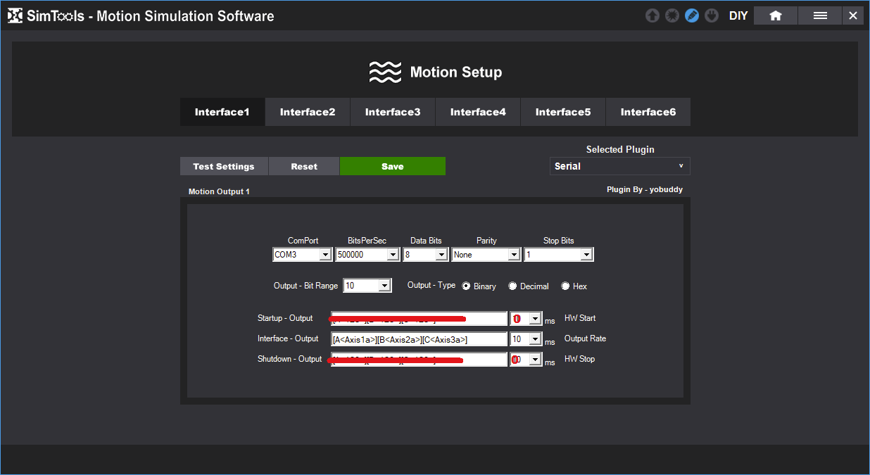

    I'm reaching out to inquire about configuring the speed setting in SimTools v3, particularly for the parking position. Regardless of whether I set it to 1 or 100, it doesn't seem to make any difference.
    Similarly, I'm encountering an issue where the motors snap to a position upon powering on, rather than moving smoothly with a ramp. I'm aiming to achieve the gradual, controlled motion that linear actuators demonstrate in many videos, where they slowly and smoothly move to a mid-position at game startup.
    Additionally, I've noticed that Symdeck promotes this feature for SimTools 3. However, I'm beginning to wonder if this feature is not compatible with the SMC3 and the serial interface plugin?
    Thank you in advance for your assistance.

    Hi @Michail,
    I can help you with this buddy.
    I think there may be 2 things going on here, one of which will be fixed in the next release.
    First thou, may I see a screen shot of your serial interface settings for SMC3.
    Chat soon!

    Here you go:
    Soon, I'll need to integrate an additional Arduino Uno because I'm upgrading from a 2DOF with Traction Loss setup to a 4DOF plus Surge system. Should I then alter Interface2 from ABC to DE, or modify Axis1A, Axis2A, Axis3A to Axis4A and Axis5A, or perhaps adjust to Axis1B, Axis2B?

    Please make these changes.
    The problem here is the interface settings are centering the sim at startup and shutdown.
    Please make these changes and you should be good to go.
    (and it should work for every instance except after a pc restart, but it will work there too after the next simtools update)

    Using Axis4a, Axis5a and Axis6a would probably be the easiest.

    Just delete startup and shutdown markups and set ms to zero?
    So my 2. Interface will be only have A<Axis4a>][B<Axis5a>] and the coresponding COM port?
    Do I have to change some code for in SMC3.ino for the other 2 motors?`Or can I use the same code.

    SimTools v3 auto centers the sim before and after the game, so we don't need these for v3 is all.
    Yes, A<Axis4a>][B<Axis5a>] and a different com port will work.
    There is no code change needed as interface 2 will use a different com port.
    Take care! :cheers

    Ok it’s working well. Tested as interfaces 1 because, I only tested the new 2 motors as [A<Axis4a>][B<Axis5a>] and if first interface not connected than I get a beep sind when I try to test the Dof. And the parking feature know works too. Thank you.
