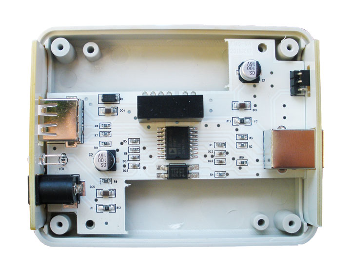

    - Another way is to use a USB hub, mind to use a powered Hub: non powered hub are often a problem in our simulator setups.

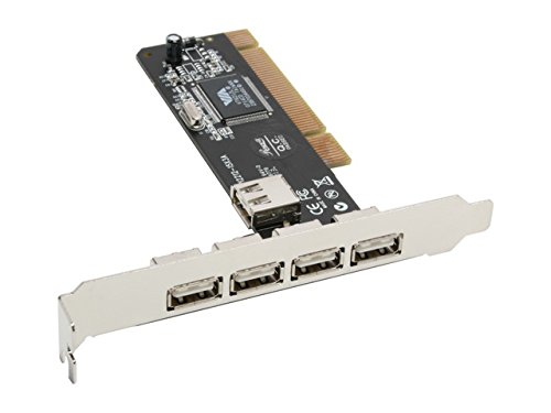

    - What I did, I bought a PCI USB card to protect my computer hoping it'll blow before the motherboard. This stage is a kind of fuse between mother board and simulator.
